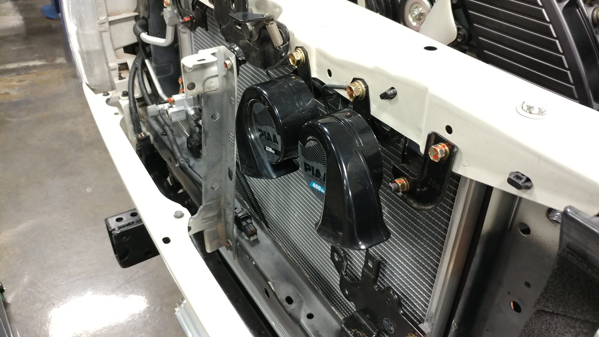

Final little things being addressed....had some PIAA horns from something....figured this would be their new home.

@bottombracket has 4 of those horns on his new 80. Will make you get out of the way quick.
I usually use the JDM Toyota horns....but I had these. Seem pretty loud from a bench test we did.
The 4 that came in my new 80 seems a little excessive. I can box up 1 to 3 of them and send your way if you need reinforcements.
All good I think.....pop them on your 79 :)

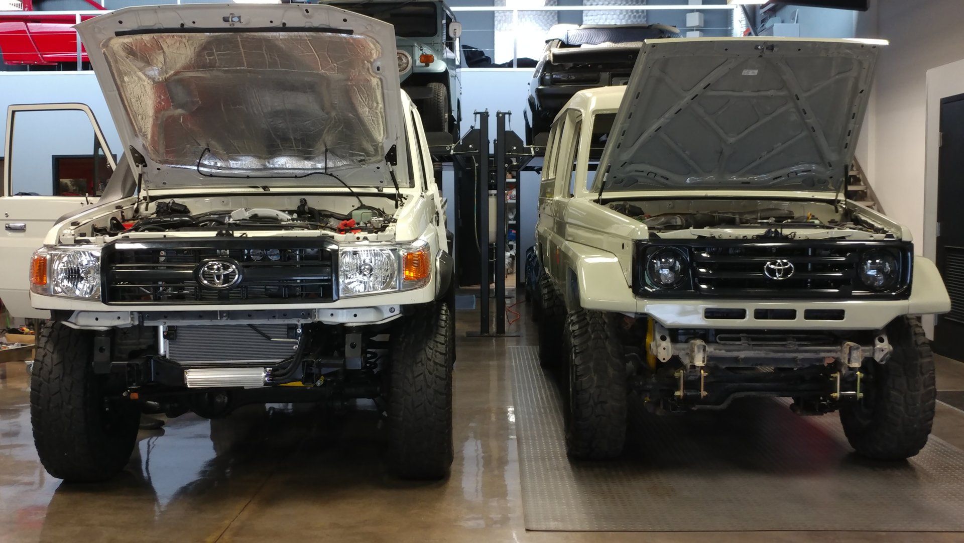

Troopy is getting some love in-between work on the 79......need to update that thread.
This is our no-prop rod pose....

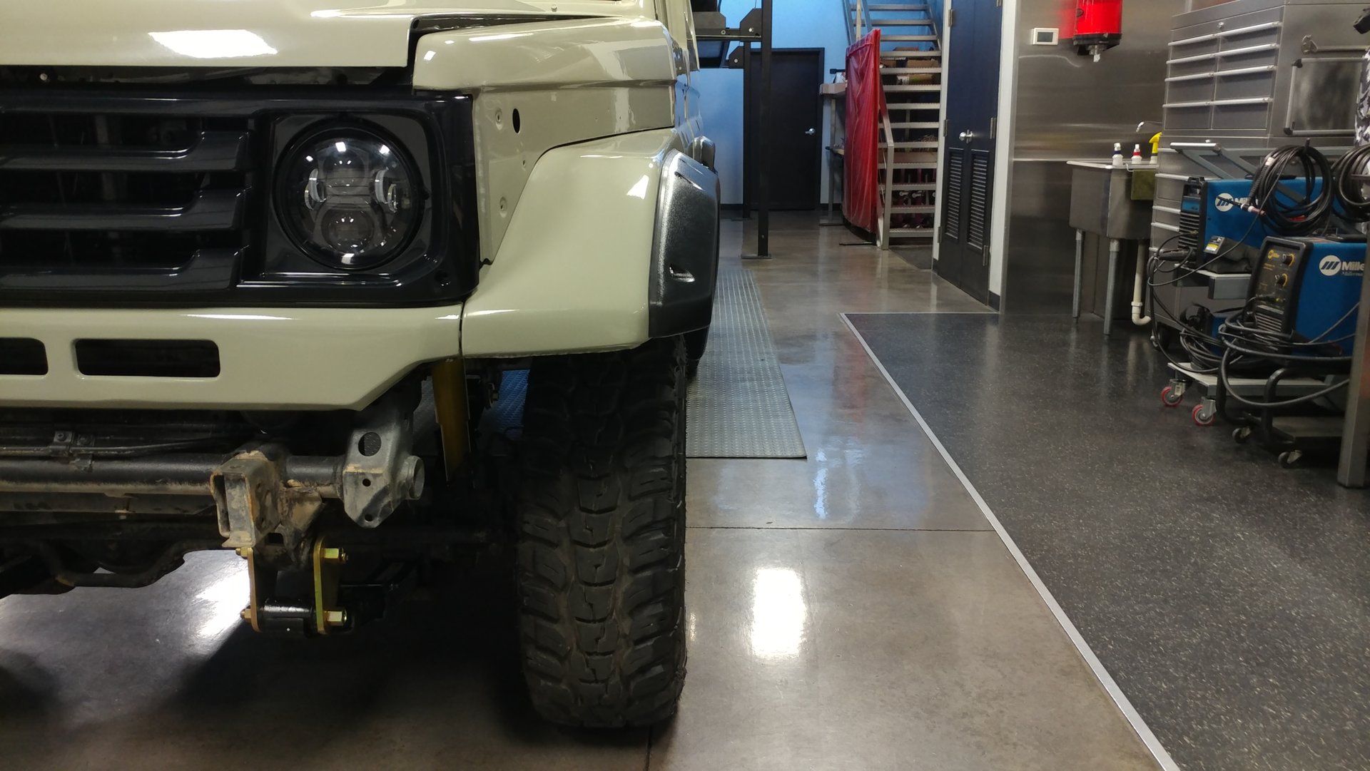

What steelies are those on the 79?
16x7 Taco/Sequoia/Tundra spares....they came on an 80 series I bought for the next build. The guy I got the truck from said they were "ex Nato wheels"...ha.
Going to buy a set of 17x7 steel spares tomorrow I think.....may end up using them on this truck. We're looking at running 255/80/17s most likely. May have a look at BFGs 33x10.50x17 too. We will be running different wheels but the 17s will give me some idea on sizing for the custom wheels we will run IF I don't keep the steelies. I love those wheels.
I have a little more room to play around on this truck as the Kut Snake flares are about 1" wider than the OEMs on truck #1.
We put the flares on the Troopy over the weekend....really nice coverage. Dobinsons suspension went on last week.

Eyeballing it, I think the 16x8 ProComp steels that came with my 80 might work or be very close with the right tire. Napkin-math, taking into account the offsets, says they'll stick out a little under an inch more than those 16x7s. Interesting.
If not, good to know those Taco/Tundra wheels fit nicely. I'm partial to the steel wheel look anyways.
