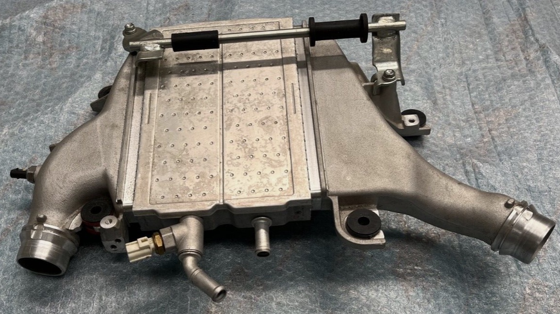

Kick it up a notch with a sweet air to water unit. This made in Japan TRAD unit is from a late model Prado. Cools over 16 psi 200hp and 375tq in factory fit up. Probably have to cut/TIG the inlet and outlet, but that’s well within your abilities.
Nice looking unit. Might be a decent fit for a 13bt/14bt if it’s not way too large or $$$
Not a bad idea at all......wouldn't need the scooped hood either which would be ind of nice since I'm not crazy about having to get another hood plus paint, etc. Certainly easy enough to find room for a pump and heat exchanger on this truck......hmmmmmmm

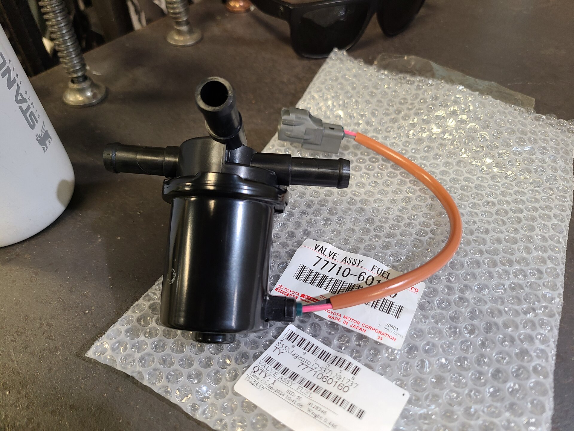

Yeah, air to water set ups make for a clean, tidy, and non bulky install. Plus, Toyota has invested heavily in electric pumps and front mount heat exchangers for not only their latest family of boosted Dynamic Force and Diesel engines, but the inverter cooler loops for the Hybrids. The parts bin has some choices.
Good to know.....going to look into their pumps.

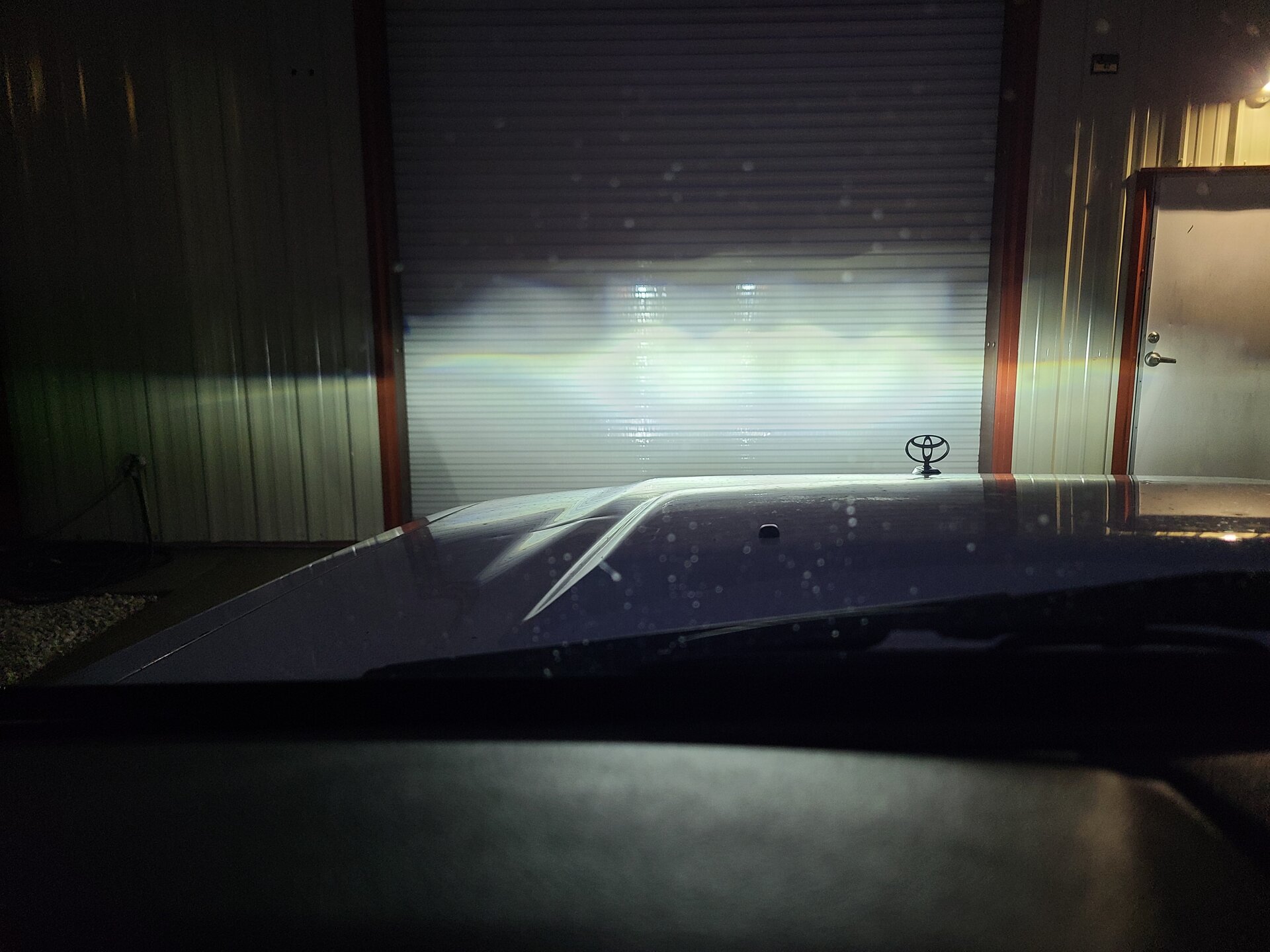

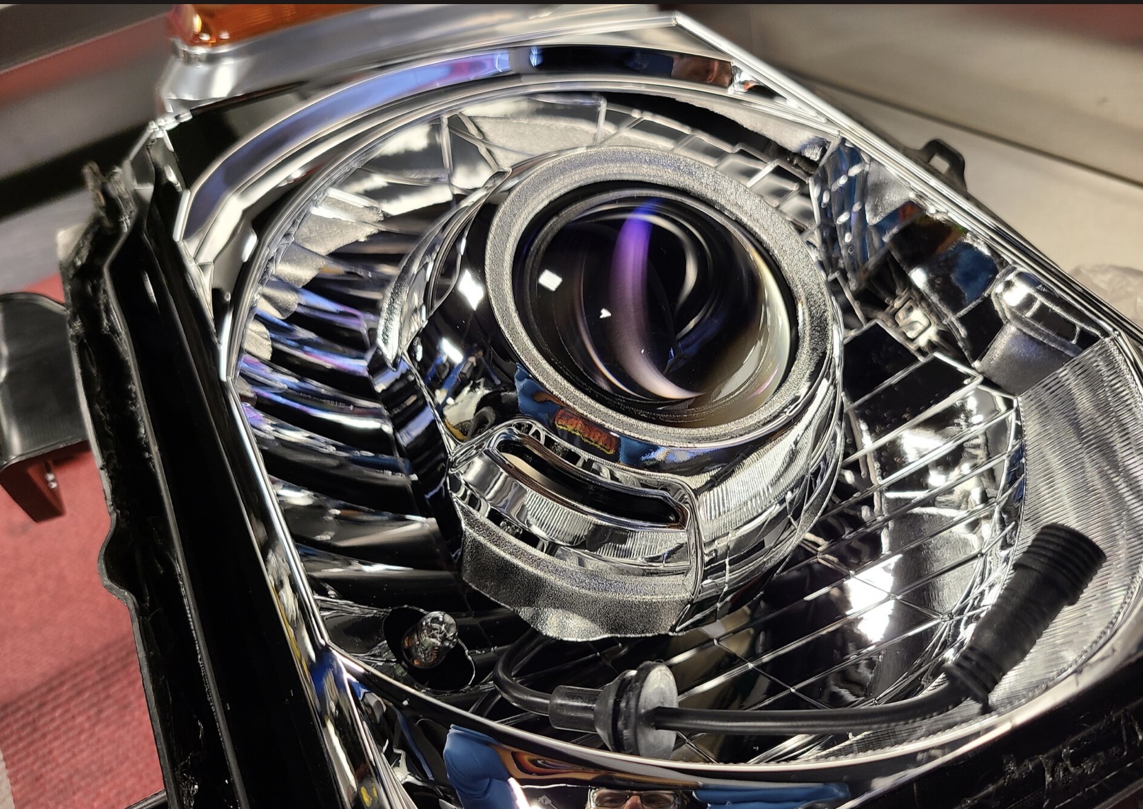

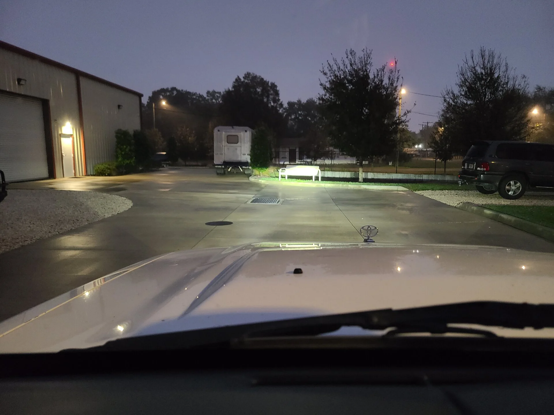

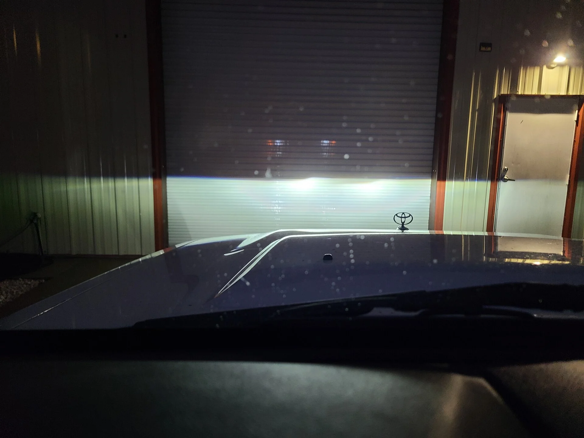

Was able to take some pics of the lights this morning......pretty bright. Probably will bring them up just a touch.
Low beam:
High beams:
That low beam cutoff is like a laser, dang!
Those lights work great!

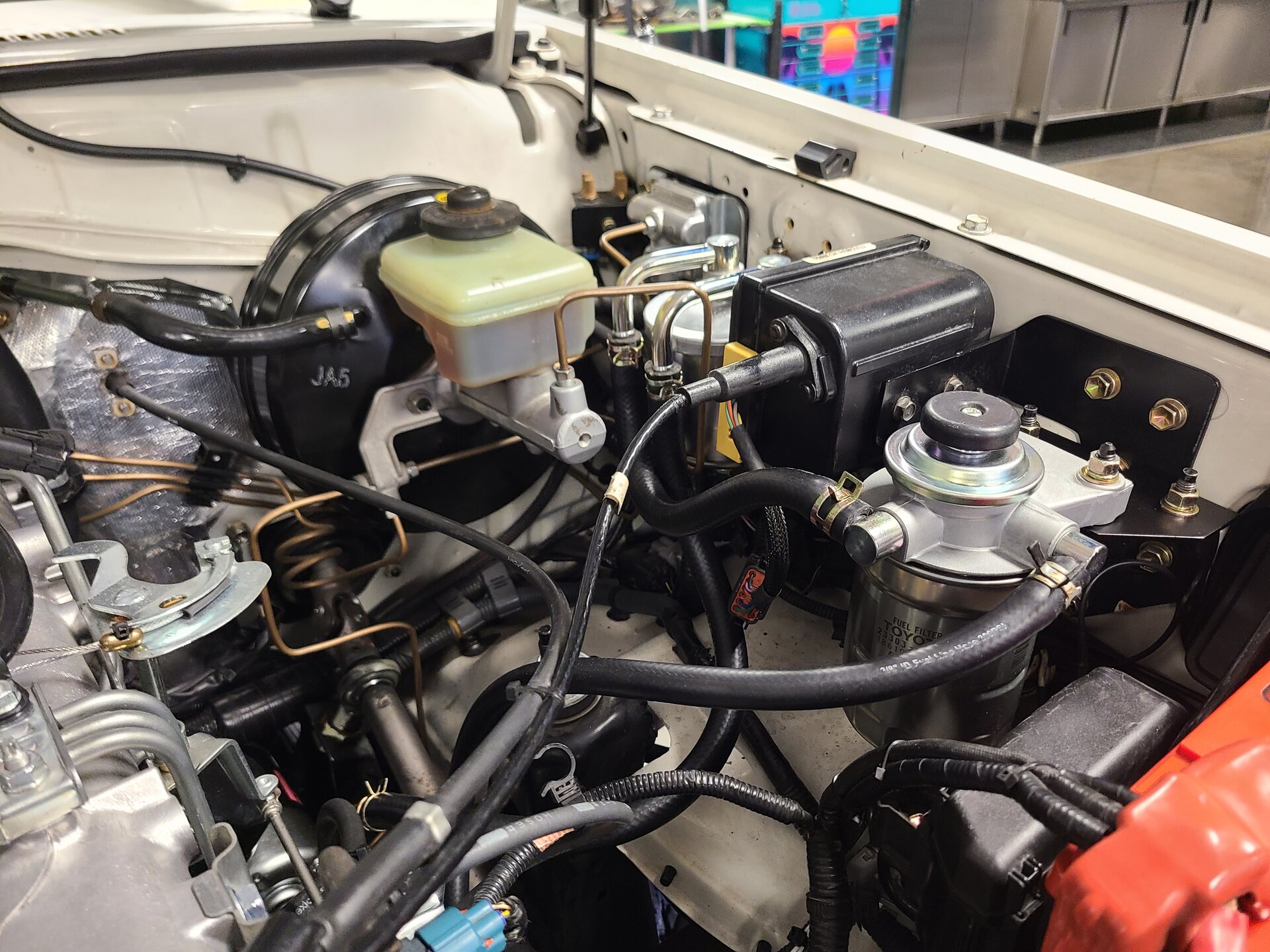

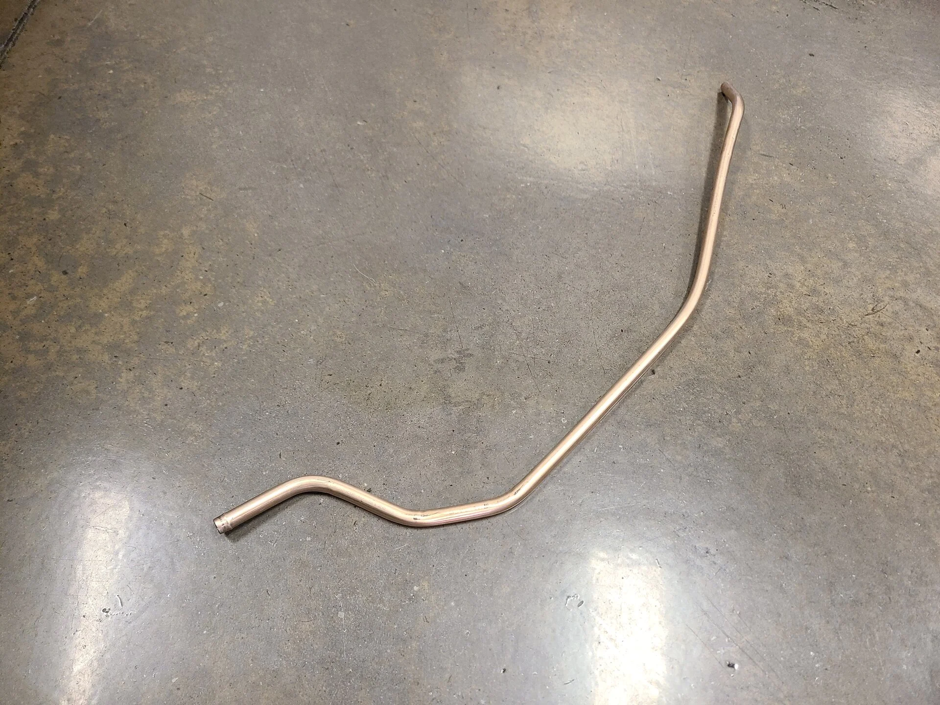

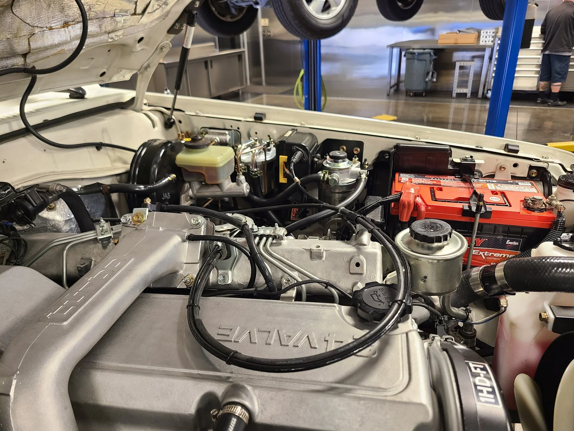

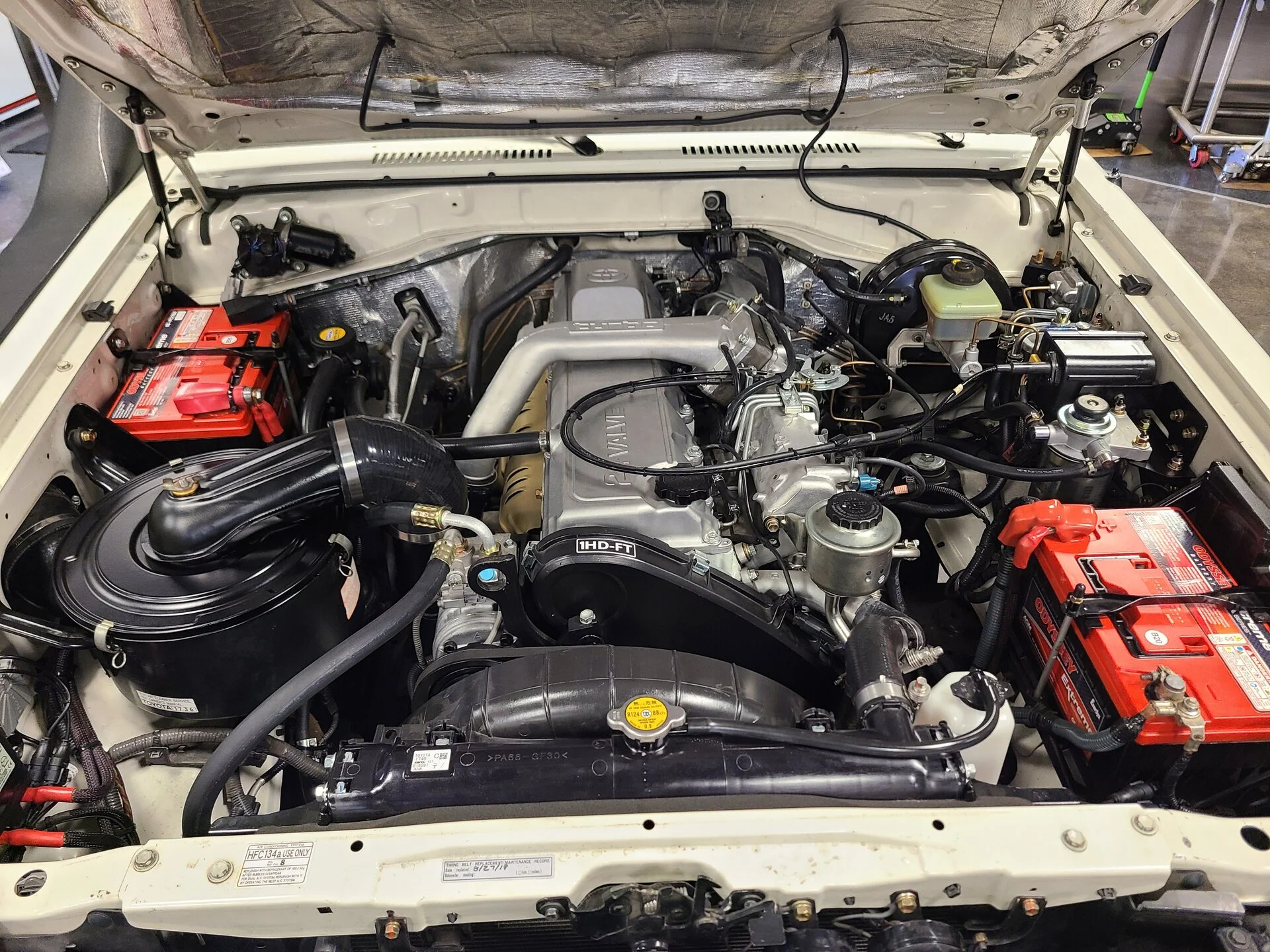

Last few bits and pieces got wrapped up.....upgraded the main tank’s fuel line and switching valve to the HDJ7x one. Need to pull the bed so we can run a 12mm hard line to the valve....maybe this week.
Got the prefilter and fuel filter mounted in the last of the available space.
Looks like it was there from the beginning. Air cleaner lid powder coated along with a couple brackets.
Been driving it the last few days.....wow what a remarkable difference. It’s way smoother and revs much more willingly than the 1HZ. Neat motor. The H152 made a HUGE change to the truck. Turning just about 2000 RPMs at 75mph....that’s about 400 or so less than it was vs the H151. I’ll have to top the tanks off to see what kind of fuel mileage I’m getting with this setup....although I’m not sure I remember what I was getting with the 1HZ. Wasn’t too great as I recall.
