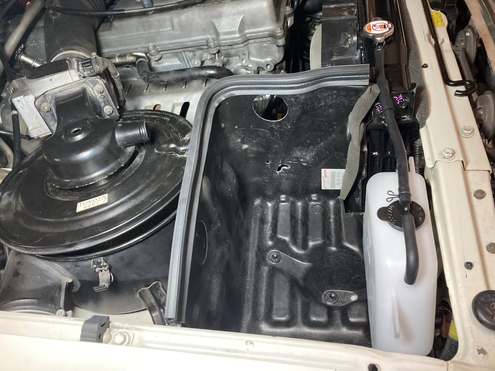

I also did this today.View attachment 2914798
Special thanks to @MrMikeyG for photos of required trimming for 2nd battery tray. I used an oscillating trimmer and nibbled away at the tray till it fit. I could have left a bit more but it’s all bolted in and I’m happy.
Where’s the 2nd battery? Good question. I’m going to use this space as under hood secure storage until I do an aux battery in the future.
Glad I could help. I'm still debating a true 2nd battery setup which is why my parts are still in a box. Under hood storage does sound nice though.;)
Well I can already tell you I like it.

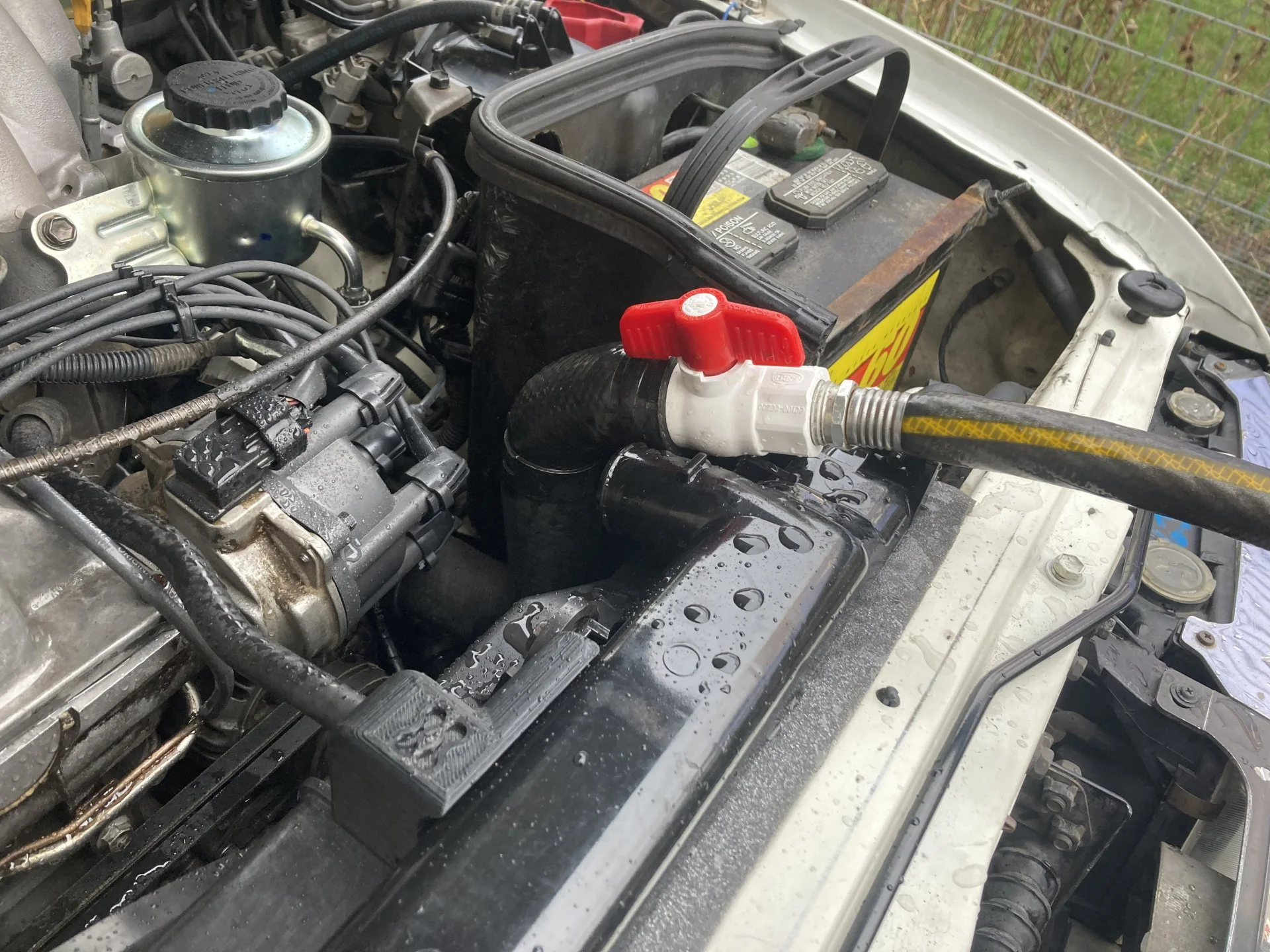

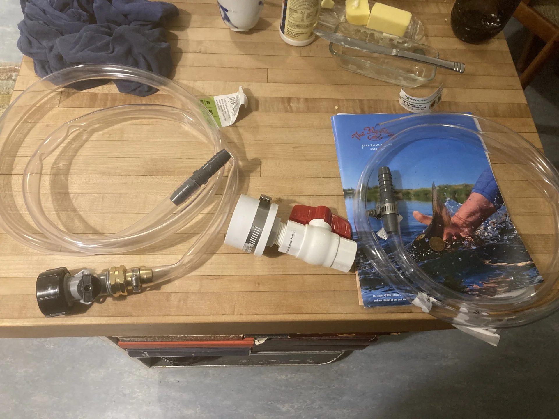

Here’s what I’ve come up with:View attachment 2908109L to R:
  1. 5/8 id vinyl tubing with a brass barbed hose attachment coupled to a ball valve. Othe end has a 1/2” barbed coupler. This is my heater core flush inlet.
  2. 2”x1” pvc reducer with ball valve and 3/4” female hose attacment. This is my block flush attachment I’ll utilize the factory hoses. I have a smaller 1 1/2” x 1” that wiill actually fit. This I think is too big for the inlet and outlet hoses on the block.
  3. And a 5/8” id vinyl drain tube with a 1/2” coupling. I’ll use this to drain the heater core to a bucket. I have a dog. No need to accidentally poison her.
Hopefully this will keep the mess under control and let me flush throughly. With luck I can flush tomorrow.

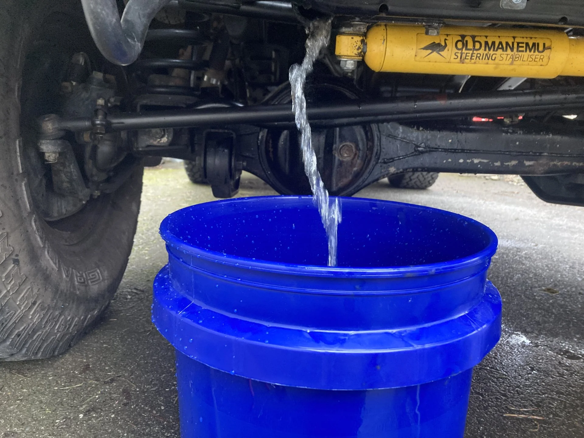

Flushed!
My DIY cooling flush worked great. I unhooked the hoses from the radiator, removed the thermostat and flushed the block. I open the block drain which I replaced with one from Wits End (has a valves and hose outlet). I don’t have e photos but I also removed the brass u at e heater control and flushed that loop as well. Tomorrow I’ll fill with distilled water and run the engine as a final flush, while I get the timing figured outZ. The I’ll drain the distilled and fill with 50:50 Toyota red and Lagavulin….or maybe just distilled water.

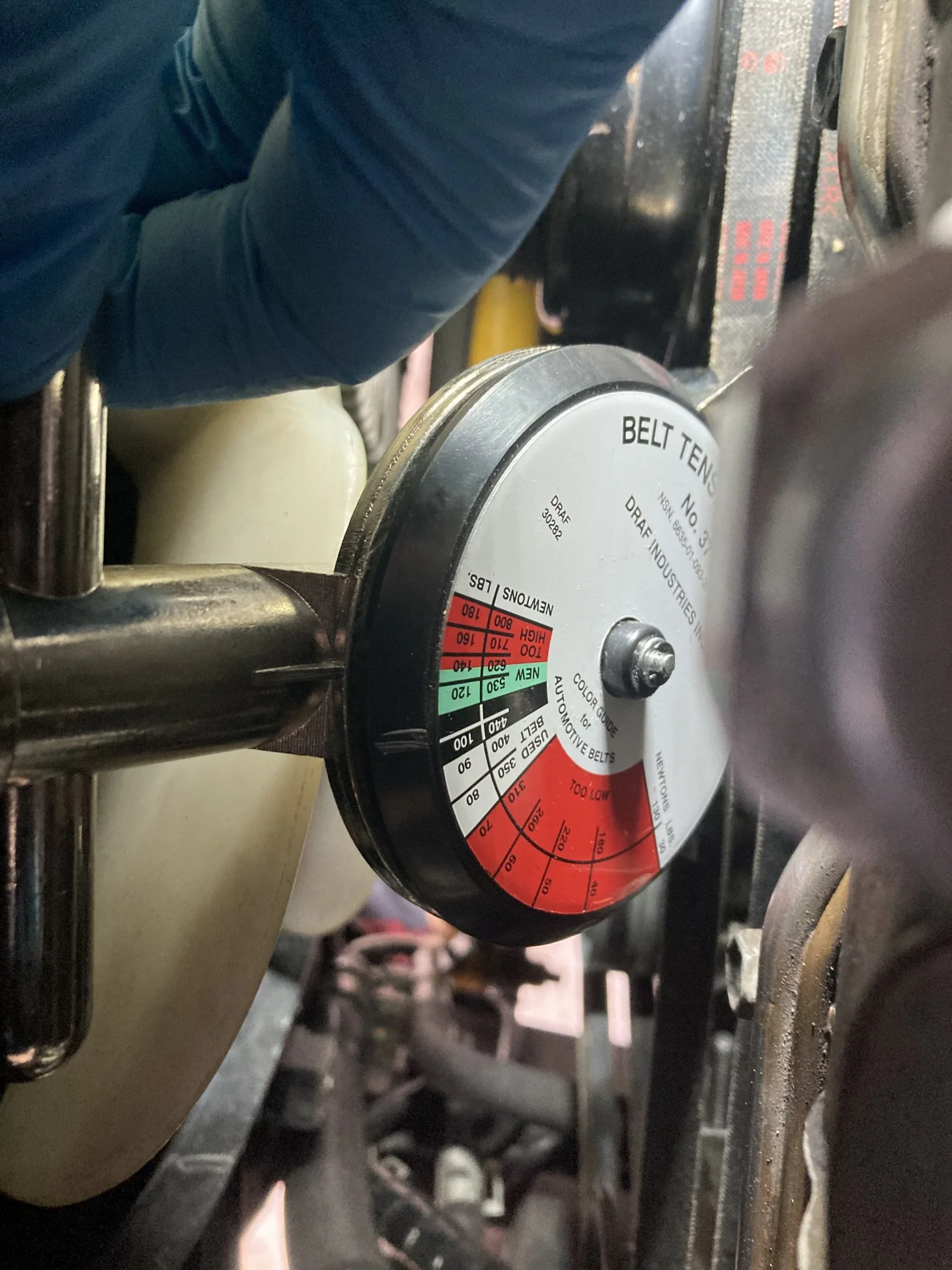

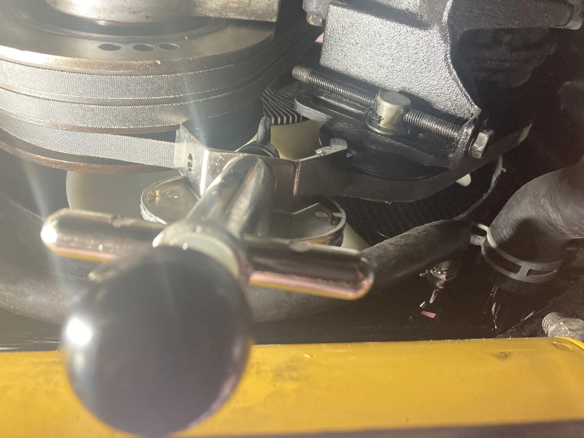

I also got the new belts tensioned up. I used my nifty Burroughs style gauge.
The guage was a little bulky to use, but it’s easy to read and it’s clear when your using it right.

I've never seen a belt gauge like that.
Same.
We always just used these.
Same.
We’ll I’ve never owned a belt tension gauge before so I used the FSM to guide my purchase. The Burroughs style one was the only one I could find. Seemed straight forward to use.
