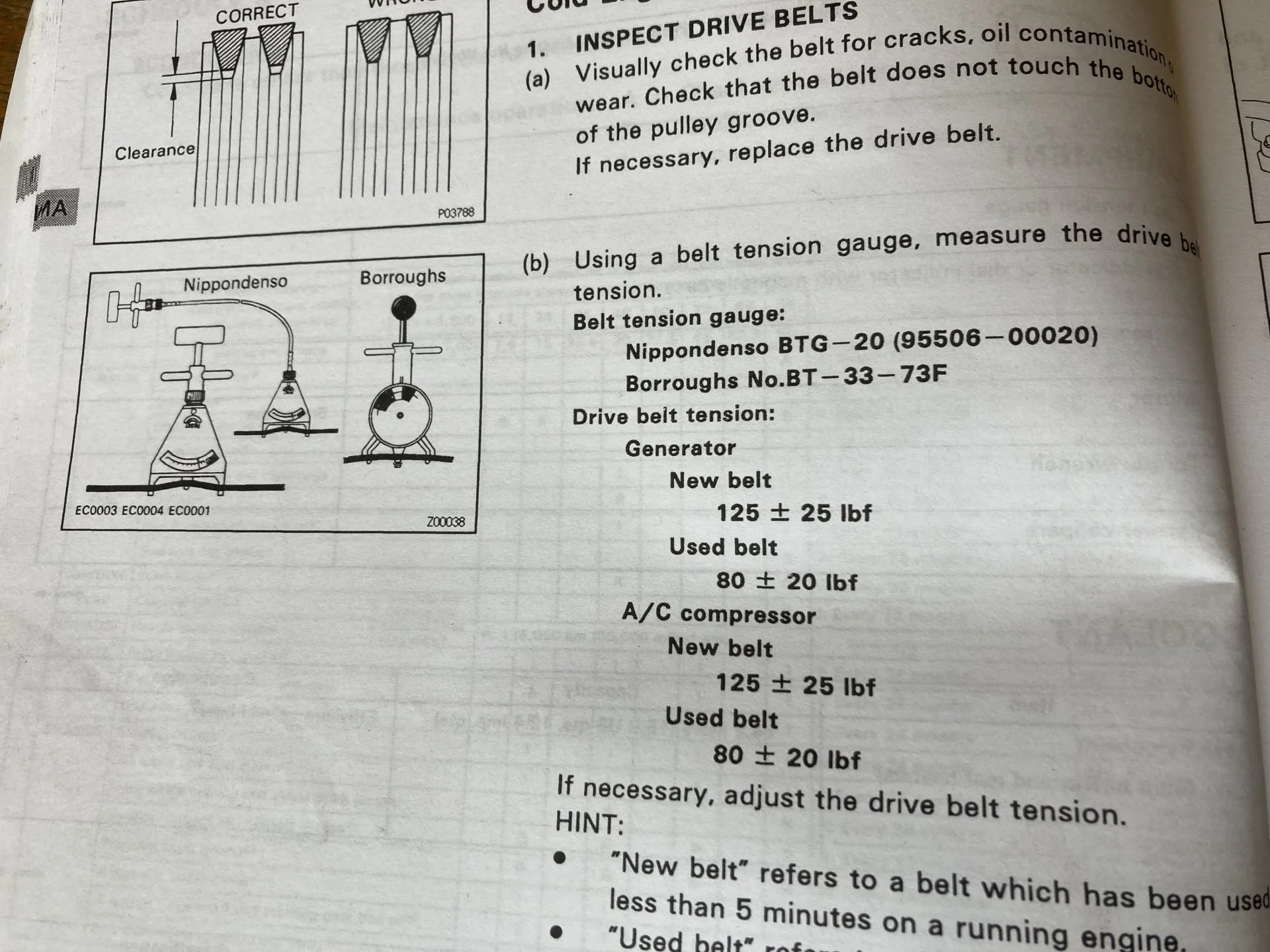

We’ll I’ve never owned a belt tension gauge before so I used the FSM to guide my purchase. The Burroughs style one was the only one I could find. Seemed straight forward to use.
I'm sure it's a great device. Nothing wrong with it. Just never seen one. I also have yet to look at the Toyota fsm.

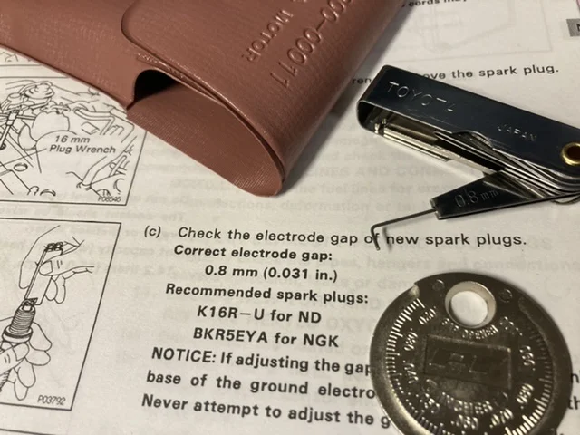

So on to spark. I did just replace every component of the spark system….new Toyota plugs (I checked gaps were at .30). New plug wires, new distributor cap and rotor. New coil. Hmm.:confused:
Not sure if this is a typo but the plug gaps should 0.8mm. If you have yours at 0.3mm then you likely are not getting a decent spark.
He said .030... That is .8mm
Most of us still gap plugs using sae.
It worked fine, but it is much larger than I expected, it just barely fits for measuring the belts.
Oops. I was not being clear again rushing along. This is my default mode when I can tell my “cruiser time” is bleeding over into family time. This is never a good thing g in my household, as it cause some bent feelings around here.
I checked the gap at .031 inches initially with a round “coin” style gap checker. I felt it was hard to accurately use (I don’t check gap very often) but then later I confirmed gap with a different gap tool from my shiny new engine maintenance set. So I feel confident that the gaps are indeed correct at 0.8mm. FWIW I did not need to adjust any of the Toyota plugs, which is apparently typical, but occasionally/ rarely they need adjustment according to some folks so it’s worth checking. So yes, gapped 0.8mm with a good tool. My earlier post Was confusing, why did I write .30? Well because I wasn’t looking at my FSM or my notes:slap:—this is a great reminder (to me) that what I remember isn’t true….unless we’re talking about trout…then really accurate memory.
Afore mentioned tools.
