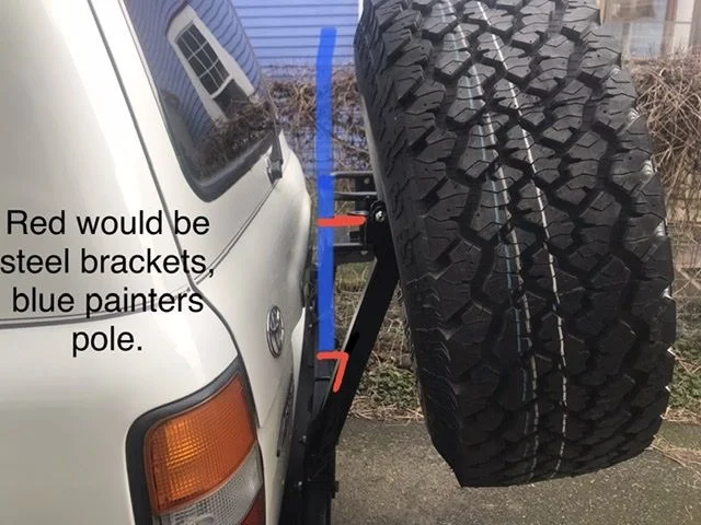

I’m doing a little bit of puzzling over how to mount up a pole mounted work light. The homemade variety made from a painters pole and a led light. There are lots of pieces to this puzzle, but my 315 spare tire makes space challenging. If I move my sparetire away from my truck at full extension of the labs mount, then I have some room to work with. However I’m worried that I will put undue stress on the spindle since I’ve increased the leverage of the spare tire mount.
This is my current idea:
I’m not a welder so I was thinking of buying some 2” mild steel, drilling holes in, it to bending it in my vise to shape the brackets. But I’m going to spend some time driving around like this to see home much it shakes.

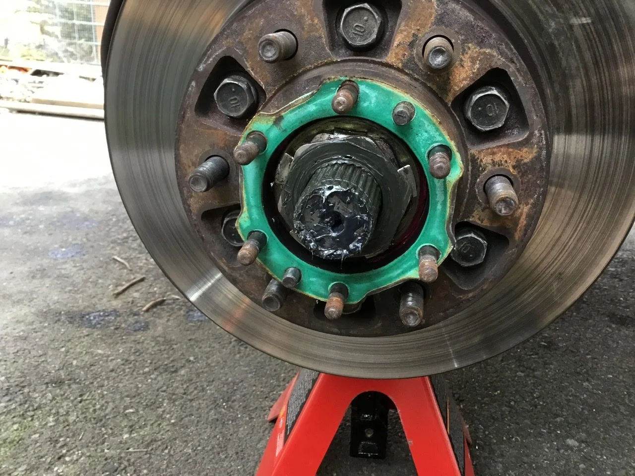

Took my rig up to mountains on Thursday and noticed a pulsing on braking comin got a stop at a couple of stop lights. So last night I checked the wheel bearings on a hunch and sure enough there was a little play in the 12 and 6 o’clock movement. So I dug in this morning and re did the bearing preload, but I tightened up the preload to 30 and the lock nut to 47 as recommended by the venerable tools r us. Pics to prove it.
I changed out the flange gaskets while I opened them up, I figured they would be damaged when I tore things apart. Fortunately the Bellingham Toyota stealership had 2 and they were only $4.00. I figured they would charge 15 a piece or something outrageous. Anyhow done and done. I’ll take it for a test drive this afternoon and see if this pulsing is gone.

Took my rig up to mountains on Thursday and noticed a pulsing on braking comin got a stop at a couple of stop lights. So last night I checked the wheel bearings on a hunch and sure enough there was a little play in the 12 and 6 o’clock movement. So I dug in this morning and re did the bearing preload, but I tightened up the preload to 30 and the lock nut to 47 as recommended by the venerable tools r us. Pics to prove it.View attachment 2598057
Let us know how she does. How do you think they loosened to begin with? IIRC, you did your axels a while back.
The pulse seems to be gone, but moreover it was nice to not feel that play after putting it back together. Why did it loosen? When I rebuilt the axle in the winter of 2018 I followed the FSM fishscale technique and I think the 35” tires are the culprit. So I followed the advice given elsewhere in the forum from ToolsRUs, and others have mentioned that this can be an issue. I’m sure the deeply knowledgeable folks could chime in and add more but that’s my best guess.

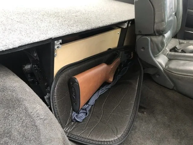

Lastly I happily discover my rifle fits in the nook behind my second row seat and the drawers. It’s a perfect fit and totally out of sight from prying eyes, yet easily accessible a nice discovery.
I‘m not a big firearm guy, but it’s nice to have a place to stash one. My marlin 336 is fairly short and it slips in and out of that cheap case easily.

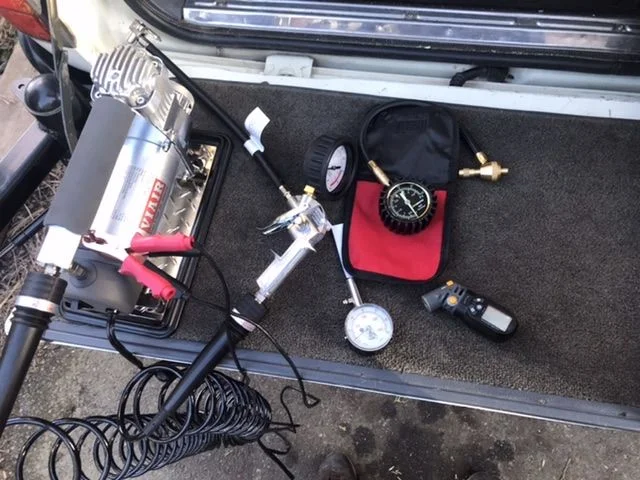

I picked up a Viair 400P compressor and a knockoff ARB deflator. I tested both out and they work so nicely! The guage on the deflator was reasonably accurate and the compressor took my spare from 0 psi to 35 very quickly! 2.5 minutes or so. I‘m excited to air down on our gravel exploration, and depending on weather we may even head west to the coast and lumber across the sound dunes. The small gauge on the right is for my MTB—I used it to double check all the other tire gauges. It all fits nicely in my drawer, which is so sweet!
