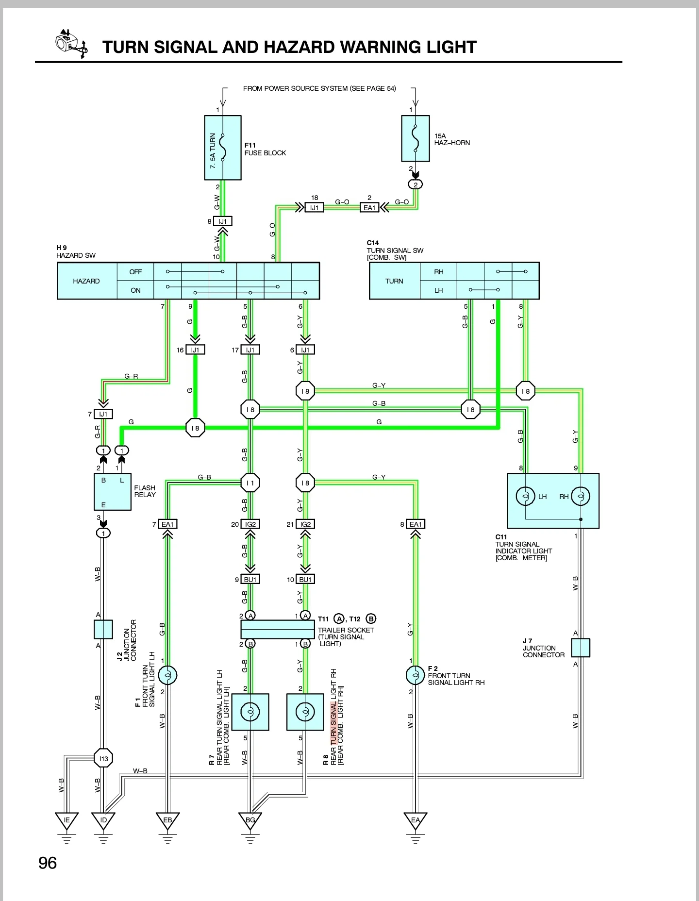

I reviewed the circuit diagram to find out why my turn signals are not working and it looks like the cause could be because I didn't plug the hazard light switch back in.

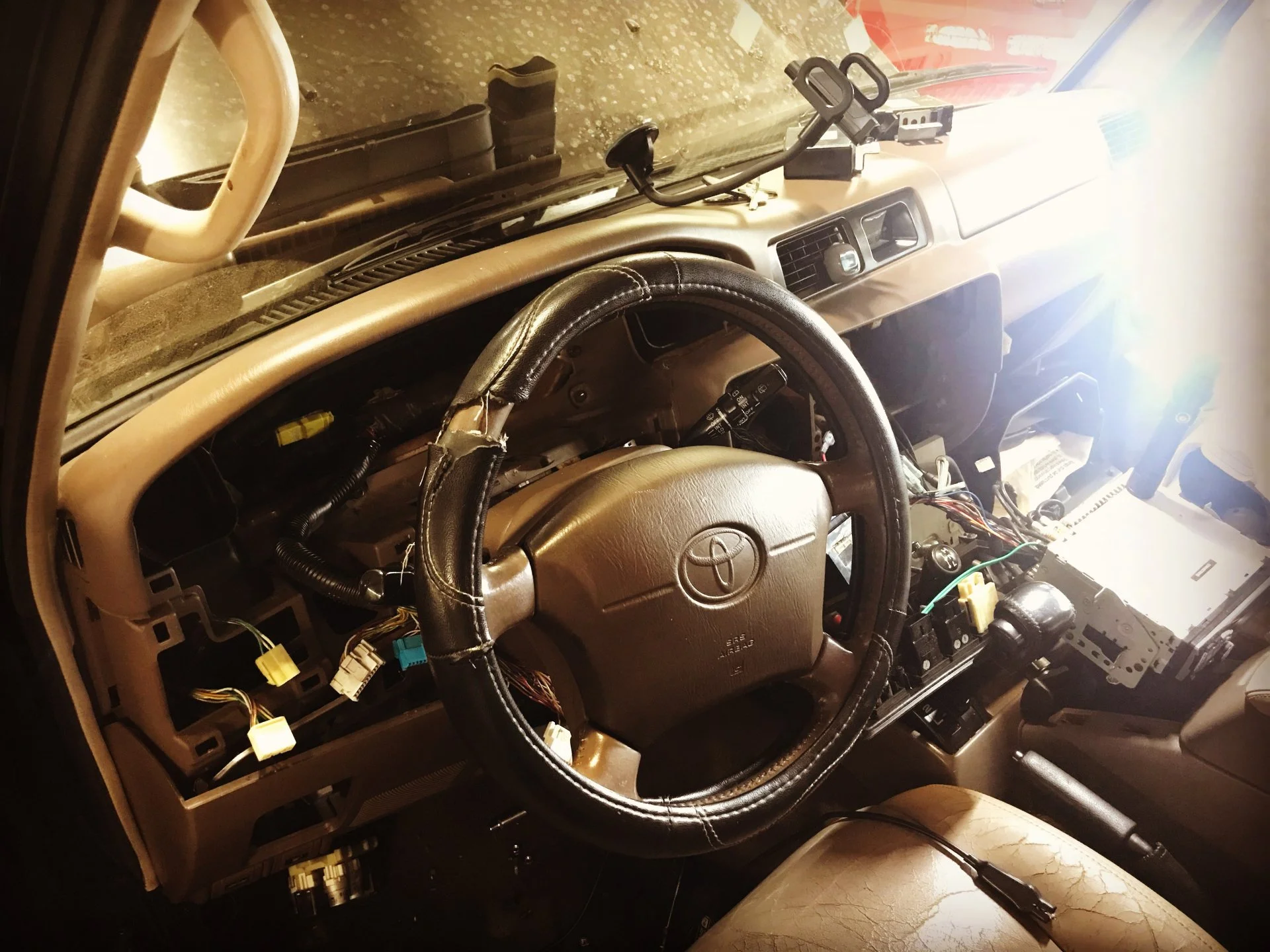

Ok I looked in the dashboard and found out the guys didn't reconnect the harness connected to the hazard lights, antenna and defogger.
Turn signals work now!

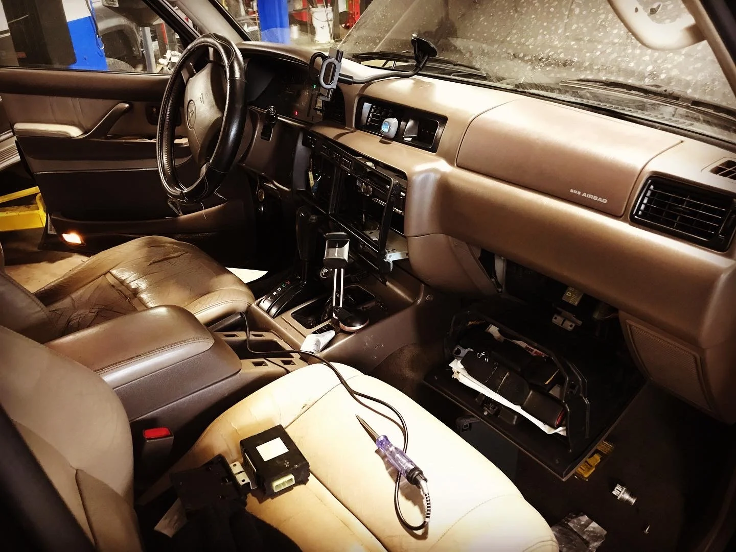

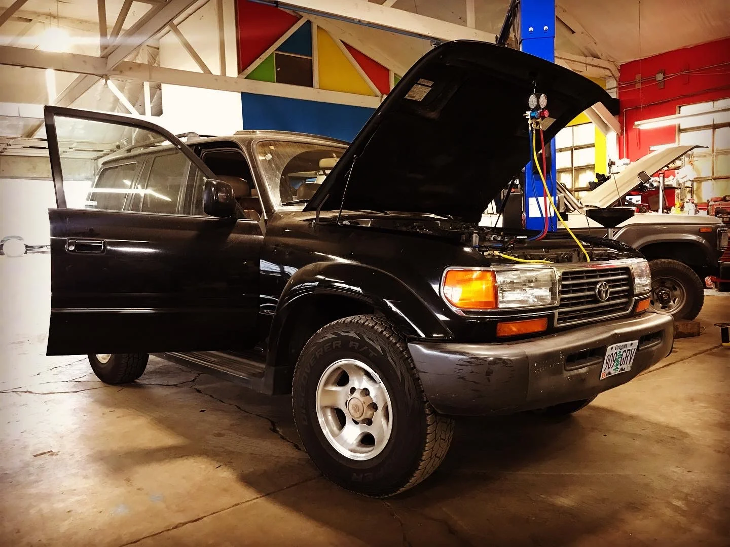

So, after being at the shop, and them pulling the dash completely apart and testing wires (some had no power) AND an AC Control Panel I picked up not working...a relay in the PS dash behind the glovebox was found not working...but this didn't correct the problem - it was part and parcel. The AC Switch (Up near the battery) was replaced but it was bad from the factory...the ac control panel had to be pulled from a donor cruiser AND, the temperature control switch (DS connector at the block) was connected...but that shouldn't have caused it. I guess it's the connector/switch that tells the system if the engine is overheating and when it hits 227 degrees F, the AC cuts out. Connected, the AC wouldn't work but disconnected, and with a new AC switch, the AC did work...which stumped the techs because the switch being connected shouldn't have effected anything.
So, I'm sitting with a new AC switch, a new relay, a donor cruiser AC control panel (The other which was sent to me didn't have polarity between switches), and a few wires given power, I have AC again.
But I still have a number of electrical gremlins.
