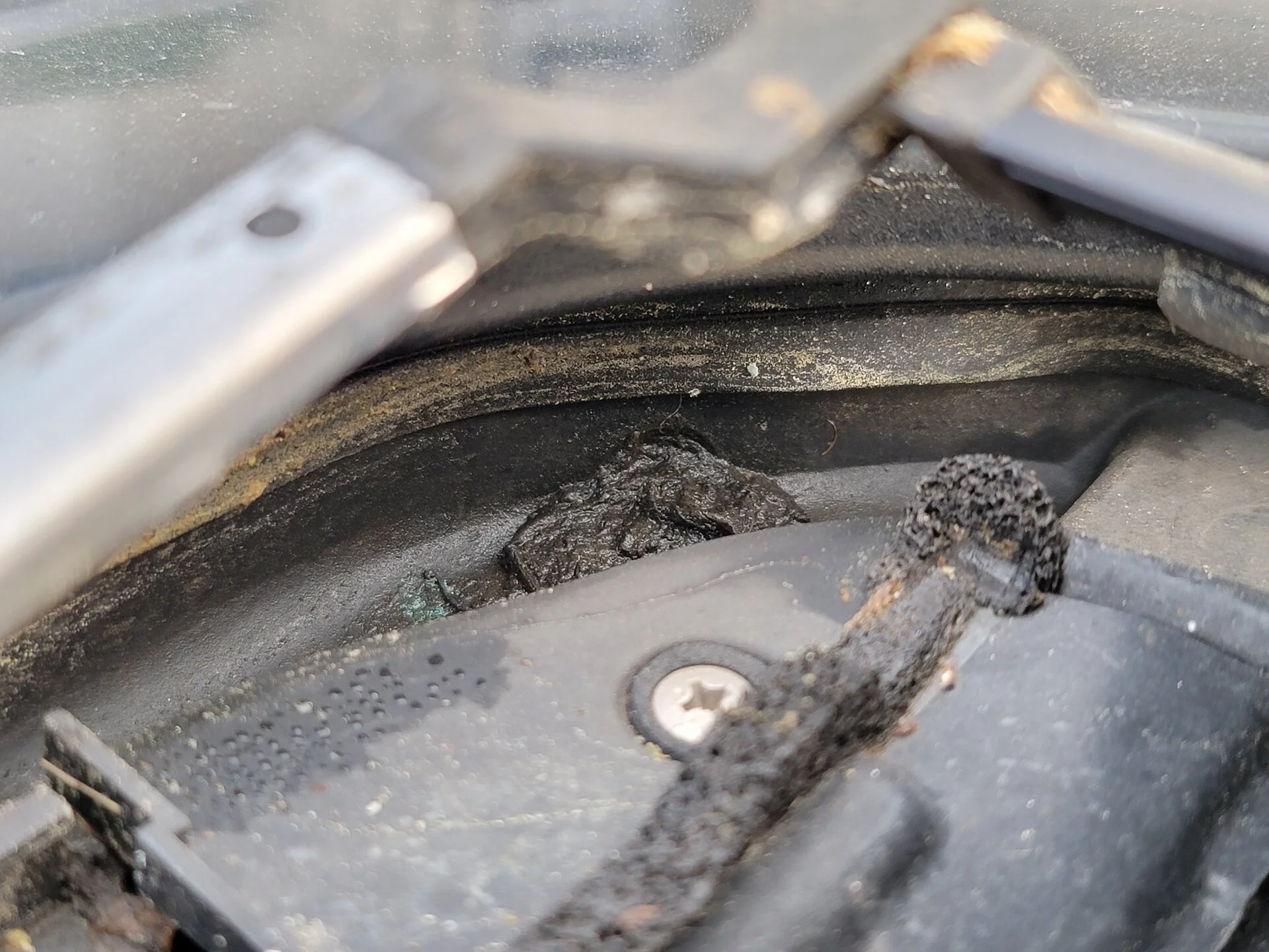

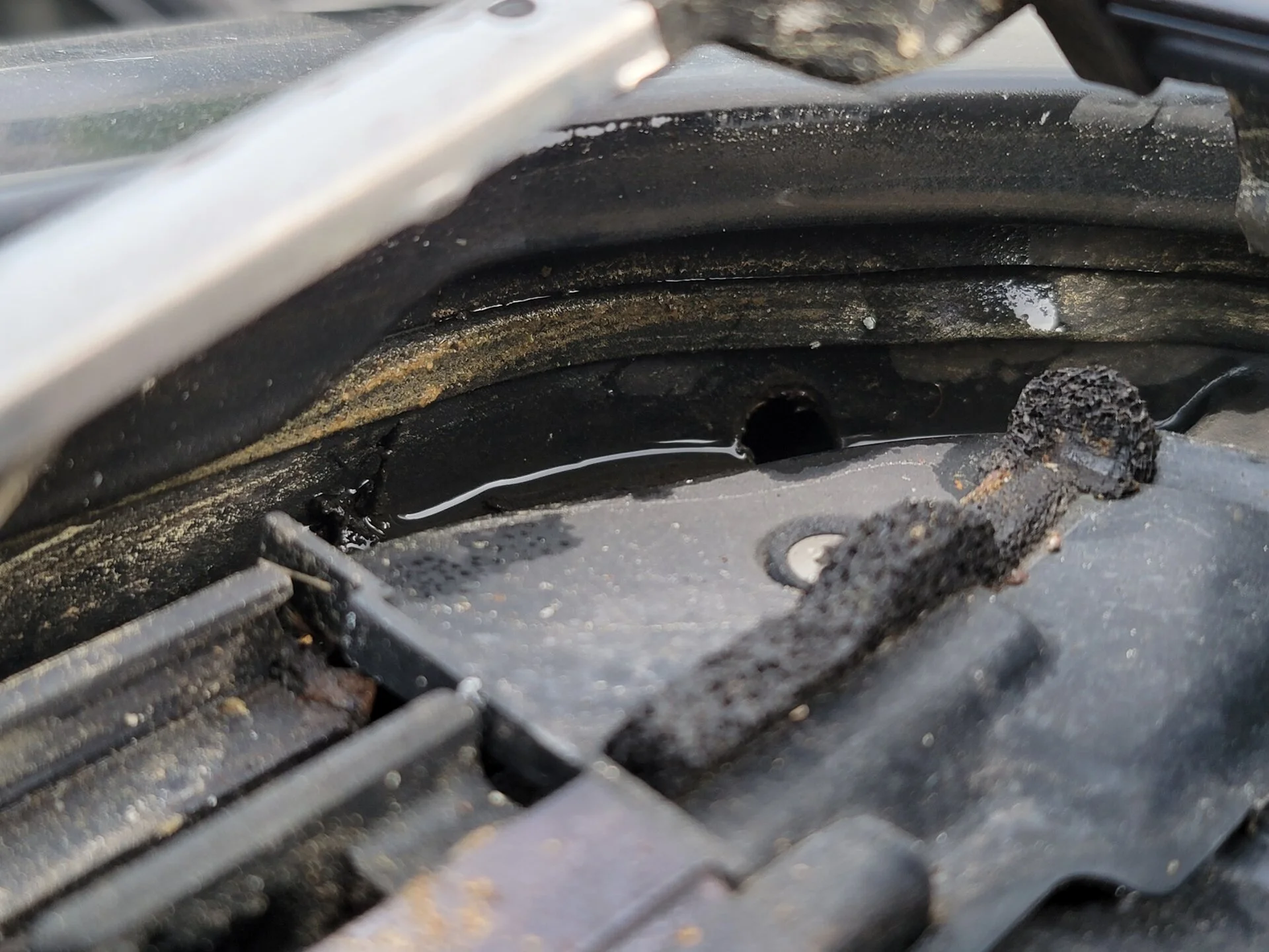

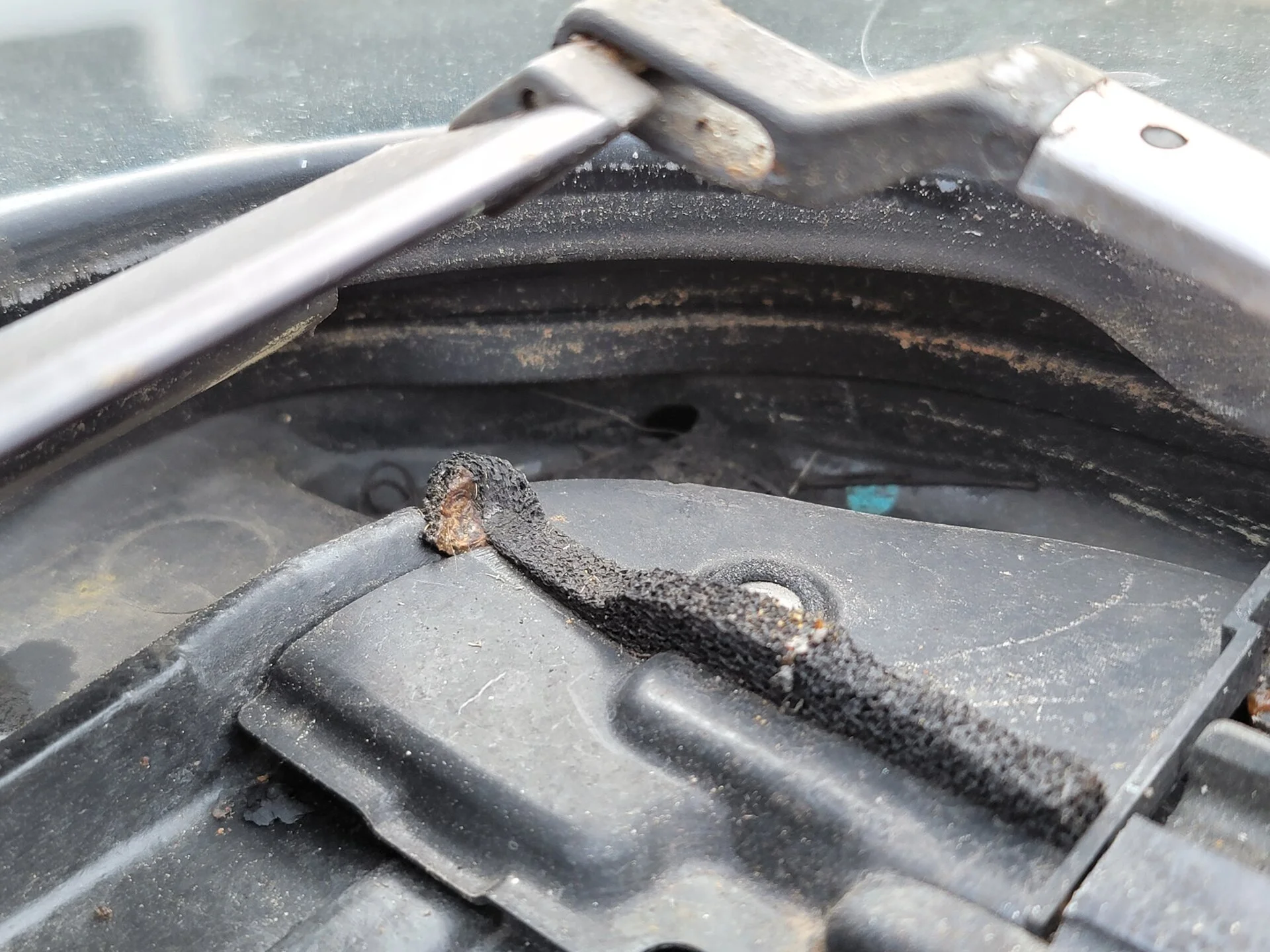

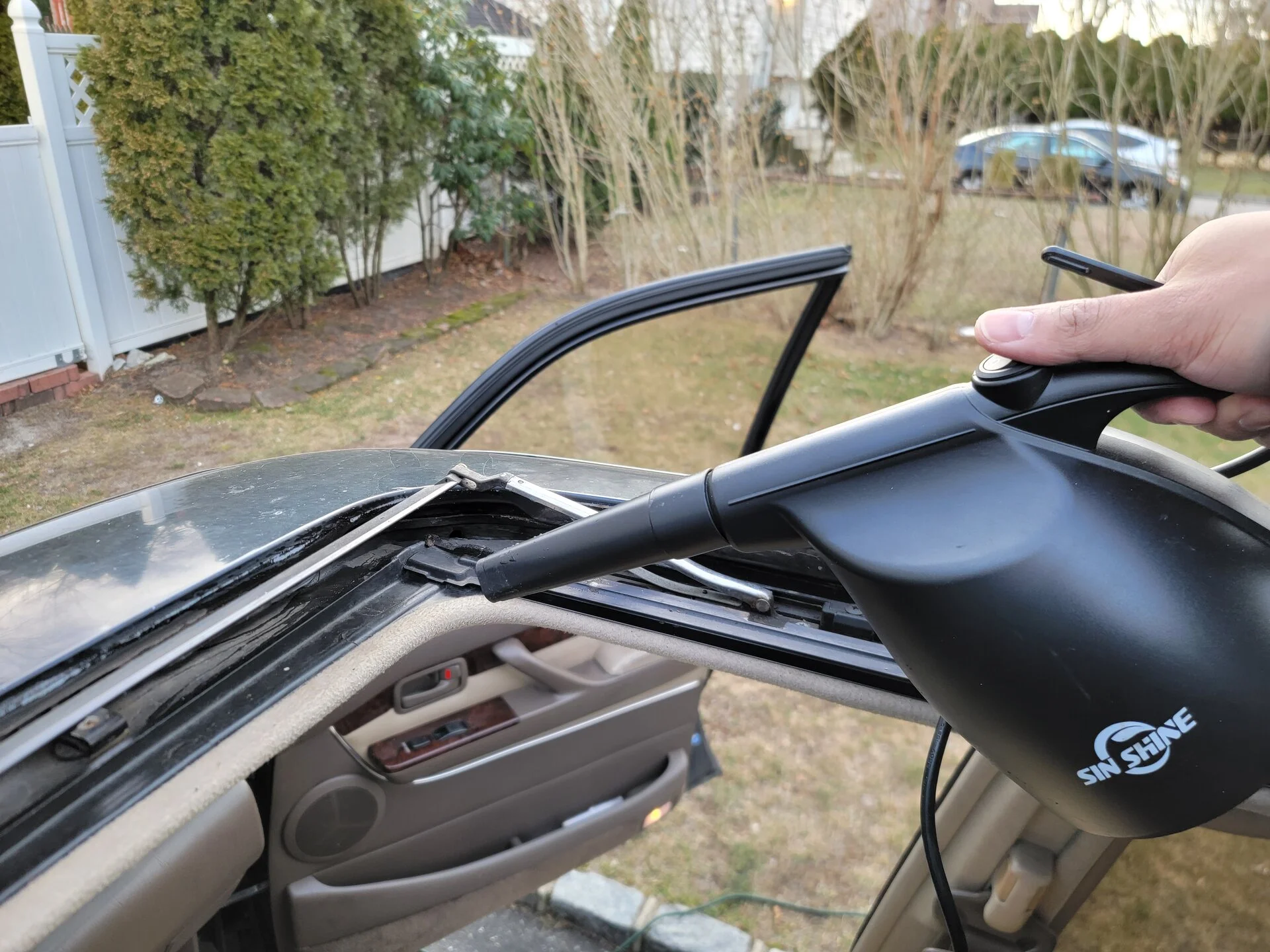

I will be doing the axle rebuild when it gets warmer. I did find this thread about sunroof drains being clogged. It looks like the pictures in the post have expired so I'll do a bit more digging to see if I can follow from the description.
Thread 'Cleaning your sunroof drains FAQ' Cleaning your sunroof drains FAQ - https://forum.ih8mud.com/threads/cleaning-your-sunroof-drains-faq.179613/
My issue is on the driver side and rear but I might as well unclog all of the drains just to be safe.

Yeah, my glass shop proved the new OEM gasket wasn't leaking...it's the sunroof...either the drains or the seal is bad.
Thankfully, she's going into an auto electrical shop next friday and HOPEFULLY, it's not going to be too expensive.
Ultimately, I'll clear the drains to be safe, and the pan...then replace all the gaskets; doors and sunroof, back hatch and back glass.
I'll need to make sure there's no more water intrusion as I want to put in sound deadening and a new carpet at the end of the summer.

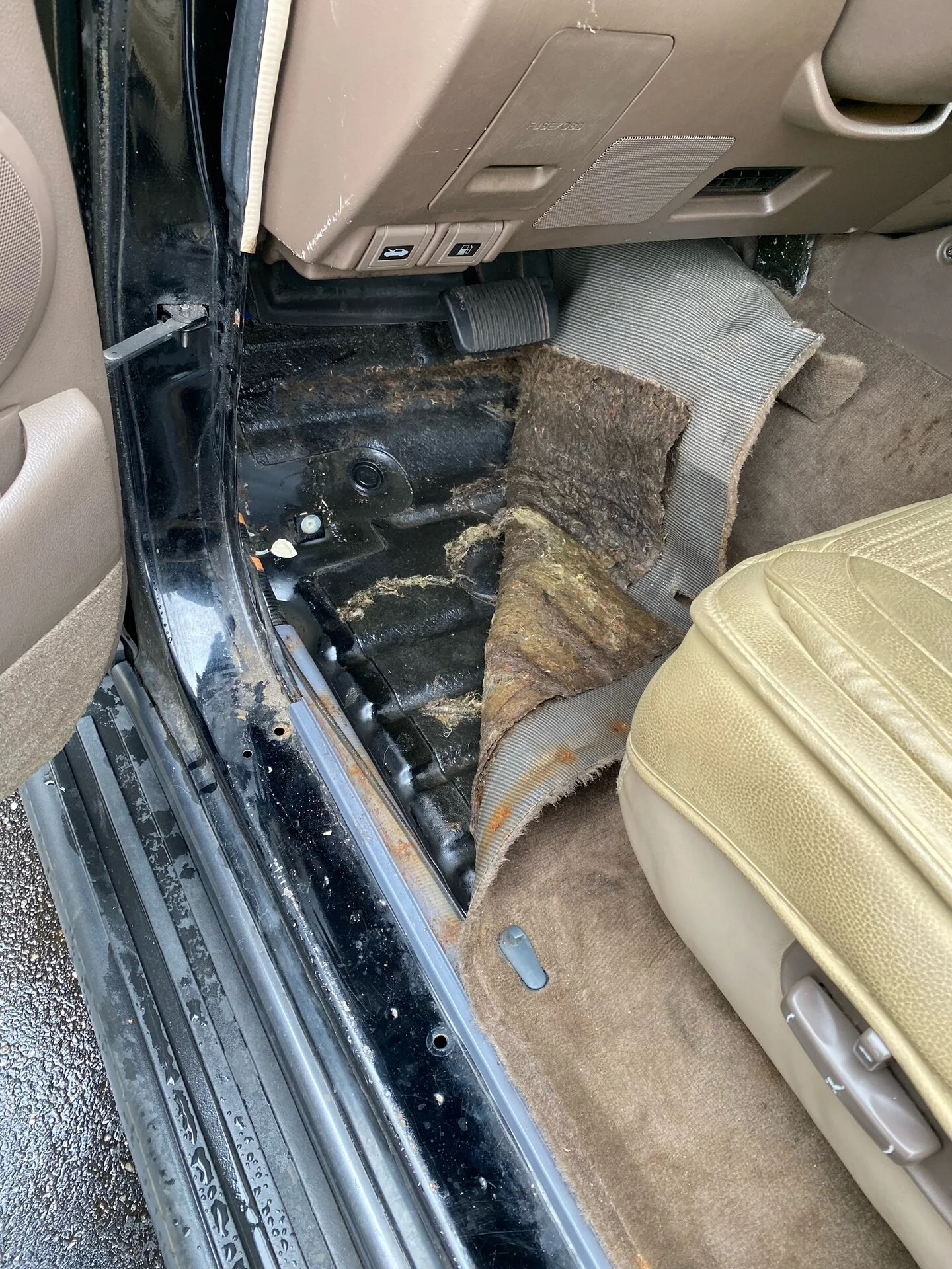

Here is the driver side floor. It's very damp and there's a puddle of water at the edge where the door shuts closed. From reading the other thread on here, it sounds like the sunroof drains are clogged. As soon as the temperature rises back into the high 40s, I'll go and inspect it.

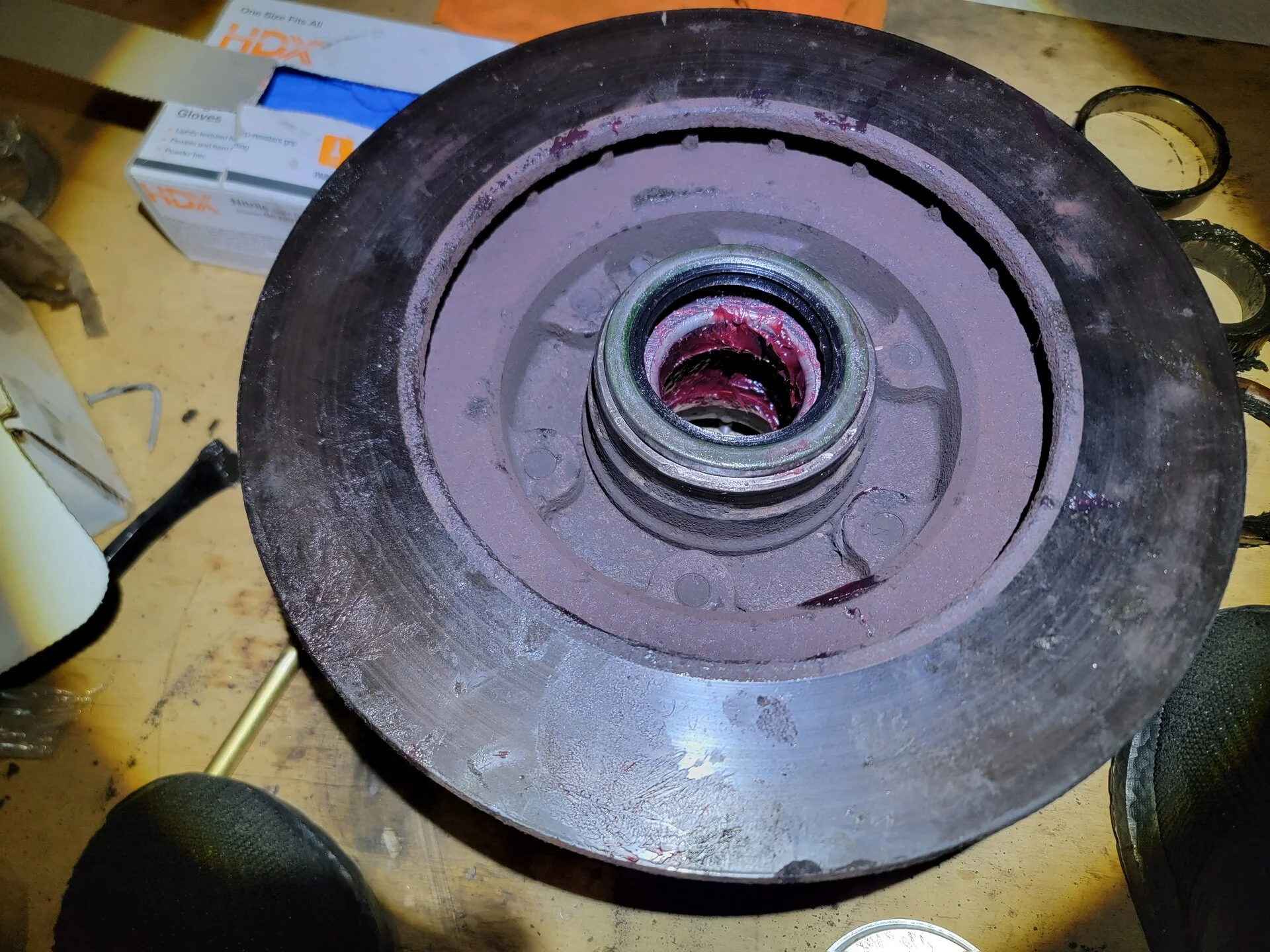

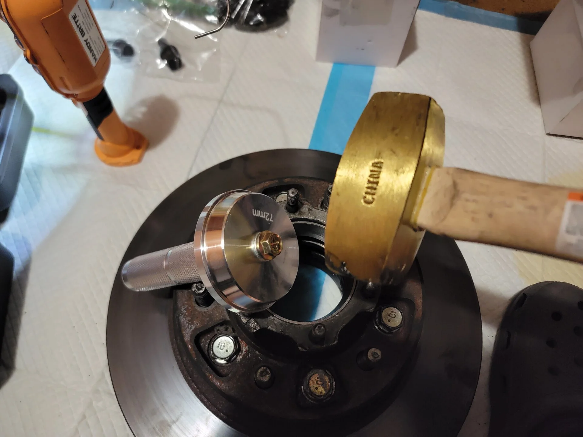

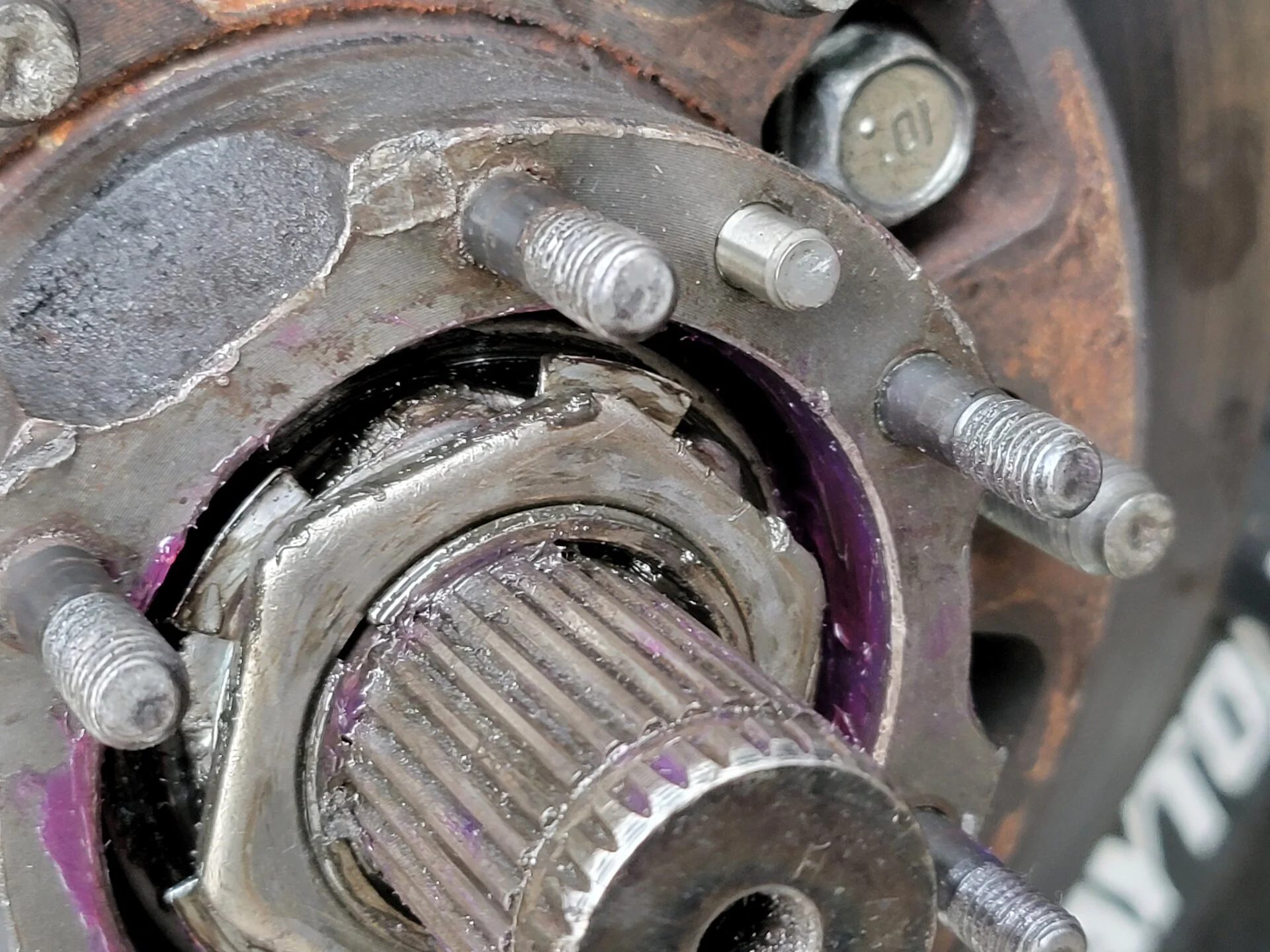

Last week I started replacing the front wheel bearings. The driver side went smoothly. The passenger side was pretty rough. First, I found that it's missing the innermost lock nut on the outer wheel bearing side so I had to order and wait for the parts to arrive, which just arrived today. Earlier today as I was replacing the wheel bearing seal on the inner bearing side, the seal looks like it won't even be able to be tapped in. I tried to use a bearing race driver but that didn't work.
I wonder if I warped the hub, which would set me back 272$ for a new replacement, or it's a defective bearing seal that came from the kit. I ordered a new bearing seal from the dealership, which should arrive by Friday.
Fingers crossed its just a defective seal. Otherwise I'll have to buy a new hub...

Welp, I finally finished replacing the front wheel bearings on both sides. I waited 4 days for the missing lock nut only to find out that the shop who replaced my rotors years ago put it on the outermost side instead of right after the outer wheel bearing 😅
