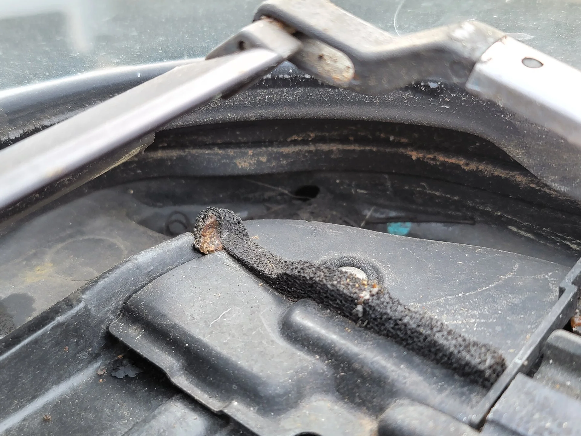

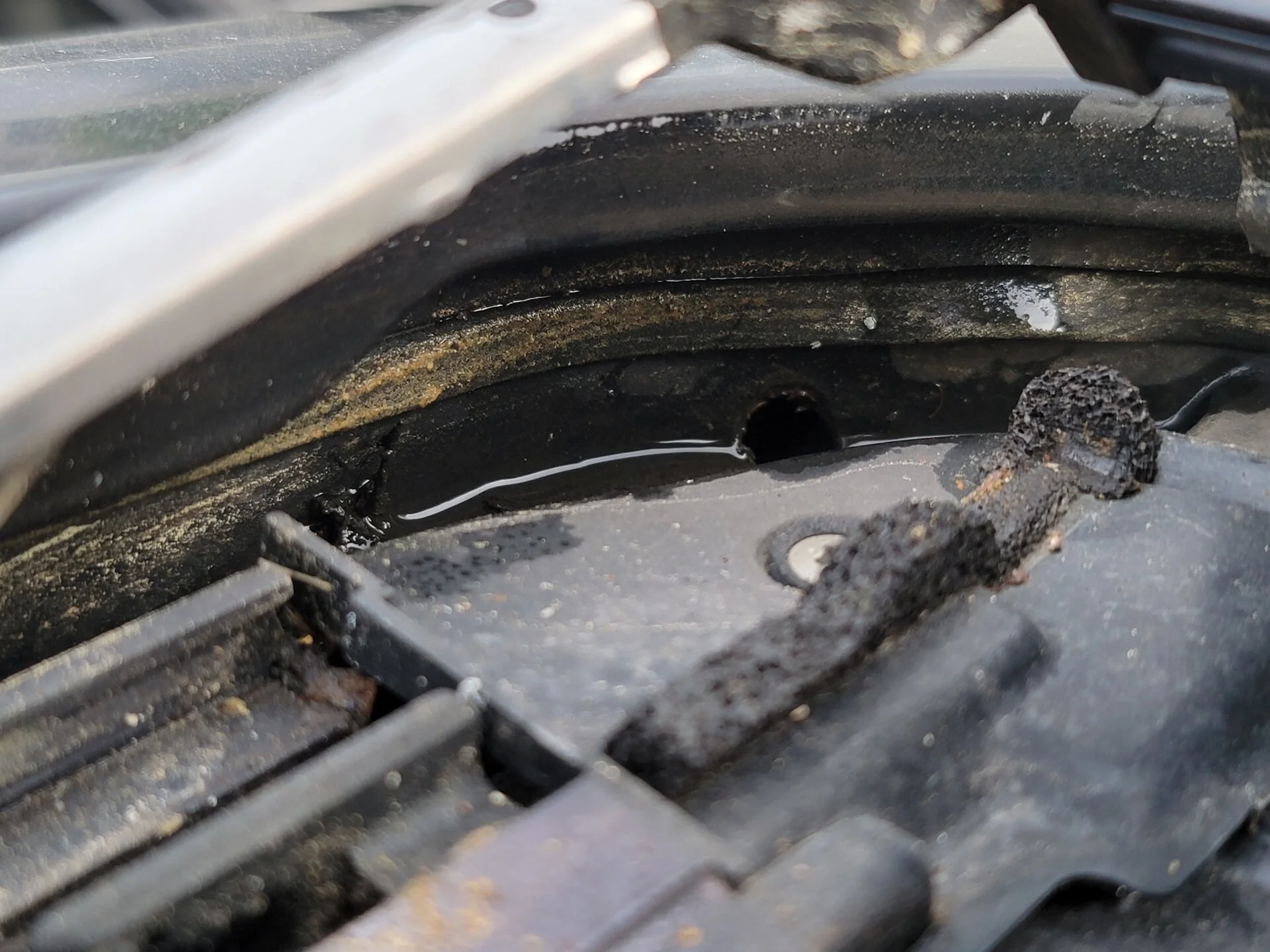

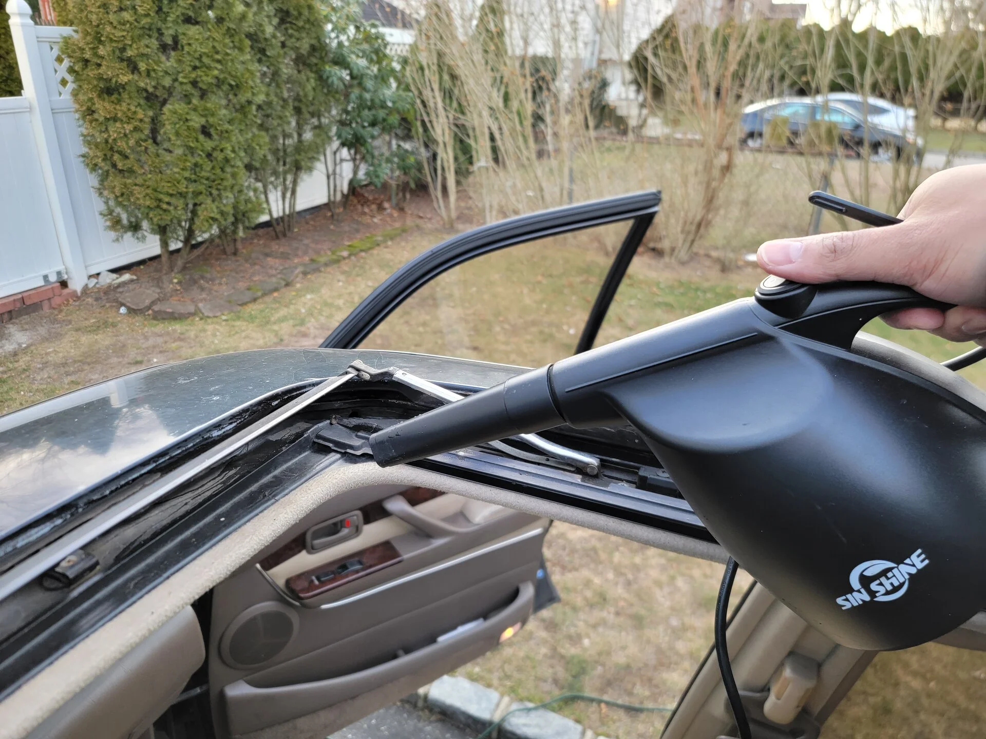

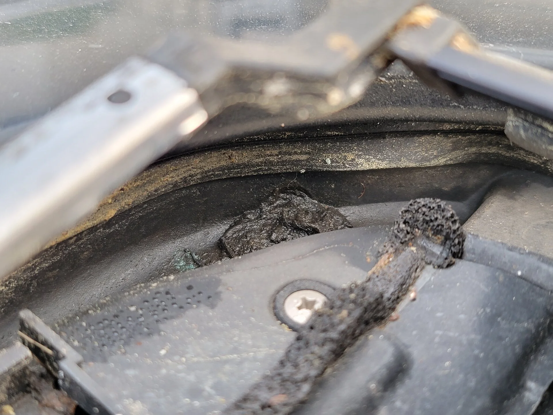

ok! I didn't have time to get started on the wheel bearings but I did get to find the clogged sunroof drain and unclog it. It was clogged by fallen leaves.
My drain plug openings looked just like yours! It was a sludge/mud mess! They're free of dirt all the way down...I haven't had any seepage into the cab/floorboard since Saturday. Bonus...my sunroof is fully sealed now!

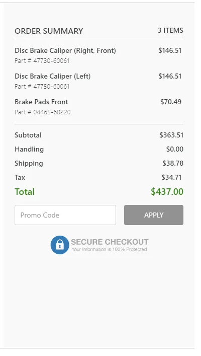

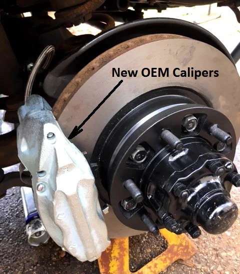

2 new front calipers $366.00 to my door. That's a pretty good deal.

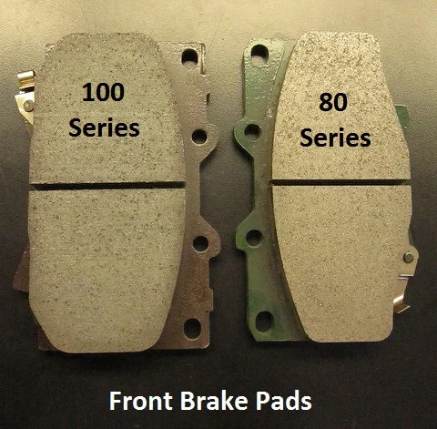

100 series front brake pads will fit on our 80 series but don't put them on expecting improved braking. IF there is any difference...it isn't noticeable. What IS noticeable (to me) is longer pad life, since they are thicker than 80 series pads. I do use them on my 80 series for that reason, but also because I only have to keep one type of pads on hand for both my 80 series and 100 series.
It rained a few nights ago and the day after I checked my carpet and it's DRY!

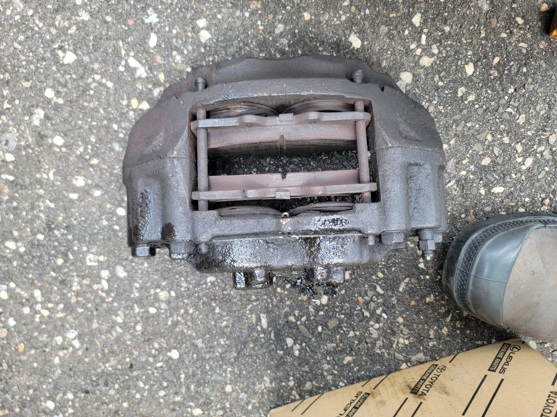

Awesome! I'll save these to cart. Did you have to disassemble the caliper and lubricate the pins or are they already set? That's a nice wheel hub. Did you coat it with protectant or is that from the dealership?

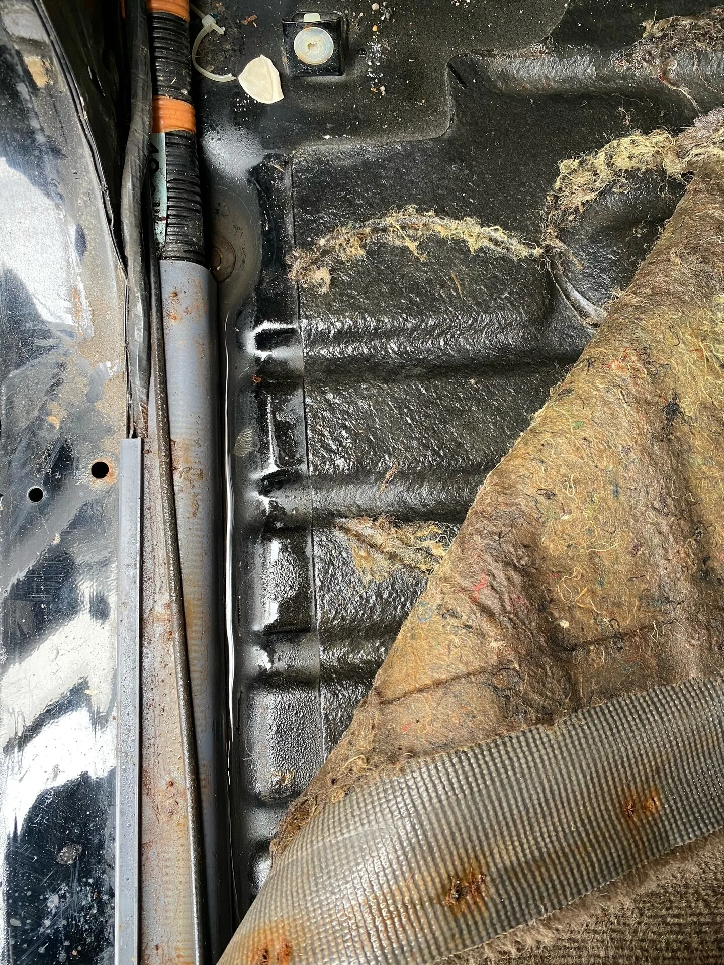

Here is the driver side floor. It's very damp and there's a puddle of water at the edge where the door shuts closed. From reading the other thread on here, it sounds like the sunroof drains are clogged. As soon as the temperature rises back into the high 40s, I'll go and inspect it.

This was a super helpful post - thank you! I am in the process of swapping out my stereo and pulled up my carpet to find this wet and rusty (bummer). I guess I need to add this to the list - was there a mud thread that you found most helpful to clean out the sun roof drains?
yes check out:
Post in thread '1997 FzJ80 - Let's Begin a Baseline!' 1997 FzJ80 - Let's Begin a Baseline! - https://forum.ih8mud.com/threads/1997-fzj80-lets-begin-a-baseline.1288374/post-14833783
@DirtyPepper details out his ordeal with his sunroof so I checked mine out because the symptoms looked similar to mine.

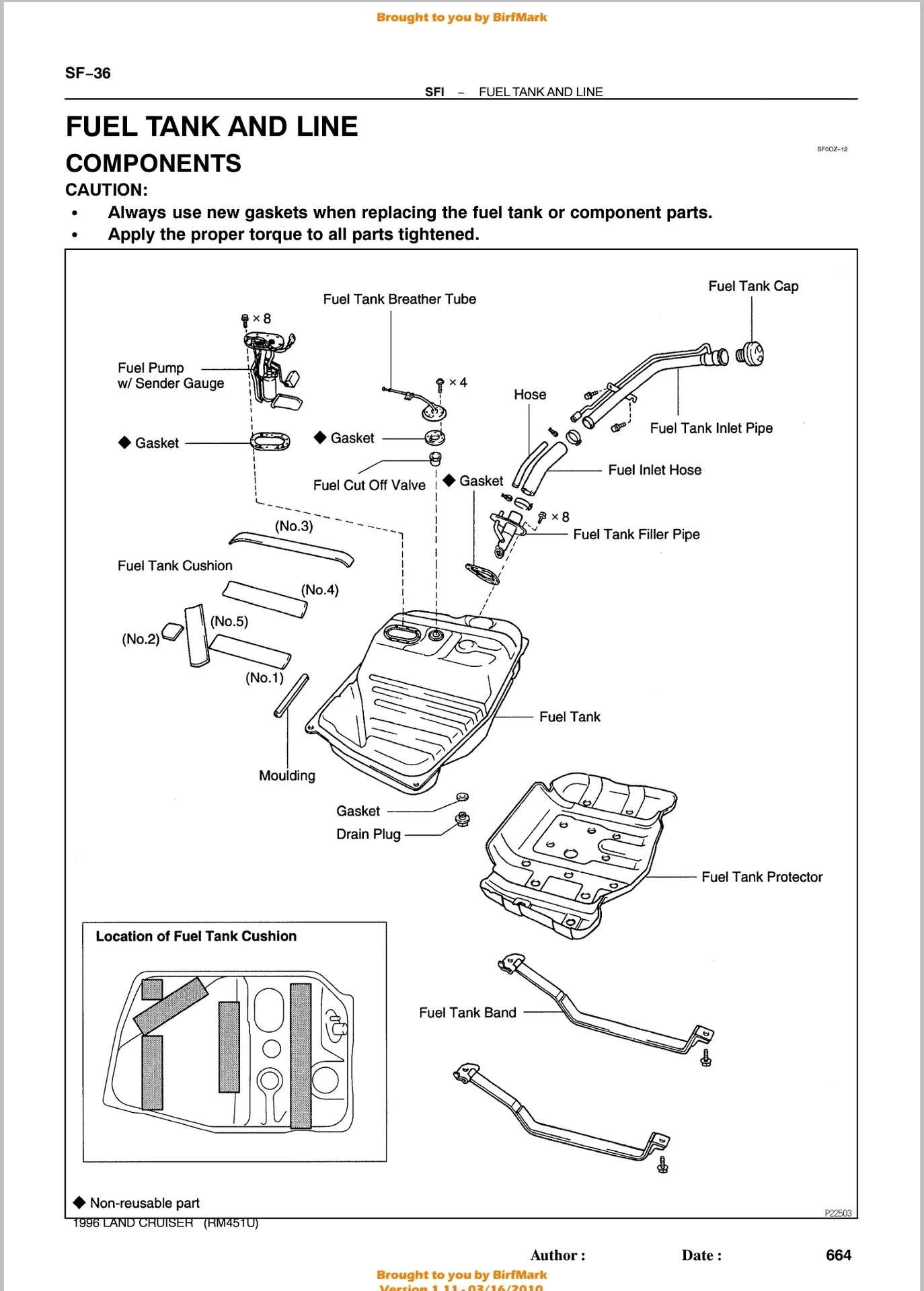

While I wait for the new brake calipers to arrive, I want to revisit an issue I've been having with my fuel tank. It is overfilling. The gas pump doesn't shut off when the tank is already full. By the time it stops pumping gas, there is already gas dripping down onto the ground.
What are some ways I can start diagnosing the issue? I have the FSM and was thinking to use my smoke machine to find a possible leak but I'm not sure which entry point to start at. I was thinking I could start at the return hose from the charcoal canister and see if there is any leak coming out of the rear, but it sounds like I'd have to open the valve but I don't know how to open that with the engine off.
I could also start to perform the EVAP tests on the FSM starting with checking the ports of the charcoal canister then going to the VCV port to test the TVV and VSV function.

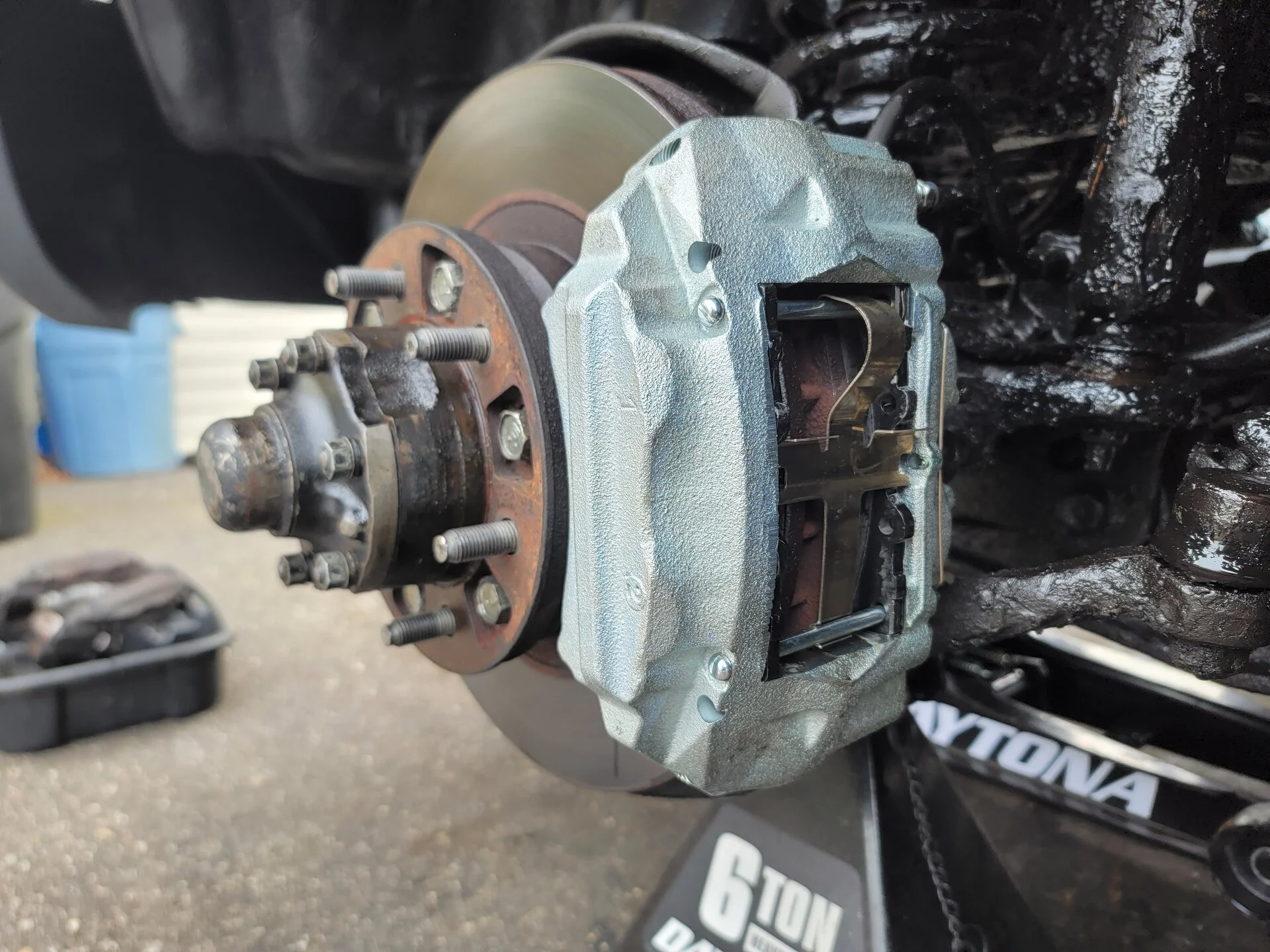

the New calipers I got from McGeorge toyota arrived yesterday and put them on today. It was actually not too bad of a job. I didn't get to finish bleeding the brakes though because of the weather but I think I need to put some Teflon tape on the screws because I can't hold a vacuum around the threads. I tried putting some brake fluid around but it didn't hold once I loosened the bleeder screw.
I ended up asking my brother for help to bleed the brakes the old way. It's a lot faster.
Up next is taking it to a shop to get the fuel leak diagnosed.
