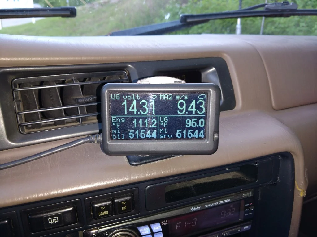

You may want to get a UltraGauge so you can continuously monitor most of the things going on with your truck. (Not transmission temps though)
I have one and I monitor alternator output, engine temps, and O2 sensors most of the time and I can diagnose an issue before it's a problem.
Oh, that's on my list...I really like that set up but it's $150 I can place somewhere else right now...so, it'll probably be a VDO type gauge for the time being and then update to that lovely little gem of a tattletale.
Did you place yours at the steering wheel or in the dash spot where the cup holder is (in some of the 80's)? I've been told that small little pocket just above the stereo is perfect for that gauge.

I plug mine in on the fuse panel by your left knee (modified the plug so I could still use the cover) then run the cord over in front of the clock.

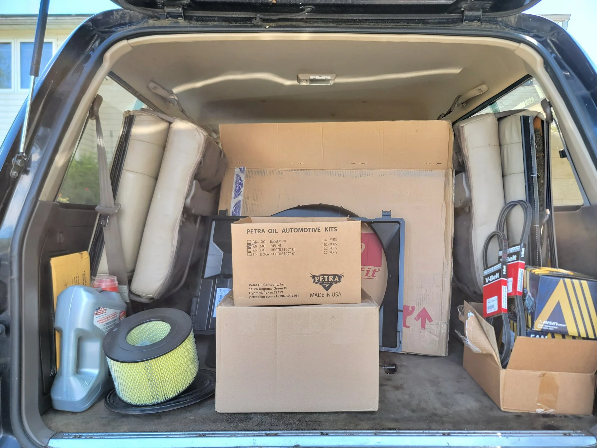

all the parts for the baselining (aside from maybe pulleys) are in the trunk. time to take the engine bay apart. 😚

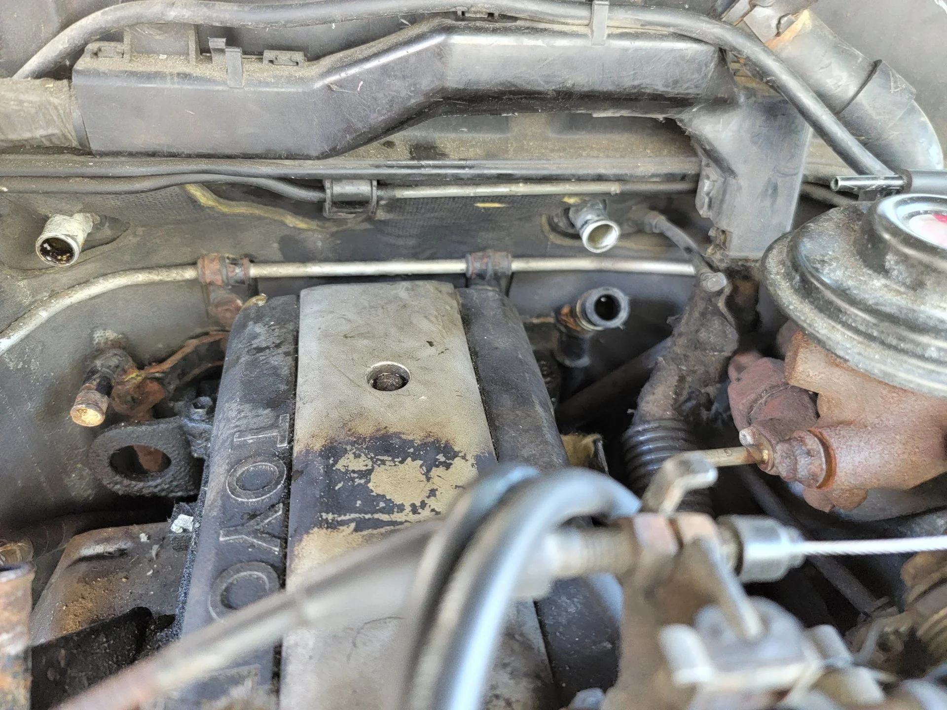

ok so I connected a new heater control valve, and new gates hose from heater control valve to the driver side front port and then the passenger side front port over to the hard pipe running along the engine block. that essentially does the rear heater bypass but I didn't put Clamps on them because I will be removing them again after a few more cooling system flush.
I screwed the wiring harness to the firewall, reconnected the egr modulator and made sure the vacuum hoses are back, I reconnected the air intake tube to the throttle body and the maf sensor is plugged back in.
now when I turned my key to the ON position, I noticed that my fan is not turning on but my rear heater blower is working fine. I also noticed that the head unit is not turning on either when it should be turning on automatically.
when I tried to start the car, it would crank but would not turn over. I tried to jump the battery, but it didn't make a difference.
any clue why it won't start?
You disturbed the wiring harness near the EGR. I'm guessing you have some bare, broken, or melted wires in there that you were unaware of.
Then, as you tried it you may have smoked one leg of the fusible links.
Do you have a CEL with the key in the "run" position? If not, then it will not start. You will need to diagnose what happened.
Did you get the harness plugged in on the MAF on the intake tube?
Double check all your plugs and wiring connectors.
Did you do the PHH? It's possible that you broke a wire on a sensor near that under the intake.
oh I'll check the wiring harness behind the egr pipe. those didn't look so good to begin with. I'll take a look at the fusible link. I plugged the maf sensor back in because that was the issue I had last time it didn't start. I haven't done the phh yet.
I didnt get a CEL which would've been nice to figure out how to diagnose the issue.
