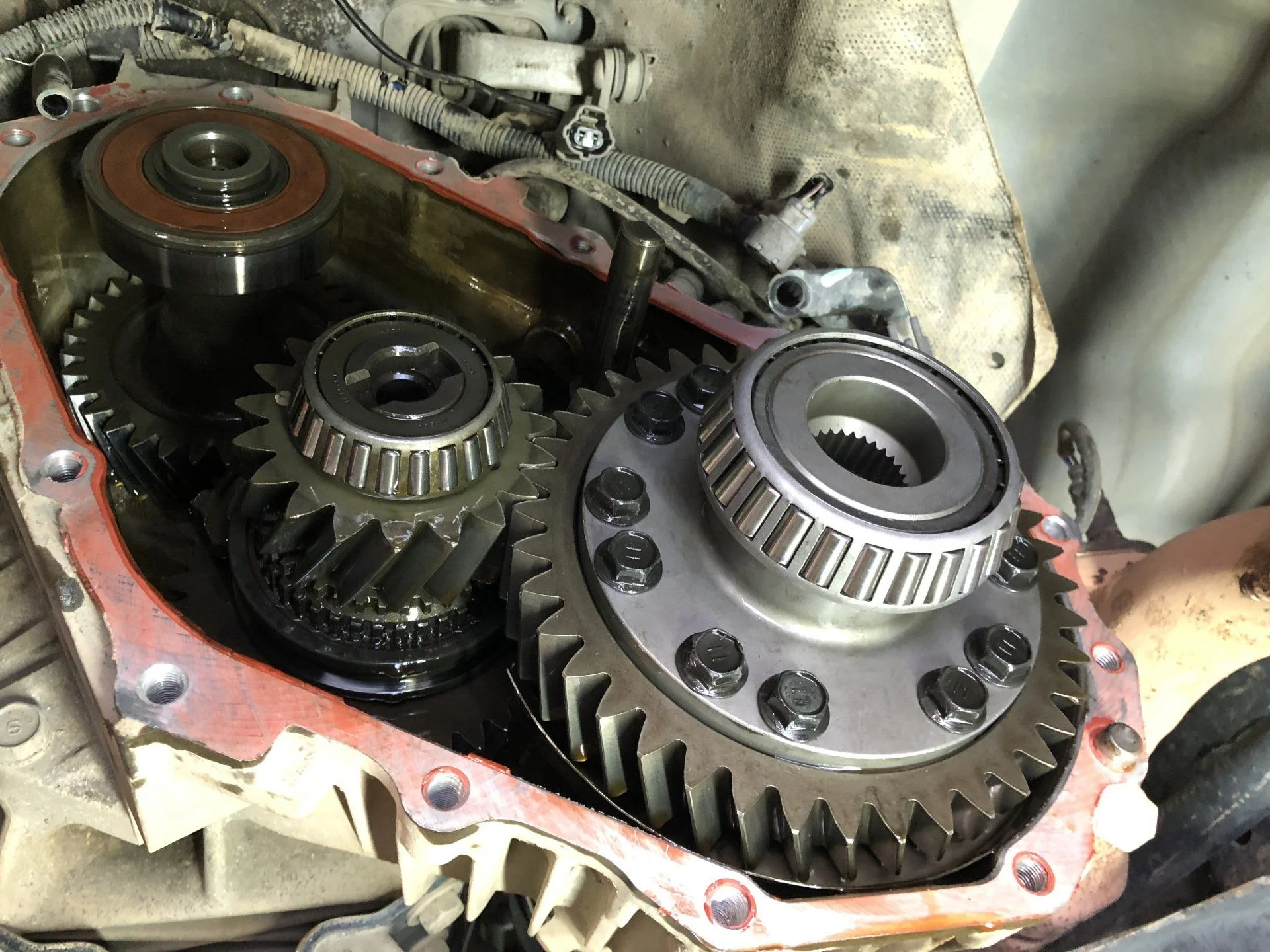

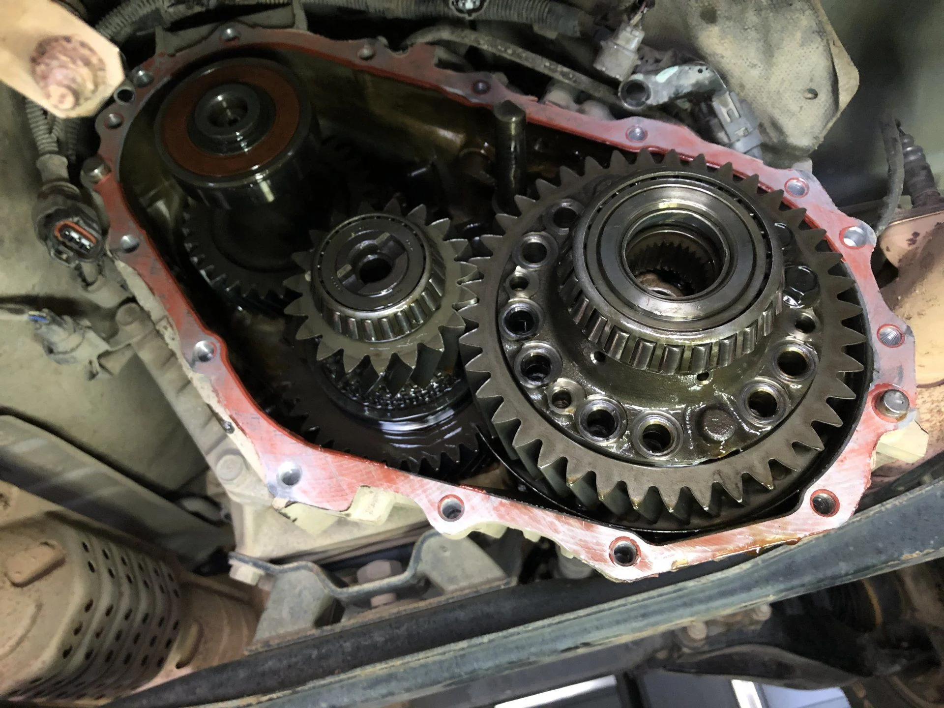

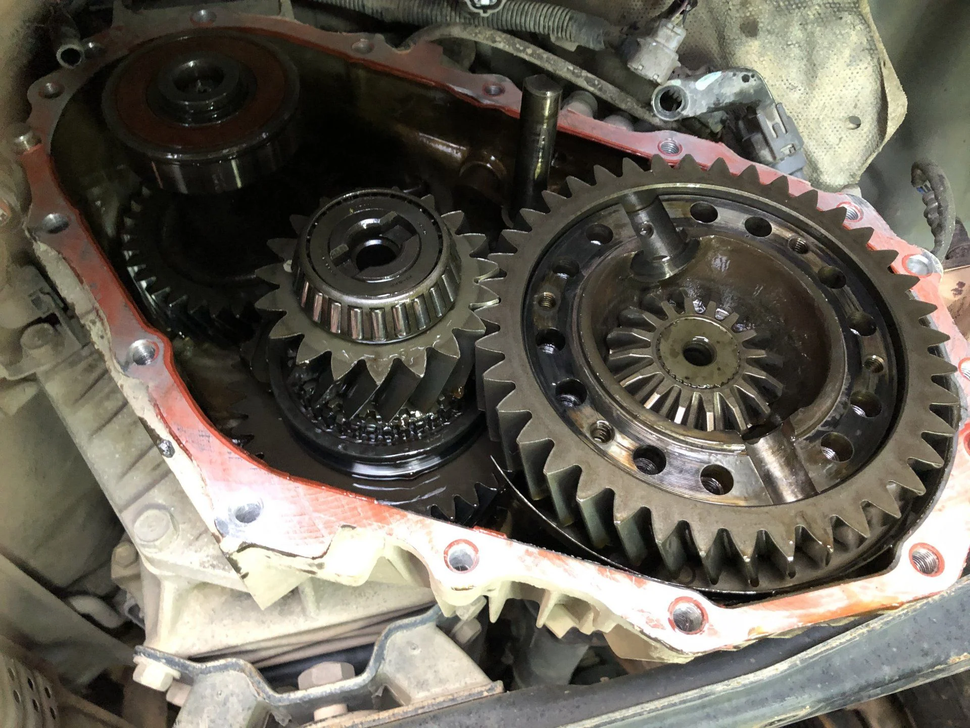

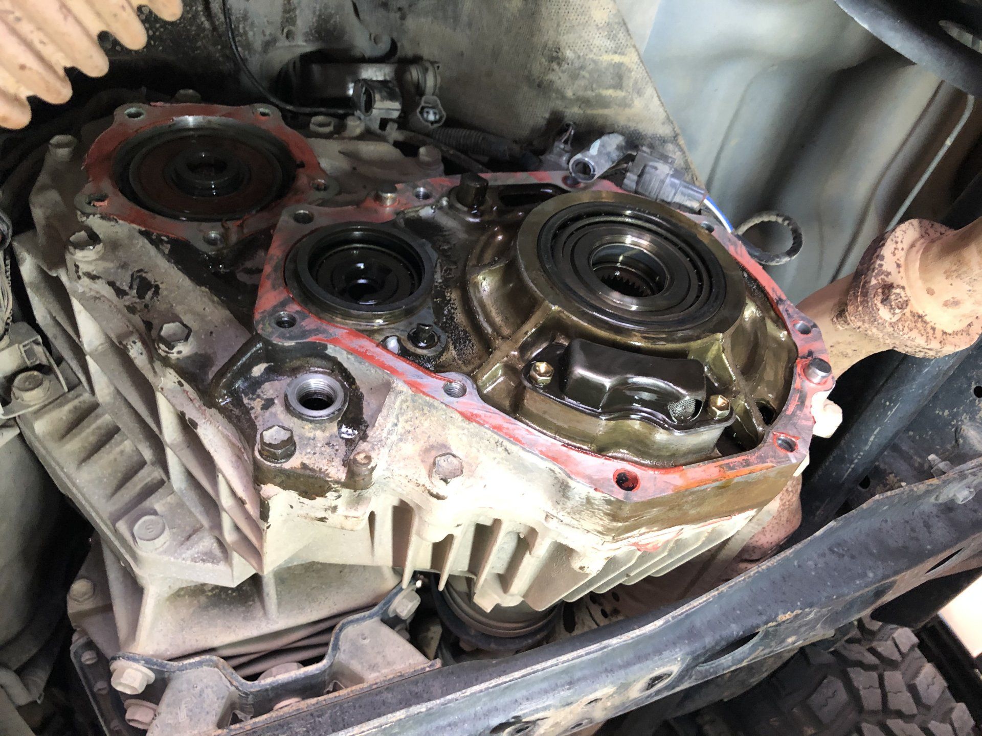

1,000 Mile Update
The truck is so much smoother. P-R R-D there is no shake at all. I'm religious about greasing the slip yoke, and before it wasn't too bad...but now there is nothing. It's shifting up much sooner and holding gears for longer. I'm shocked, my mpgs are up 1.1-1.3 over the last 1,000 miles. This is a great mod for people who live in mild climates and use their trucks 98% on the pavement.
The spool install was a very fun project. Tricky in a couple spots. I would imagine this is a little easier in the 80 series without the y pipe in the way there.

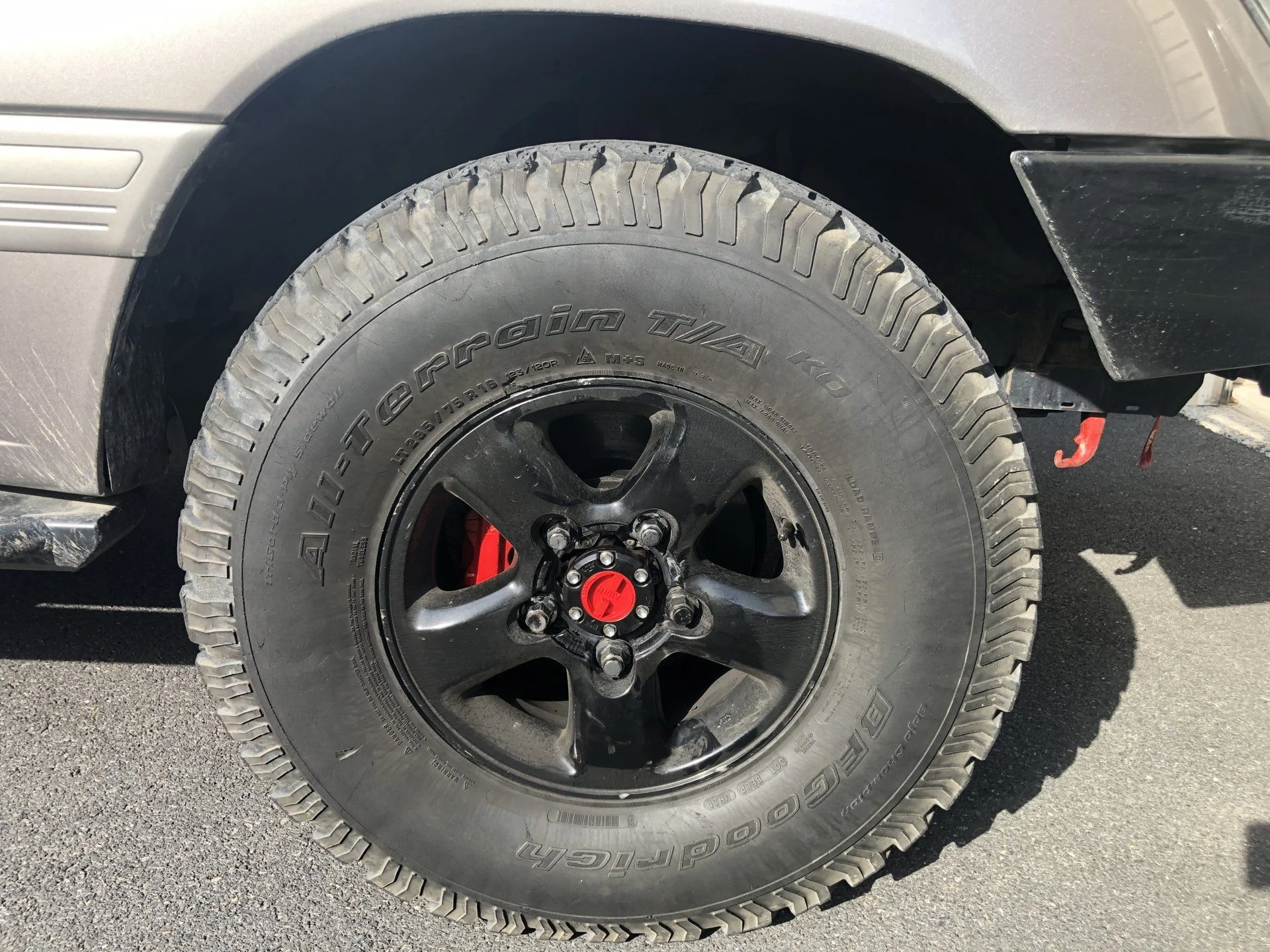

Sell (or may be return) your front hub flanges and replace them with the locking hubs!

For me I have been happy....also who doesn’t love these blingy gold hubs 🤤
