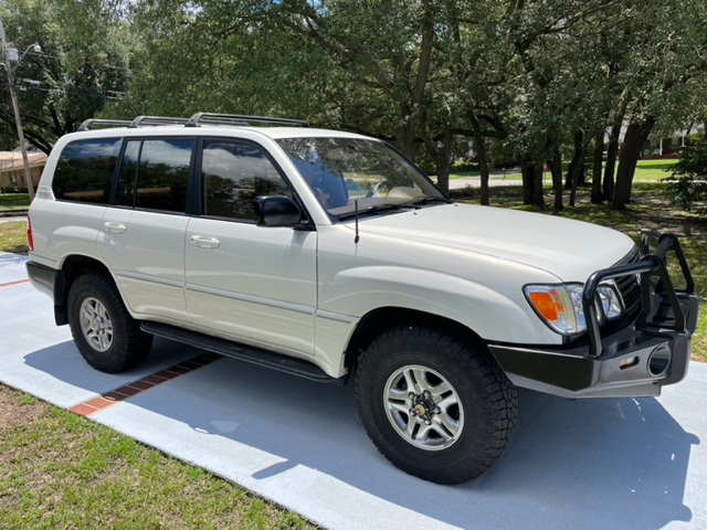

Installed.
As others have reported, there is a subtle lightness to the steering and the driveline is smoother overall. Very happy with the new set up.
The Aisin hubs are great. They really set this kit apart from any other.
I've driven this truck for the last ten years, and 100K miles. The part-time conversion was on my to-do list to get it ready for the next 100K.
Thanks to @cruiseroutfit. They were great to deal with.
Update 7-27-22: I'm @ 200,000 miles and I'm still loving the part-time kit. Doing 75-80 MPH on the highway is a dream now. I didn't realize how much vibration I was getting from the front driveline. Doesn't feel like I need a 5 speed gearbox anymore. Super smooth.
