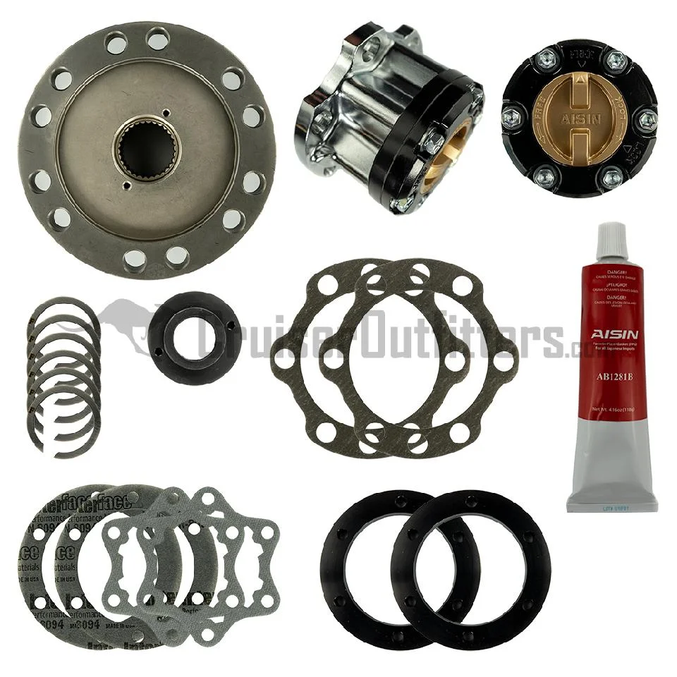

Kurt- Got a dumb question: With the spool installed, the CDL button becomes the 4WD on/off switch right? So if in the rare case the switch or actuator fails somehow- no 4wd? Got another dumb question: Are there any other operational concerns to consider- say like the Mrs. is driving the truck and inadvertently pushed the diff lock button while the hubs are unlocked- what happens?
If you did have a switch or actuator failure, you would would have 2WD only. Fortunately it's not a failure we see/hear about. As for the engaging the front half of the t-case while driving... exactly the same as doing so in every 4x/5x/6x/7x, if you're moving slow it's not going to be noticed, if at highway speed it would be trying to match the front and rear output shafts which will be noisy. Just like trying to shift from H-L while moving. Just don't do it :D

I know quite a few of these have shipped. Let's see some installed pics! :cool:
well, I can report back on mine, everything is working as advertised, there is a little gear whine from the 10% under drive gear but that is it. my mileage went up a little maybe if you are concerned about things like that..

another addition to the list, just changed the gear oil in the t-case and the gears are getting quieter as they break in.
I installed my part time kit alittle less than 2 weeks ago. I could not be happier with the results. Truck rides even smoother. Gas mileage has increased a bit too. More miles will tell how much better, but even bit helps.
