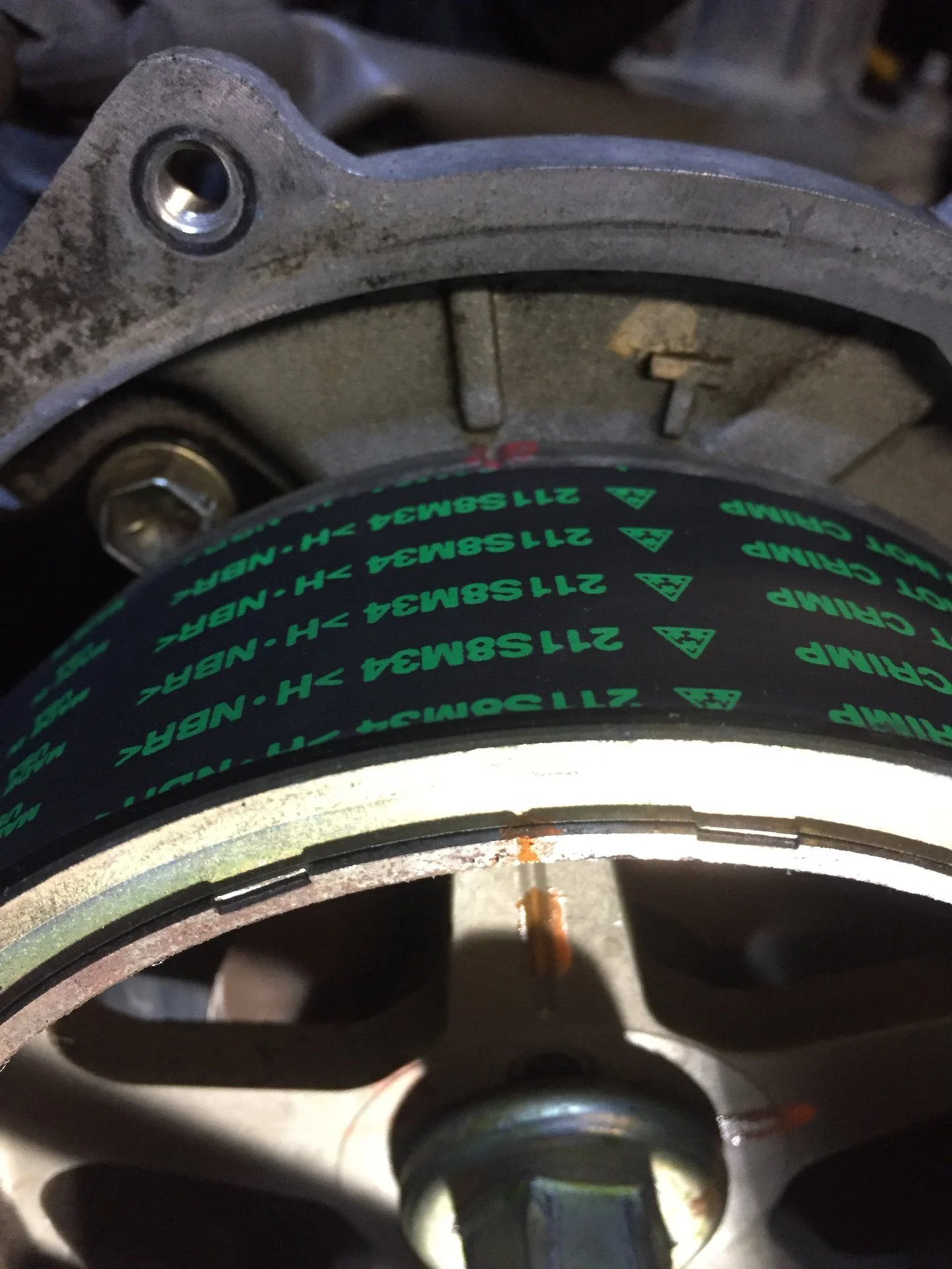

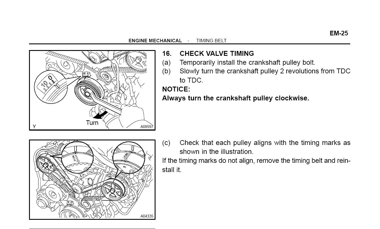

is there a way to confirm my engine is still timed before replacing this sensor? is there a marking somewhere or a method to determine this? the concern being it may have slipped a tooth.
Yes- remove cam covers- remove the accessory/serpintine belt, turn crank pulley to the 0 zero mark, and the small dot on the cam gear should line up with the hash mark above the cam gear. It sometimes takes two full revolutions of the crank pulley to get the cam gears and the timing mark at zero on the crank pulley to all line up.
