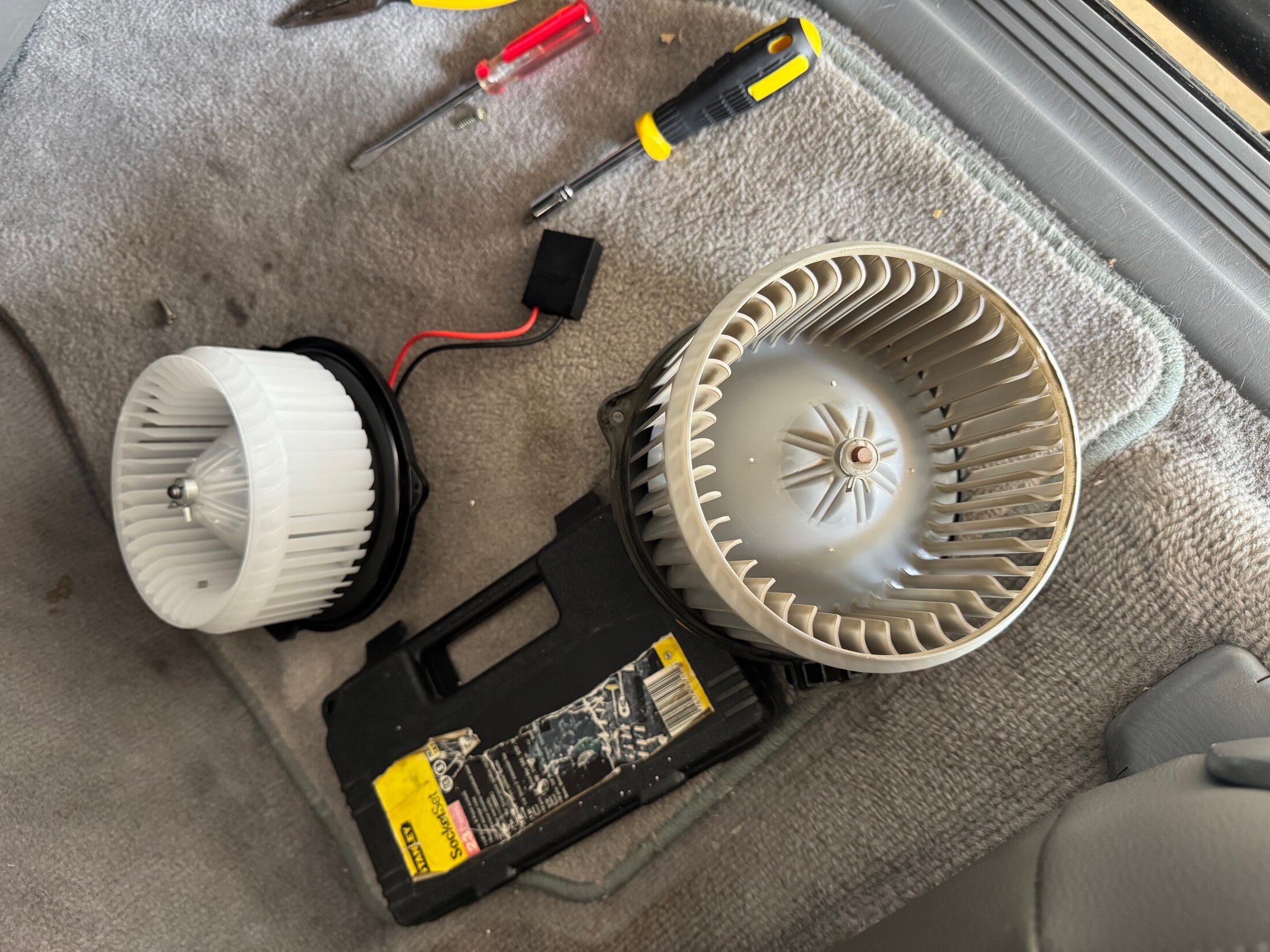

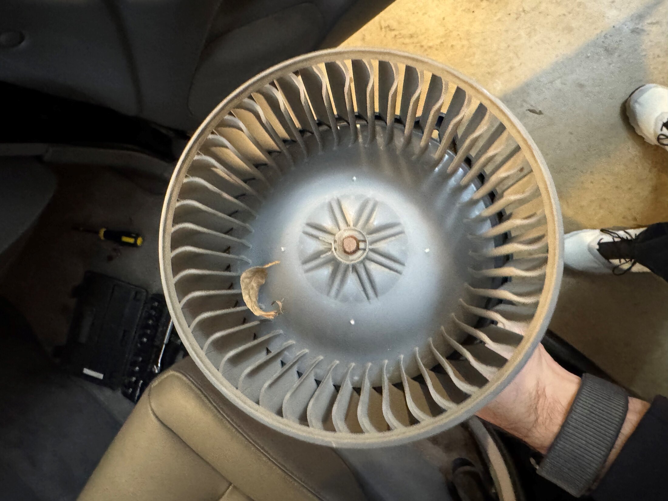

So about 2 months ago, I began to have the "tiking" from the AC blower. So...I took off the blower and cleaned it out (picture 1, leaf can be seen). The ticking stopped...but then it started chirping. So, I decided to go non-OEM and get one off the Bay, AC Blower motor that fit my truck. It was a simple DIY unscrew, drop the old one and put the new one in its place. Took me 15 minute tops.

so strange !! i had the same issue. clicking issue from the blower motor, cleaned some leaves out of it, no more clicking but now randomly hearing chirping noise - which is even more annoying than the clicking !!!
The chirping was intermittent after I took the leaf out...I heard it a couple times even before the leaf. I think the bearing was going...just the timing. I replaced the blower...no more noises.
I had a subtle squeak from the blower on low, which dissapeared on high. When I pulled the blower out I could see a light contact mark in the housing from the squirrel cage. Bearings in the motor seemed fine - no end float. RHD fans are expensive, so I packed the blower mounting flange out with a thin layer of closed cell neoprene foam (similar to this NIT686-5 | Nitto Black EPDM Rubber Sheet, 1m x 500mm x 5mm | RS - https://uk.rs-online.com/web/p/rubber-sheets/2027911) and the squeaking has gone. I'm sure I've reduced the blower efficiency by 3%, but I'm okay with that for a free fix.

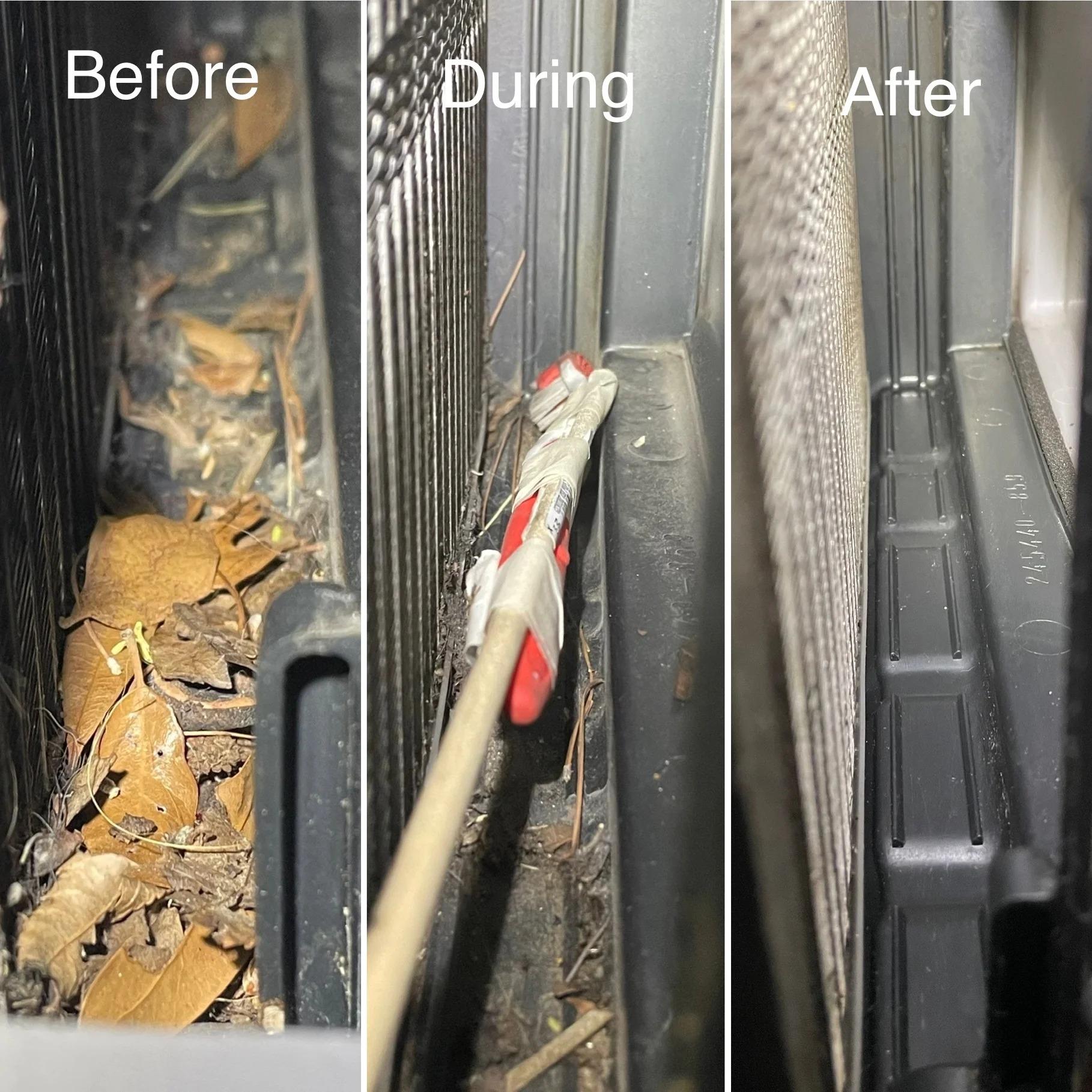

Here is a sample picture of that condensation catch basin before & after:

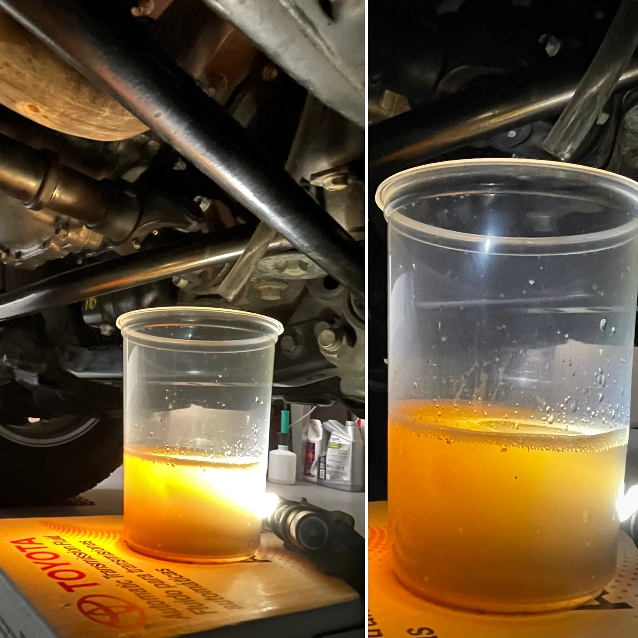

Collected water from the drain under the front passenger side floor:
