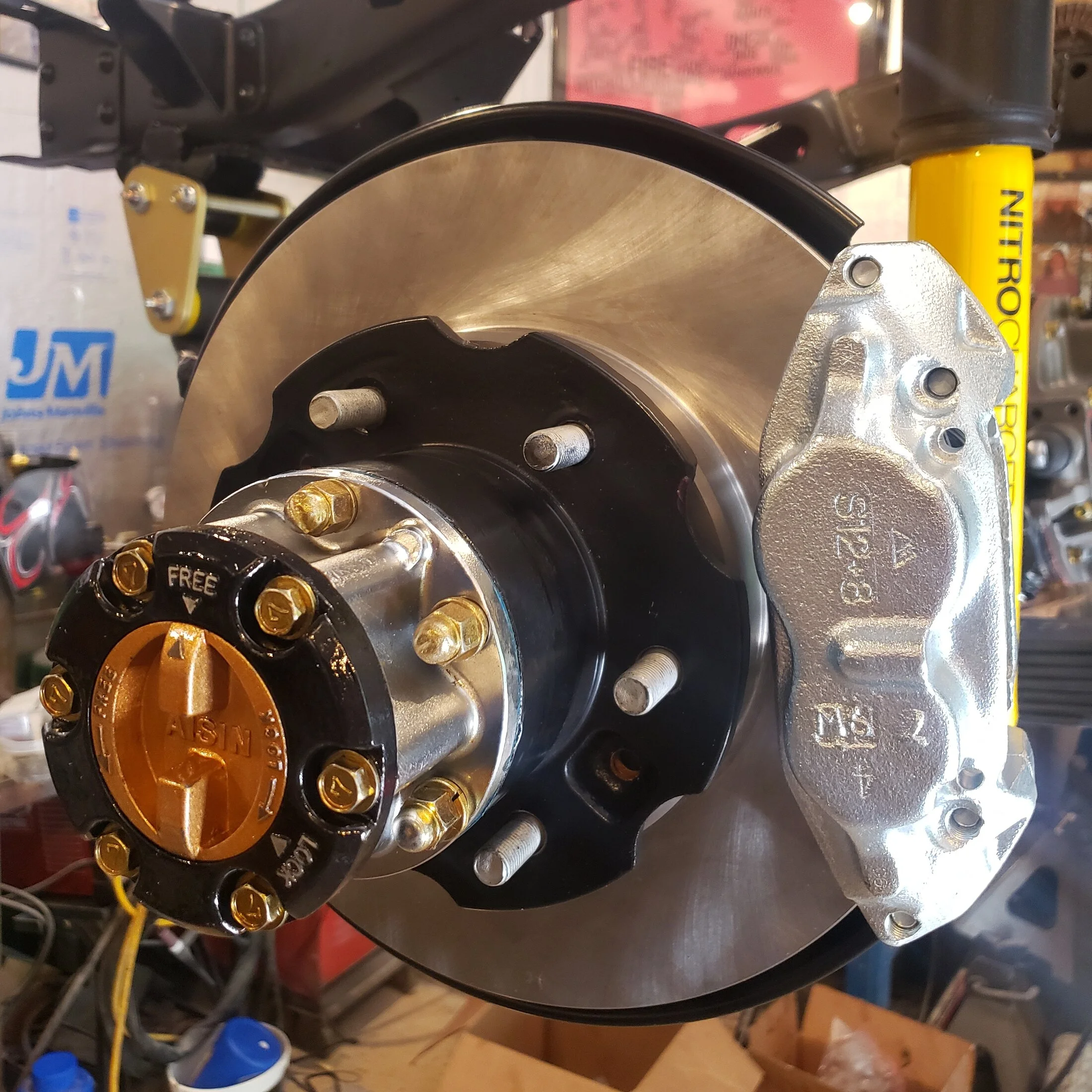

Besides all of the tools for the job, it is worth noting that it is an excellent time to make it all pretty as well. You can scrub the knuckles with diesel fuel, or in a parts washer, then wipe with thinner and paint them semi gloss black. New Aisin hub bolts and rebuild kits are available from @cruiseroutfit to make your hubs look great. New hub mount studs and bolts/washers are available too for cheap. With the hubs apart you can clean up the aluminum body, paint the black outer ring, and do the gold (or red) on the dial handle. That with new bolts will look great poking out of the wheel centers. You may have already thought of that, but it's good to have your items ready.
