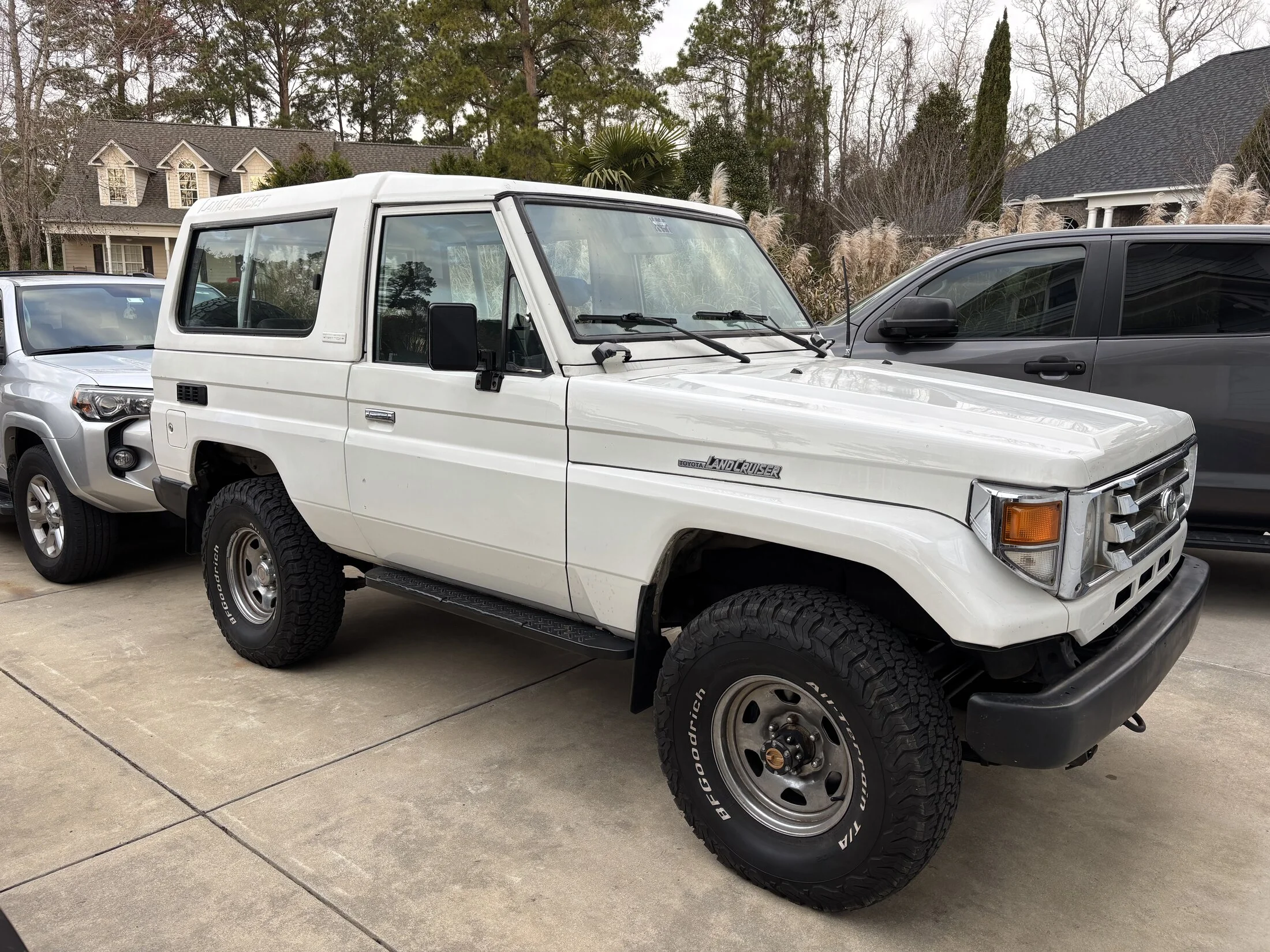

Hi, picked up this FJ73 to go along with our 1977 FJ40 (LilRed on the 40 forum). Have a question hoping some can shed some light on. The transmission shifts fine in all 5 gears while stationary in the driveway while running with the clutch engaged but as soon as I start moving it is very difficult to shift into all the gears? Possibly air in the system (bleed the clutch)? The 73 has great power and drives good with the Holley sniper BUT I must admit that I still prefer driving the FJ40. Anyway, thanks in advance.
