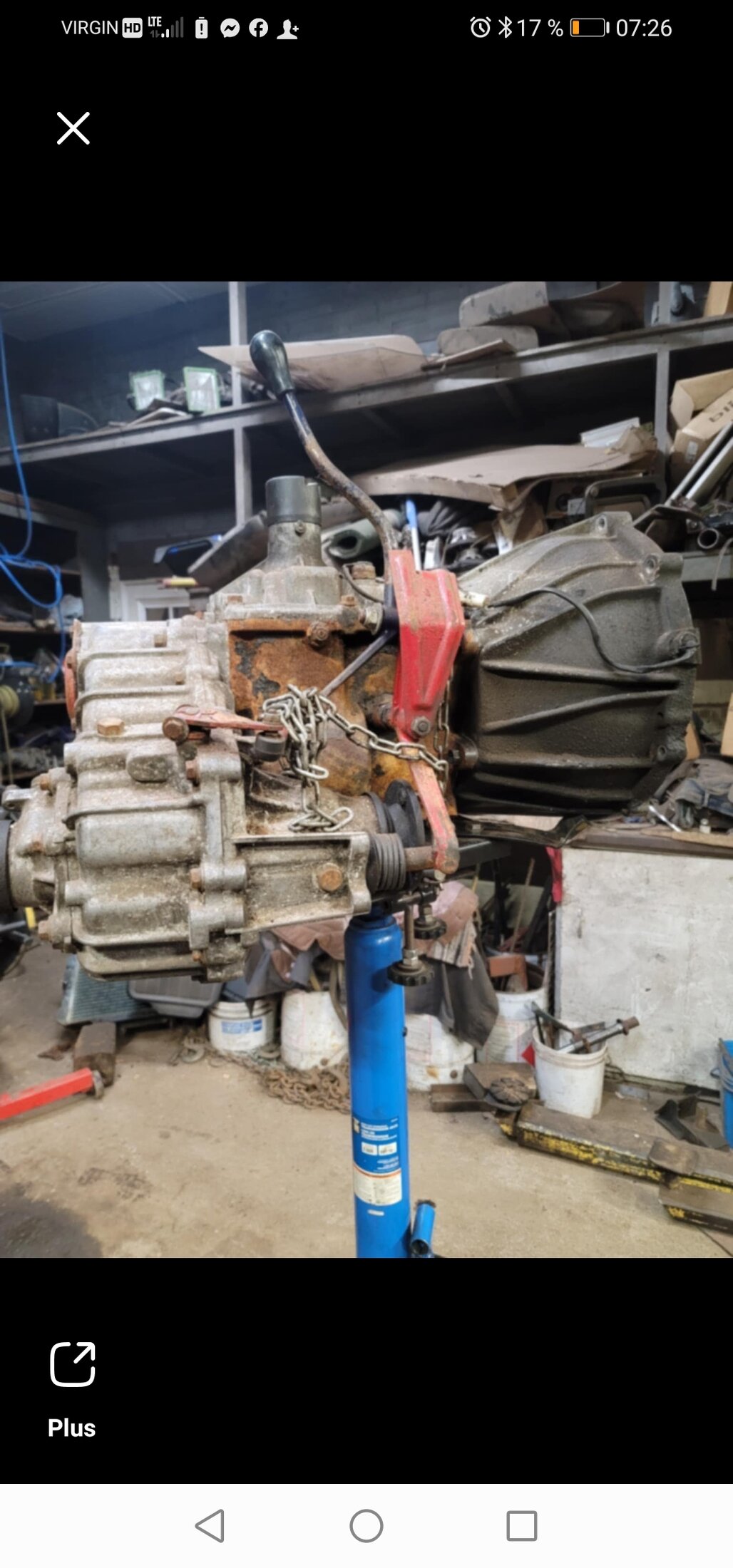

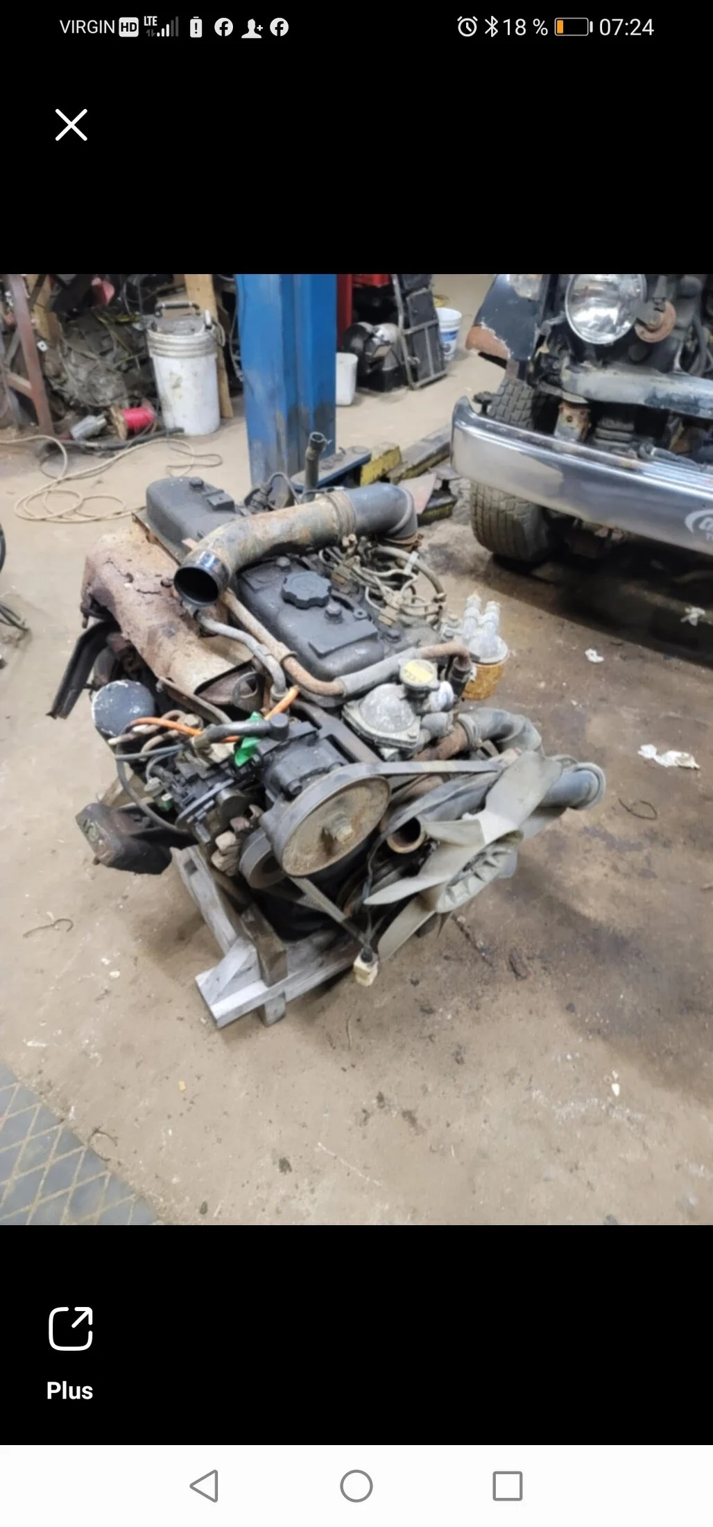

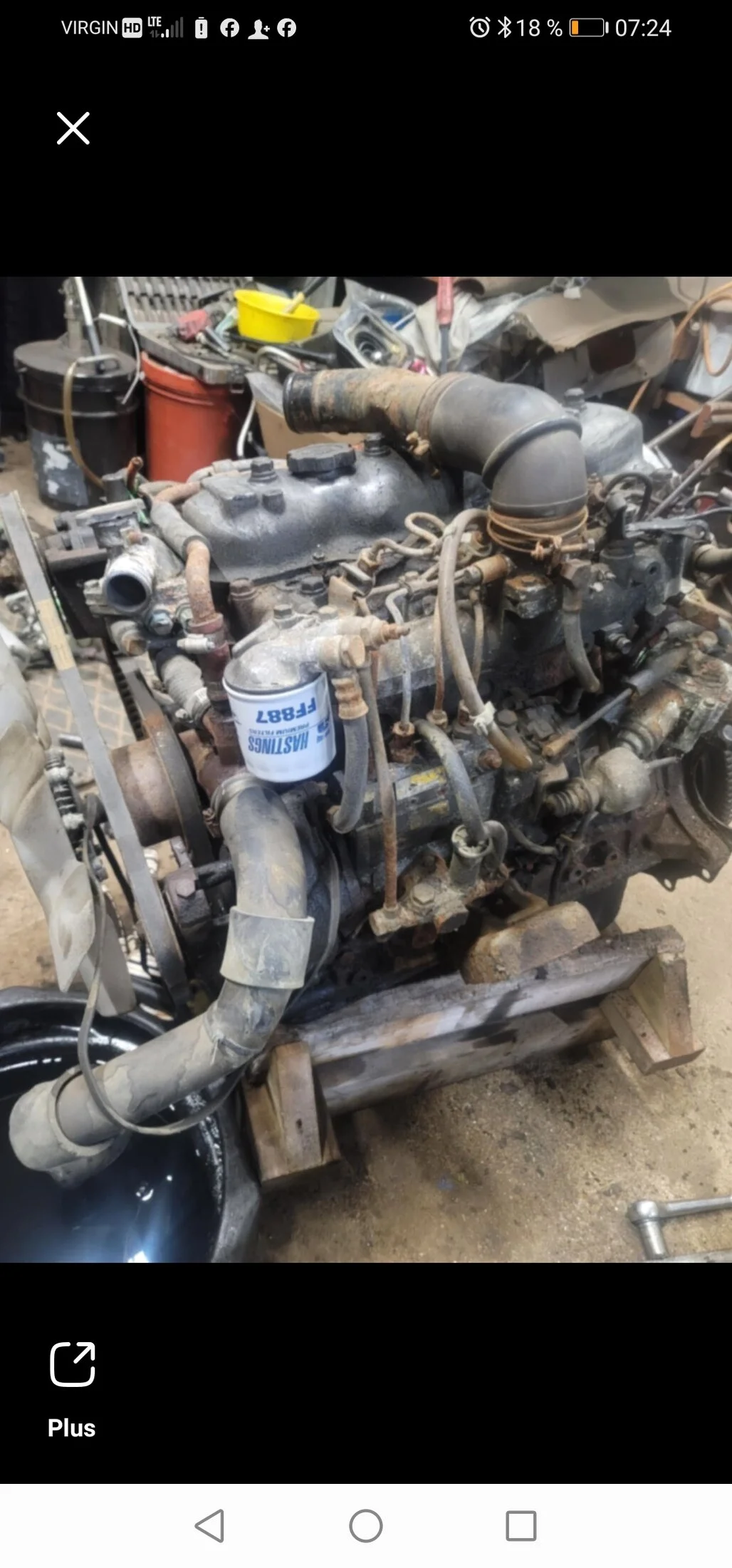

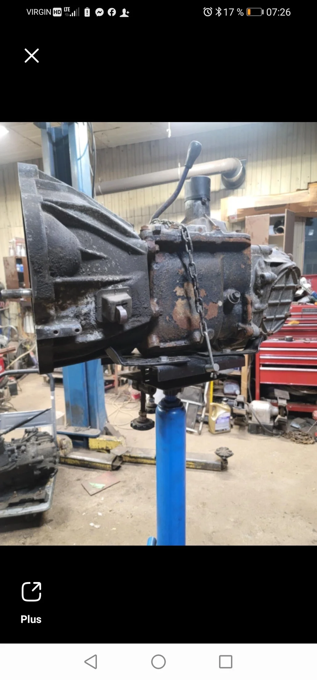

Found a 3b for sale from a 1985 bj70 and it have a 4 speed and a split case , the seller send me pic of it , is it possible or it was swap in the past?

Look like an inline pump like on my bj42

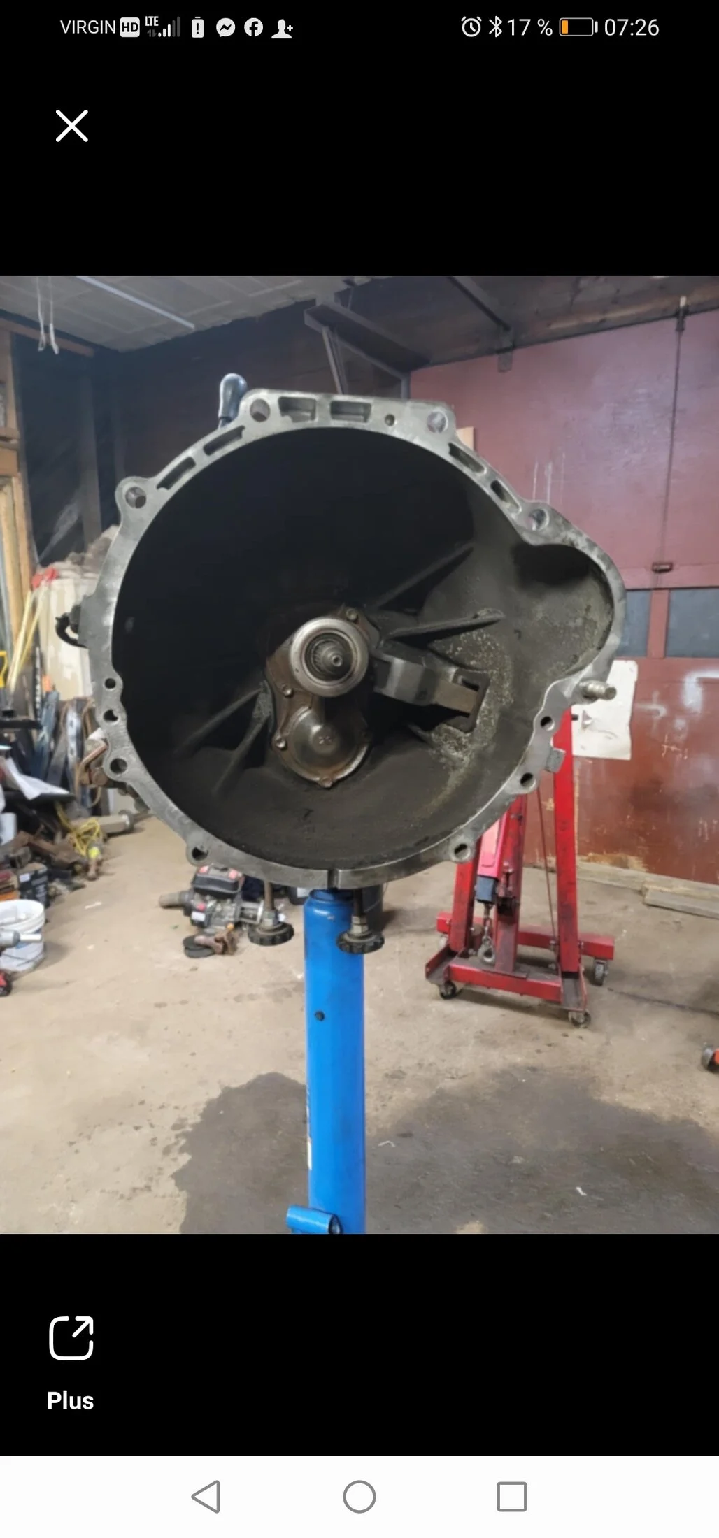

There is some clues tho, the bell housing is an aluminun one which was introduced around 85 in Canada. The h42f was installed behind a cast iron one, the 4 speed tranny was dropped around 82 (BJ60) here in Canada in flavor of the 5 speed h55f.

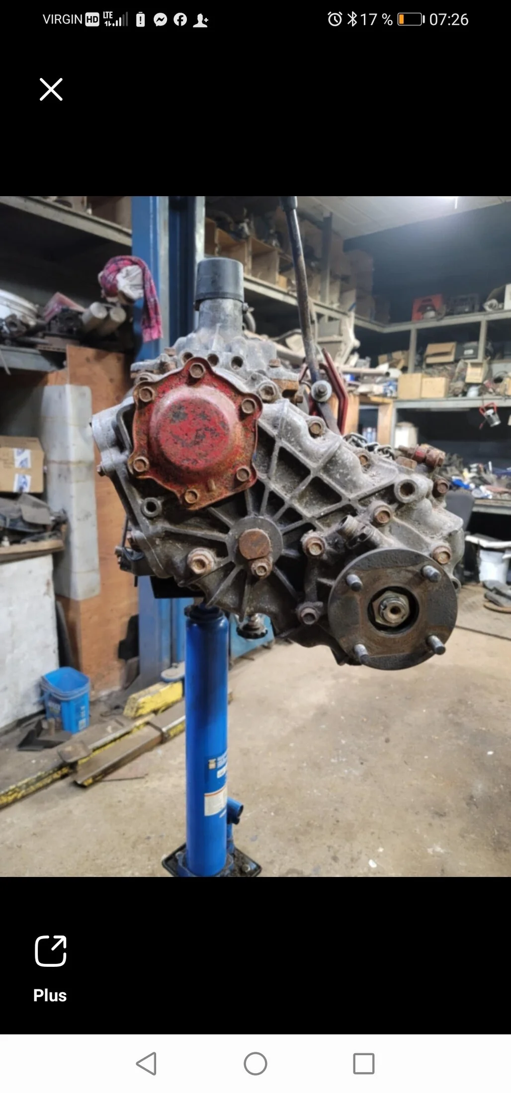

Can you see the identity plate of the donor vehicle? That will tell all.
If not, it could be an H42 from a US model, or an H41 from anywhere else. They both look identical from the outside but the H41 has lower ratio 1st, 2nd and 3rd gears, identical to those in the H55F.
The seller find more info , the engine is an 87 3b with 250k km and transmission t-case is from a bj40 , most likely 81-82 .
New clutch, starter and alternator
He ask 3k for the combo
The engine suppose to run fine, it could be good replacement for my 84 bj42, at about 450k it feels tired and last summer i've found metal from the cam bearing in the oil pan , but keep on driving it anyway knowing i should rebuild it
Transmission and t-case could be use on my 77 chevota fj40 to replace the old tired h42 and one piece case , better shifter location and sturdier t-case .
