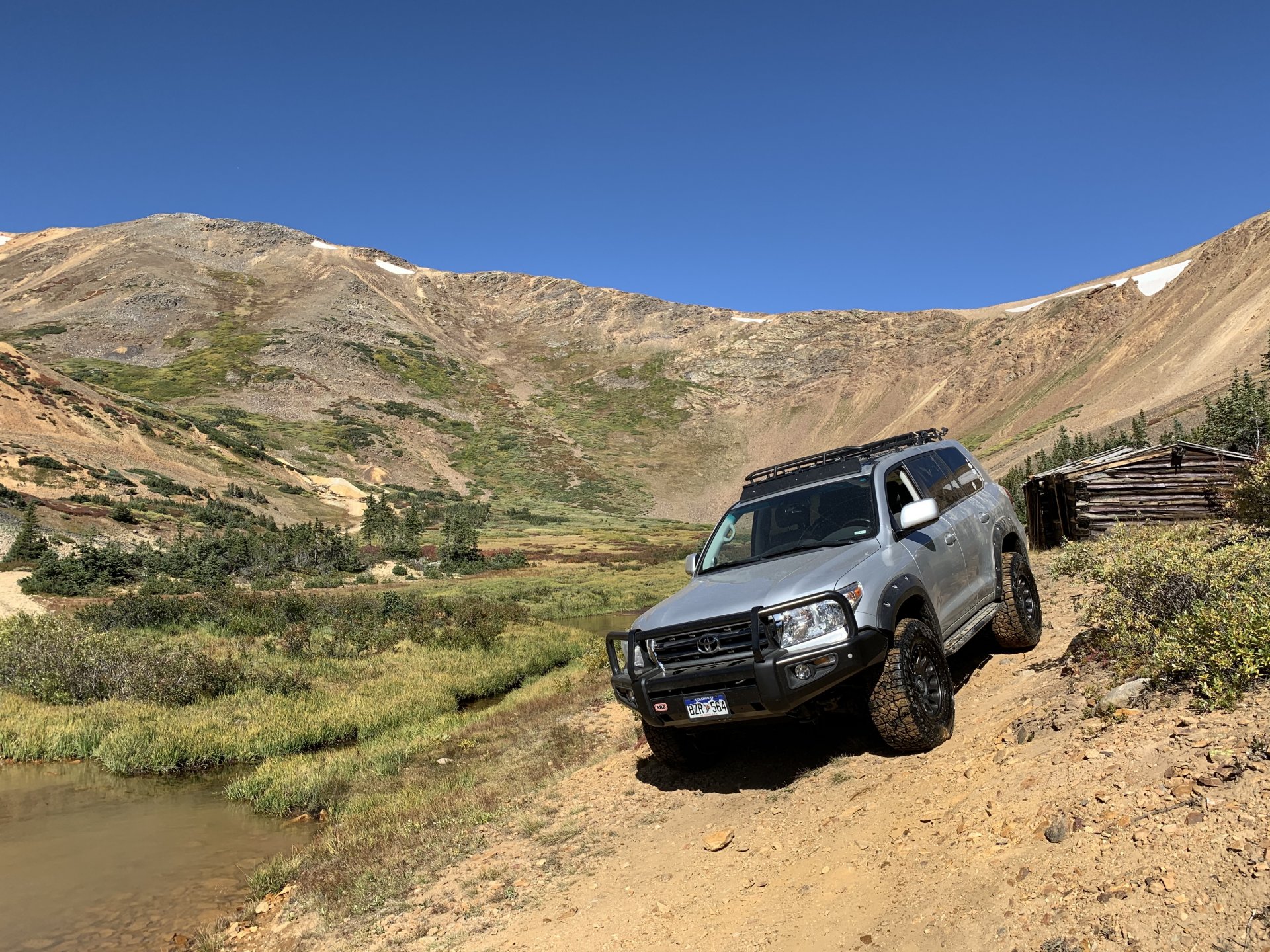

Any chance you have a build thread or more pictures of your setup?
I don't have a build thread, but here are a few pics to show lift height and wheel offset. This is with the King shocks with zero preload (so the strut ring is all the way at the top; least amount of lift). This was before the Tundra IFS and no wheel spacers in this shot, so without the flares, the tires are just proud of the wheel wells (maybe 1/2"-3/4").
Here are two with the spacers installed. Almost exactly the same stance with the Tundra IFS and no spacers.
