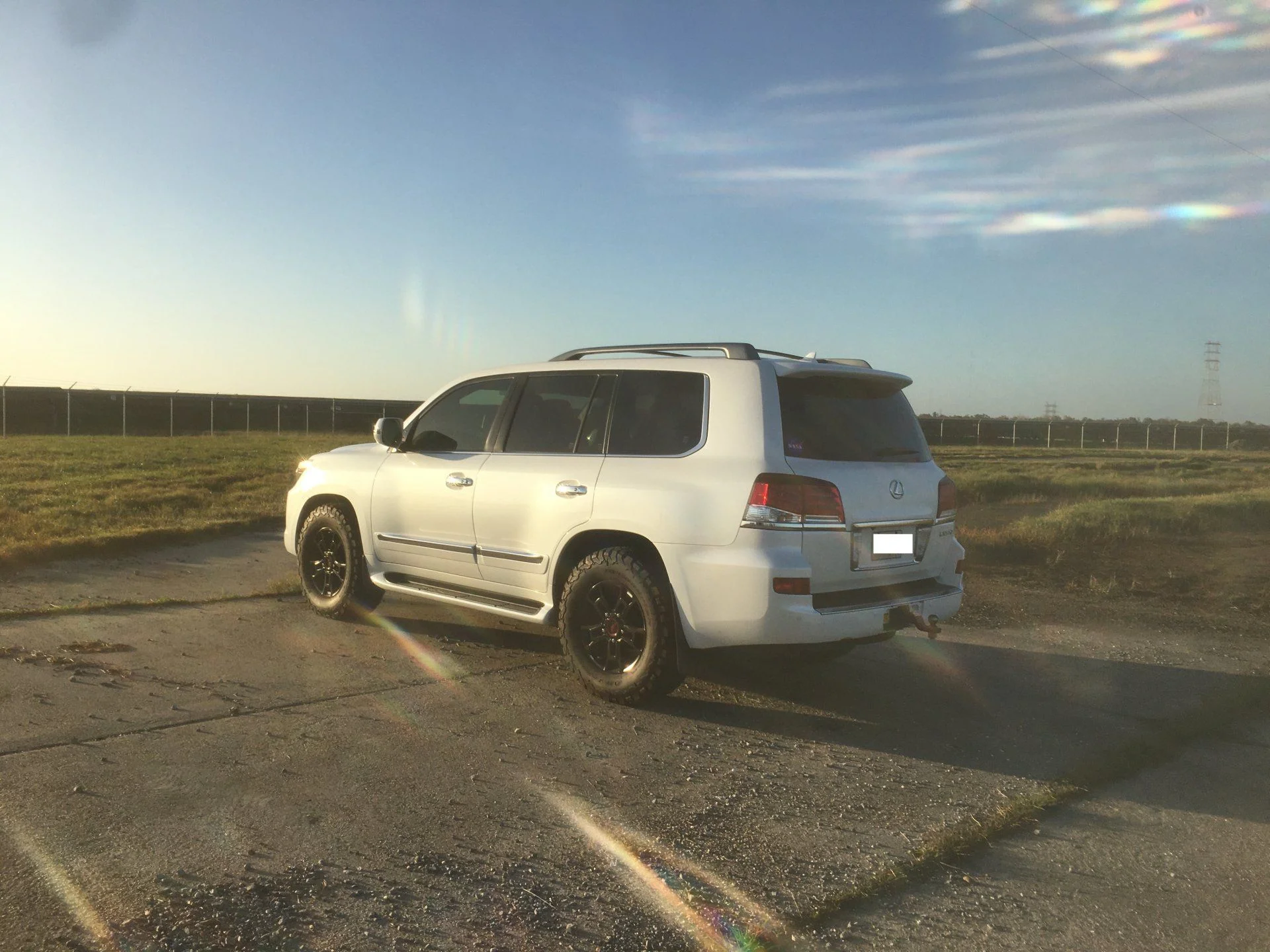

I’m running LT305/70/18 on black BBS wheels, same as your heritage.... so the 65 would be no problemo
