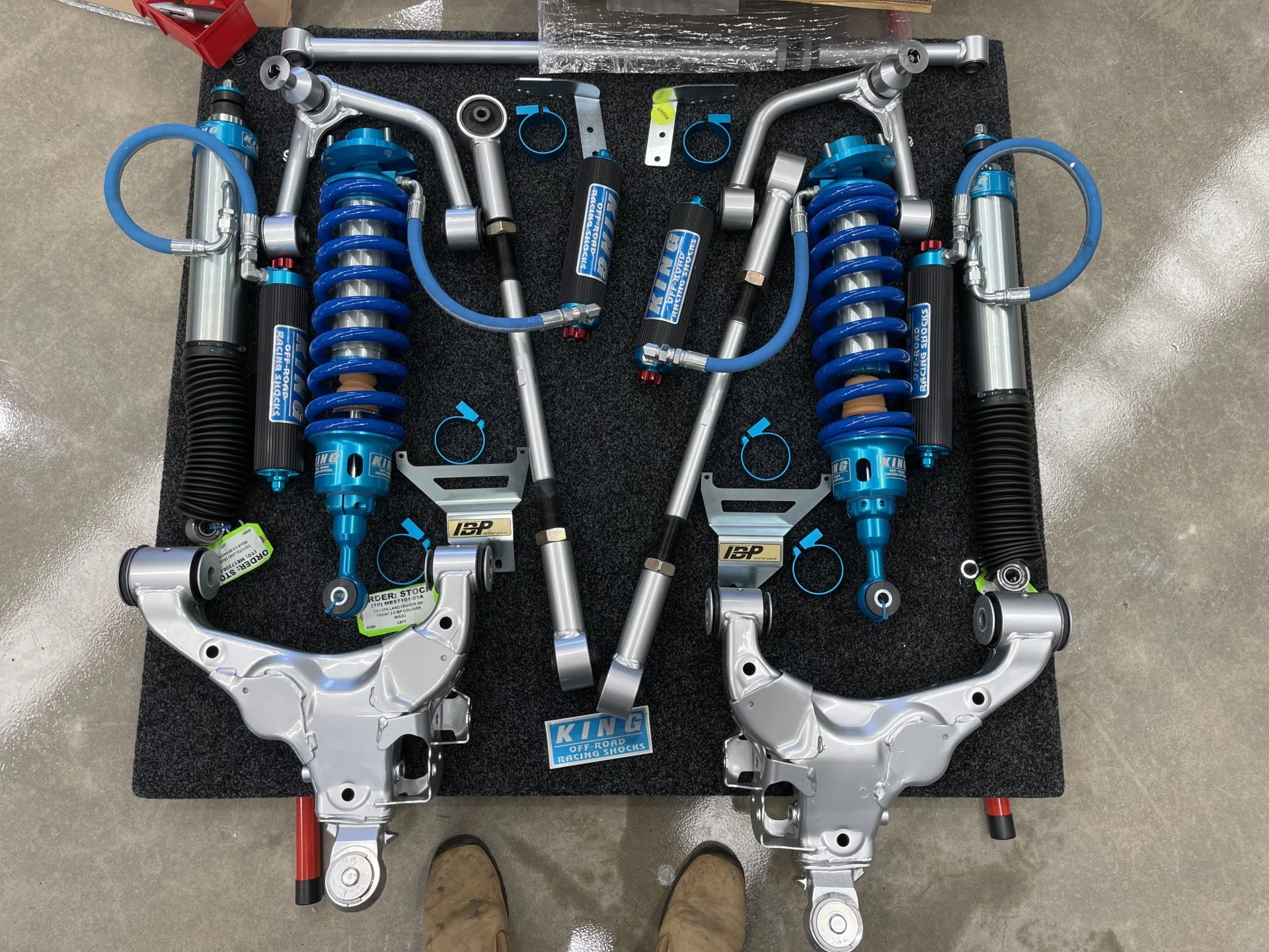

3.0 kings
Internal Bypass front an rear
Electronic Fluid Management
Custom front arms
Adjustable rear lower control arms
Adjustable panhard
Waiting on the APP from Kings. Was finished last week so will be even cooler than the older screen they used to have.
