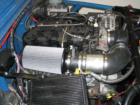

The intake setup - a "Cobrahead" 90 to a standard 90, some 4" tube, then a reducer to 3.5" for the MAF, and an AEM "dryflow" filter - none of that damn oiled gauze... I still need to make a little bracket to stand it off the engine slightly.
