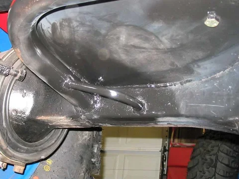

Since there's no way to get an axle strap around the tube on my axles (especially the front), I added these tie-down points. old u-bolts are good for something!

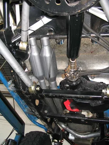

A few pictures of the exhaust work.. a VERY complex system, to be sure, especially up front. The sound is fawking GREAT though.. Deep, rumbly, and nice and agressive when you get on it. Not *too* loud, but you know it's there.
2.25" pipes through 2 Hushpower II mufflers (17" case), into a 3" collector, then out a :bling:stainless steel tip that they had basically installed before I even knew what was up, but it actually looks pretty good in person, IMO.
The hushpowers are nice because they're double-walled, so they don't radiate nearly as much heat as a regular muffler. I am going to be wrapping the pipes this week where they go under the floor, and also under the cooler.
