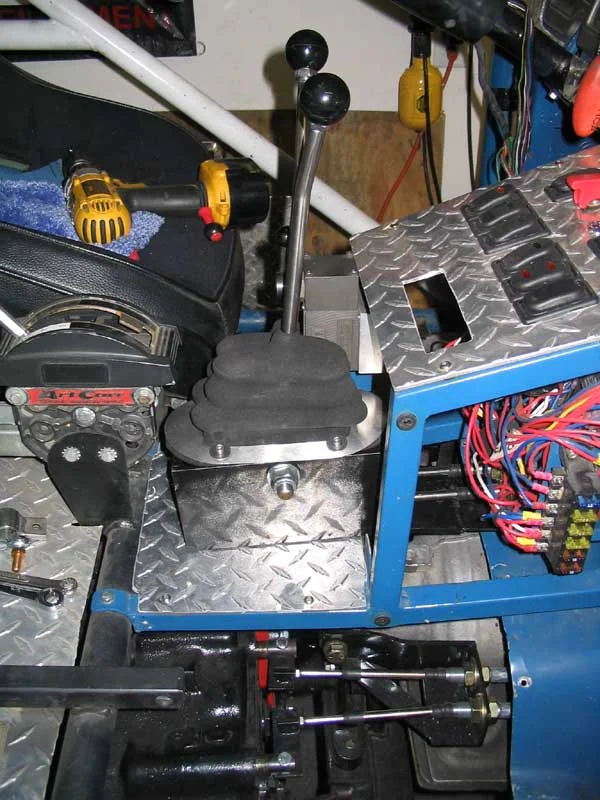

Lots of levers.. :D (cable twin stick is done!)

A few of the twin stick.. It works very well.. very tight, plenty of leverage, and in a good spot! No more leaning over to shift. I reversed the levers, putting the front output closer to me, since that's what I use most.
you can see the shift rails in their various positions:
4hi:
4lo:
Neutral:

in this pic, do you have a panel that covers the right side of the center console? just wonderin about the fuse box...
attachment.php
malphrus
cool cool... i figured you did but i couldn't remember seein 'em
