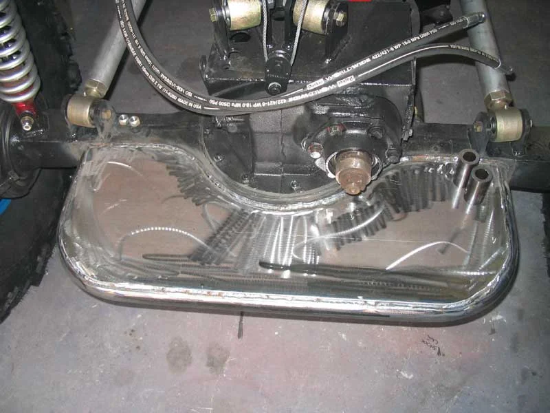

small update.. the pinion brake and steering will be on the front side of the rear axle.. I'm very happy about that.. didn't think it would fit before, but it does... I winched down the rear suspension to the bumps and there was still a bit of clearance between the link and the rotor... so I got to go and swap the knuckles around to put the steering arms on the front... fuuuuuun.

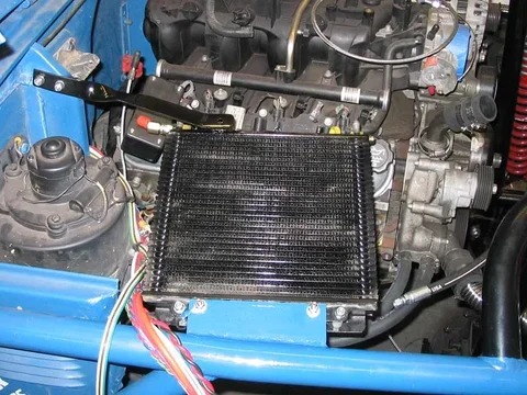

Got the power steering & transmission cooler mounted up.. Was a pain to find somewhere where the tires wouldn't throw things at it, or where they weren't too close to heat. The fan blows up from the bottom, and the hot air will exit out the louvers in the hood..

And, the rear area is complete.. fuel cell & cooler are mounted. Amazing how fast the room got eaten up!

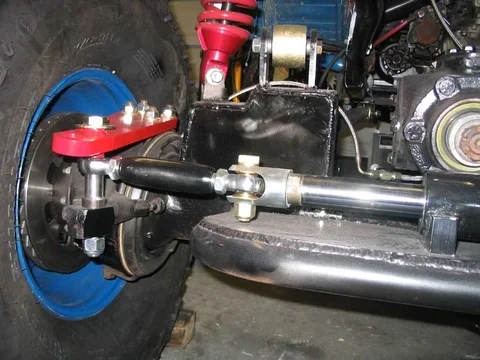

decided to put the rear steering ram on the back side of the axle, as it let me use the hi-steer arms, and I'm less likely to get hung up with it there vs. on the front of the tube.
Also made a guard for the pinion brake, complete with speed holes..

Q. did you have tranny cooler and PS cooler one on top of the other one . ?
I have the idea to place it rear .. have more space, lees heat.
Dude you work as you have a complete team working for yoy ..
I *WISH* it was more than just me many times... Like when I'm trying to install the NP205, or working with Rockwell parts...
The trans/PS cooler are here: https://forum.ih8mud.com/showpost.php?p=2264568&postcount=164
They're stacked together, with the air flow order being fan --> steering --> trans cooler.
There's really not room for it anywhere else on this rig because the coolers are 12x12", then add room for the fittings and lines. The air temp going in shouldn't be too bad, since the sides are totally open..
Still thinking on that .. and thought more longer hoses add stress to the pumps on tranny and PS ..
Don't get me wrong .. I'm not saying that your plan positioning it in the engine room are bad .. naap .. just wondering there another place in the rear just to keep it far away from the engine heat and alloing your engine have more " space " to be cool.
But again I'm always forget that you don't have the same eviroment temp as me .. :eek:
Your temp are not a radical issue as us .. down here.
Oh, it gets plenty hot and humid, but ya have to remember that I have no fenders, or aprons, or anything, it's just the hood that keeps all the engine heat from escaping. The PS system I'm not worried at all about adding stress to, but the transmission pump I am, somewhat. In the last build, I had the transmission cooler off to the side of the radiator area, and the transmission hot line never got over 140-150°
Not alot to update, made the mini tie-rod ends for the front and welded up the slugs in front the steering arms, did some painting on the rear axle pieces and the rear tubework, and started installing the engine wiring harness. Once i figured out why Jim's laid out the connectors where he did, it all made sense.. All the wiring is pretty well hidden, it's a nice harness he made.
Now to figure out where / how in the hell to mount the computer.. I think I have a location, but the PCM has no provisions for mounting..
I'll snap a picture of the front steering once it's fully assembled.. it's freakin BEEF.. the pieces from Station are nice as hell...
