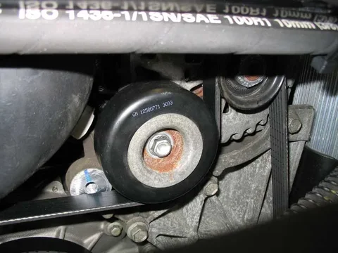

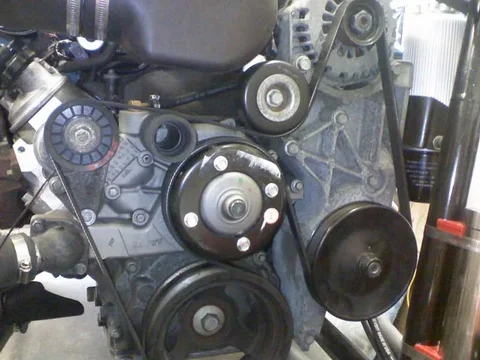

Getting closer, but not without some stress.. When I initially installed the serpentine belt, it was rubbing BADLY on the radiator hose outlet.. I'm running 5.3 truck accessories on a 'vette water pump. Fortunately, it looked as though one of the alternator mount bolts would be a good spot, but that's already a LONG M10 bolt. Aprilia to the rescue! I had a spare bolt of the right size, perfect length, threaded right in in my spare bolt bag from my motorcycle... Even the belt for the Tahoe fit, and I've got great pulley wrap so things won't slip.
Here's the before shot.. note the location of the idler pulley on the right.
And, after!

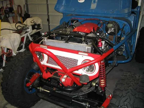

Oh, and in a moment of "Duh, Rich", I figured out that the brace in the center of the hood was preventing me from running the engine cover we painted up and wanted to run.. buh-bye to the brace!
