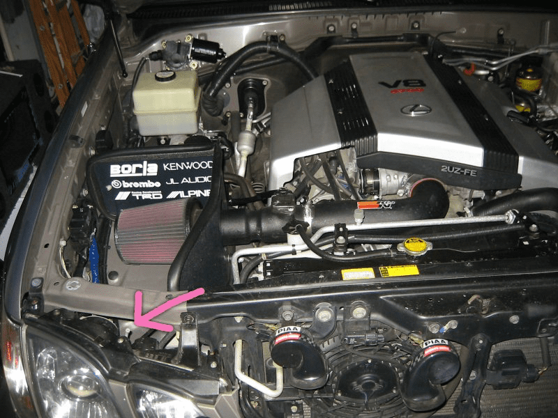

Okay the rear cargo area had two of these:
What the heck are these?
Exactly what those were. Thank you. Really cleaned up the front end.

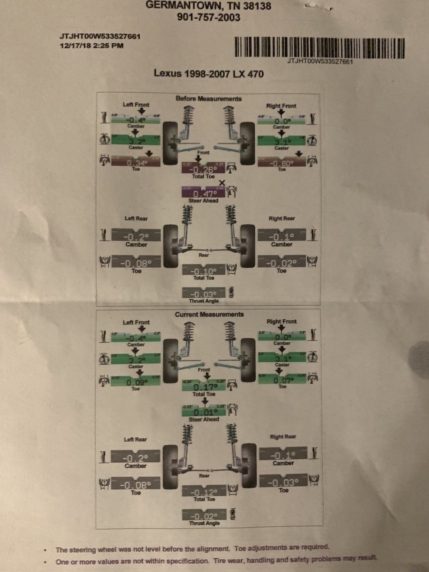

Finally got it aligned. Needed it from the moment I bought it:
