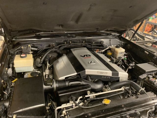

I also cleaned my engine bay (easier to work on a clean engine):

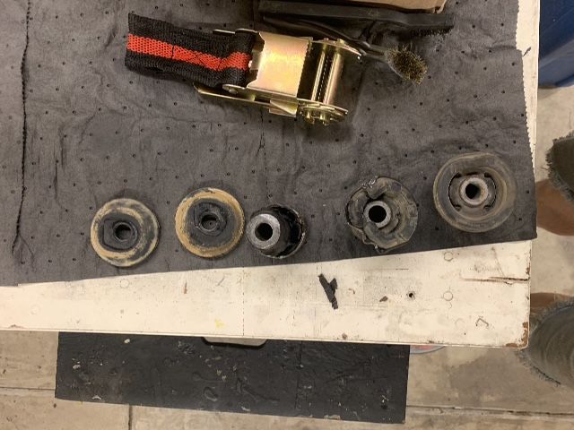

And finally, all the old diff bushings, not bad for 235k:

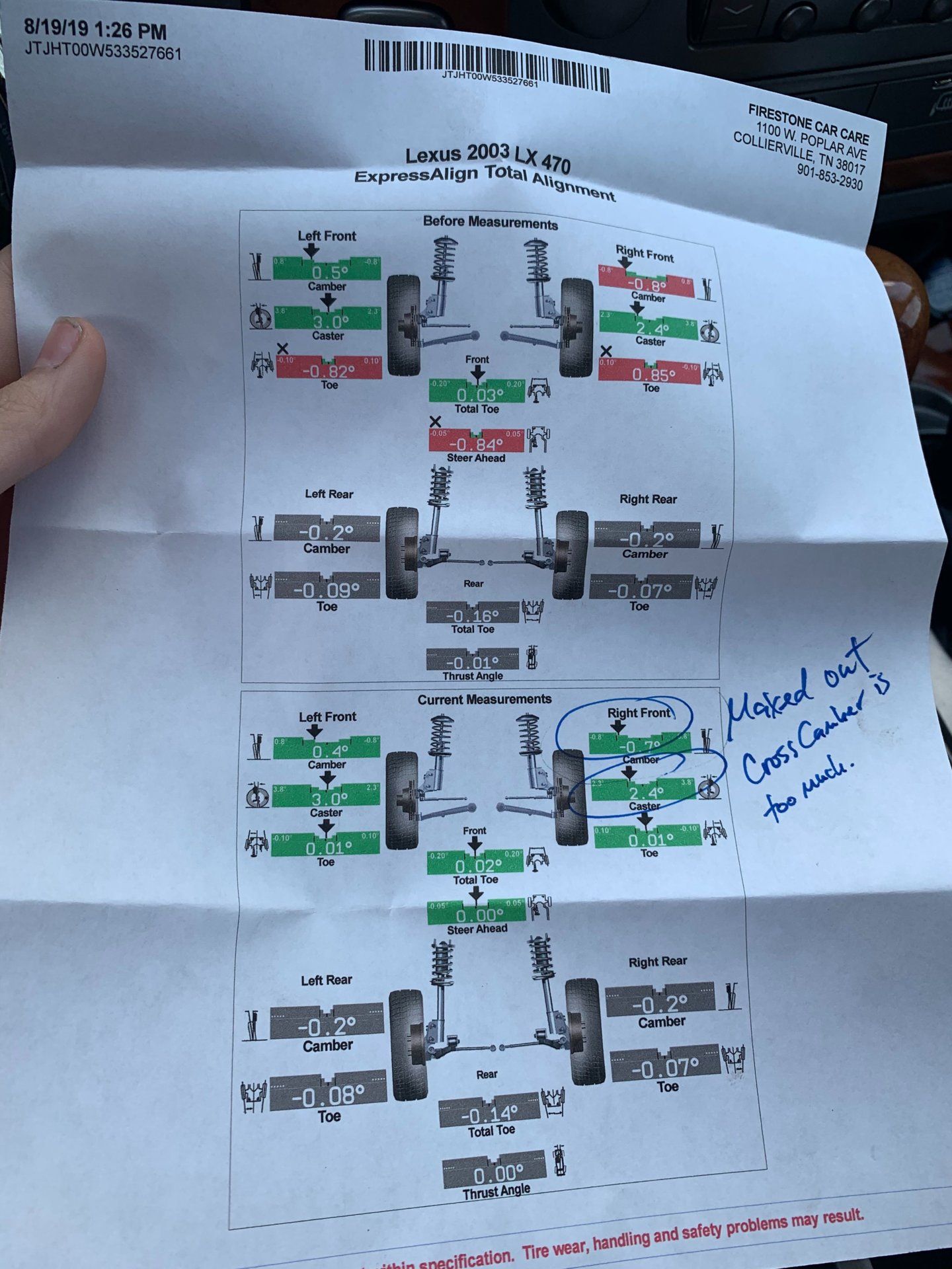

Finally got the truck aligned after FAR too long. Was one of those things where I kept saying "yeah, I'll get to it this weekend" lol.
Looks like I need to replace some control arm bushings soon..right? they tried to tell me the front shock bushings could be worn to the point of it pushing the arm out like that. I disagree...

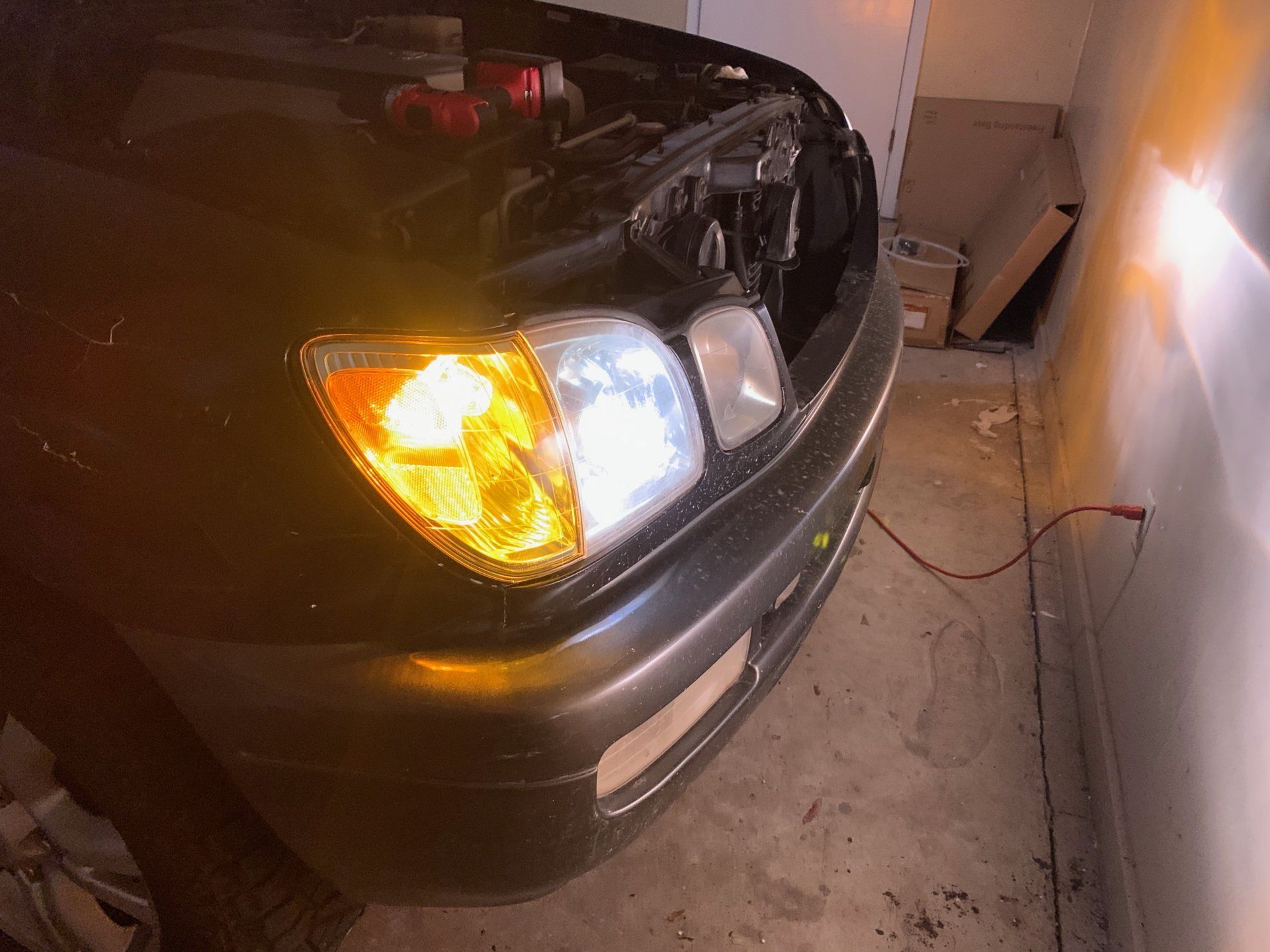

I took delivery of my new fog bulbs, sway bar bushings, and some 'Gummi Pflege Stift' for the door seals. The fog light change ended up being a bit of an adventure. At this point, the LX will need a new fender, new headlights, new headlight surrounds, new inner fender, new lower splash apron piece, new hood seal, and new fog housings to satisfy me. Whatever sideswiped PO did a number on everything.
I learned that the fog housing was shattered completely:
Awesome. Thats why the fog was blown in the first place. Surprised the turn signal bulb still worked with that much water/dirt stuck in there.
Think this bulb has a few more miles left?
I replaced them with $7 HELLA LEDs that are a nice light shade of yellow.
I "fixed" the cracked assembly with some 3M window weld and plastic sheeting. Just to hold me over until the new housing arrives.
Sealing on the front looks terrible, but not noticeable in the bumper. Like I said, something temporary to hold me over for a bit.
