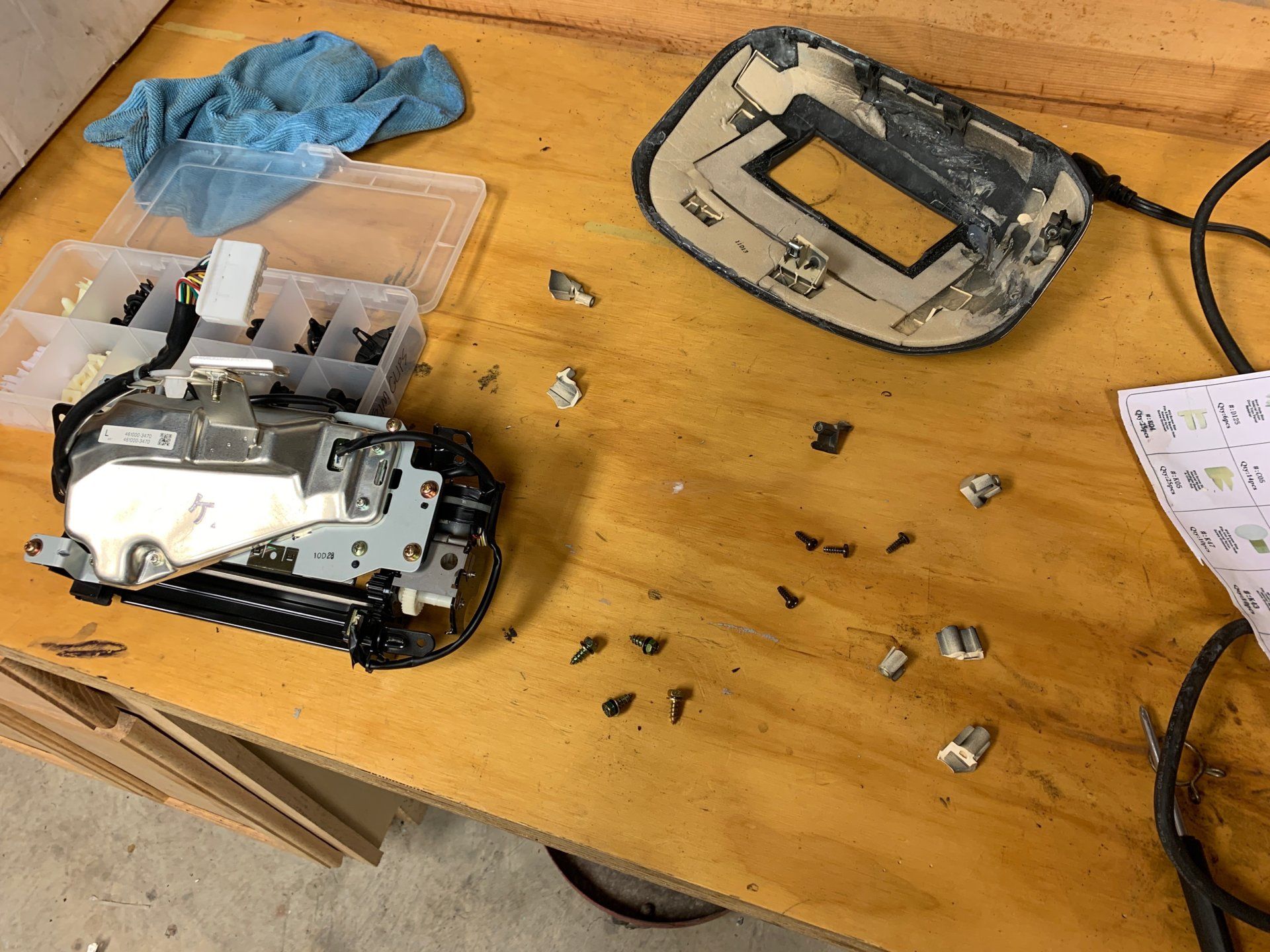

I also pulled the gauge cluster to get at the Night View stuff to pull the rest of the broken tabs and pieces:

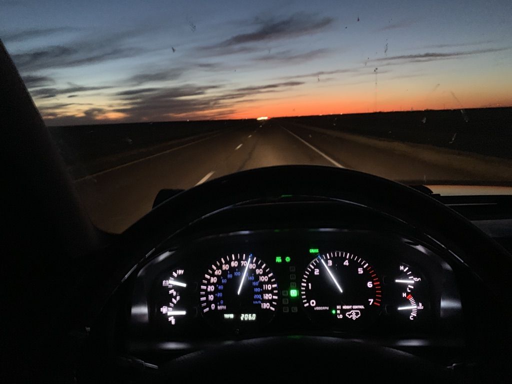

Accumulating miles pretty fast on this bad boy. Happy to report it will still hit 110mph (slowly).
Had my best mpg ever going down I-70 to Denver:

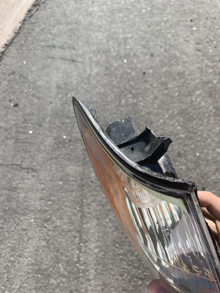

A chunk of tire struck me on the interstate recently:
1988554
1988555
Looking at DEPO clear corners since OEM corners are $200/apiece.

OEM corners should be ~$70/side. 81621-60220 and -60240.
They were $54 each when I ordered them a few months ago (also for an ‘03), so shopping around with the part numbers in hand might get better than $70.
Awesome. When I was searching I was on a poor connection so basic Google searches were about all I could do. Thanks!
