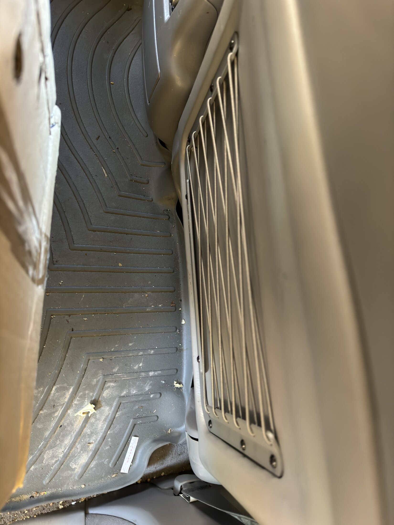

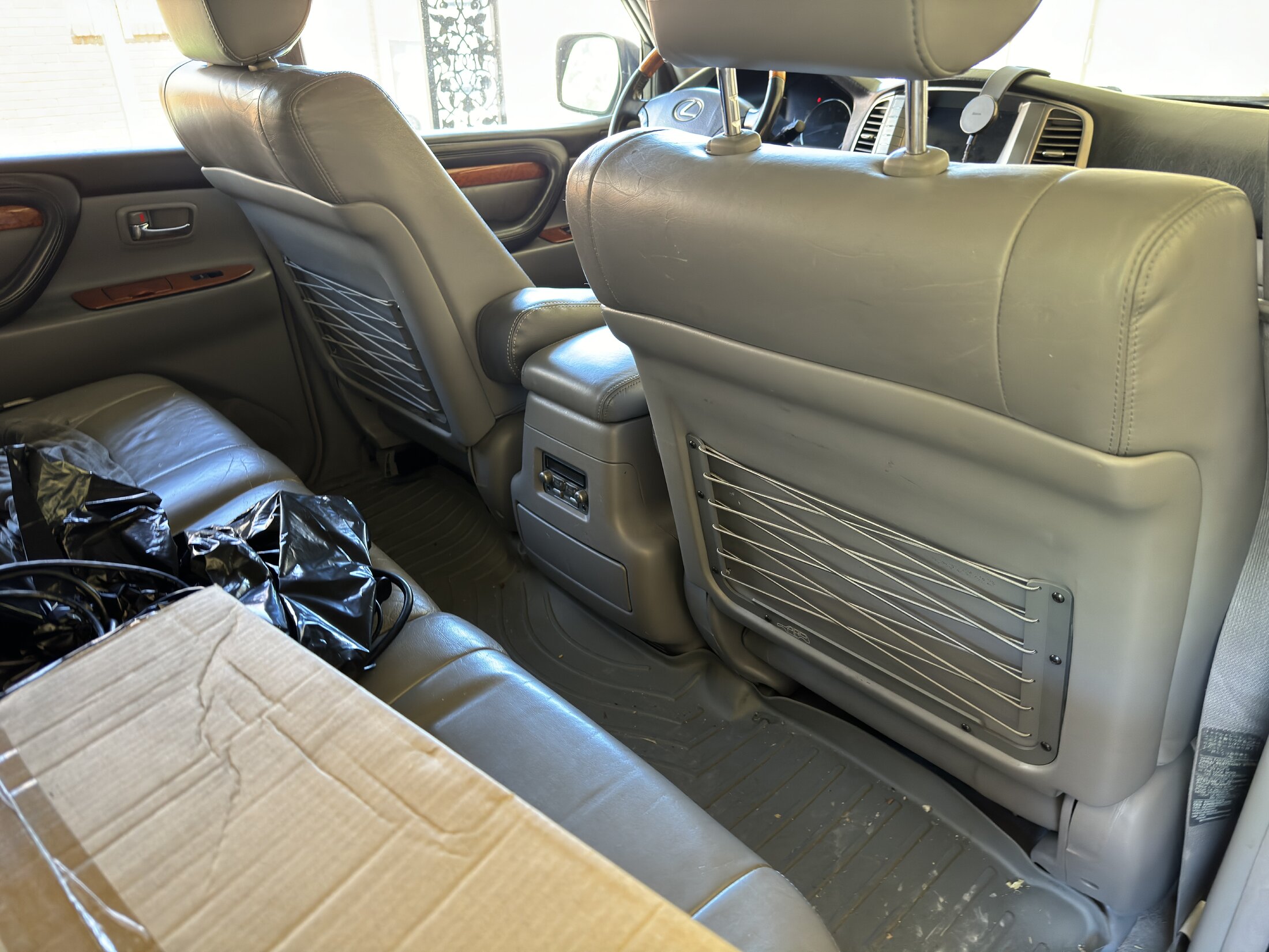

Looks like you nailed it! It does take a little care to spread the frames perfectly vertical to keep the alignment correct while drilling. Seriously love how the grey ones blend into the seats.
Same here, they look factory. So the only two holes I needed to drill were the upper 2x. I fully bolted it to the back with the bottom holes. You just have to punch through the leather/vinyl but the holes are there for the lower portion. Wish I snapped a photo, I was worried about the alignment too, but it’s easy if you bolt the lowers first.
I just installed a set for my friend’s LX the other night. Did it the same way, secure the bottom bolts first then align and drill the tops.

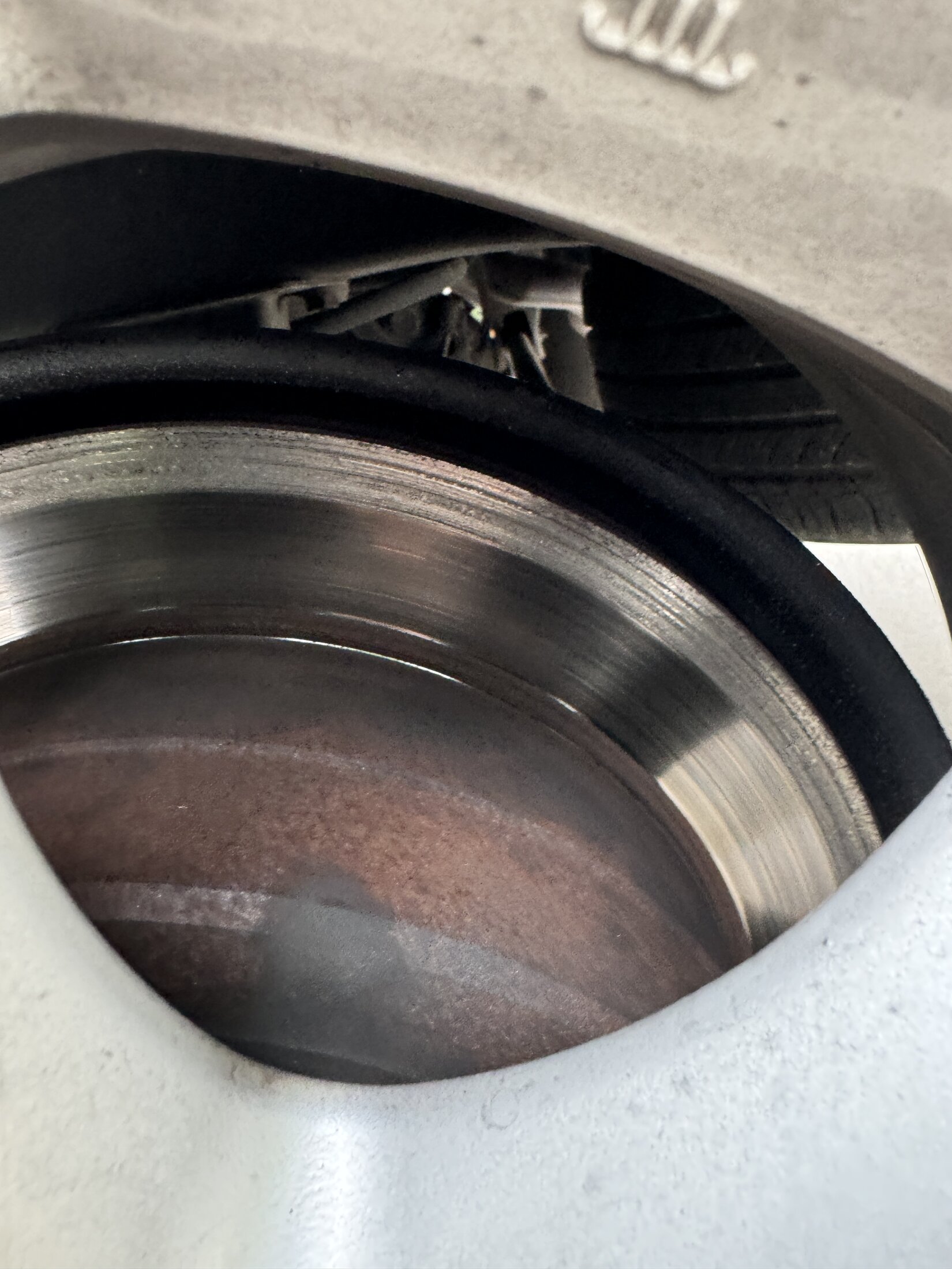

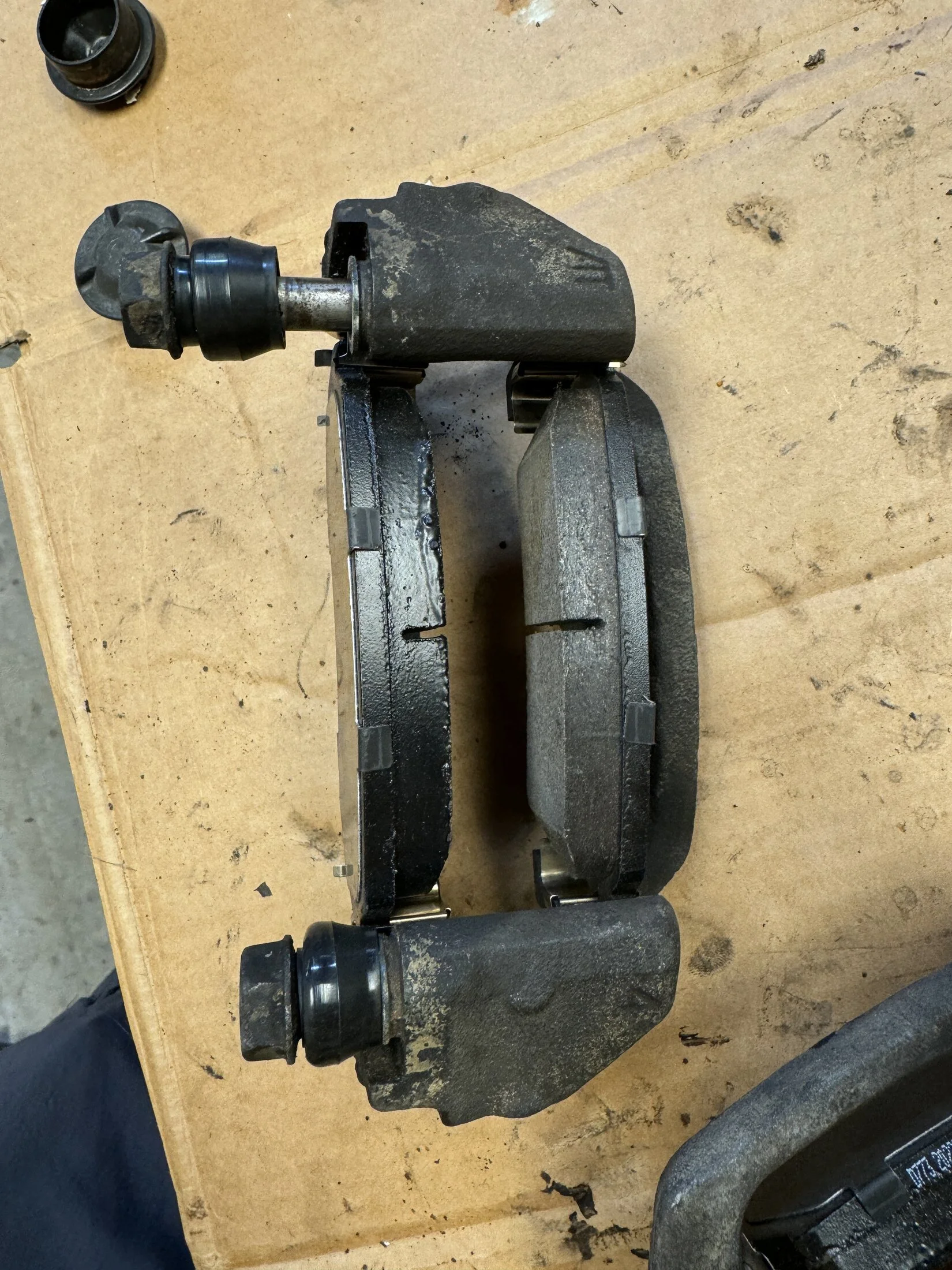

On the way out of Colorado, I noticed a rotational grinding:

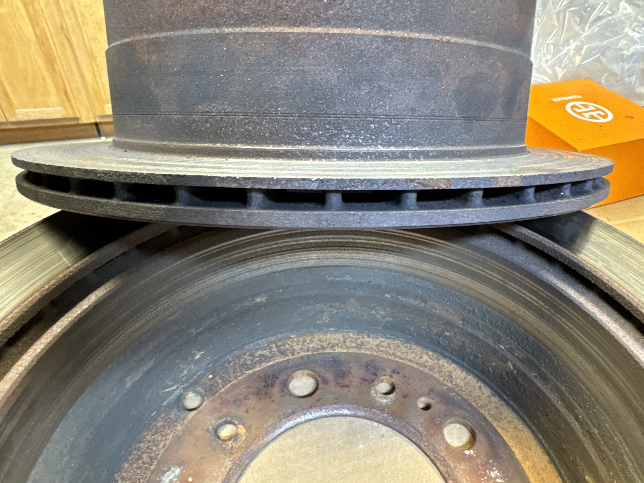

Had to finish driving home and order parts. Opted for PS discs and pads, went together well. I took apart and greased the caliper slide pins with new grease, put the new boots on, and put new pads on both sides (with discs) in short order:

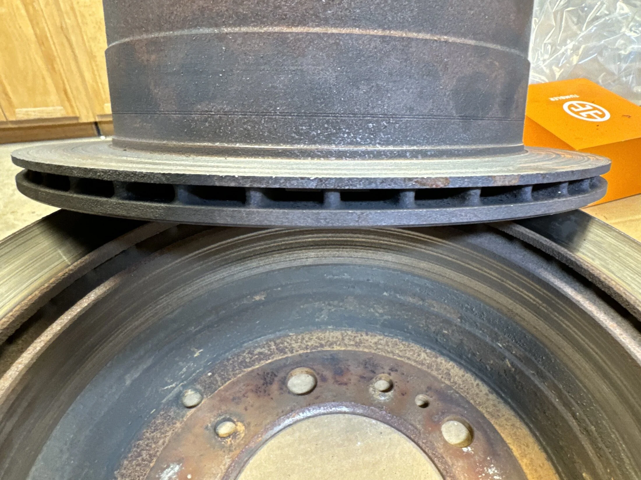

I did the rear brake pads and rotors around 228k I think, but I got my money's worth:

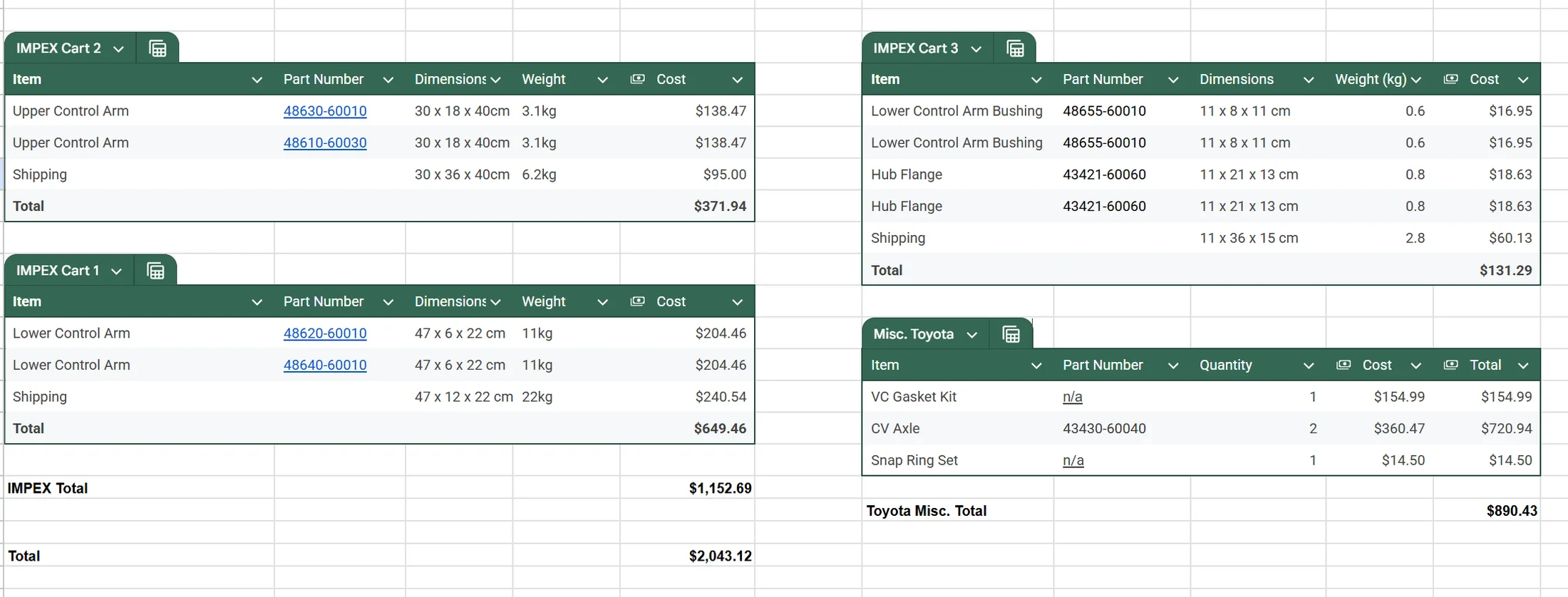

Good call. I ran all the parts I needed through it and ended up with the following breakdown:
The UCAs/LCAs are pretty heavily discounted, even with shipping included. UCAs are light and can more or less fit together when shipped, I'd imagine IMPEX is creative with their packing as much as Toyota is creative with their packaging. Tried to add in a margin for shipping pricing, this was best I could do with their calculator. Was surprised to see US dealers shipping/selling CV axle cheaper.
Placed an order with cart 3 just to see what the process is. You wouldn't happen to be able to share the shipping cost you paid for your LCAs/UCAs?
