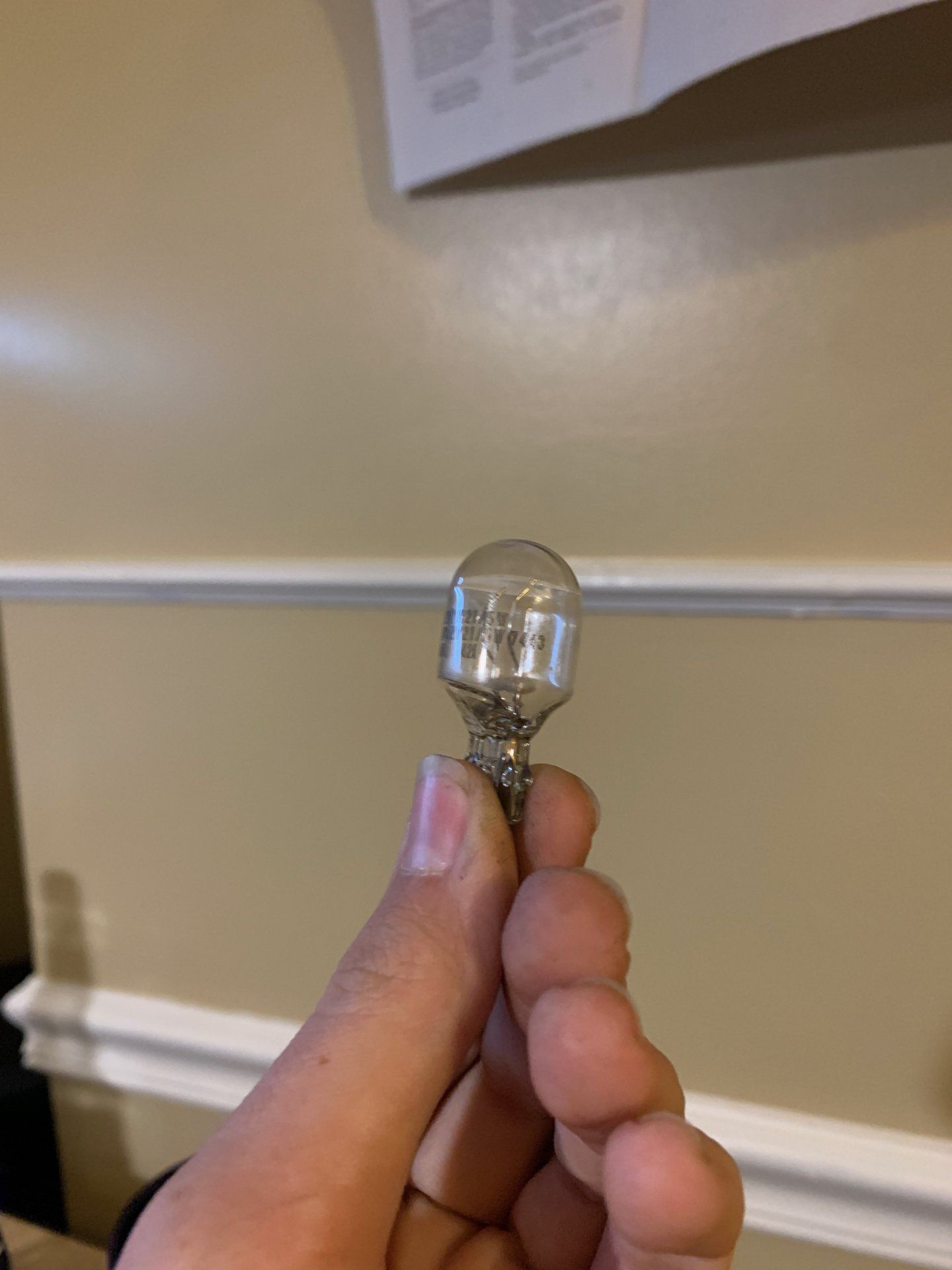

Found one of my rattles. There was a whole taillight bulb inside the taillight assembly just floating around.

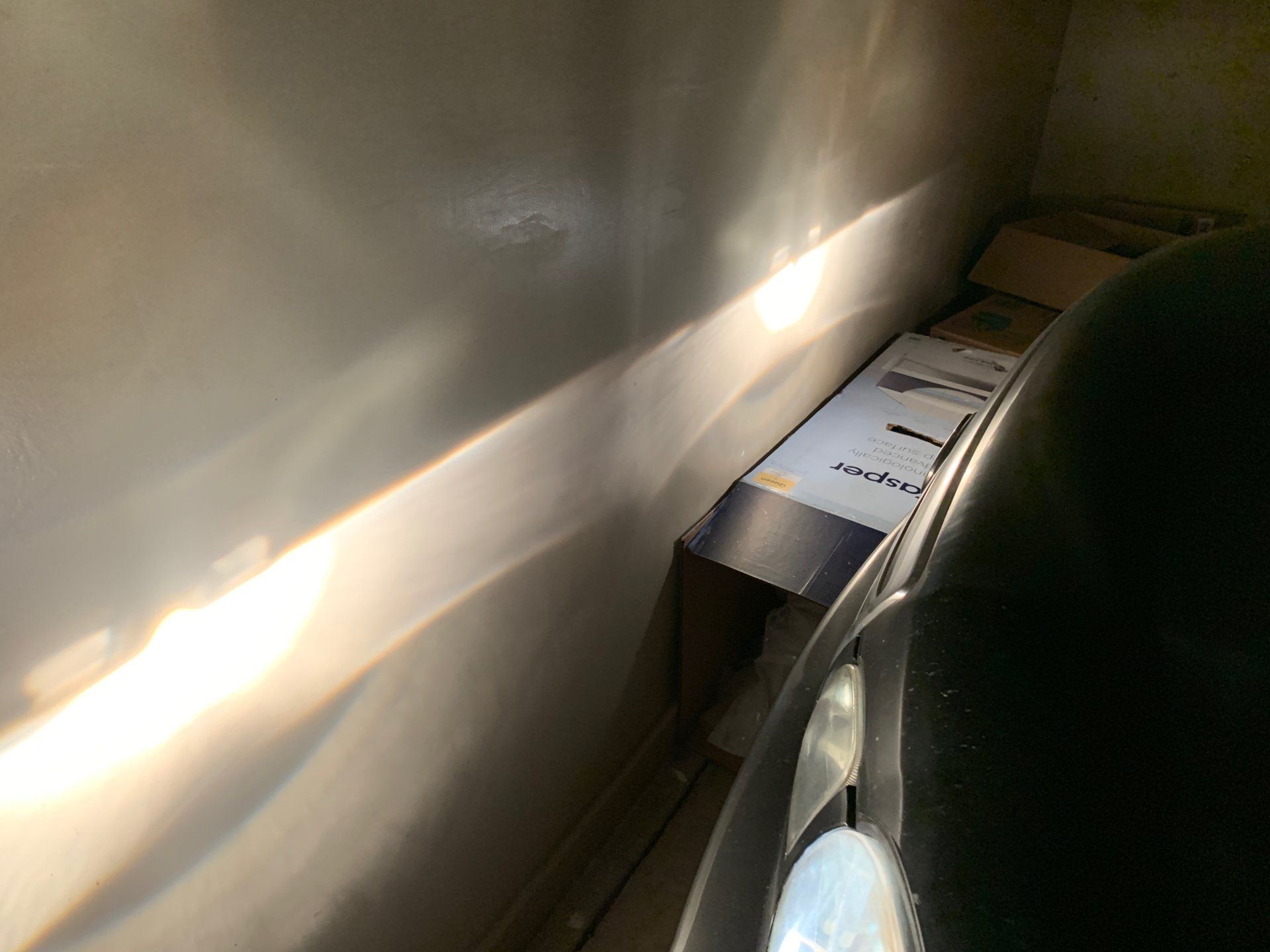

Looks like its time to adjust headlights! I've been using the Sylvania Zxe bulbs (gifted to me, thankfully!) with great success. These bulbs absolutely rock. Very bright and provide excellent visibility. My adjustment screw is gone so I guess I have to figure out the best solution. I think my PS assembly needs to come in some, and my driver's side needs to come down a bit. A happy medium will be hard to find since the passenger side was slightly sideswiped at some point!

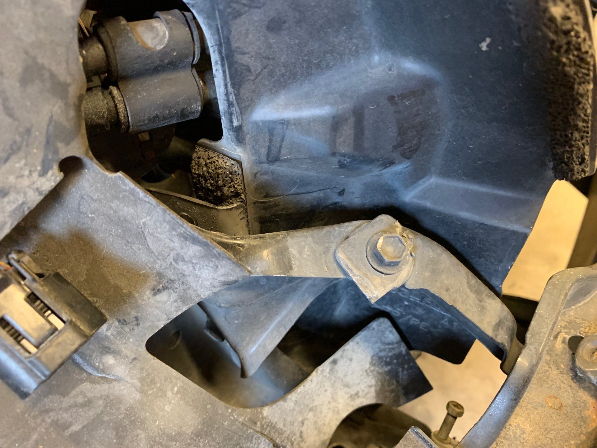

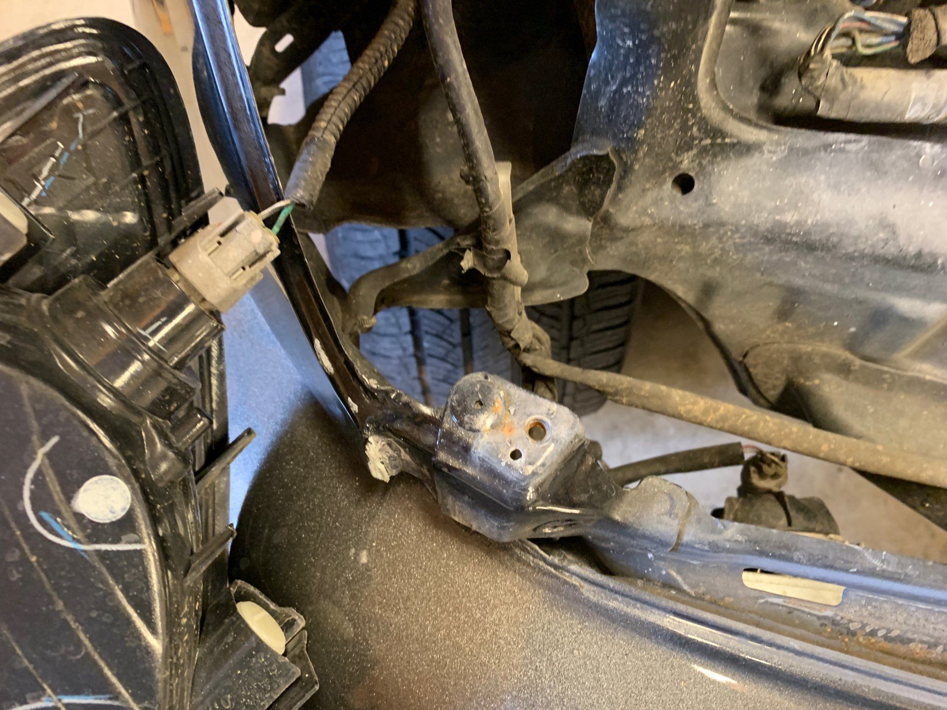

Well, turns out that when the car was sideswiped, more was damaged than initially thought. Everything behind the passenger side headlight was damaged, tweaked, or bent in some way. It was honestly pretty poorly done and super depressing to find this out. The headlight brackets on that side were completely broken off and gone, so someone just made some out of aluminum stock and drilled holes into the frame around the headlights.
1906354
1906353
I guess I am on the hunt for a passenger side headlamp assembly. If I had the $$$, I'd just buy some beautiful glass units and be done. Why Lexota switched to plastic is beyond me.

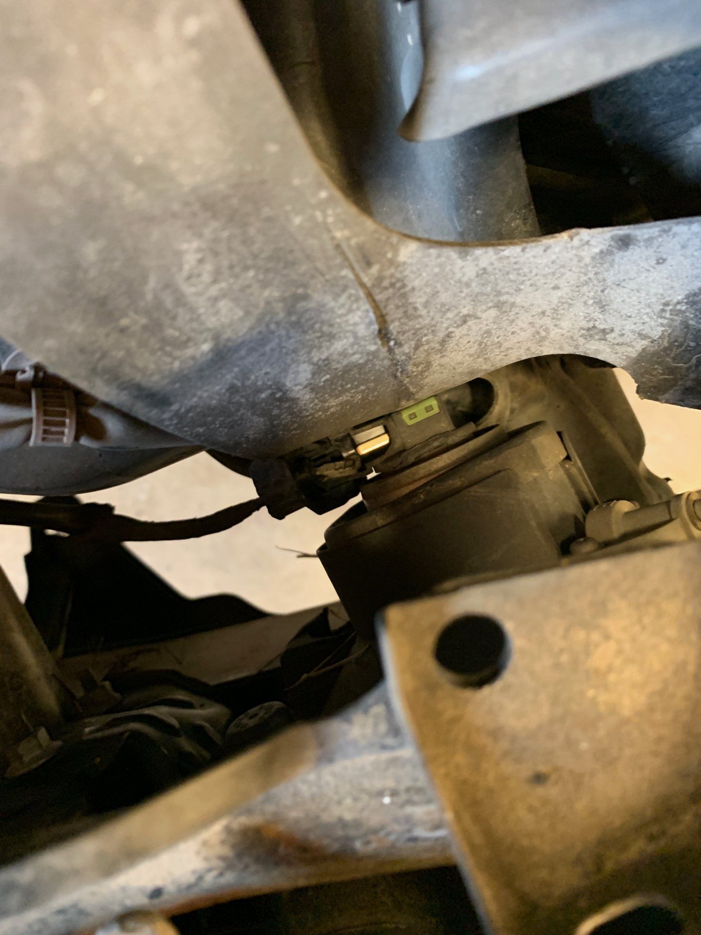

I also learned that my night vision beams were not plugged in:

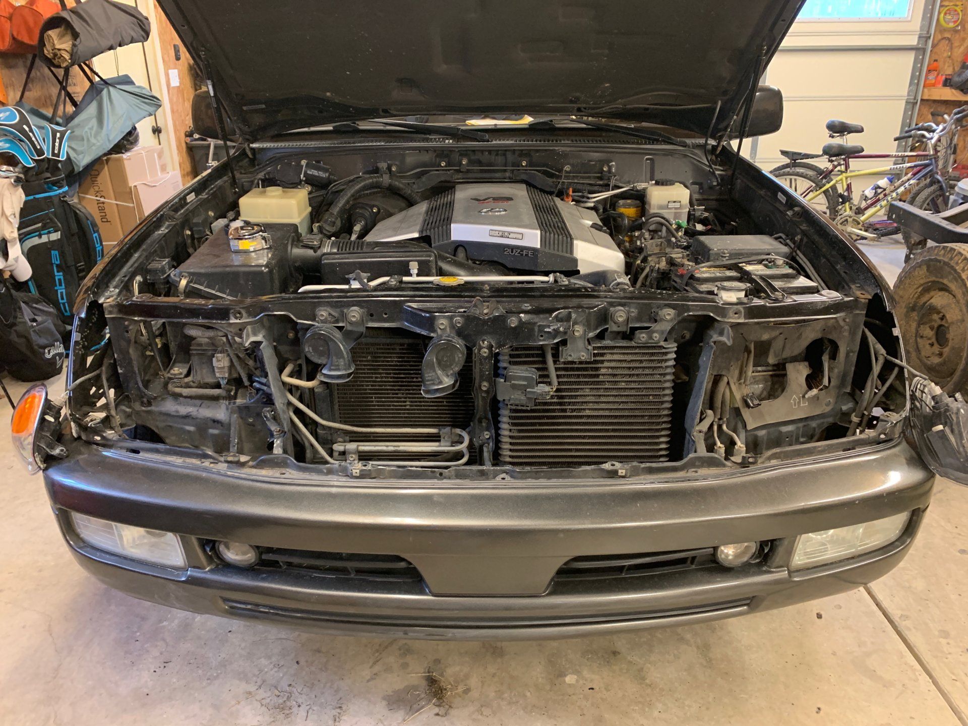

Now, I need a new bumper support, new headlight surrounds, a new fender, and the plastic piece below the grille that sits on top of the bumper. Its all broken in someway, shape, or form. Ugh. Super disheartening to have this be the reality on this LX.
More pics of everything off the front:
