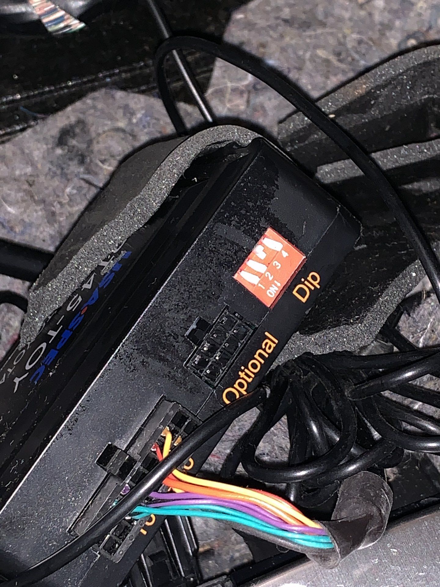

One thing I have noticed is that when skipping tracks, the disc does not update, so the artist is stuck on the title screen. Not sure if that is a side effect of the lack of CASLEX cable or if its just the USASPEC box DIP switch settings... Haven't really investigated.

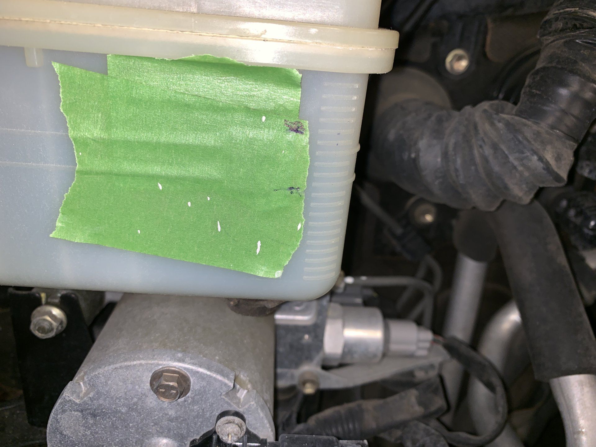

Just ordered AHC fluid. Total was around $71. Higher than I was prepared to pay (lol college budget LX470). This weekend, I plan to jack up the front suspension to check wheel bearings and tie rod ends.
Well shoot. Driving to work today, I noticed that the ride did not really change between sport and comfort. Plus, 5 minutes after starting, my AHC kicked in at a light to raise the front (I park at an incline). Looks like I'm gonna be spending some time troubleshooting the AHC system as well this weekend. Fun. Fun.
The leveling at a light is normal.
Okay--thank you. Was slightly worried about that. Still learning and reading everything I can about AHC. Hoping the fluid flush is beneficial. At worst, its peace of mind and good long term maintenance.
Crap. I did the L-N-H test today (finally) to see the health of my accumulators. 7 marks. Looks like we’re gonna be replacing these at some point.
If I adjust some pressures (t-bar) and flush, maybe I can get it back up to 8-9. If not, looks like I am in for some serious penny-pinching. This is a time where I wish my scholarship covered ALL of my classes lol.
Finally flushed. Pretty sure it had PS fluid in there. The viscosity was way thicker than the new AHC fluid. The fluid was not super foamy. I think the DS rear accumulator is having issues.
On the subject of the BT45, I found two DIP settings that worked great (without the CAS-LEX) with refreshing title on song change.
