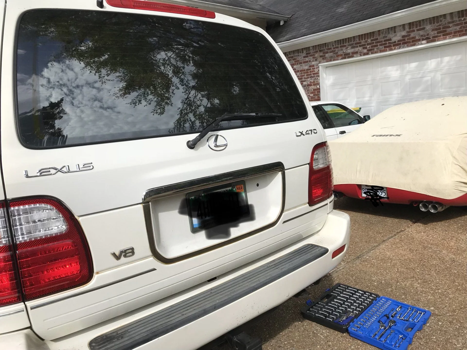

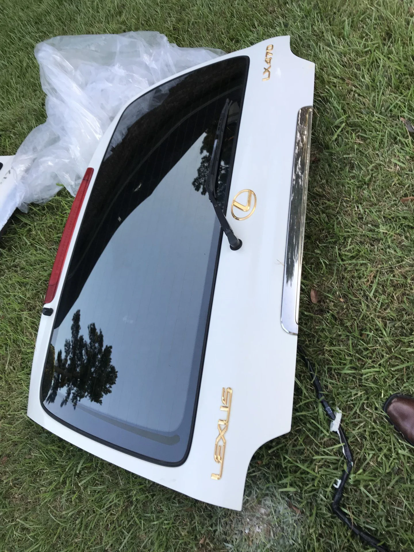

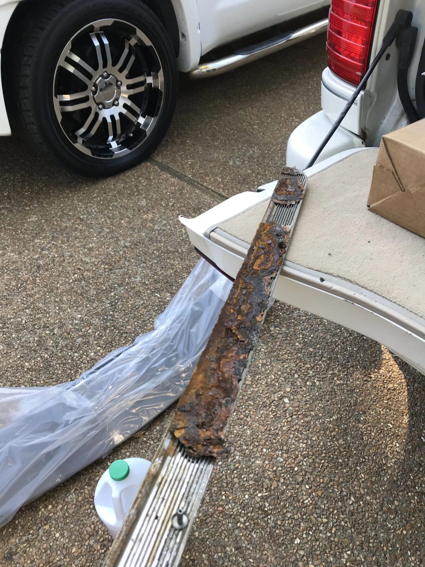

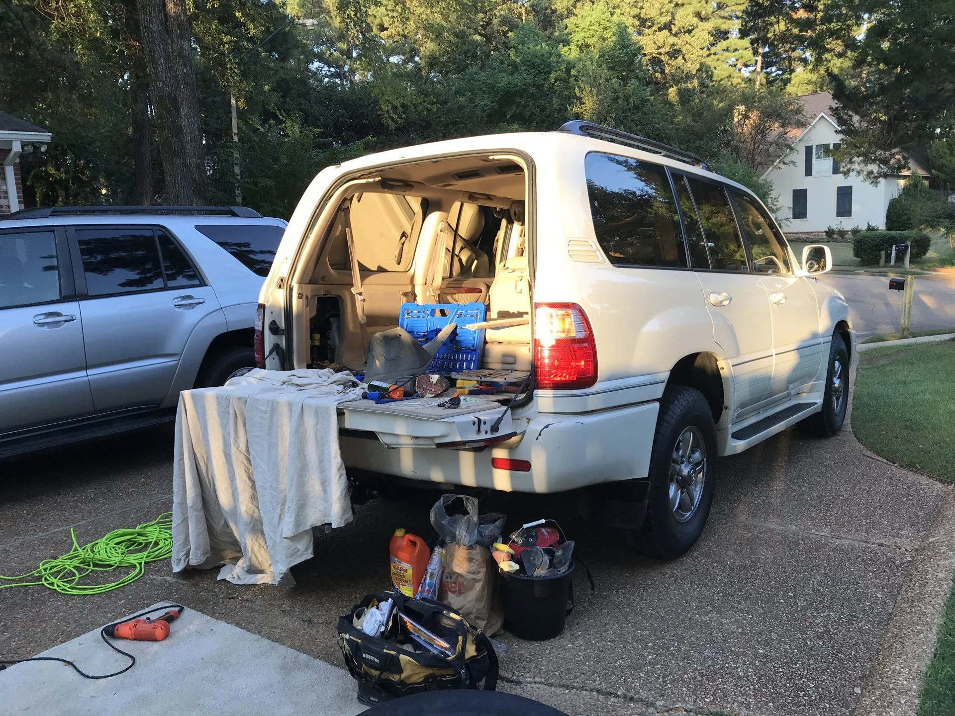

Took the rusty Michigan upper hatch off! Found the exact color match in Mint condition in Calera, Alabama at Billy’s Toyota/Lexus parts (ive used them since my first Lexus SC400 20 years ago). It had a gold package that I changed with the original chrome emblems.
More......
Dental floss and my heat gun on LOW sand a plastic scrapper to gently pry the stubborn emblems up a bit.
Goop remover/thinner and a lil wax afterwards... used 3M emblem adhevise And masking tape for added pressure
Looks amazing!

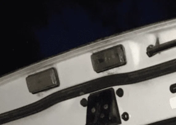

Is that rust starting to form around the lights? If so, I might recommend changing/improving the seal around the 3rd brake light and possibly drilling a couple holes at the low spots for drainage.

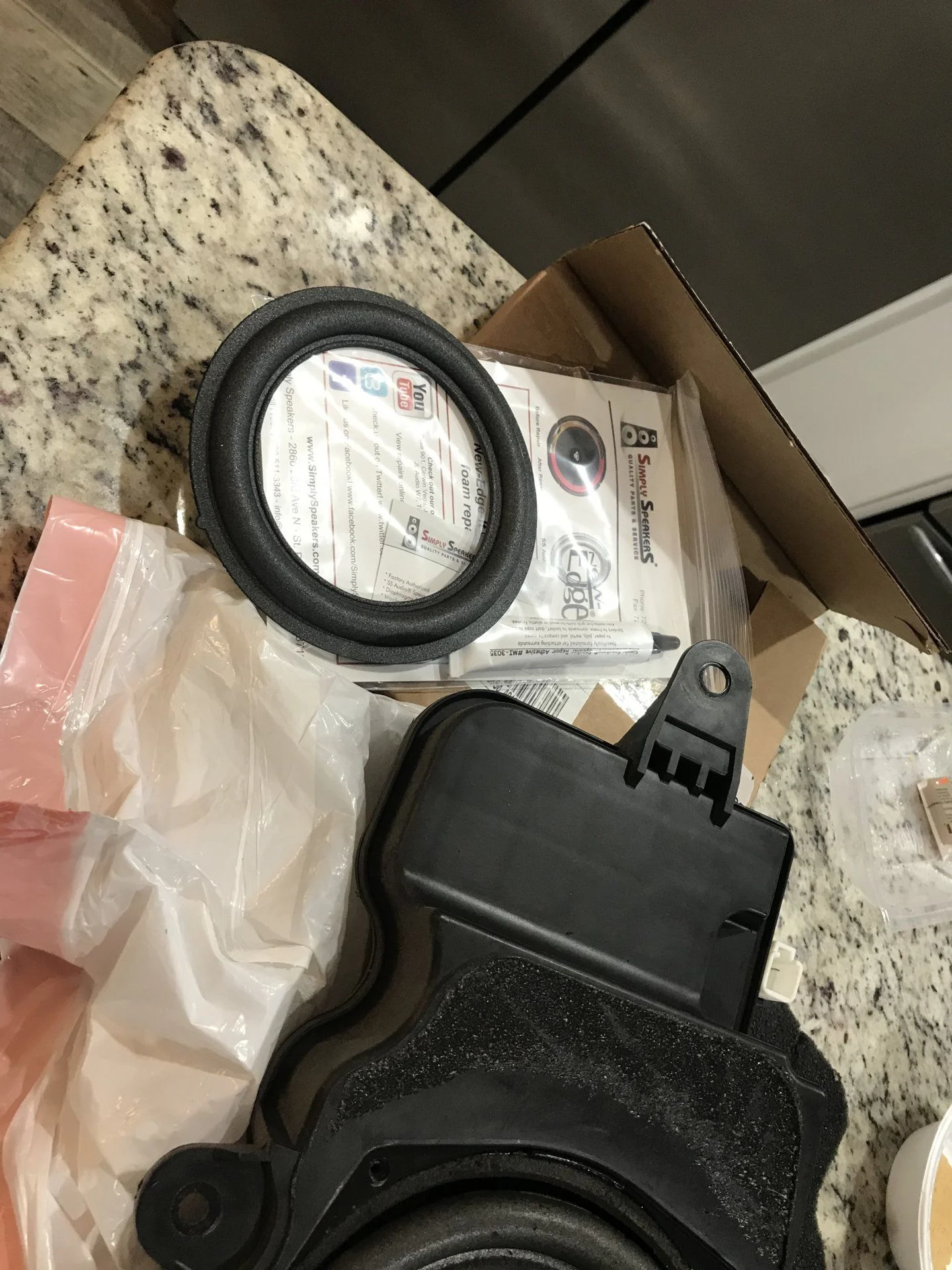

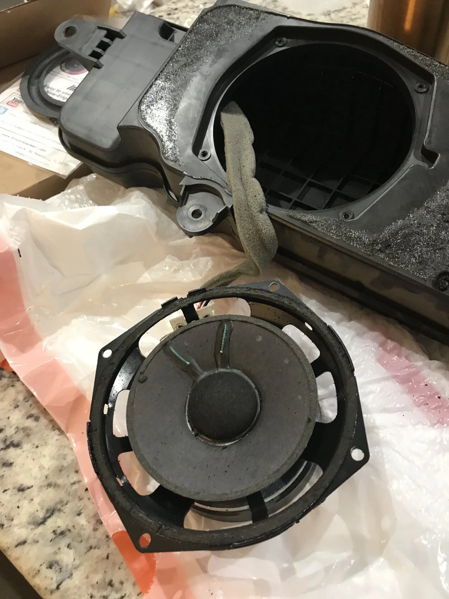

On to the Mark Levinson subwoofer foam repair... ordered the simply speakers kit for $19 and it was a breeze to fix, just take your time. I’ used the link from Club Lexus LX forum directions. Plus tips from SImply speakers YouTube channel.
My daughter was my assistant! And she fully installed in the LX once we completed the repair!

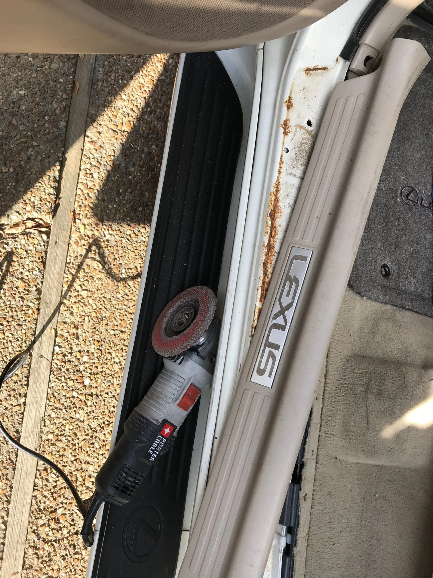

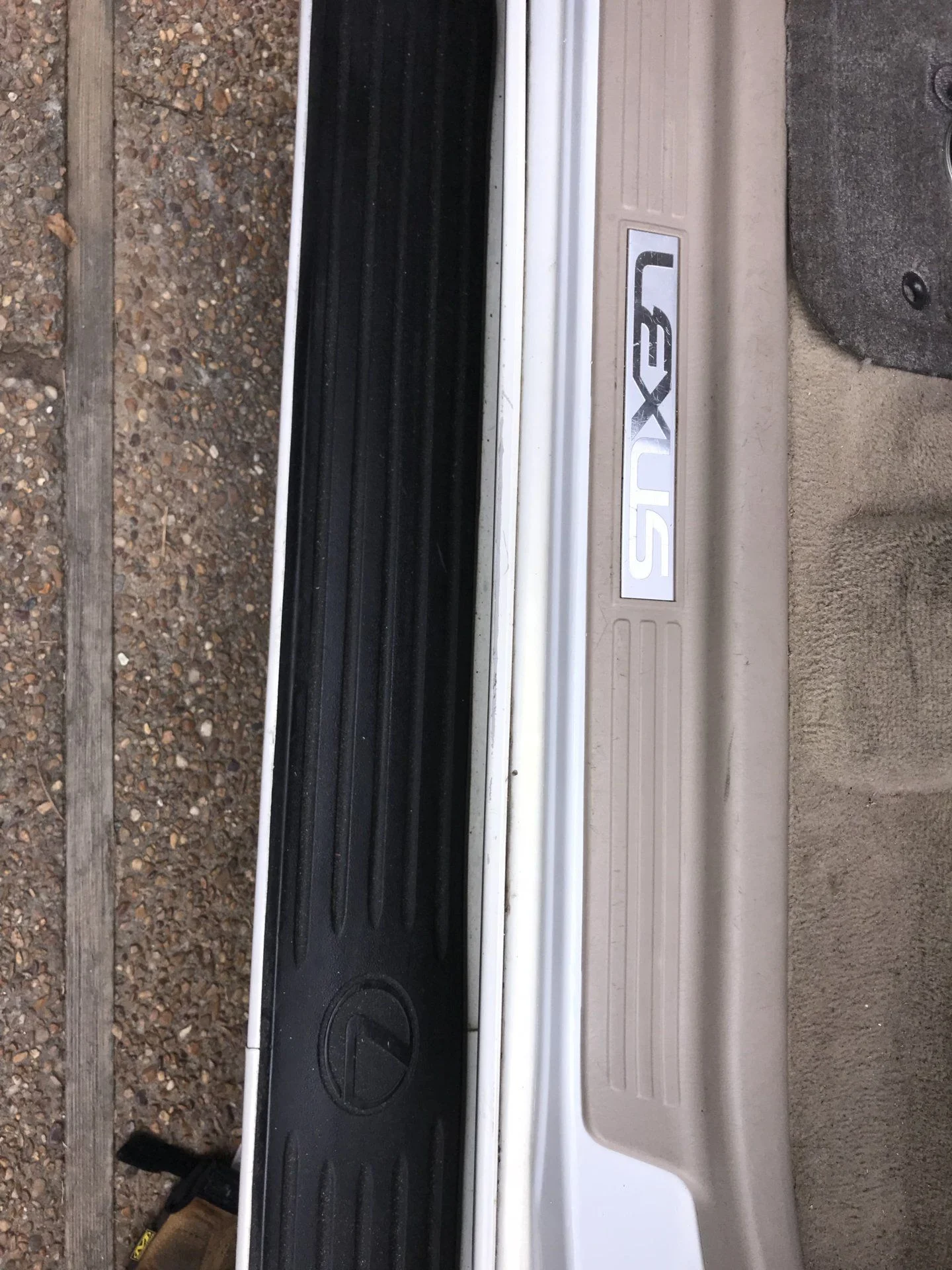

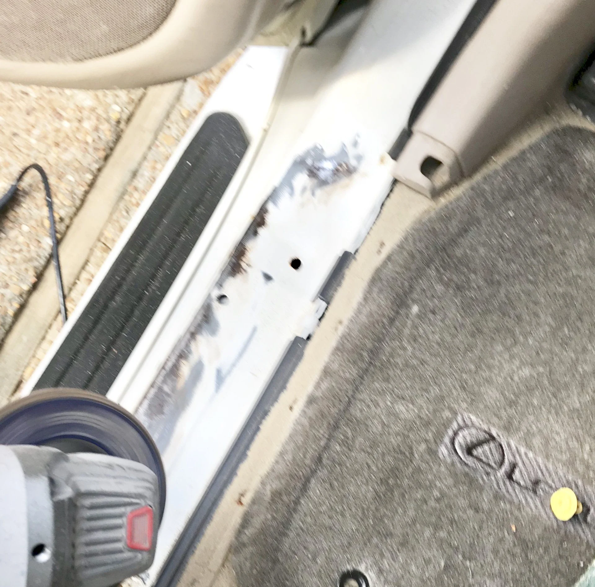

Surface rust in the door sills repaired...! Grind, sand, prep, painted & cleared
I’m on it!!! Just called my body guy( sent pictures) and he said he’ll repair it and put some drainage holes in it. Thanks, i’ Didn’t even pay attention to it!!!!! I guess I was just happy to get rid of that rotten out upper deck lid that was on there.
Nice work on those door sills. Well executed.

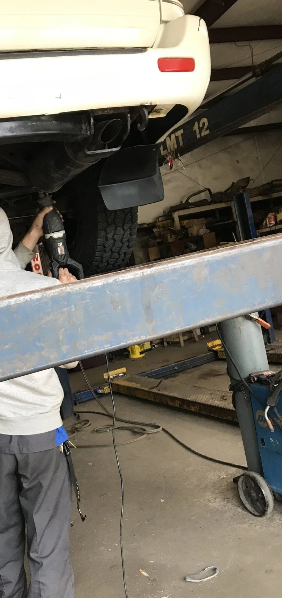

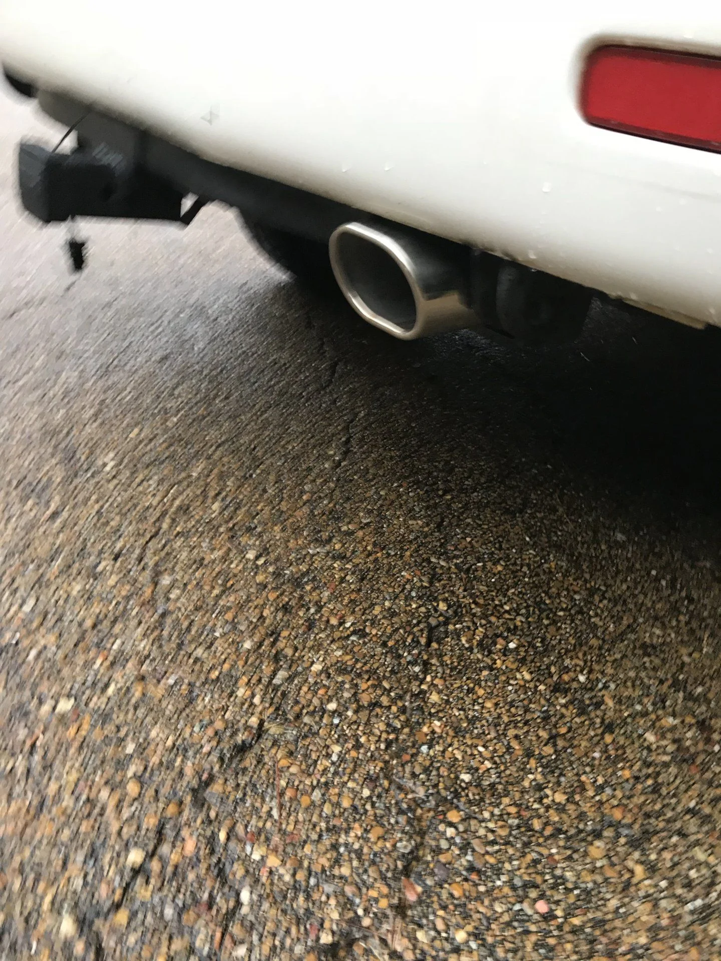

Rear resonator muffler deleted and replace with straight pipe and a rounded rectangular stainless steel tip from Autozone in the oem location.
Sounds a little louder than oem on the outside very mild change. I can’t tell the difference on the inside unless I’m passing or WOT. My Tundra sounds like a man with its Flowmaster 50 and deleted resonatorand Lexus still sounds like a Lexus....
Not sure If there’s any HP or mileage difference as some have suggested... don’t know these suvs well enough to articulate fairly, but it sounds a Lil better
