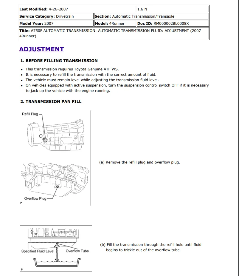

Working with @2001LC, he noticed that the extension housing has the fill plug on opposite sides (4Runner on passenger side, LC on the driver's side).
Snippet from the 2004 Land Cruiser factory service manual (note the refill plug side):
And a snippet from the 2007 4Runner factory service manual:
A thread at Pirate4x4.com has a couple pictures of an A750F with the extension housing removed:
2007529
Pretty sure just swapping the extension housings will be fine, plus my '03 doesn't even have a fill plug on the extension housing :)

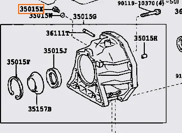

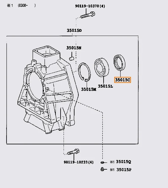

Also: note the extension housing's part number was superseded and the same extension housing was offered for 2003-2007 LCs/LXs
The extension housing for the 4Runner is a different part number and is shared with the FJ Cruiser (but not the GX470, funnily enough):
Diagram image of the 2003 LX470 extension housing:
Diagram image of the 2007 4Runner extension housing:

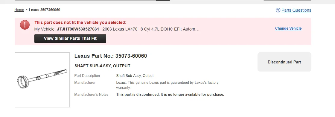

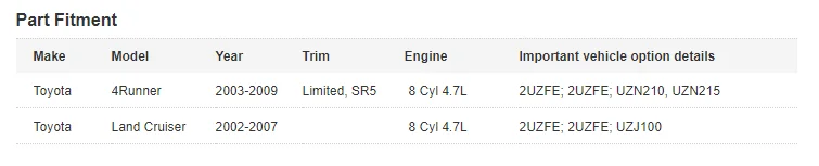

I'm not sure anymore. I forgot that if I don't put a VIN into Toyodiy/ToyotaPartsDeal, an 03 could mean MY03 or BD03, so it showed both A343F and A750F parts (lol)
2009032

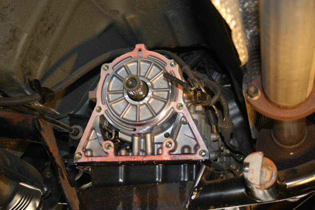

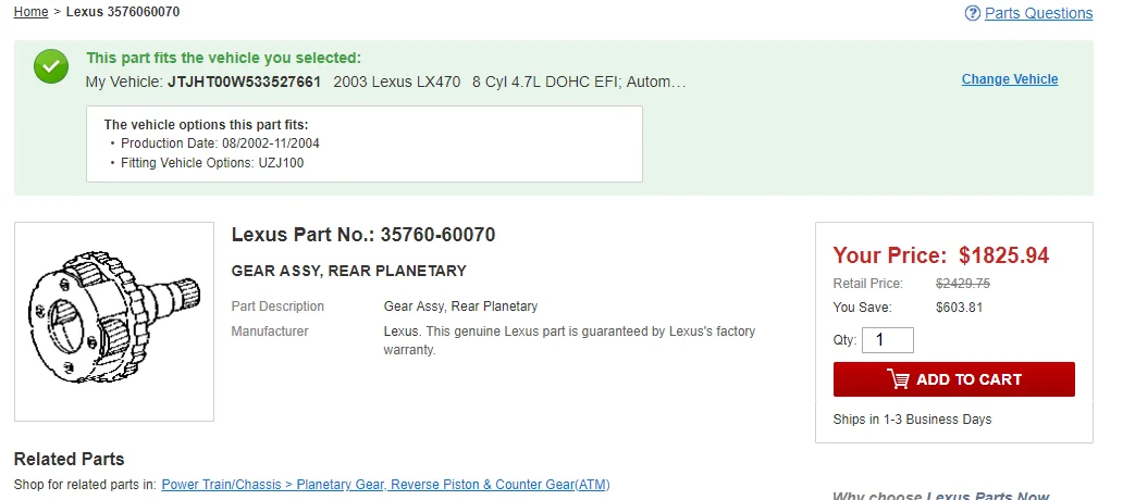

Here is a picture of a GX470/4Runner rear planetary gear assembly (output shaft for trans out the back):
And here is Toyota/Lexus Part Number 35760-60070:
I cannot find a real picture of one off the internet, does anyone have a pic when they had their MY03+ LX/LC transfer case removed?
Either way, not worried, just ready for the transmission to get here so I can get to work!

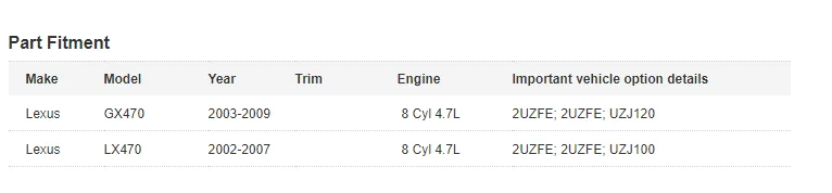

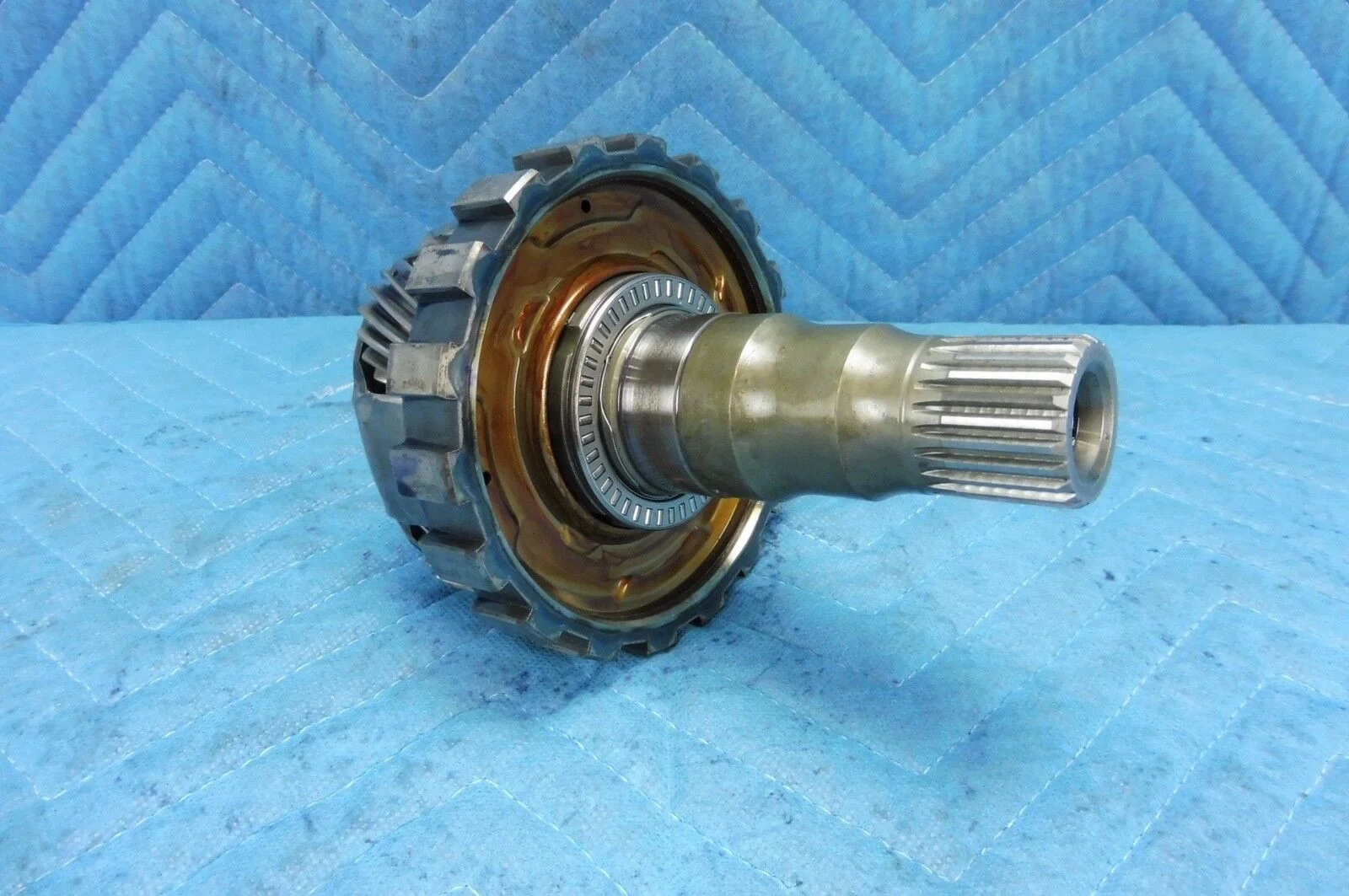

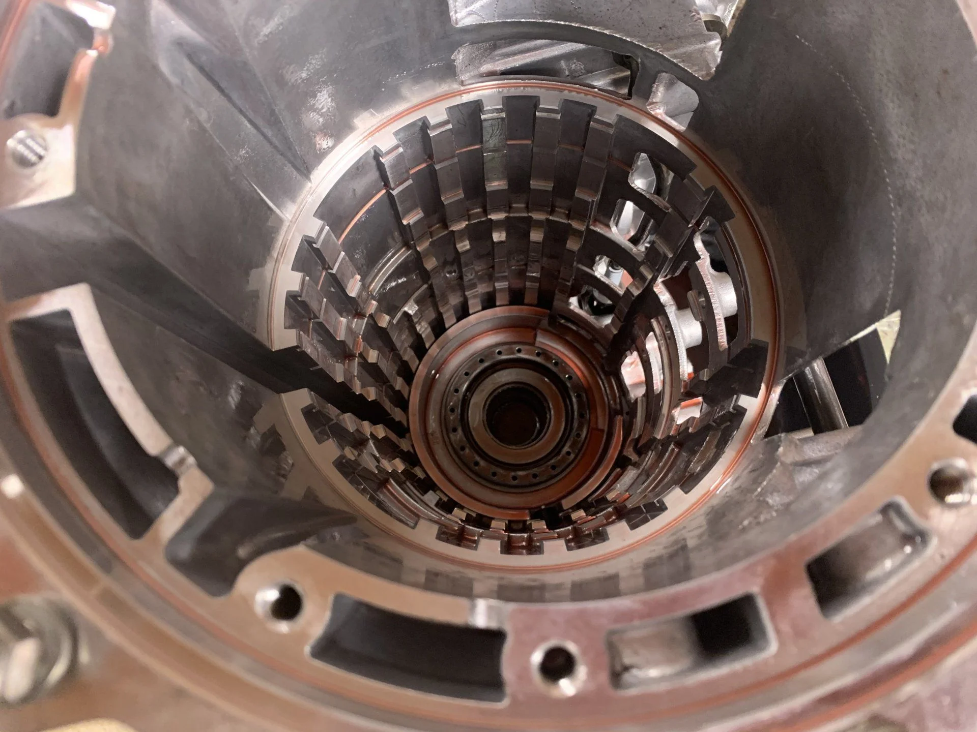

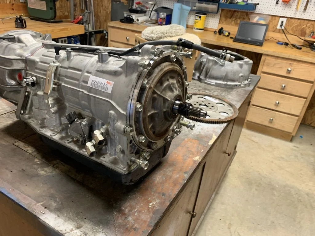

The first of the five recent pictures you posted is from a 2wd Tacoma transmission which is set up for a slip yoke.
The second picture is correct.
The third picture is the output shaft from an a343f from either an 80 or 100 series. Unfortunately, the part catalog graphic used here isn't especially accurate. I can post a picture of this shaft if needed, but I don't think it will help you much as it is for the a343f.
The fourth picture is correct.
The fifth picture is also correct. I believe this part differs from the GX470/4runner (fourth picture) in that the spline count is different...19 vs 23.

RE: pic 1 and 5. This picture is an ebay listing of an '05 A750F out of a LC/LX

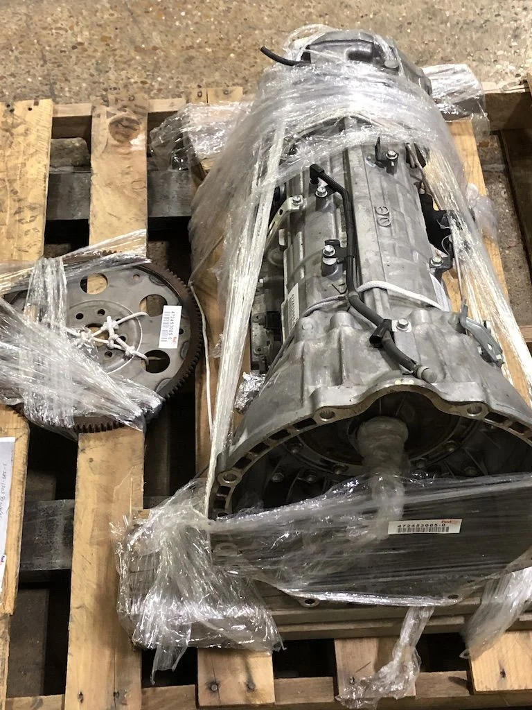

Since the LX is down for now (couldn't use forward gears this morning), I'm borrowing my father's truck. Great truck!

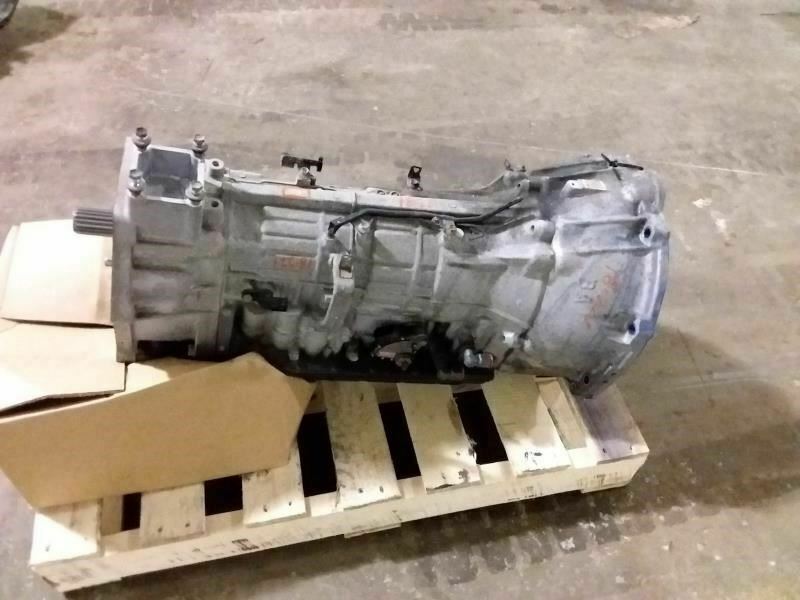

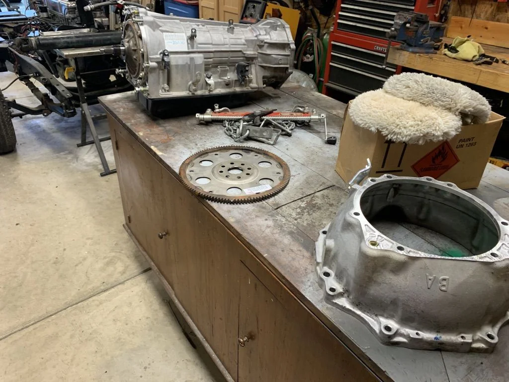

Picked up the used A750F at work and got it home and got it off the truck with a cherry picker.
Looks good!
2014719
2014720
Also, think I have enough ATF?
2014721

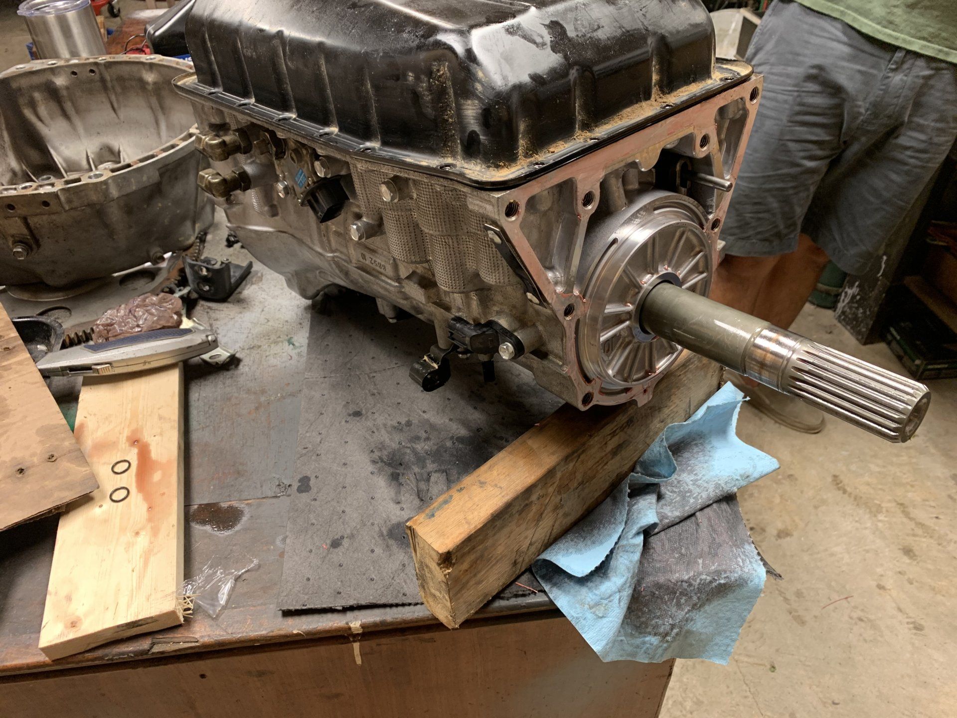

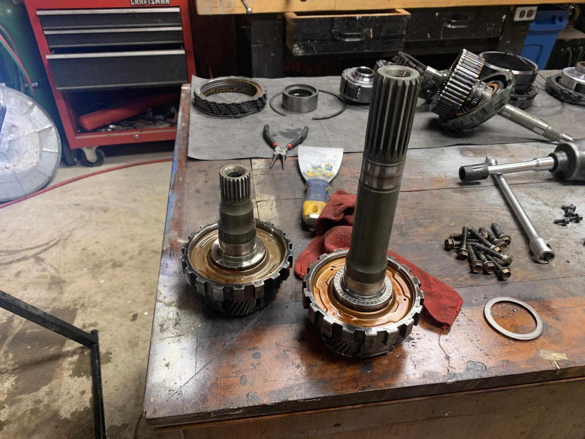

Well, I got the output shaft swapped!
2016542
2016544
(left, the final product, the 4Runner-turned-LX A750F. right is the differences between the 4Runner and LX shaft, respectively)
There were two very notable differences that were thankfully solvable. First being the park/neutral switch being different (pin out was different on the 4Runner). I just switched switch from my LX's old A750F and it was good!
The second was that the shift lever bracket was different. Once again, the LX's lever swapped over without problem.
The 4Runner A750F has a few different brackets to swap from the LX's A750F, and the 4Runner had two extra brackets not on the LX's, so those were just removed.
Disassembly of both transmissions (at the same time), wasn't too bad. Good snap ring pliers are definitely needed.

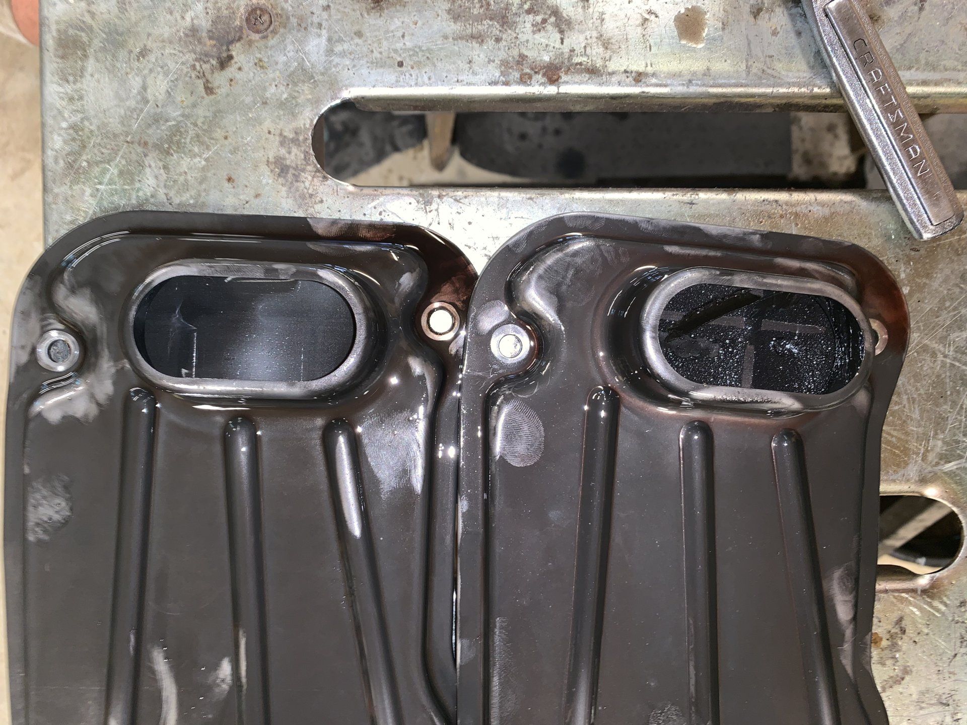

Here is a pic of the 4Runner and LX's AT filters, respectively:
2016545

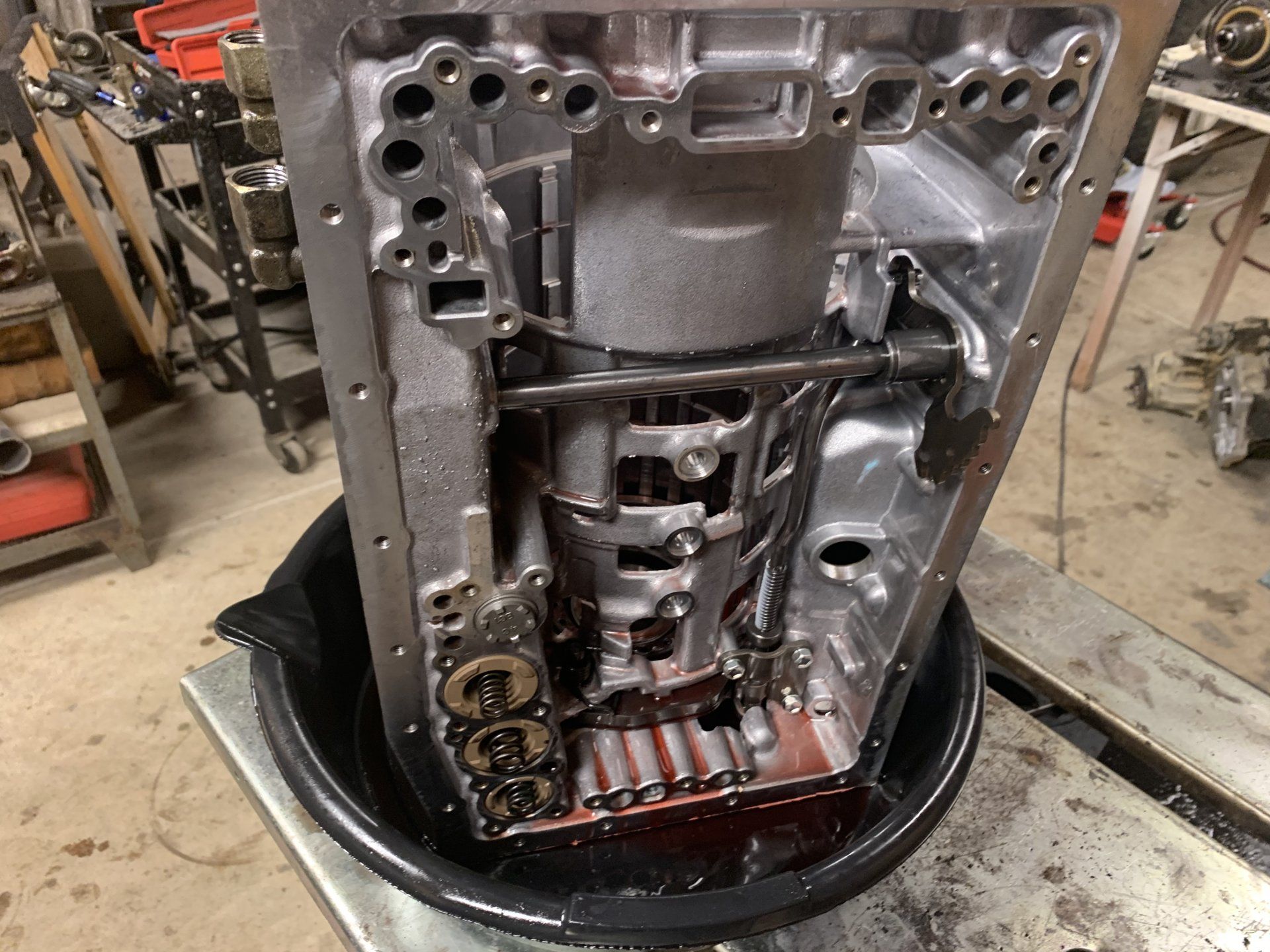

And, lastly, a look down the throat of a healthy A750F.
2016549
