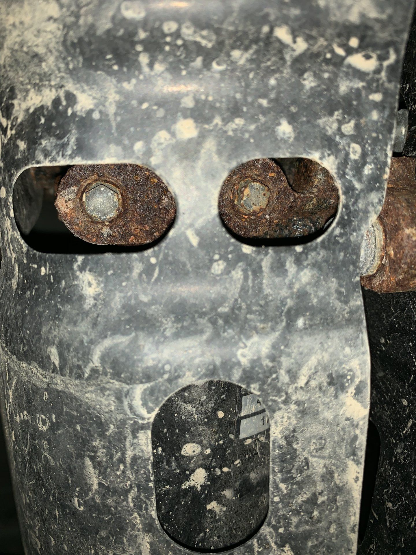

Checked my ‘18 LC today and it was rusted. I was able to turn the bolts fortunately and coated them and the valve with grease. Thanks for the PSA!
I don’t want to freak you guys out but if you are driving in an area with road salt I’d go beyond coating the bottom valve face. There have been pics on here of valves that maybe half the material had corroded away. Clearly not just the lower surface.
With that knowledge I’d be coating the whole thing and the nuts on the lines in areas prone to vehicle cancer.

Thanks, that’sf good advice. Once my tools get here I plan on cleaning up the whole thing with a wire brush and coating everything that’s rusted.

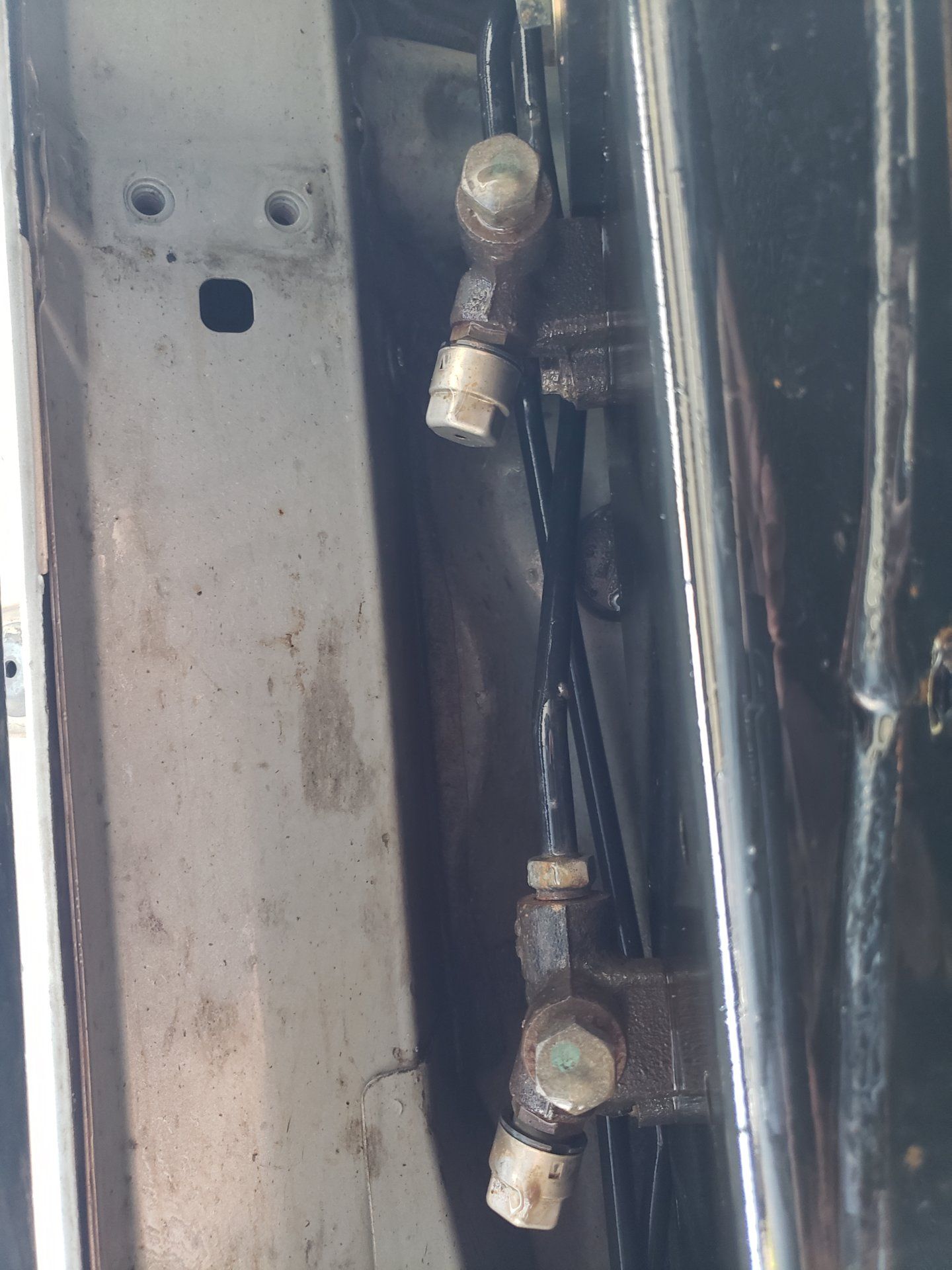

Are these the kdss valves....? 2008
It's on driver side right?
Technically they are valves in the KDSS system but not the ones everyone is discussing. Those are where the system is charged & flushed.
The main valve assembly is on the inside of the left frame rail and is covered by a thin sheet metal cover with a few holes along the bottom. The lines in your picture wrap over the top of the frame and go into the main valve assembly.

Thanks! I'll make sure I'm looking into the right spot tomorrow when I'm under there again

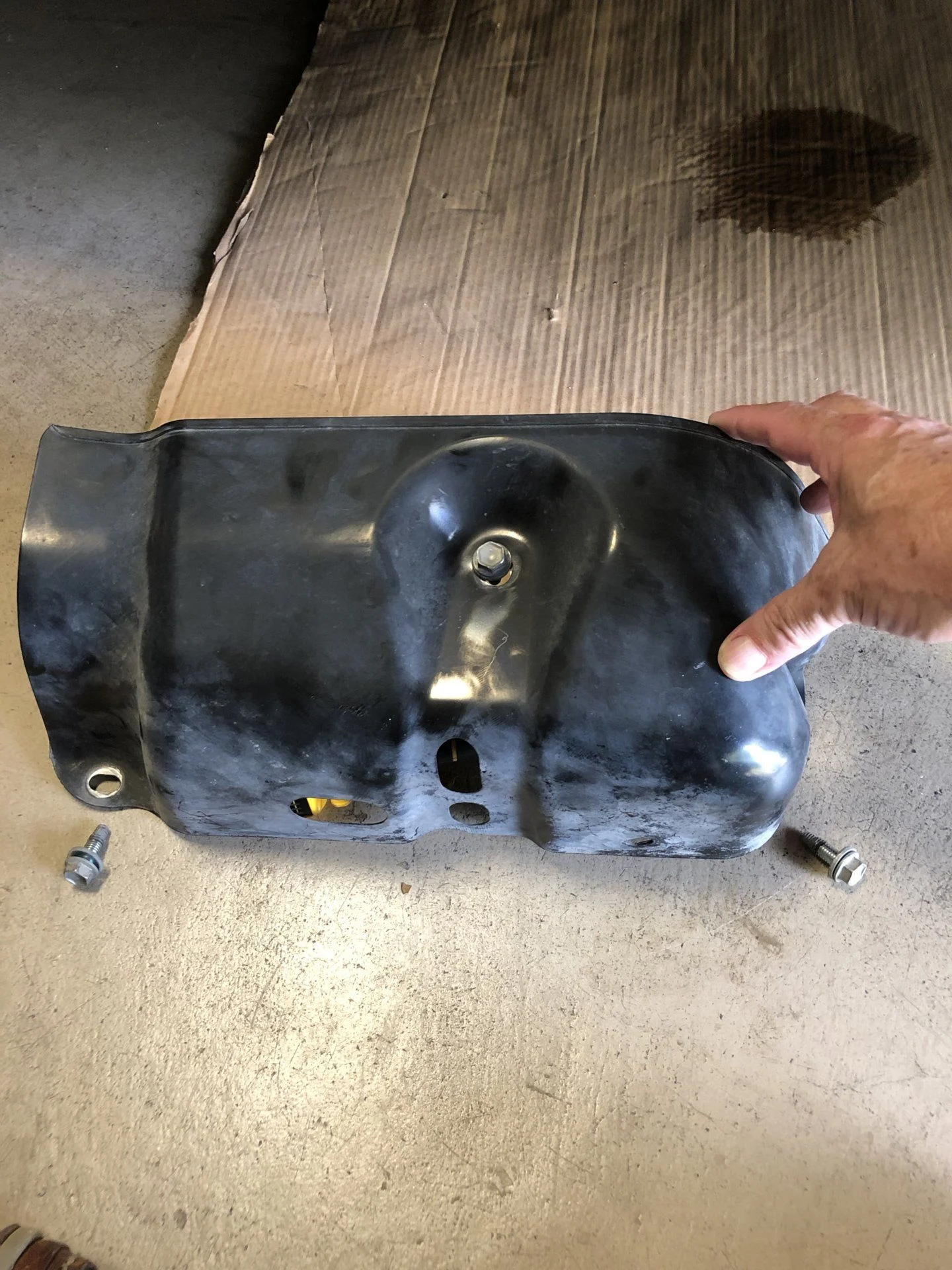

Crawled under my 15 LC today and here's what I found. Some surface rust which I brushed off... most of it anyway. Pulled the shroud off (3 bolts as shown in my pic. Took me a few minutes to find the one in the middle. No need to remove the second bolt to the rear. Its holding on something else.) One hex nut moved easily. The other didn't budge, even with a breaker bar on the hex. Didn't want to force it too much as I'm bad about stripping heads, threads. Hit it with some PB Blaster and put the shroud back on. I'll see if I can break the second hex loose tmrw. Need to get some LPS3 or something like it, so no rush. I think I got lucky on the condition of the valve body.
