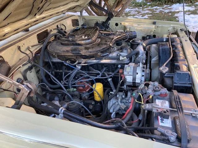

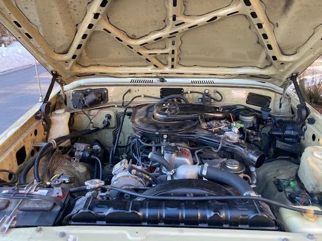

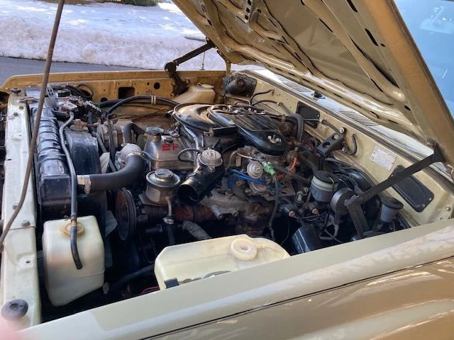

can you tell me anything else about what's been done to it from these pics please?
Hard to tell from the small pics, but it looks like the desmog was not carried out correctly. Go through this guide, then go through it again. Heads up, you're going to need a VCV or two and some new vacuum line.
Otherwise, it looks like your radiator and master cylinder are fairly new. The rubber thing on your battery pops into the top of the fender.
Your distributor cap is missing the vent hoses, and there's no vacuum hose on the outer nipple of the advancer. The outer nipple is for the High Altitude Compensation system, which you may or may not need/want based on your location. Both of those are affected by how your (partial) de-smog was done - most of the vacuum system is inter-related.

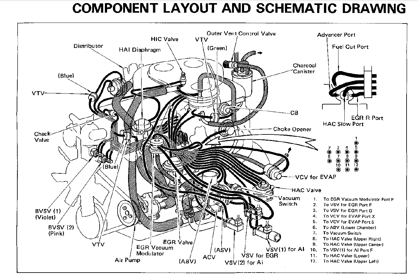

The guide looks very comprehensive but at this stage I'm a little intimidated by it. It mentions welding holes shut - I can't do that. I don't even know what desmogging is, why it is necessary and what the consequences of not doing it are. Can you help explain please?

I suspect the hard parts have already been done. Like 4C said, I’d hone in on the required vacuum connections from the distributor and the HAI/BVSV.

your FJ60 originally came with many parts and systems to reduce tail pipe emissions: Air Injection & catalytic converter, Exhaust Gas Recirculation are the main systems. By the looks of your pictures your truck has had at least the air injection system removed, and maybe also the Exhaust Gas Recirculation. Removing or disabling these systems will effect other parts (eg. distributor advance) that will need to be addressed to have the engine operation optimized.
Because you are already missing key components (your air pump is probably missing or gutted), your best bet is to ensure the desmog has been finished correctly. Identify which parts are there, which are already gone and migrate towards what is recommended in the guide linked above.
