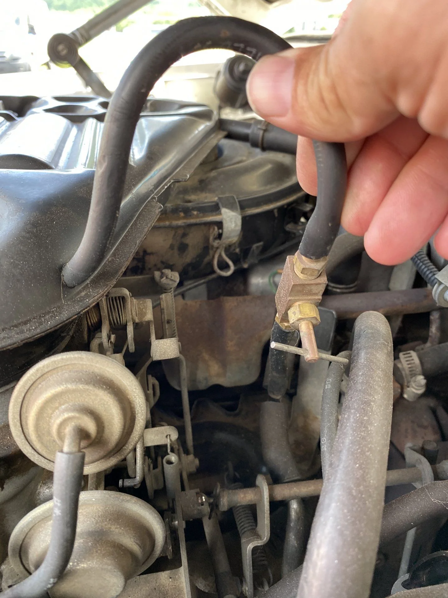

Also check out this little gem I found sitting on top the motor. Variable pitch needle valve for fine tuning... HAHA

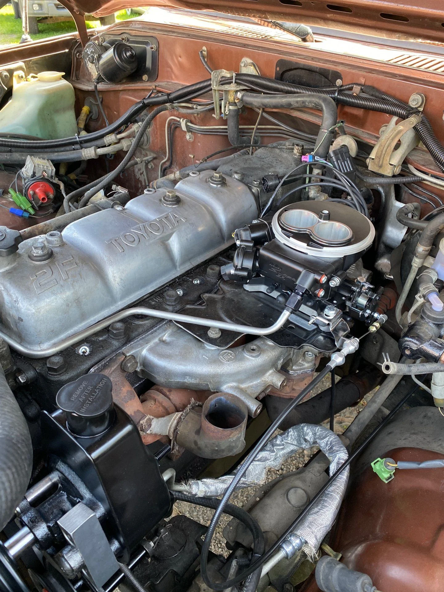

This is THE Guide! Wrapping up my full Jim C Desmog and Holley Sniper install. New Intake & Exhaust manifold gaskets, and removed the cats. Tossed in a new Saginaw PS pump while at it. The Desmog & Sniper Kit Solved all my vacuum leak issues, fires right up and runs super strong now. Tuning and will be GTG by Thursday.
Does your stock tach still work ?
