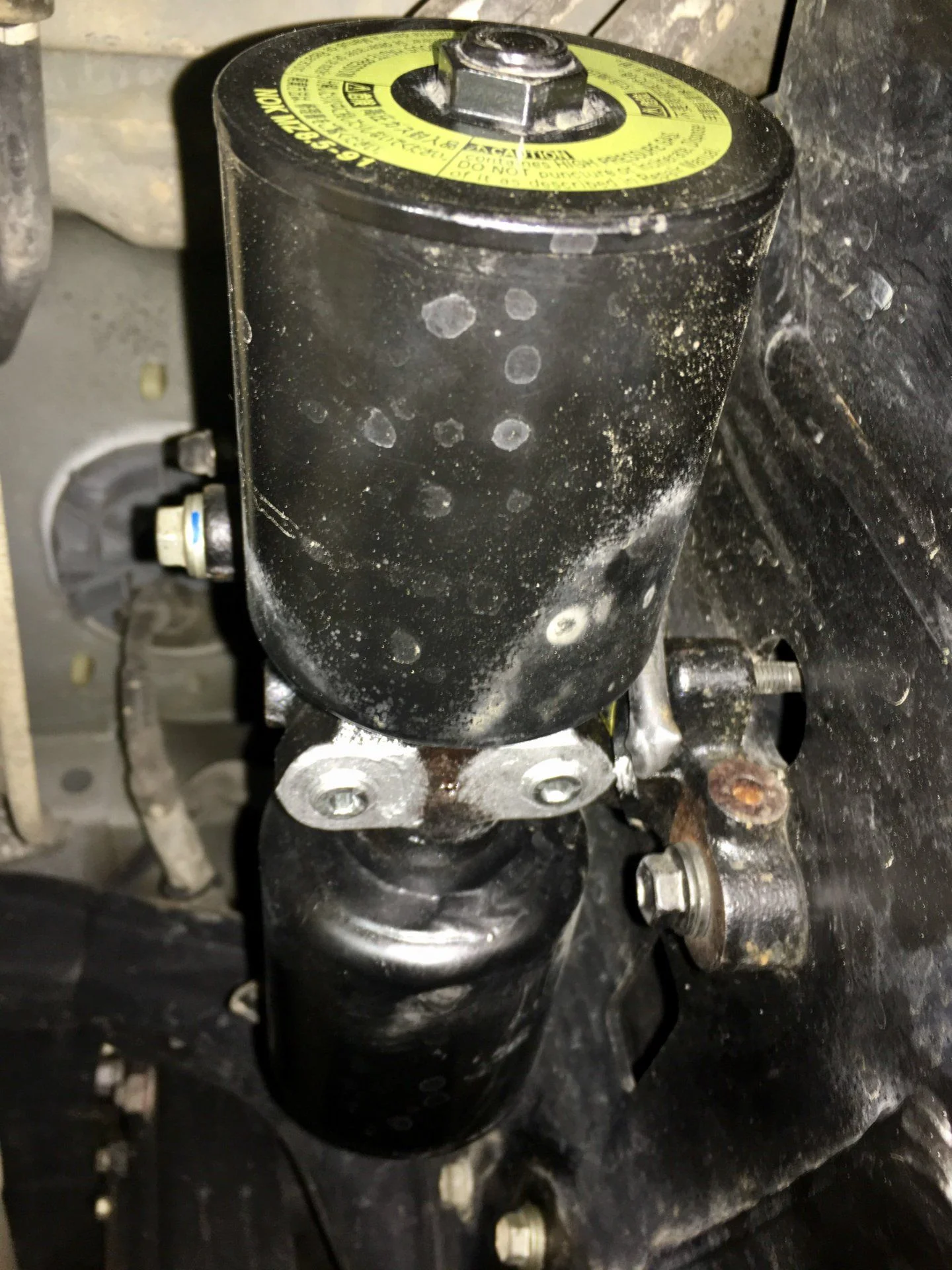

First off, a big kudos to @NLScooby for helping out the community with this thread:
KDSS - UNfrozen! :) How I did it...
Tonight, after spending the previous seven days spraying Kroil, picking, and tapping - a beautiful thing happened...
I hit my KDSS adjustment screws with one final spray of Kroil - waited 30 minutes - and then broke out my 5mm socket and 1/2" socket wrench with a long handle for leverage...
Just a little bit of pressure and with a distinct metallic POP!, the frame side adjustment screw turned with very little effort. I moved to the outer screw and experienced the same result - whew... what a relief. I was so excited that I forgot to snap a picture of those beautiful threads before slathering them in anti-seize :)
I used my pick (to mark the screws for reference) and loosened them three turns each; then applied a liberal amount of anti-seize, tightened and then loosened both a few times, before finally torquing the fasteners down to the required 10ft lbs per the recommendation of @gaijin here:

With all wheels on the ground, tighten the shutter valves with a 5mm hex wrench - Torque: 14 Nm (140 kgf/cm, 10 ft/lbf).

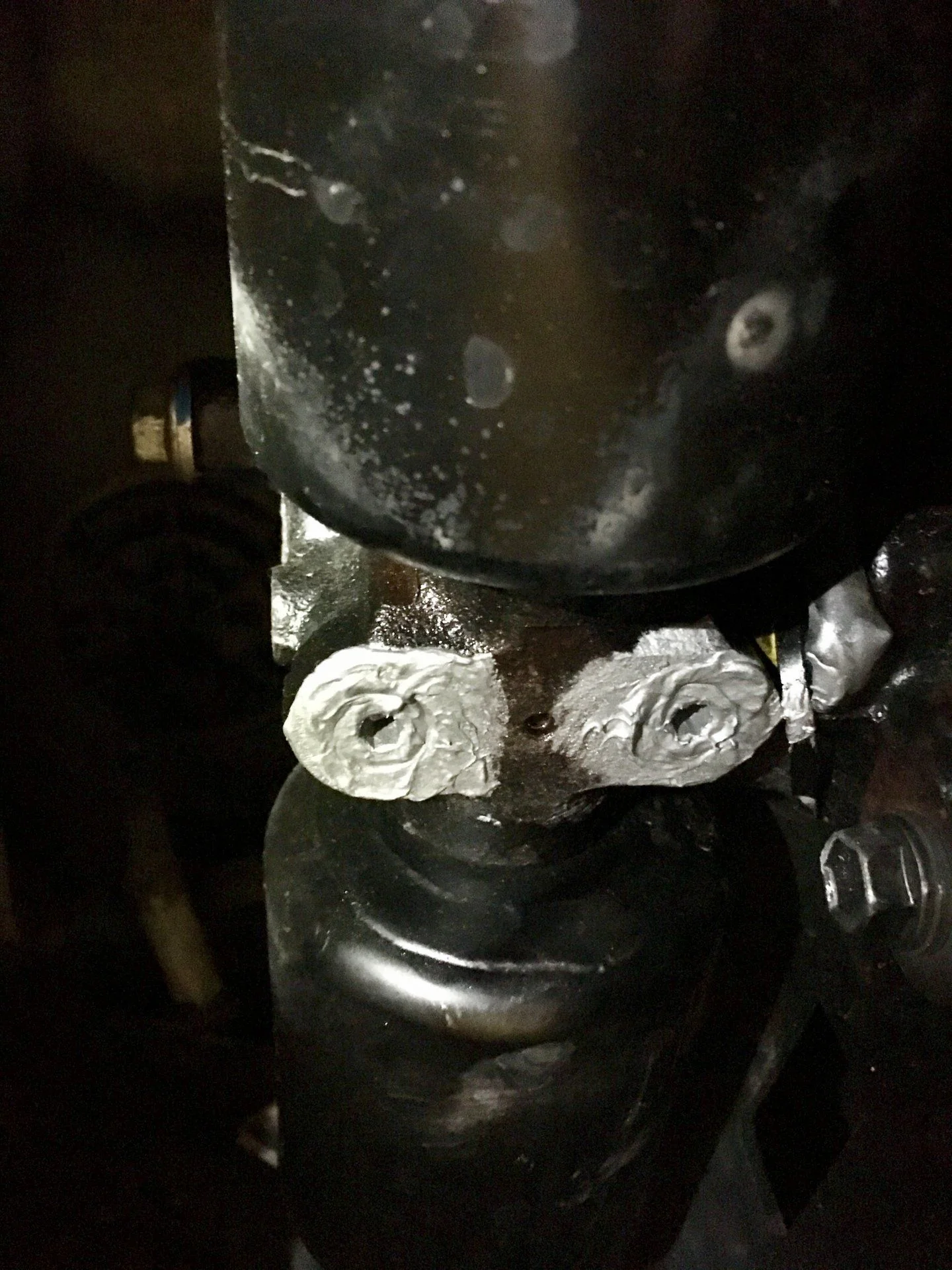

All buttoned up:
I'm glad to have this complete with the peace-of-mind that comes along with a KDSS that is adjustable should I add OEM front spacers, a lift, or have to correct "KDSS lean" down the road. After reading the above thread months ago (along with some horror stories about stripped screws, etc.), this job has been on my mind since buying my 200 last fall.
Thanks again to @NLScooby and @gaijin for their shared knowledge and to Kano for concocting Kroil - such a kick ass, quality product. That stuff is not cheap, but it's worth every penny. It melts rust like an Eddie Van Halen guitar solo melts faces:

Congratulations! I know exactly how you felt to hear and feel that little "release". It's all about patience, grasshopper.....(which I am known to have little of....)
