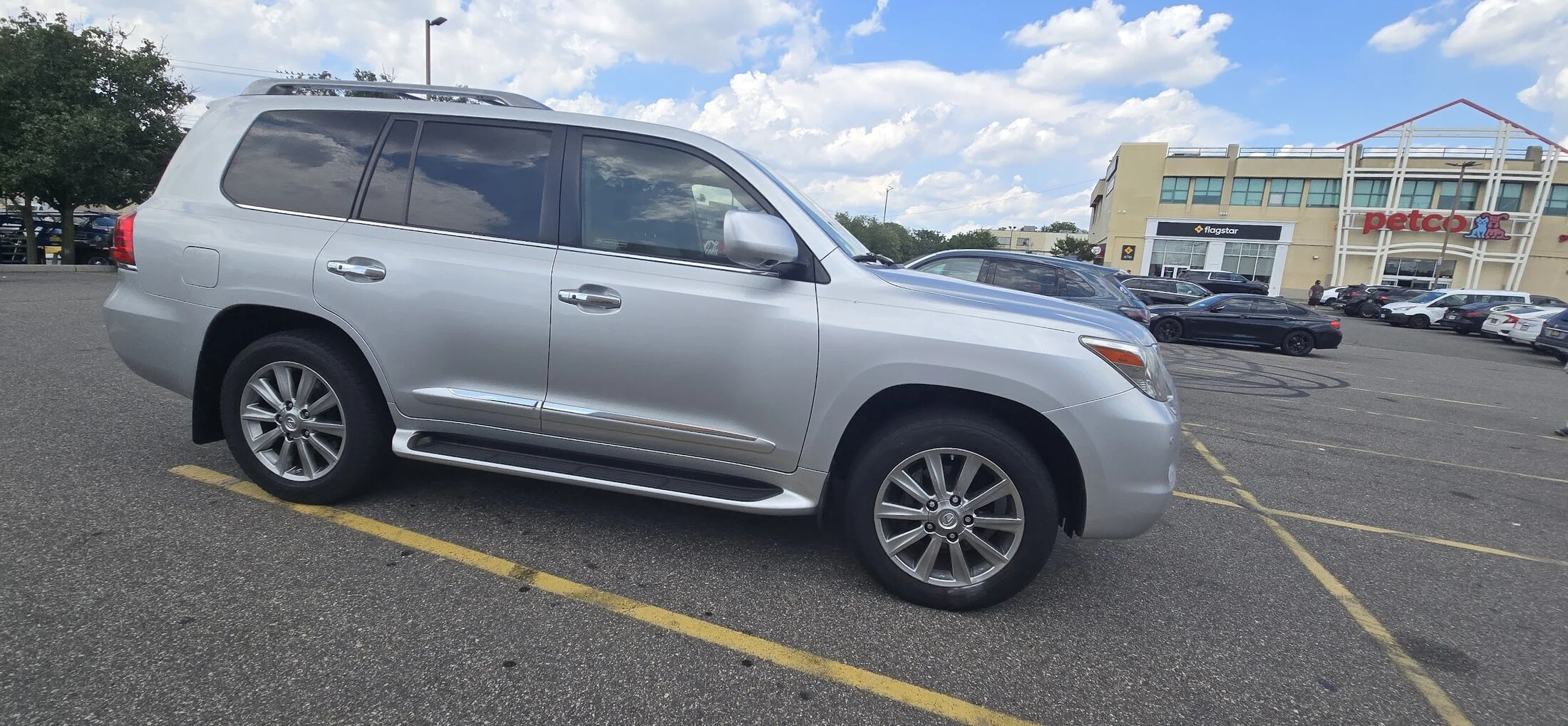

Grabbed a 1 owner, 124k mile 2011 for $27k. Texas owned vehicle its whole life. First time buying and shipping a car sight unseen. Still waiting on delivery but excited to finally get into a 200. Will post more pictures upon arrival. Will probably keep it mostly stock for now after doing a baseline of fluids, checking for radiator cracks/oil leaks. How does the undercarriage look to you? How did I do on the price?
I've been out of the pricing game for a long time but the undercarriage of that example looks better than average, even for a texas vehicle. They probably didn't even take it skiing or to the beach.
Congrats on the find!
I don’t know much about pricing for this vintage but that looks like a great example in a great color. Undercarriage looks very good. Nice work and enjoy.
Let the fun begin! If it's now going to live in NY, be sure to get some Fluid Film or equivalent on the nice undercarriage.
Definitely want to do fluid film or woolwax. Need to find a good shop that will go inside the frame rails and everything.
Doesn't get cleaner than that underneath! Undercoat it if it's going to see winter of course. Price seems fair for a clean 1 owner.

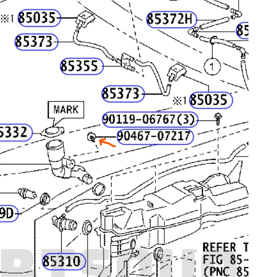

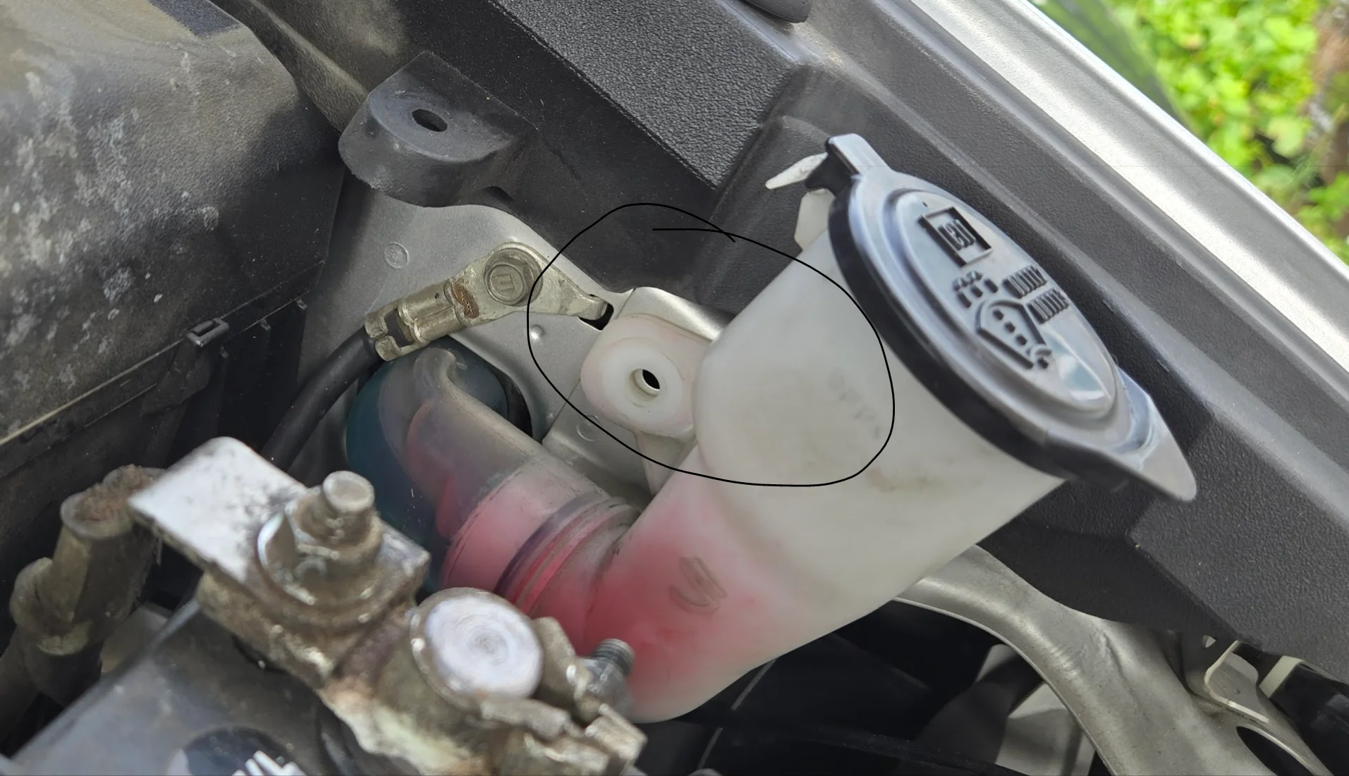

Looks like the previous owner lost the fastener for the windshield wiper fluid neck. Does anyone know if this is a fastener or a bolt? If bolt, does anyone know what size or where I can get a replacement?
That is a plastic rivet.
90467-07217
They are the same part number

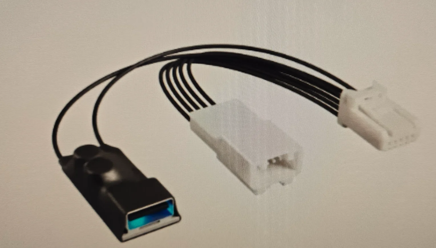

So it turns out, the 2011 LX does not have the 10pin adapter for the rear-view mirror and instead has a 5 pin adapter. I finally found this daisy chain 5 pin adapter for USB power but it does not send enough power to the USB camera. The rear view mirror LED does light up when I plug this in, but the dashcam wil not power on. Has anyone found a solution for the 2011 to be able to wire in a USB powered dashcam into the rear-view mirror or maybe some ideas on how I can get this one working?

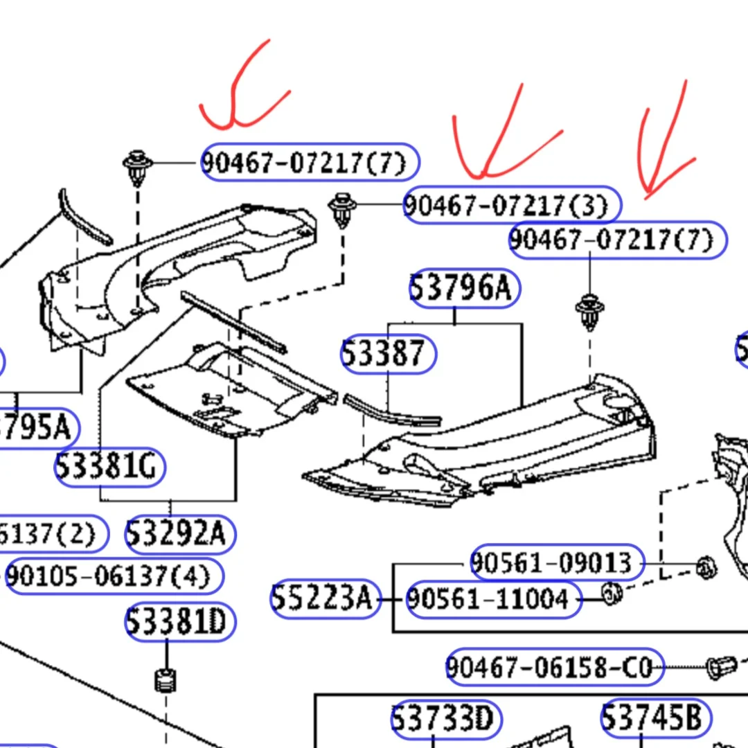

Seem every time I pop my hood I’m missing one of these. No signs or wear of the holes and nothing looks out of the ordinary
Most were missing when I got the truck, replaced them all. Now a couple more have gone missing again. I dunno how or why
I bought some different ones for mine. Will have to see if I can find the part number. They are tight as I was always losing the stock ones even when replaced with new ones
