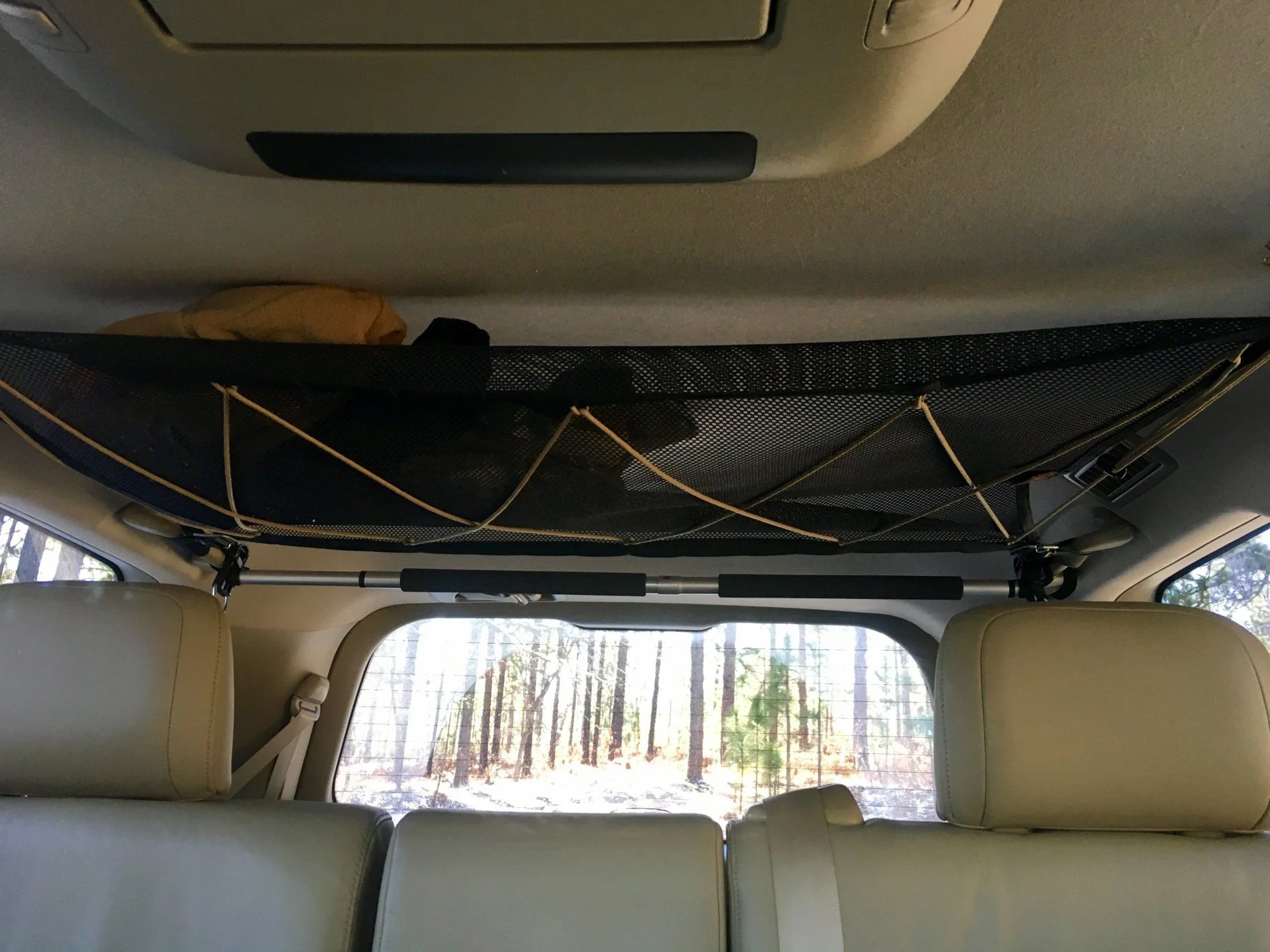

Interior organization:

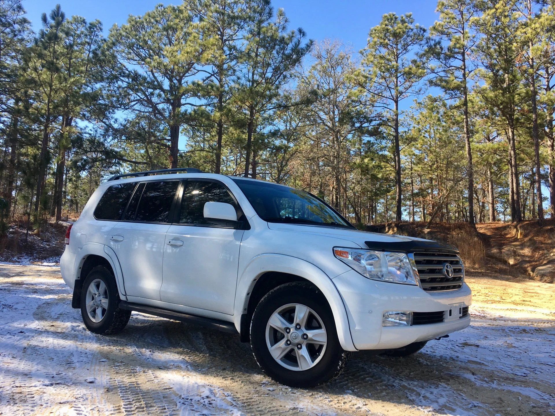

In November a white/tan 2011 LC surfaced on Autotrader. It was just across town, relatively speaking, so I drove the two hours to Charlotte to check it out a day after the ad hit AT.
It was a zero-rust, squeaky clean southern truck with 121k on the clock. The vehicle was at a small used car lot. The owner of the business was selling the LC for his friend; interestingly enough, he had found the vehicle for him less than a year earlier. Apparently his wife didn't care for the size of the Cruiser and refused to drive it, so they opted to go the minivan route - sound familiar :)

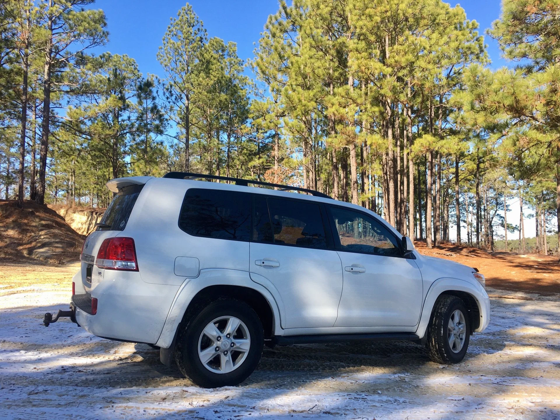

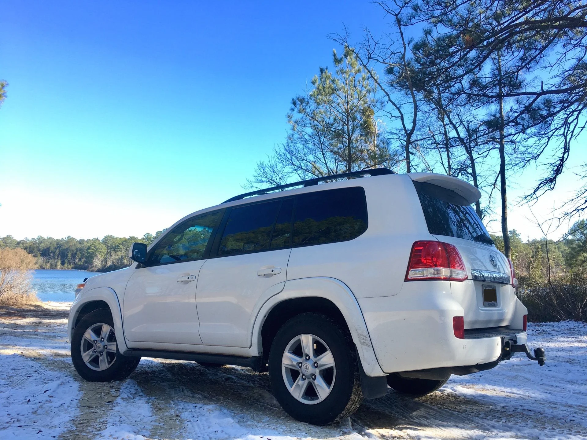

Some photos:

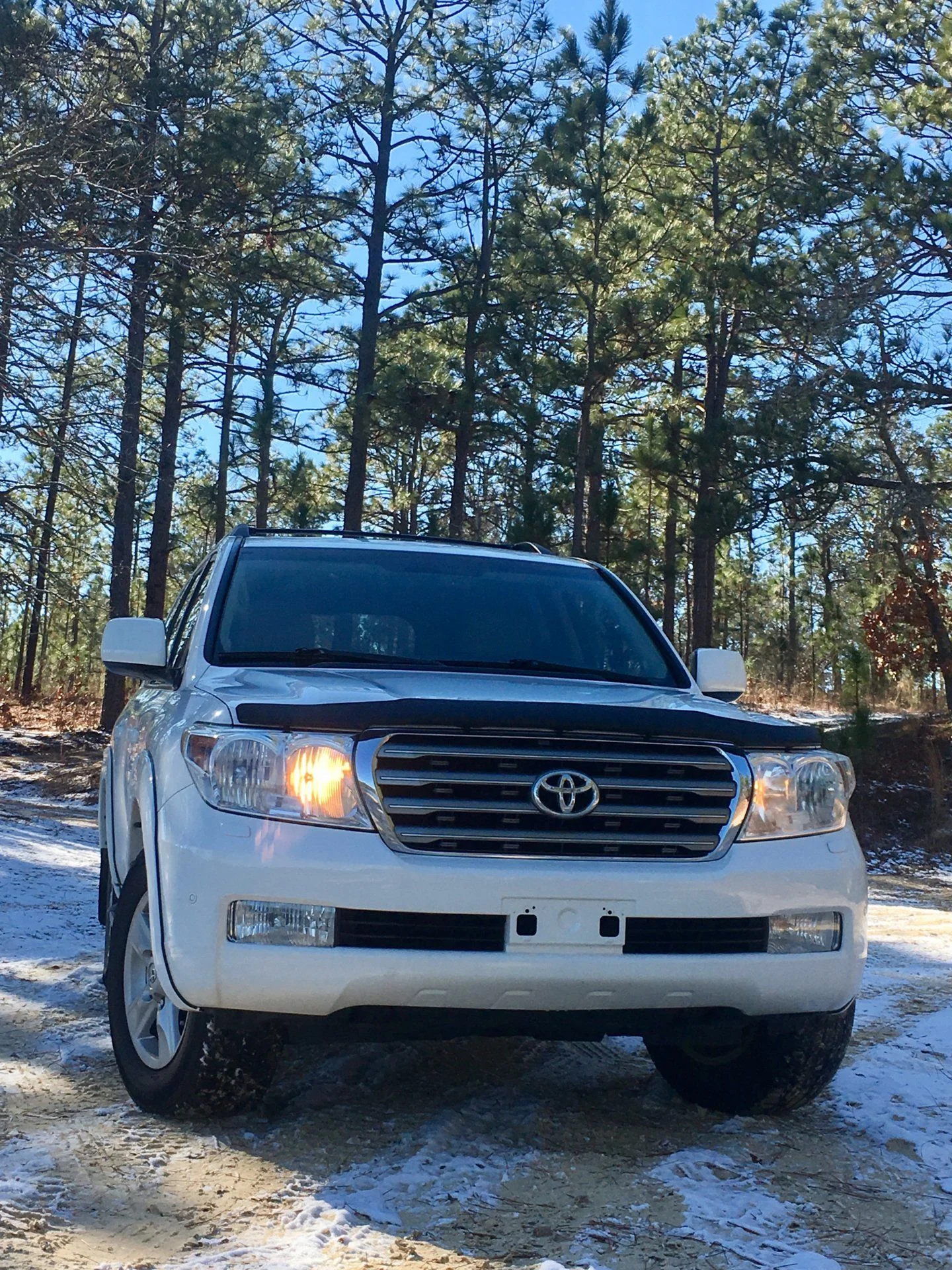

The LC came with an OEM Toyota bug deflector. I'm not sold on the mustache look of the black deflector against the white paint. I've contemplated painting it Super White to match the vehicle and blend in a bit more, hopefully I'll get some time to knock that out this spring.

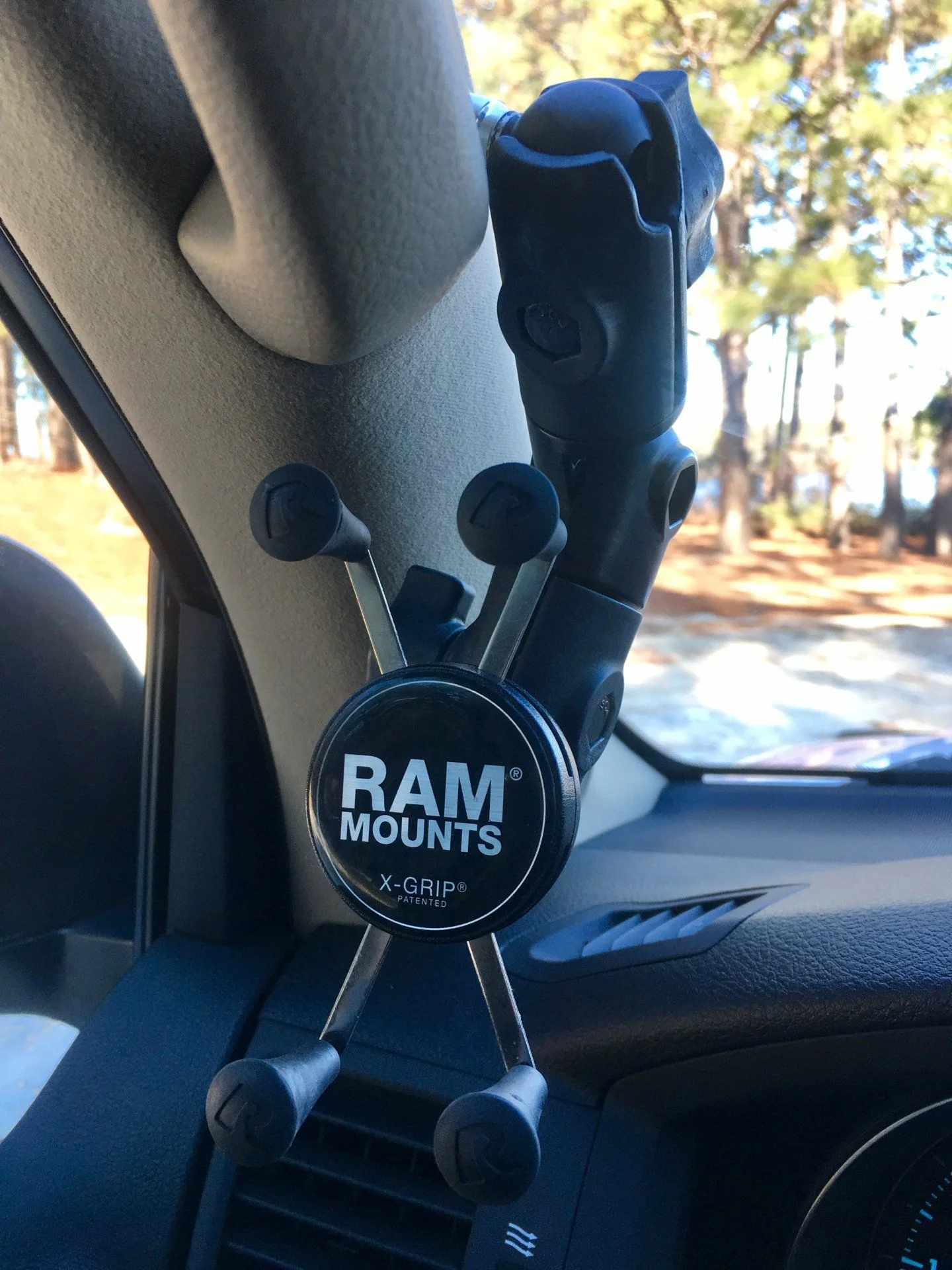

As of now I've added a RAM mount / small X-Grip (utilizing the lower mounting bolt of the drivers side grab handle), Husky Liners (front/rear), an Attic from BROG, and placed the third row seats in storage. Down the road I plan on upgrading the electrical system with a Group 31 battery and BlueSea components (similar to my Tacoma).

Interesting fender flairs, those must have been installed at the dealer when new? I don't have those. What brand?

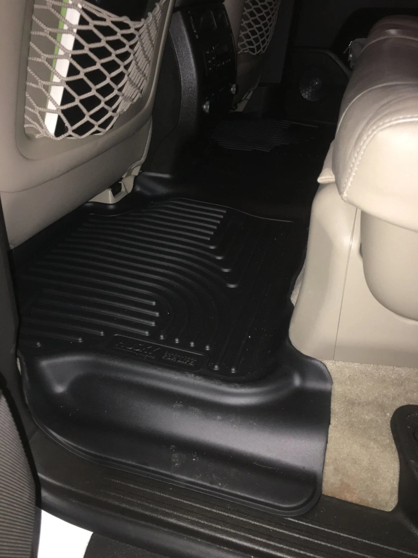

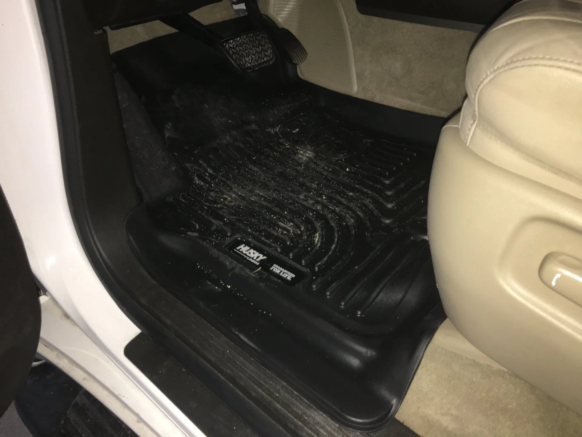

Didn't see an application for the 2011 on Husky site so do the later model liners fit or were there any changes? Yours look like they fit well.

From my research, and someone with more knowledge please chime if I'm incorrect, these flares were added to vehicles within the Gulf State region by Toyota. That's the best info I have.
The fit is great and I like the look; it really breaks up the white well and I enjoy the aesthetics as well as the added protection from door dings / rocks kicked up from the tires. My only complaint is some of the clear coat has peeled at the very top of two of the fenders. I cleaned them all really well about a week after purchase and gave each fender a few coats of wax to hopefully prevent any further peeling. We'll see if that works.
I didn't notice the fender clear coat peeling until I was refueling for the first time. That's the only real blemish I could find with the vehicle, so I'm pleased.

check out the posts from Ethernectar on adding a ram mount to the A pillar bolt. It may interfere with the side curtain air bag.

Yes, they fit. Though the floor hooks do not line up with the 13+ floor mat holes, so I removed them. The Huskies are very rigid and do not move around, therefore the floor hooks are not really needed. I picked up four 7/8" plastic plugs from the hardware store to fill the unused hook holes. They are a little too big, but I forced them in with some trimming to the inner lip of the plugs.
I came to the same conclusion as you and originally settled for Weathertechs. After being underwhelmed with the fitment of the WTs, I tried to make them work and posted this thread on Mud:
Dead pedal liner/cover - my attempt at fixing WeatherTech's shortcoming.

Good point. I actually thought about that when I installed it. I didn't see his specific thread, but actually carried over the application from my Tacoma. I'll do some digging and may switch back to my RAM windshield suction mount. Thanks,

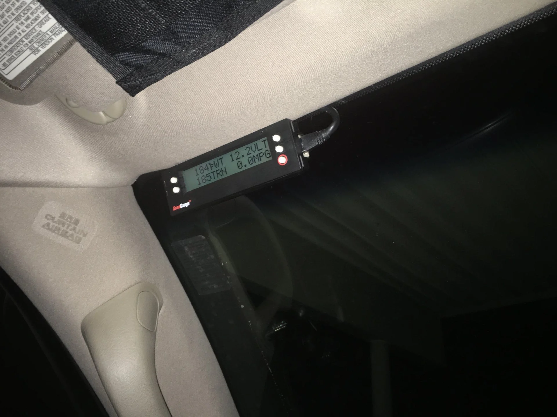

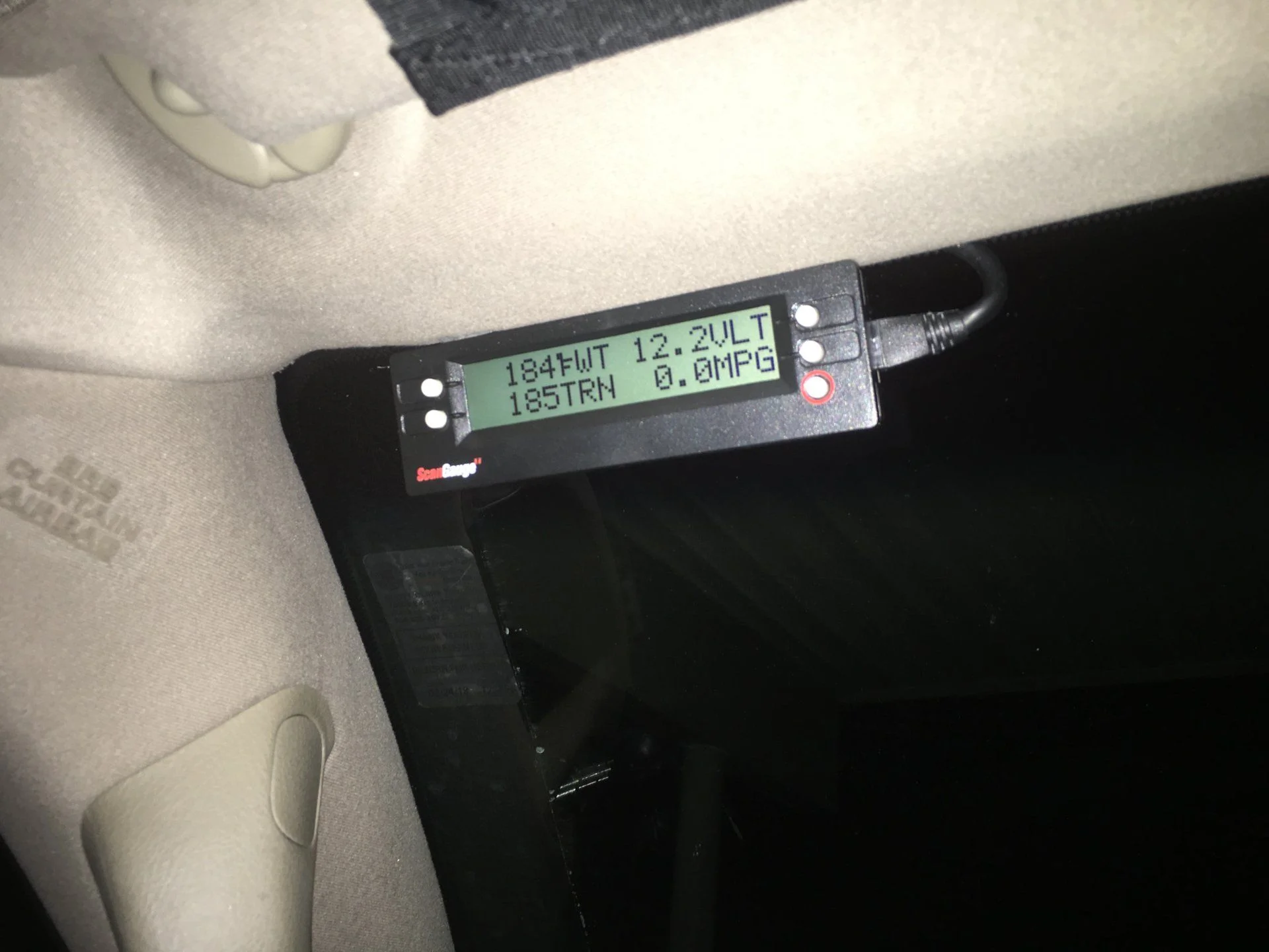

I also moved my BROG Visor Molle Pouch and ScanGauge II from the Tacoma to the LC. The Visor Pouch is an excellent use of space. I keep my registration/insurance documents in there, along with a pen, mechanical pencil, tire gauge, notebook, and a small book of stamps. All small items that are convenient and within reach of the driver.

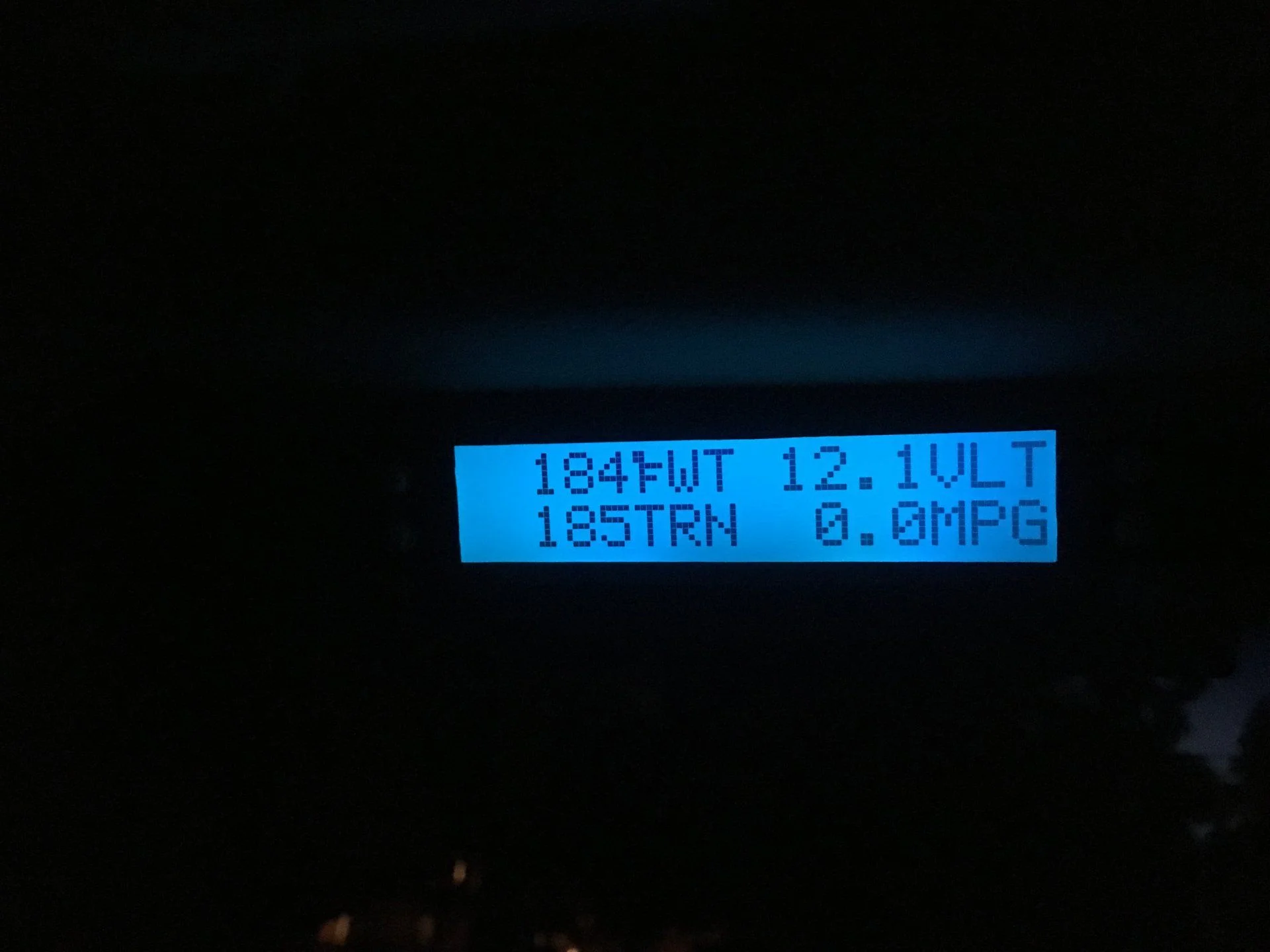

The ScanGauge II is great. I like being able to view the actual coolant temp, trans temp, voltage, and calculated MPGs via the readout. I dialed in the backlighting to a soft light blue (to match the gauges) and fixed it to the lip of the headliner with two belt clips (removed from a couple of cheap measuring tapes) and 3M HD trim tape. I stumbled upon that idea a couple of years ago on Tacomaworld. It's held strong since then and I like the HUD location.
Nice ride! I know this has been covered elsewhere, but since it's fairly fresh with your install, could you post the X-gauge commands to read trans temp. I'm going to try them with the 8 speed.
I added that X-Gauge command when I installed the ScanGauge II in my Tacoma. That same code read the trans in the LC as well.
Without going to the garage to check, I believe these are the codes I used:
IIRC, I could only get one of the codes to read at the same time - maybe they're pulling the same data, not sure? I just renamed the first X-Gauge command "TRN" and called it a day. I might play around with it some more in the future.
Let me know if these work.
Nice truck, best color combo available!
Note that those bug deflectors will prevent the front edge of the hood from getting cleaned, the edge will cake up the dirt and gunk and can cause rust on the front edge of the hood. If you run one, make sure to remove once a year or so and clean underneath. Ive removed many deflectors from old LCs, and the condition of the front edge of the hood underneath will make you gag.
Yep, those are factory Toyota flares. They have the same problem as all fender flares since the 80 series. Something about the paint bonding process to the plastic, they always fade and degrade faster than the paint on the vehicle.
Note that only the flares have clear coat. The rest of the vehicle does not have clear coat. That Toyota 040 white is a single stage paint, which I prefer, because when it starts to oxidize in a few years, a simple clay bar will shine it up again.
The good thing about the flares on the 100 and 200 series is they didnt put holes in the door to attach them like they did on the 80, so if you decide you don't like them, you can remove them without needing to fill up a bunch of holes.

I like the scangauge job. Would be really nice to have when pulling a trailer.
