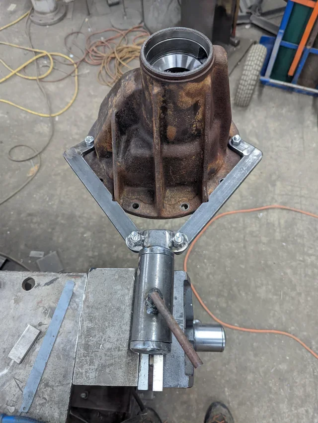

You'll want to build or borrow a third member clamp/holder (shamlessly stolen image
if you do it yourself. They are a concentraded chunk of iron and difficult to work on without the holder.
Other than that, its not that bad a job if you can follow instructions and have the tools already.
