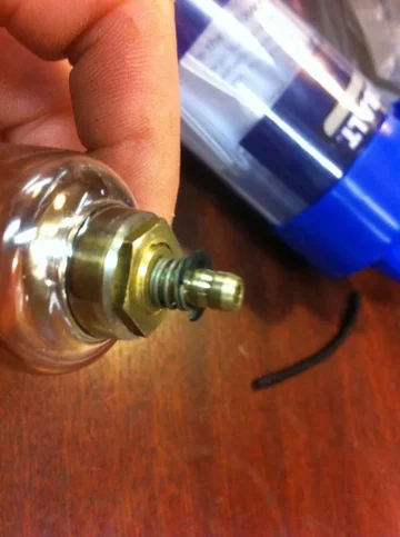

Husky Oil Separator
So I stopped into Home depot and picked 2 Husky separators. A quick check of the value at the bottom seems that it does not close... What am I missing here?? Did I pick up the wrong one?
I imagine if you applied air pressure to it like its made to be used, it would close. Thats why people are messing with the drains, i.e. JB weld, o-rings and bolts etc.
