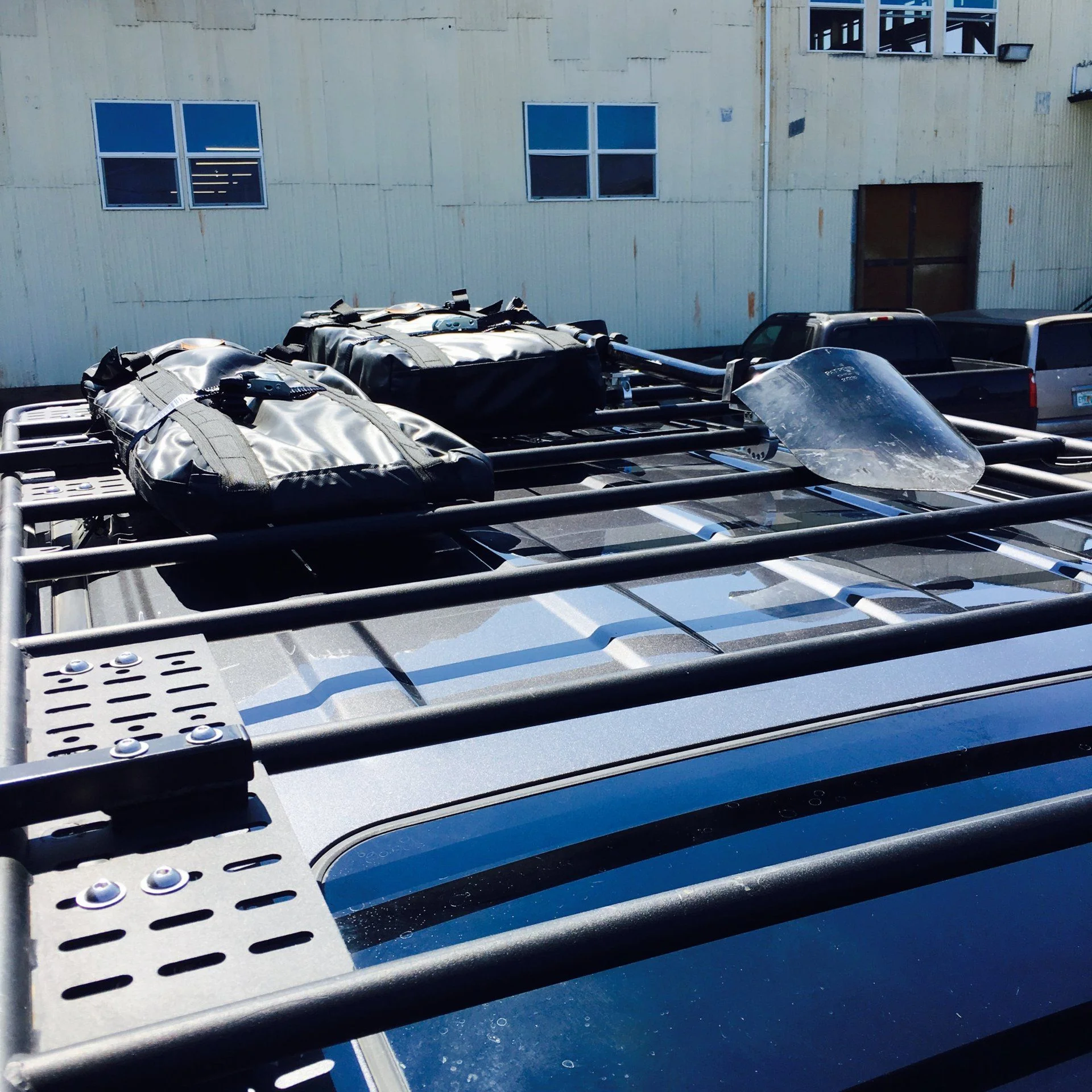

Roof with Shovel, Maxtrax, and Traction Jacks. It's nice having a lighter roof setup as my JB Tent + Roof Stuff before was probably 300 lbs.

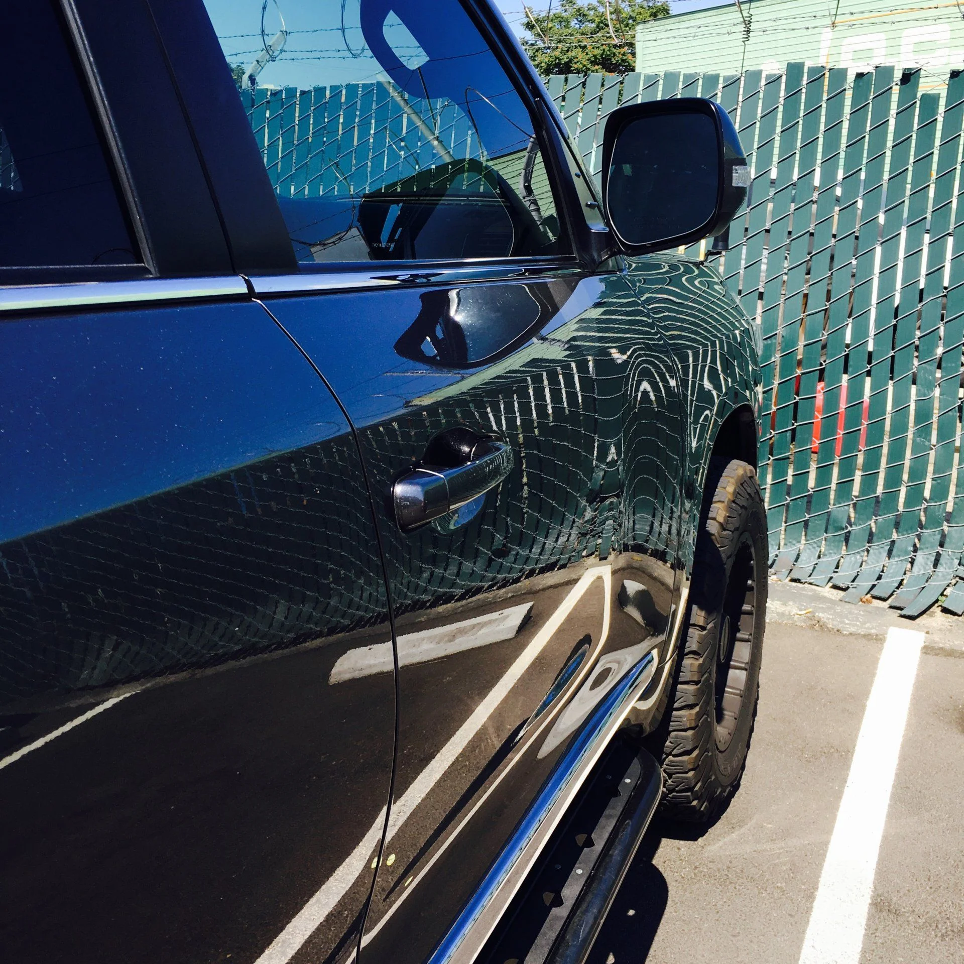

My budget Procomp wheels have taken a beating and it was getting hard to keep track of all the scuffs to discern between cosmetic and serious damage. So, I applied Plastidip to all the wheels so now it'll be easier to see new damage. It looks better as well.

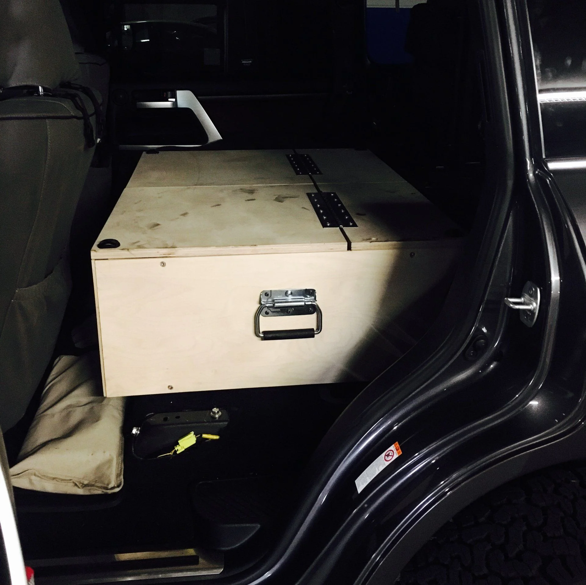

We're heading out for a 3-4 night trip to Death Valley and Papoose / Mazourka Peak. For this trip we removed the rear seat and installed some squibs to address the SRS light.
More detail on the squibs for the second row please!
I generally used the parts/method from this thread: 2nd row removal and SRS fix.
I did end up just grabbing the resistors from Digikey as I was already ordering other parts from there: FMP200JR-52-2R2 Yageo | Resistors | DigiKey.

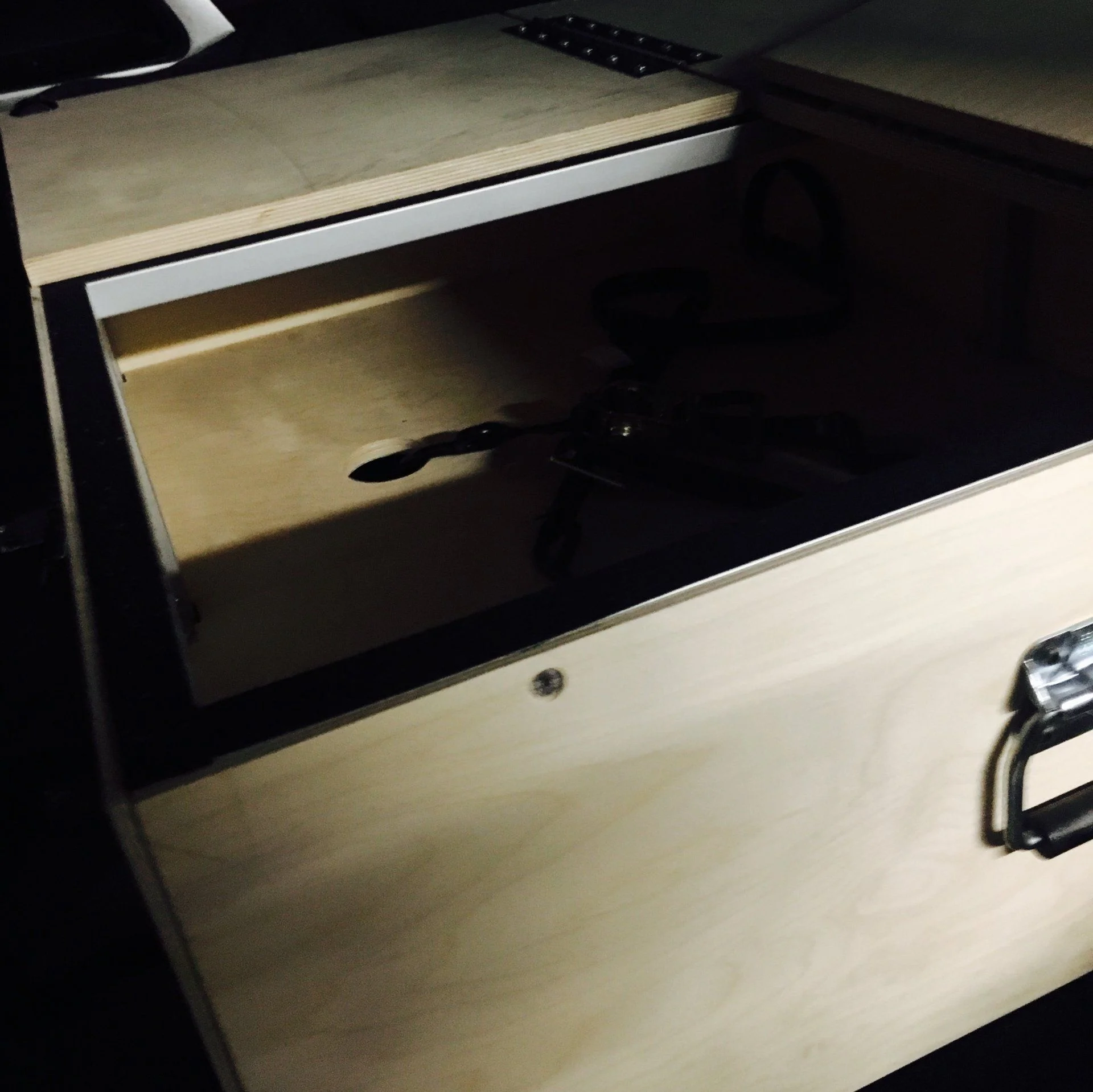

I've also finished the second version of a middle row storage box. It's an aluminum frame with 1/4-in baltic birch exterior and a 3/4-in baltic birch top and bottom. It's mounted using ratchet straps on the inside but I'm building some custom brackets over the longer term to utilize the seat bolts.
The wood panels are secured to the aluminum frame using nutserts along with some Loctite. Given the frame/plywood connections I was expecting some significant noise to chase down but I haven't heard much yet. We'll see how it does on the trail.

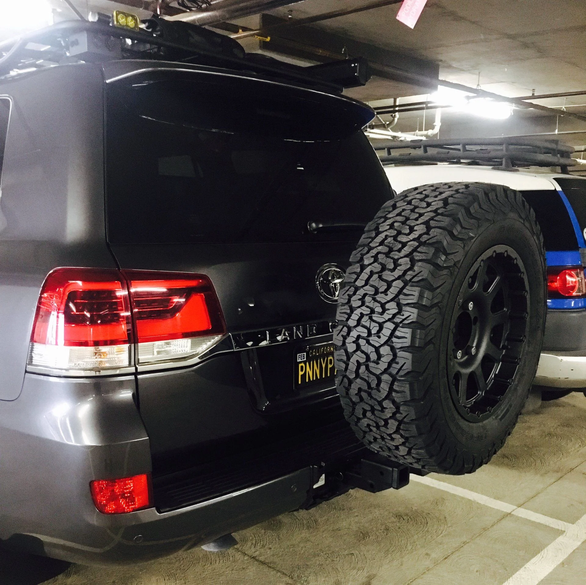

Very nice! Any plans on getting the Jerry Can or Rotopax attachment for the hitchgate? Or is this just a temporary solution until the Slee bumper is ready?
I expect this to be a temporary solution. My rear bumper cover has taken significant abuse in its young life so I'd like to get some adequate protection.
I may check Craigslist for the Rotopax attachment (there's no option for jerry cans for the Solo version) but I'm usually okay with storing fuel/water inside the truck.

Looks good! I need to finish the top on my 2nd row box too. What are you using for latches?
I am digging the Hitchgate. I'm running a non swing out ARB rear bumper and this might just be the solution to getting a full size spare back there. Did you get the off set one? The extreme high clearance one? It looks like the basic centered one, does it clear the tail light easily? I'd love you impression after wheeling with it, is it really super tight and rattle free? Any details you could offer concerning this one product would be appreciated. Thanks!
Thanks! Also, you saved me a couple bucks after I saw your quick-frame approach as I'd been planning on using t-slot extrusion. The raw material cost isn't much but all the hardware and time to machine it adds up. I'm using these latches from McMaster -- McMaster-Carr. I just have one on each lid but two would probably be a bit better.
This is the standard height Solo Hitchgate that I snagged for $300 on Craigslist. I do not suggest the high clearance version as there's no way the tailgate would be able to come down all the way. There's about half an inch of vertical space between the high point on the hitchgate and the bottom of the tailgate. It barely touches when sitting/standing on the tailgate so I applied some felt tape to the hitchgate as a precaution. There are no issues with the tail light though it may be close if you're running 35s.
We went camping this weekend and spent some time on some Santa Cruz mountain fire roads and didn't even notice it was back there. It's probably one of the sturdiest devices we've installed in the hitch. There's a tightening device built into the hitch mount itself that seems to do a solid job. It's no replacement for a bumper but it does the job for me. I had previously looked into the regular hitchgate or the max version but realized I'd drop $1000-$2000 before it was all said and done.

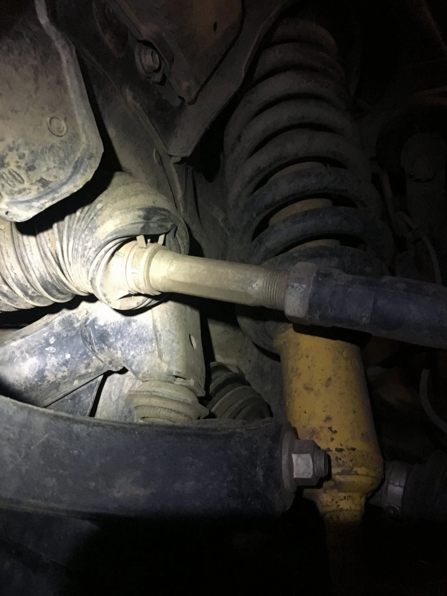

Mechanically-inclined people -- does anything look strange in the picture below?
I was inspecting the undercarriage this evening after hitting my LCA on a rock and thought that the boot above looks weird. It looks like this on both sides.
Looks like broken inner tie rod end.
