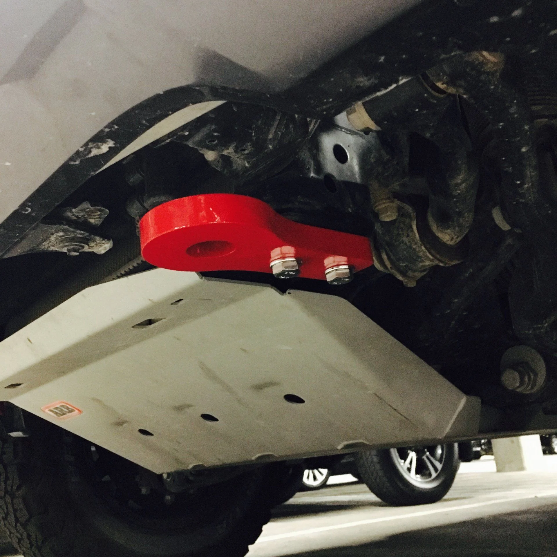

I installed Tow Points and RLCA Skid Plates from @reevesci this week. The quality and service from Trail Tailor is top notch.
Even though these were minor modifications, I came away with some new lessons. First, I learned that my $35 torque wrench is wildly inaccurate after breaking one of the stock screws for the tow point. I had it set to a torque of 79 ft-lbs and it was probably torque-ing closer to 120 ft-lbs. I replaced the stock screws with some M12x1.25 55mm screws with a bit of blue loctite. I also picked up a Precision Instruments 1/2 Drive Split-Beam torque wrench and torqued the new screws to spec. Extracting the broken screw wasn't too bad as there was enough thread left peaking out of the frame that I was able to use some needle-nosed vise-grips to rotate it on out.
I also encountered some challenges with the RLCA skids due to operator error more than anything else. First, I had trouble getting out the RLCA bolt and then realized I was trying to loosen the bolt head instead of the nut. Second, unbeknownst to me my driver side RLCA housing had already taken a pounding and the skid would not fit over the housing. Hammering didn't help but I was able to reform the housing with some large vise-grips. I drilled a couple holes, installed the thread-tapping screws, and the driver side was all done. For reference, I'm going to powder coat these at some point but I wanted to get them fitted for an upcoming trip and the powder coating machine I use at a local shop is out of commission for a couple months.

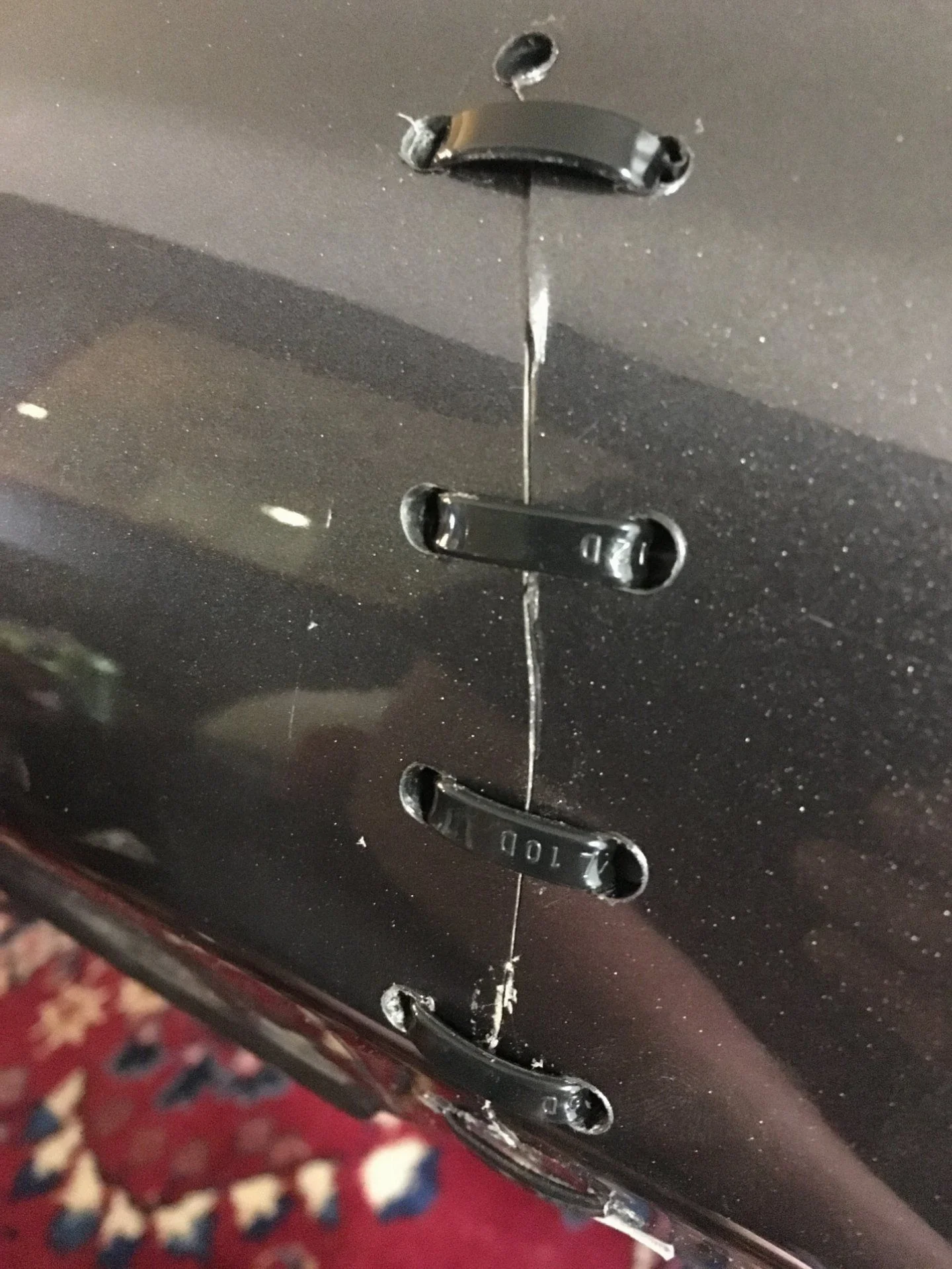

Also, I made a medium-term fix to my bumper after some damage during a recent Death Valley trip. I'll probably end up getting a steel bumper instead of buying and painting a new plastic bumper.

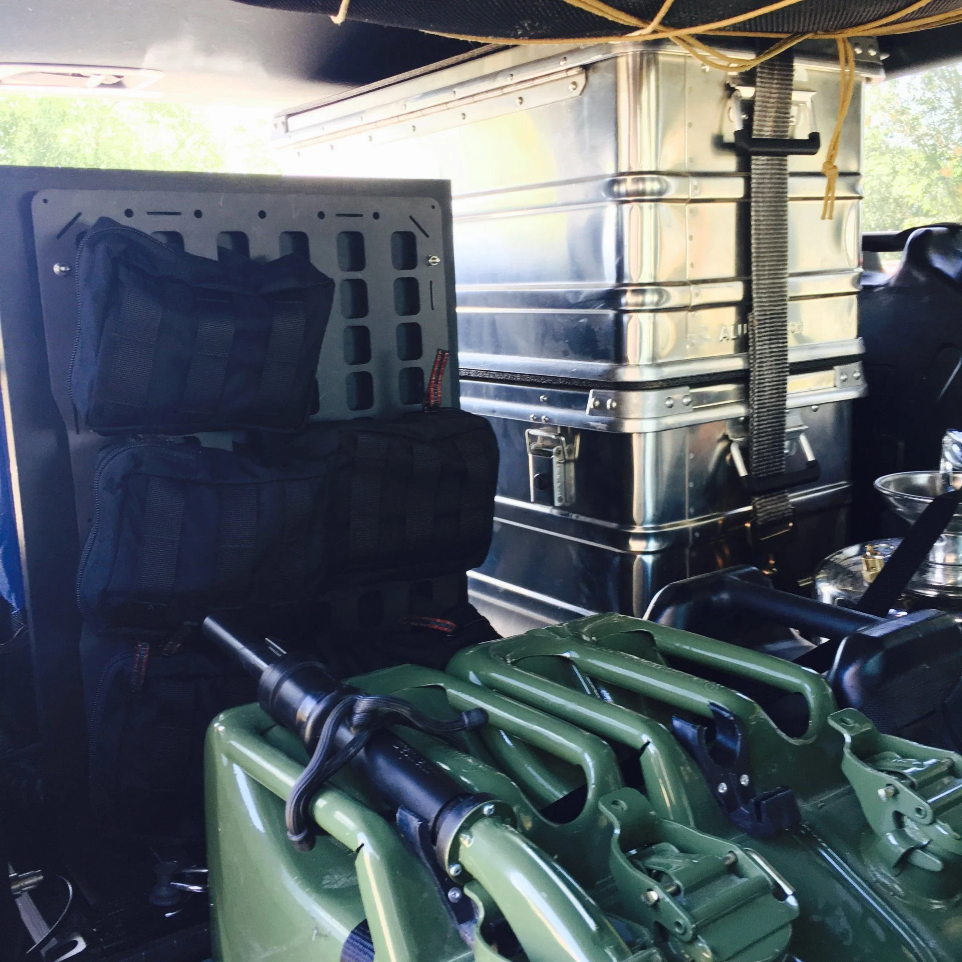

I utilized some leftover baltic birch to create a simple, two-sided molle panel. I used two rigid molle panels from Greyman Tactical which worked perfectly. I'll just use a ratchet strap over the top to secure it for offroad travel but there's some heavy duty velcro on the bottom of the panel mount to keep it steady for normal driving.
I guess I didn't snap any photos of the other side... it looks the same but with different stuff mounted :)

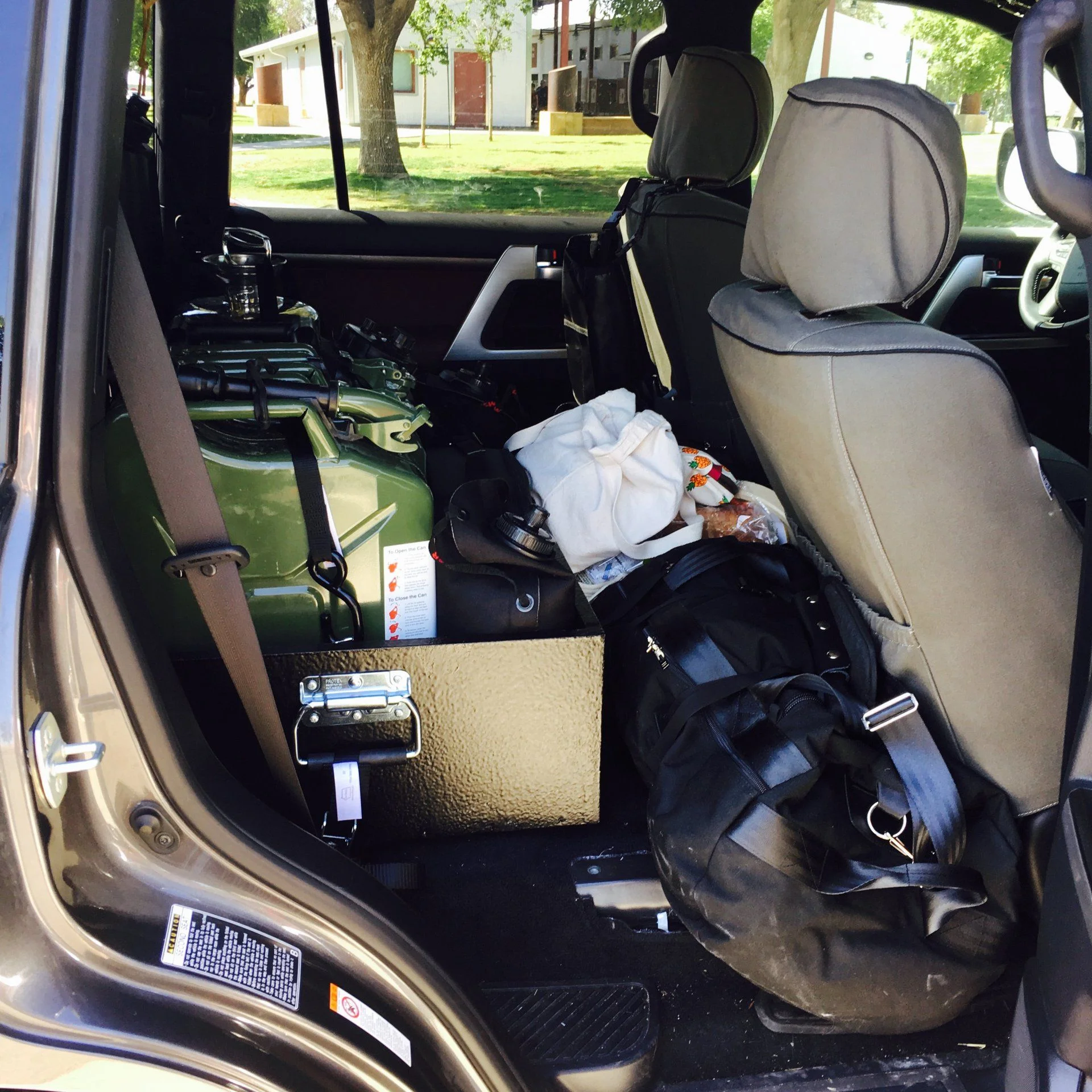

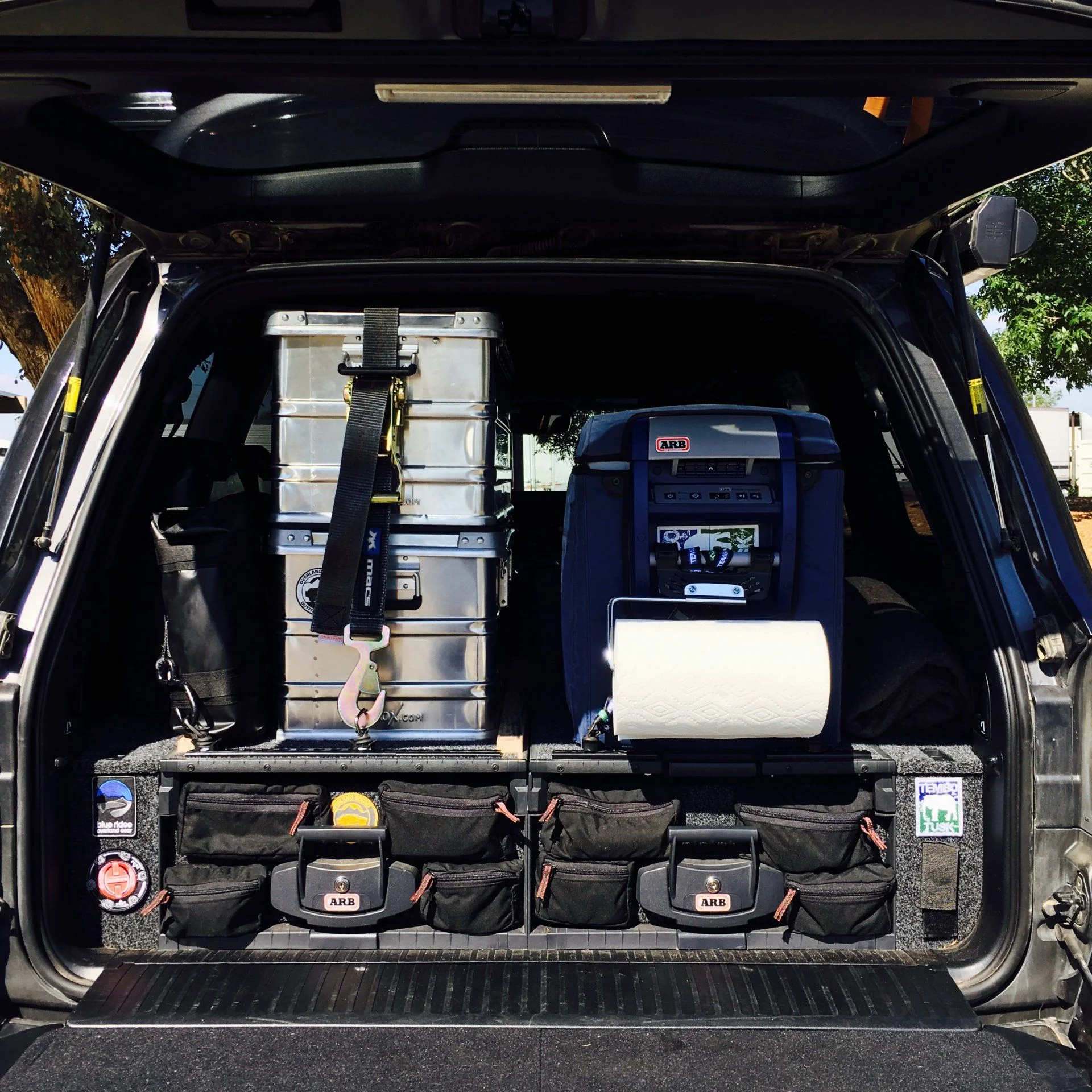

We're heading out for a 3-4 night trip to Death Valley and Papoose / Mazourka Peak. For this trip we removed the rear seat and installed some squibs to address the SRS light.
Yeah, we're not light packers.

I think you need bigger tie down straps for the boxes in back. :flipoff2:
Nice set up. :steer:

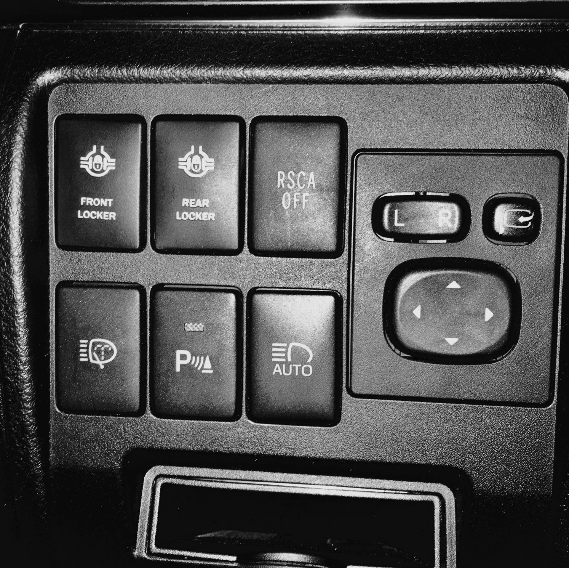

I opted for the air-on-board switches. They're wired so that the front locker will not activate unless the rear is active. I'm thinking of installing a locker kill-switch either in the cabin or under the hood for when other folks drive the car. Do folks do this?

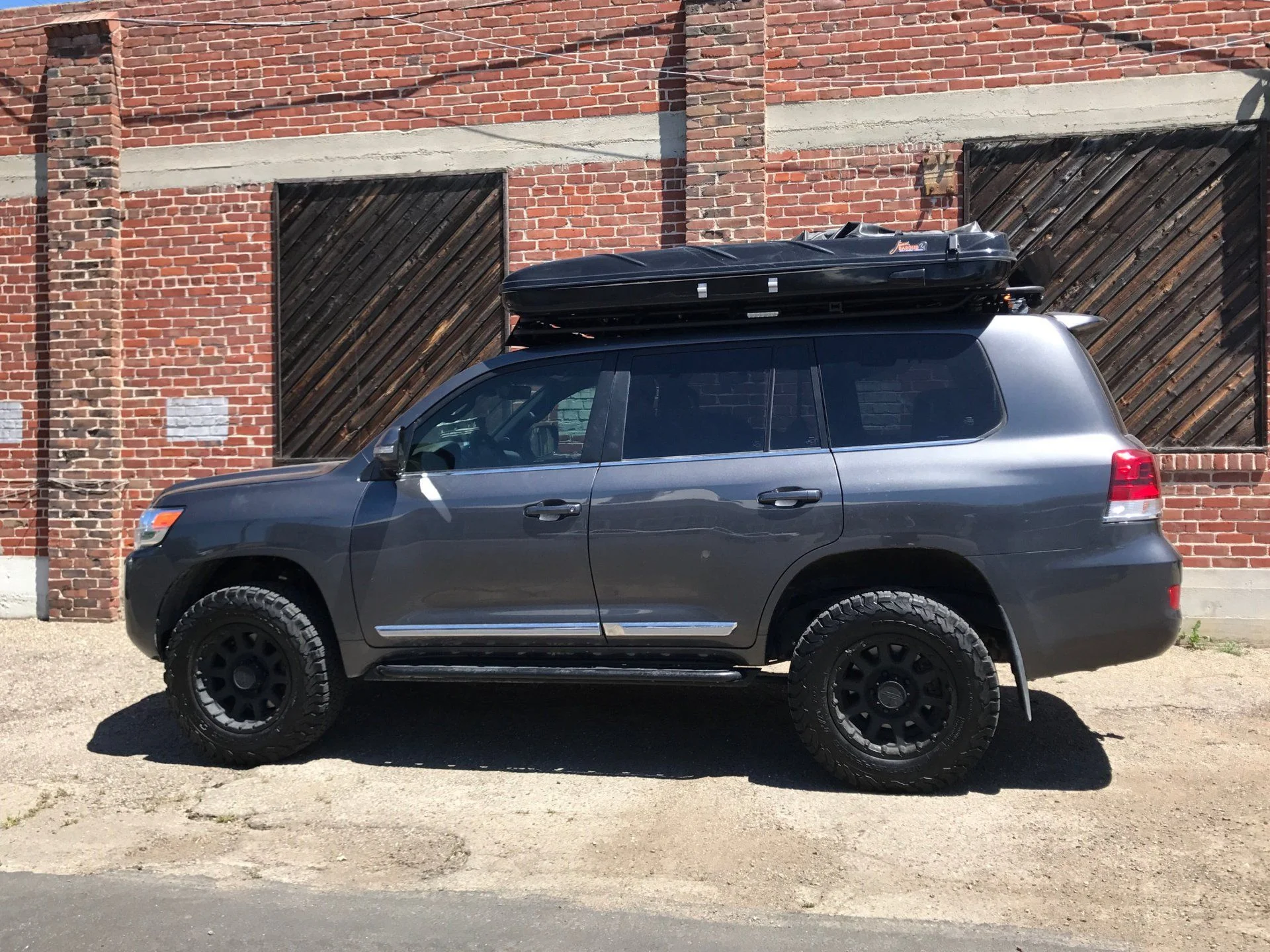

I've been doing some minor preparation in advance of a big trip at the end of the month. The current plan involves 4 days in Moab, 5 in Breckenridge for the LCDC event, 4 days in the Dakotas on the way to Glacier, and finally 5-6 days around Glacier before the long drive back to California.
With the trip approaching I'm holding off on any modifications but am looking forward to a rear bumper in late summer or early fall. I've also temporarily removed the James Baroud tent to eliminate some roof weight for the Moab/Breck trips and made room in the cabin for our canvas tent.

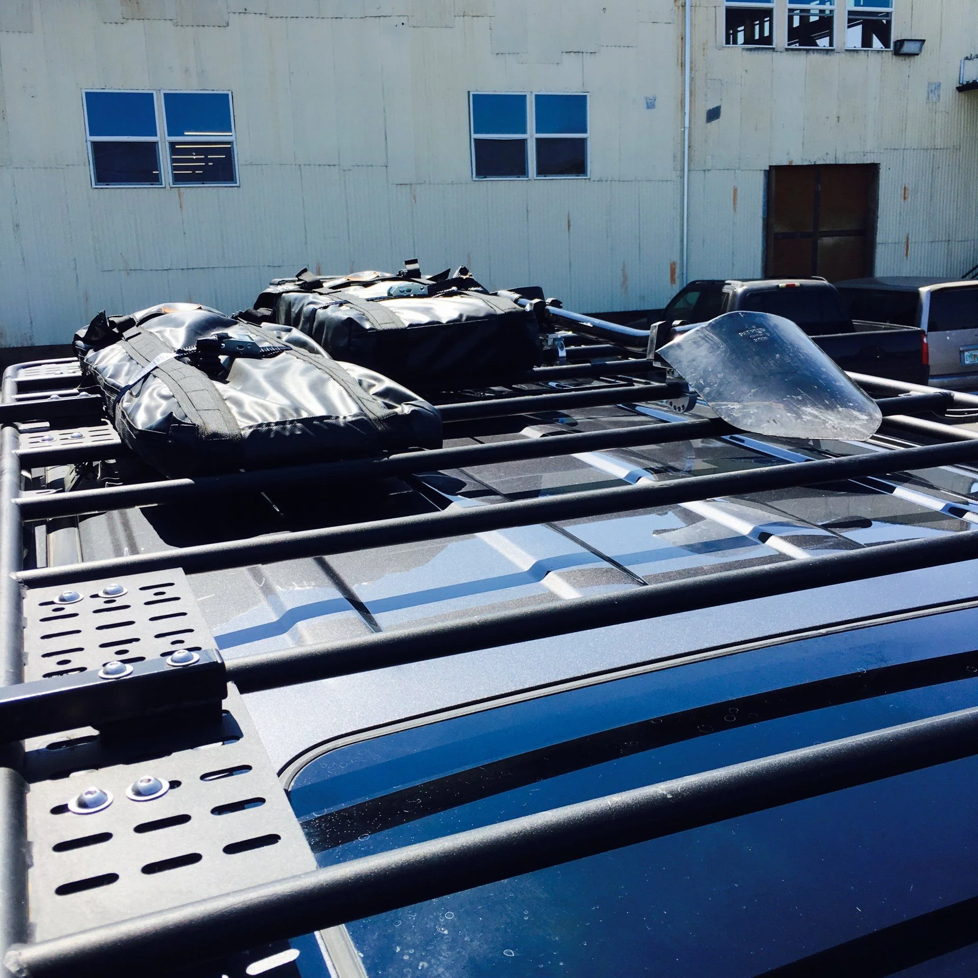

Roof with Shovel, Maxtrax, and Traction Jacks. It's nice having a lighter roof setup as my JB Tent + Roof Stuff before was probably 300 lbs.

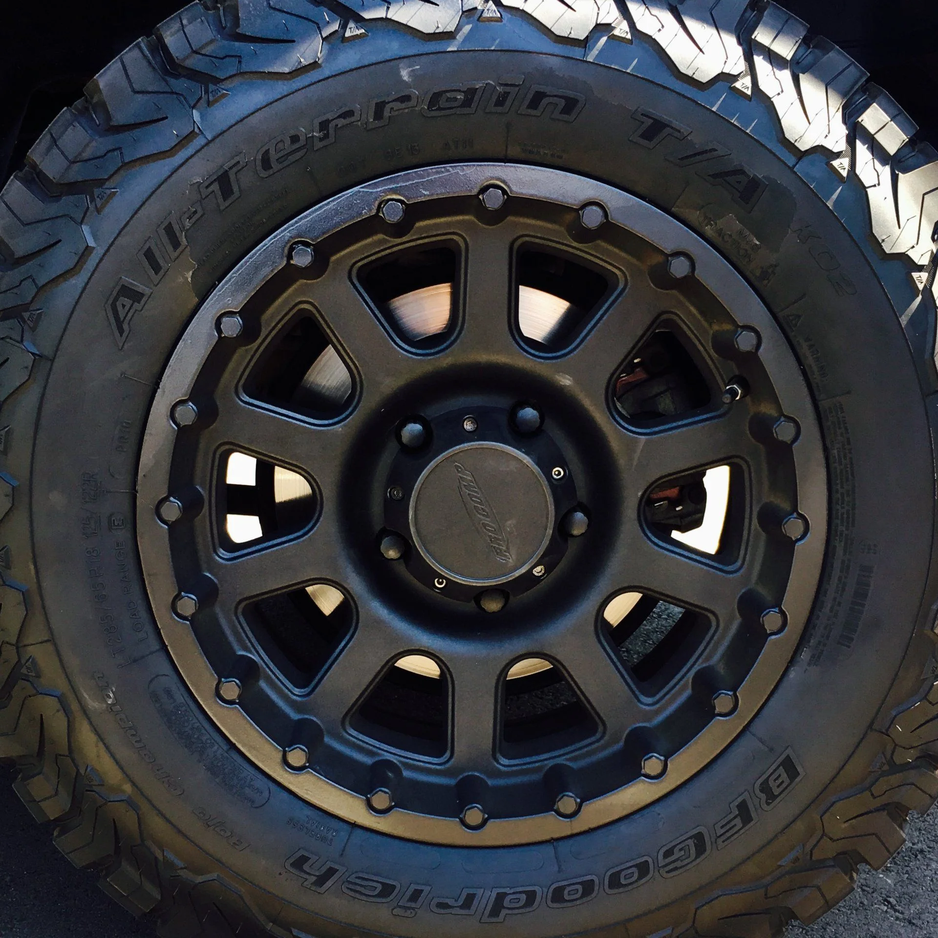

My budget Procomp wheels have taken a beating and it was getting hard to keep track of all the scuffs to discern between cosmetic and serious damage. So, I applied Plastidip to all the wheels so now it'll be easier to see new damage. It looks better as well.

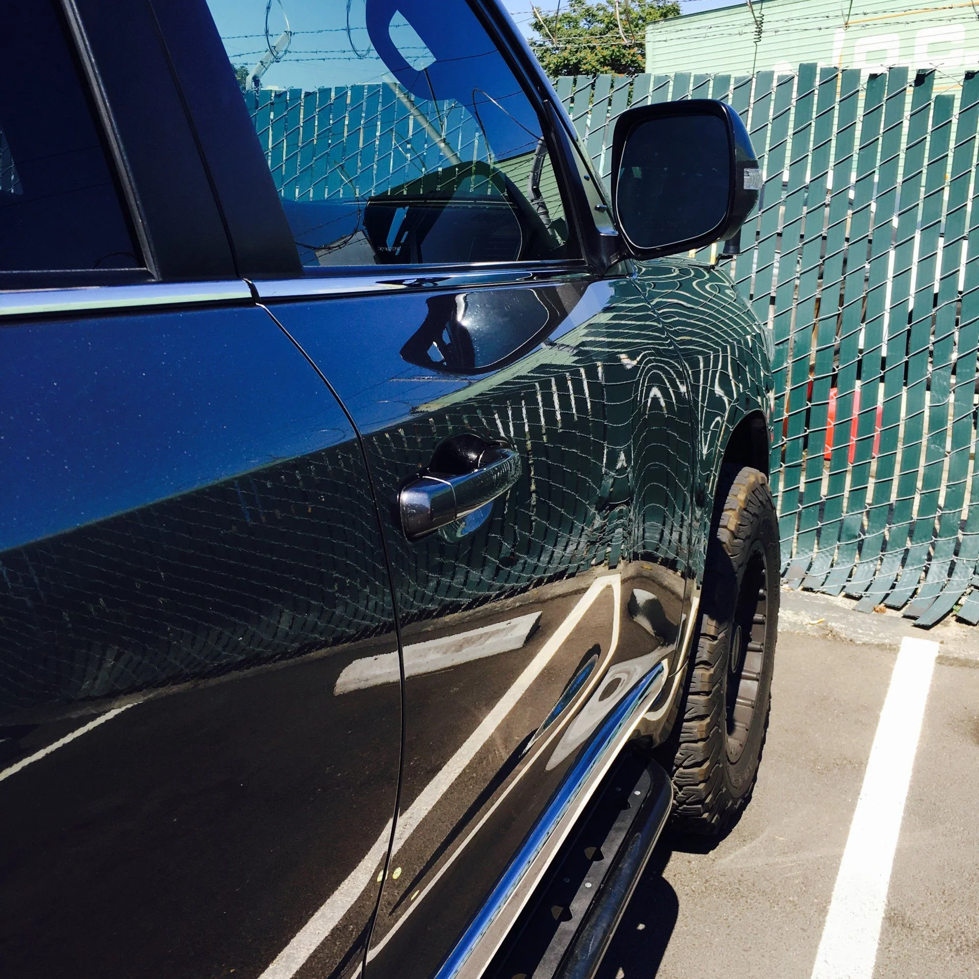

I also did a mini-detail this weekend using clay, wax, and some detail spray from Chemical Brothers.

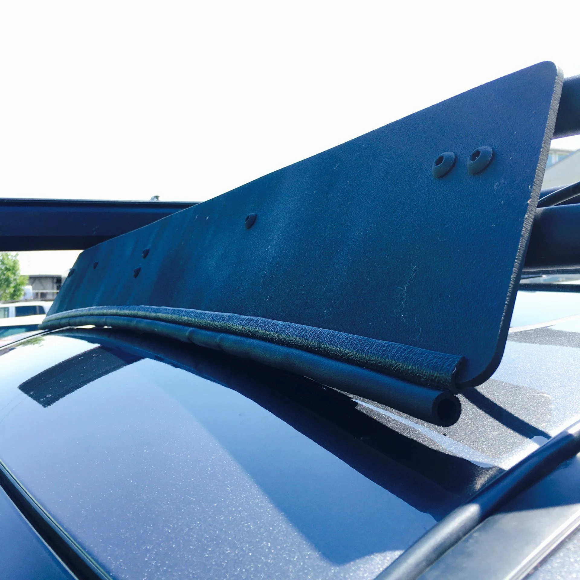

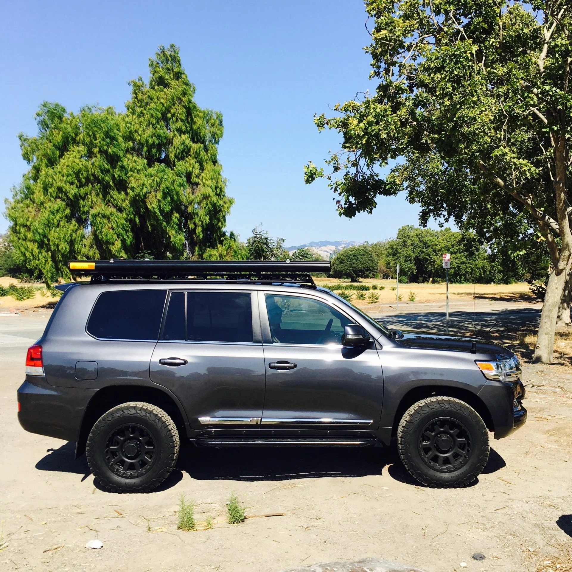

With the tent off the roof, I also spent a bit of time adjusting the Gamiviti rack to get the fairing down a bit lower. I believe I still have one side a bit higher than the other, but I'm pretty happy with the outcome. I also installed some weather stripping from Pepboys on the wind fairing.
In other changes, I installed TRD break pads at 20k miles. This seems a little early but my front-passenger side pad was nearly worn out but there's no sign of anything odd with the calipers, rotors, etc.
Looks good! I'd throw some 3M clear bra down underneath the fairing weatherstripping if you're going to run it all the time. My old 4 runner had a nice strip of clearcoat worn through with that weatherstripping rubbing for a few years.
Thanks for the heads up. I'll do that.
