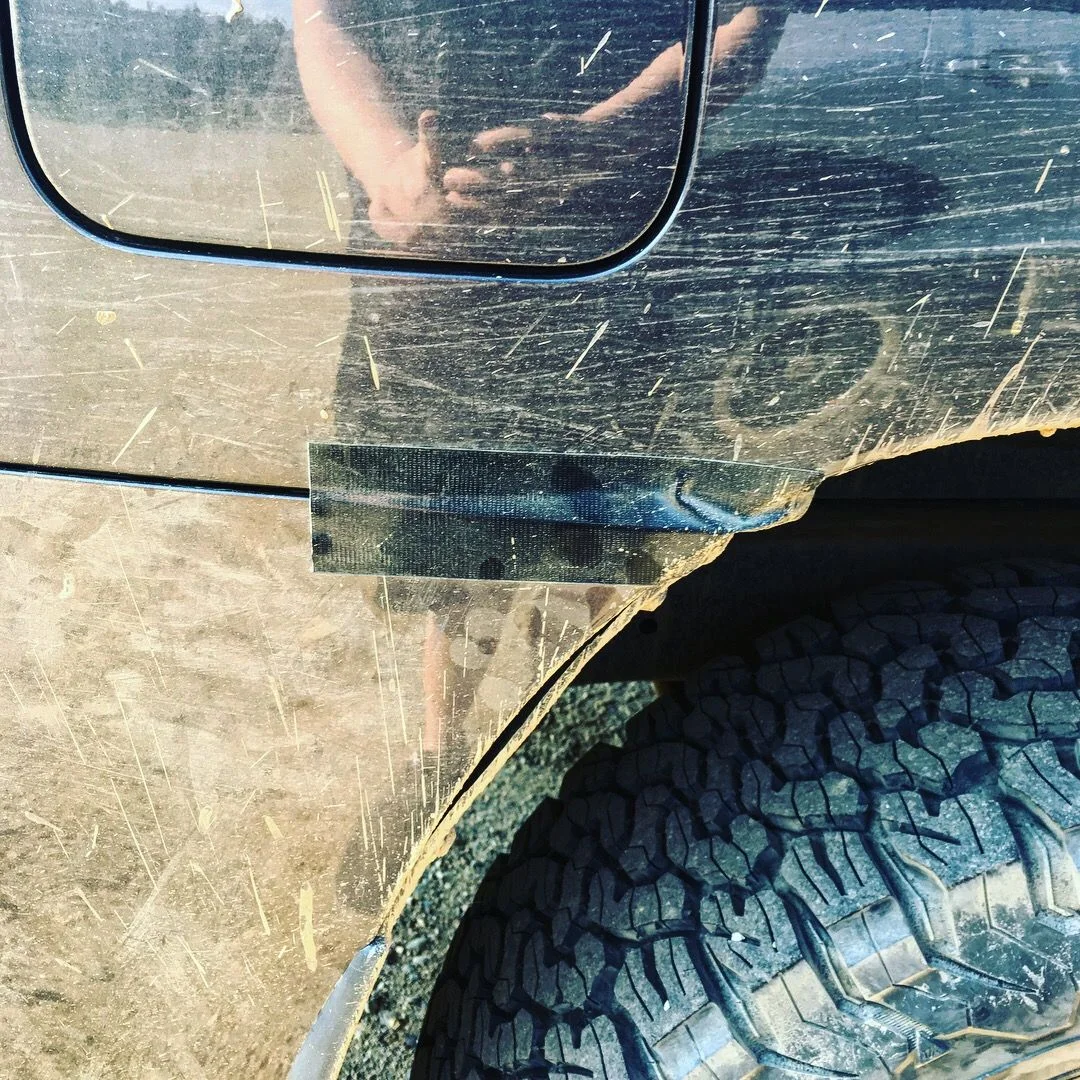

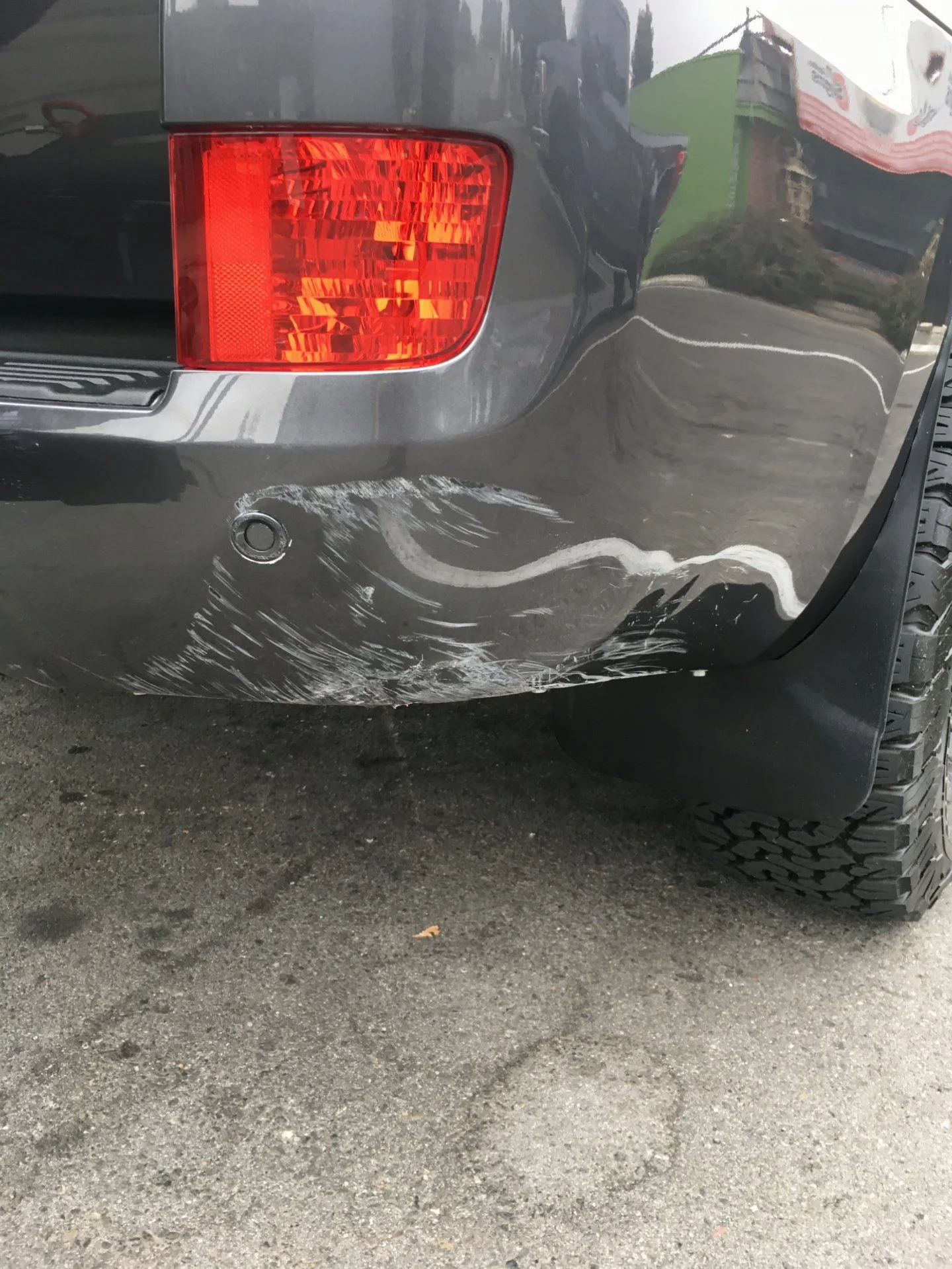

  • Finally, the most significant damage was related to my rear bumper cover and some of its supporting structure. I re-aggrevated this injury (first noticeable issue was from a Death Valley trip from not noticing a rock when pulling out of a campsite, doh) in both Moab (Hell's Revenge -- not much I could have done) and in Breckenridge (Middle Fork -- took a wrong turn and led half the group down a tricky alternate route where I didn't take an aggressive enough line). The bumper cover itself took a major dent on the passenger side along with significant scratching. The driver's side is fine. The scrapes/dents also broke the side panel molding (the long, skinny plastic piece that the bumper snaps into against the quarter panel), some clips in the mudflap, mangled the plastic protector on the underside of the bumper cover, and actually bent some internal sheet metal (but not the body panel) that the protector clips to. I knew that the side molding was broken in Breck and had already ordered replacement parts
    • Removed the bumper cover and used a heat gun to reshape the dents
    • Replaced the side molding
    • Replaced clips in mud flap
    • Used heat gun to reform the protector
    • Used vise grips to reshape the inner sheet metal
    • Ultimately, this is a short term fix as the the clips that attach the bumper cover to the side molding are broken. That means I'll need to replace the bumper cover even if I get an aftermarket bumper.
On a related note, the deformed steering boot issue I posted a from Breckenridge magically fixed itself with no intervention. I guess I'll chalk it up to altitude?

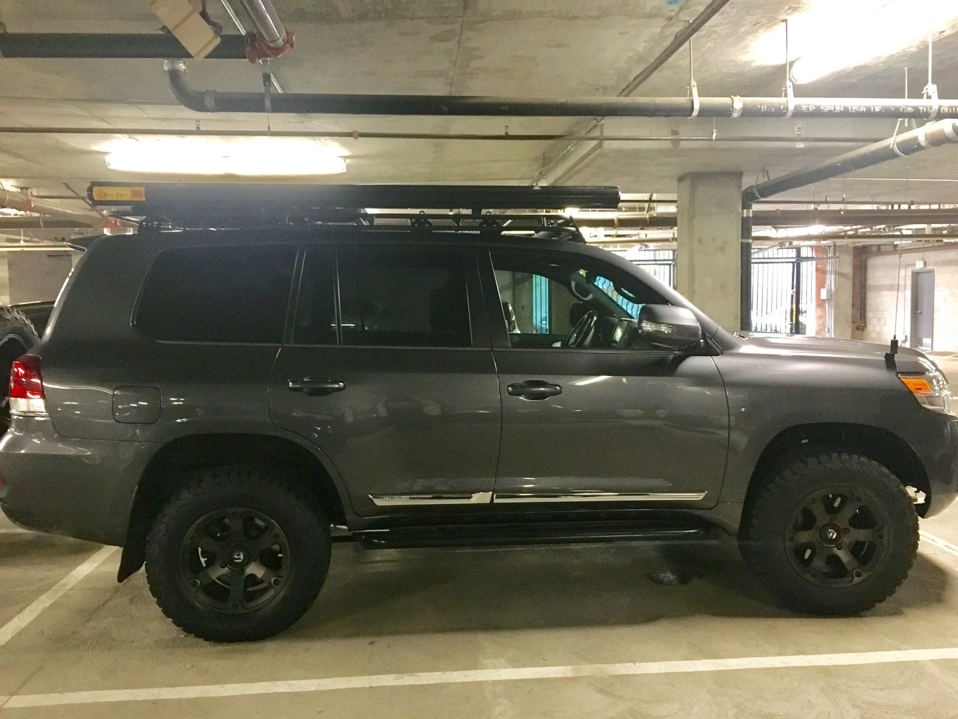

Along with working through the issues above I've acquired Cody's old BP-51s and will be throwing those on the truck at some point. Lastly, I finally replaced my ProComp wheels with some new Fuel wheels thanks to 4 Wheel Parts working with me on an issue I had with the ProComps.
Before Photos (rear bumper dent, broken rear bumper side molding)
After photos (new wheels, detail, bumper dent "fixed" -- the wavy line is a reflection)

Nice shiny wheels Cole!!! What offset and width are those? My rig at body shop and will get it back in two weeks.
chicks dig scars!
truck is looking great Cole.
Thanks again for the GPS routes in Moab, they were a life saver!
No problem! I ended up using the GPS routes in Breck as well and they were certainly helpful given that I was leading trails that I'd never been on before (and still took some wrong turns).
Fuel Beast D56418905657, 18x9, 20mm offset, 5.75" backspacing, 36lbs, 2500lb capacity

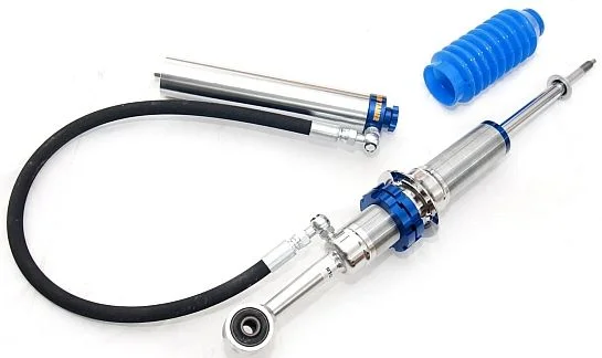

I spent last week in Melbourne. Had meetings with our partners at Terrain Tamer, amongst others including Harrop. I also hit the National Outdoor 4x4 Show which had all the vendors in one venue. It was a fun and productive visit. I also had a chance to try out a new 200 with the Terrain Tamer Pro suspension kit - comparable to the high end adjustibles mentioned above.
The Pro suspension has been in the Aussie market for two years and is a proven hit - very happy users. We have not fit a 200 yet, but have the Pro kits on several other Series and they have been well received.
