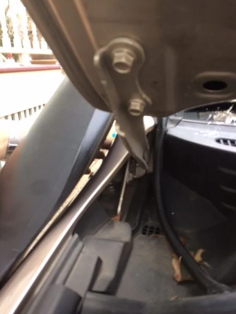

  2. Once you rivet the L bracket to the A pillar, the rivet heads stick up and prevent the snorkel from fitting tightly against the A pillar. Maybe you could use flat head rivets instead? Because I had already riveted mine I opted to dremel the holes on the bracket so that the bolts would actually line up with the nuts which are embedded in the snorkel. Maybe @crikeymike will chime in and Dobinson's has fixed that? BTW I put a bit of silicone around the rivet holes before attaching the L bracket in order to 100% prevent water intrusion... I'd definitely recommend some silicone or RTV since I imagine any water being driven into the A-pillar airbag area could be bad.
  3. The two bolts used to secure the snorkel to the L bracket on the A pillar weren't even zinc coated, I think, as they started to rust within a week. I bought replacement stainless steel bolts from Home Despot for a couple bucks. Hopefully Dobinson's now includes these.
  4. The snorkel doesn't quite fit flush where the front quarter panel and A pillar meet, so there's a small gap (see below). I haven't noticed any excessive wind noise because of it, so that's a plus, but the Dobinson's kit also didn't come with a snorkel-to-body gasket like the ARB does either. So between the gap and the A pillar fitment issue in #2 which pushes the snorkel tube slightly away from the body I find that leaves sometimes end up between the snorkel and the quarter panel, which results in a bunch of smegma falling out every time I go to the self-service car wash.
