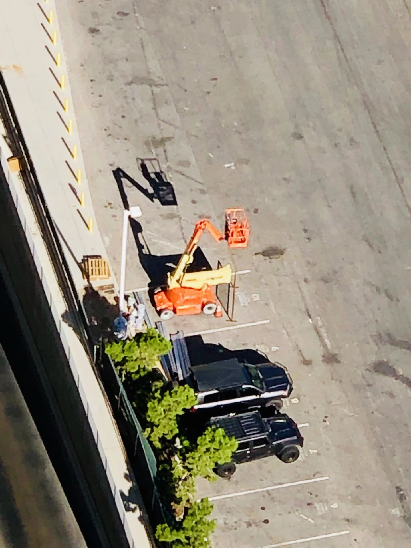

We made it home last night after a brief stop in Las Vegas. The valet at the Cosmo didn't know where to park the truck and apparently they didn't like my suggestion of "park it between the GT3 and the Testarossa up front" as lo and behold I found the truck parked in a utility lot from the balcony, lol.

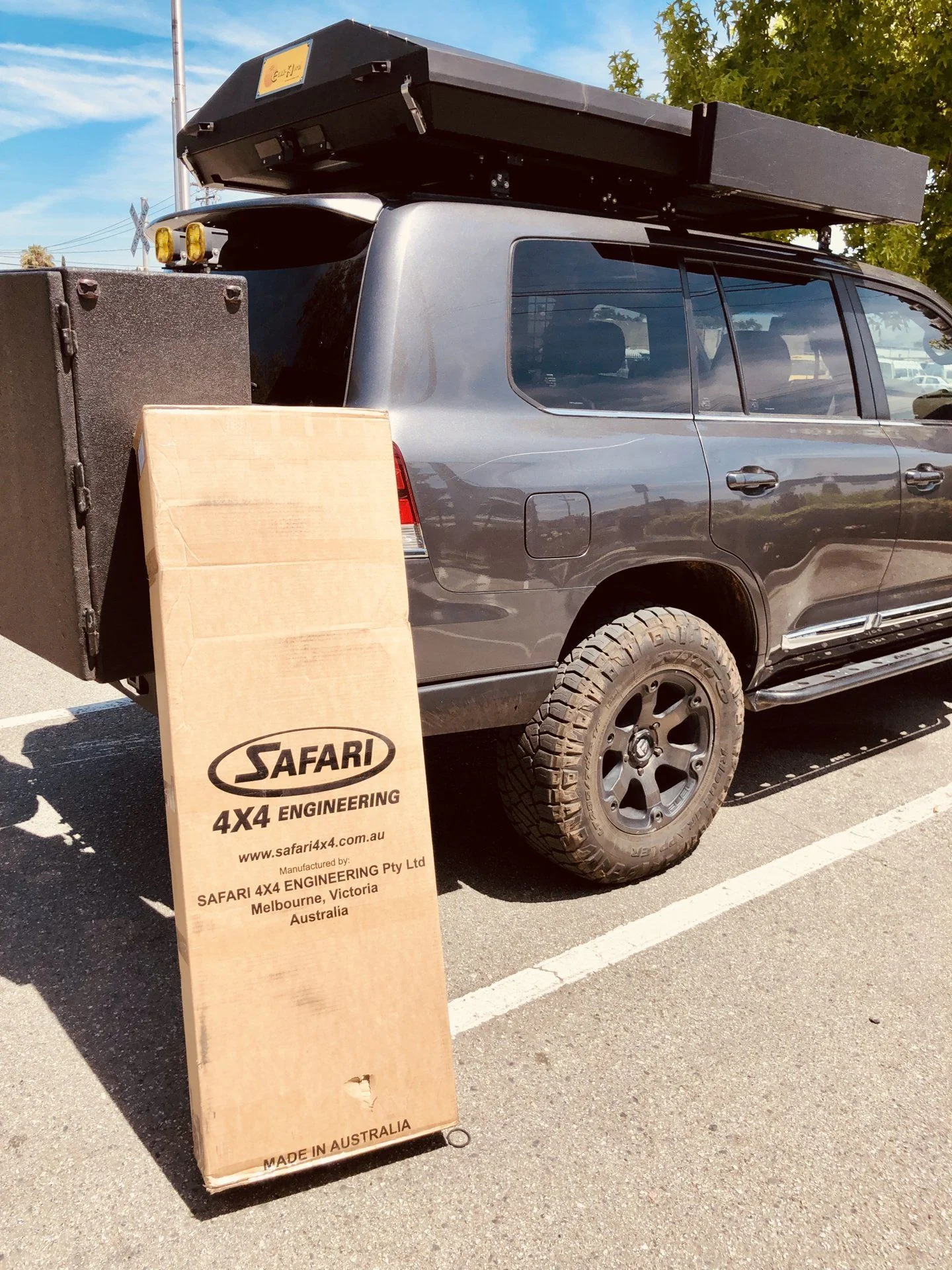

Also, the snorkel is here.

To park in front at the valet...he needed to be at the Silverton next to Bass Pro Shop... :hillbilly: Not the Cosmopolitan.
I lived in Vegas from when I was 22-30 years old, and I'll bet 1% of the valet parkers have any idea what a 200 is. I RARELY saw any Land Cruisers of any vintage living there (worked on the strip too - corp finance not a pit boss like I'm sure you all assumed), but the valet guys see all the crazy exotic stuff. Agreed with Mark - Silverton or South Point would have parked you front and center!

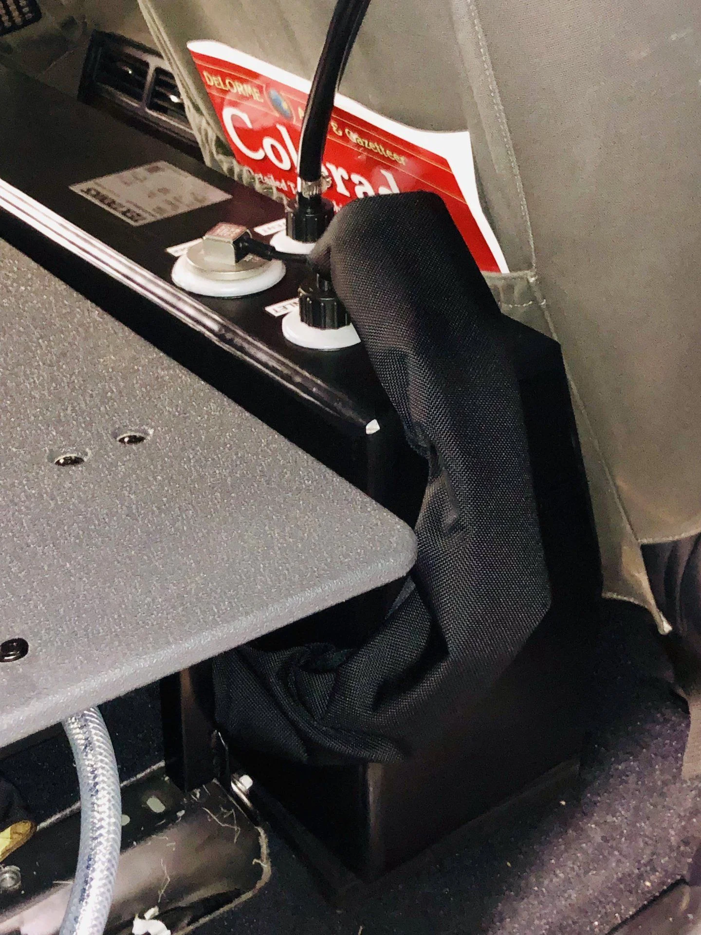

I also need to install the new water tank and the filtration system. The interior needs a good cleaning, first, though, as we rode ~20 miles in the dirt with the windows down while being pulled off the trail.

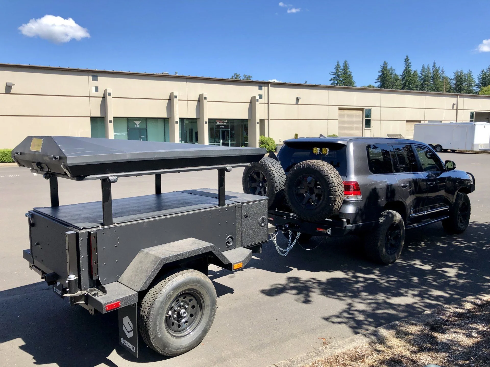

Lastly, we bought a trailer — a Schutt Xventure XV-3. Our intent is to use the trailer for more the backcountry/camping trips and as such we'll be relocating most of the camp-related gear to the trailer, including the 250-300 lbs of stuff on the roof.

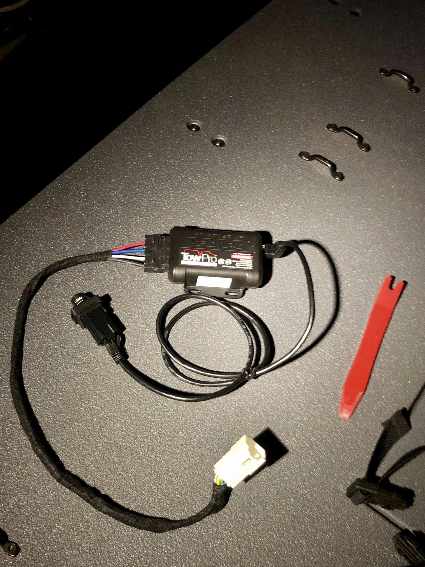

I checked off all the maintenance items from above last weekend and wrapped up the custom water tank install and Redarc brake controller this evening. The steam cleaning joint across the street claims to have removed 25 lbs of mud from the undercarriage. I don't believe them, but they're required to store all mud in 50 gallon drums as a toxic material. The mud hadn't made it to the drum, yet, but I can verify that it filled almost two five-gallon bucks.

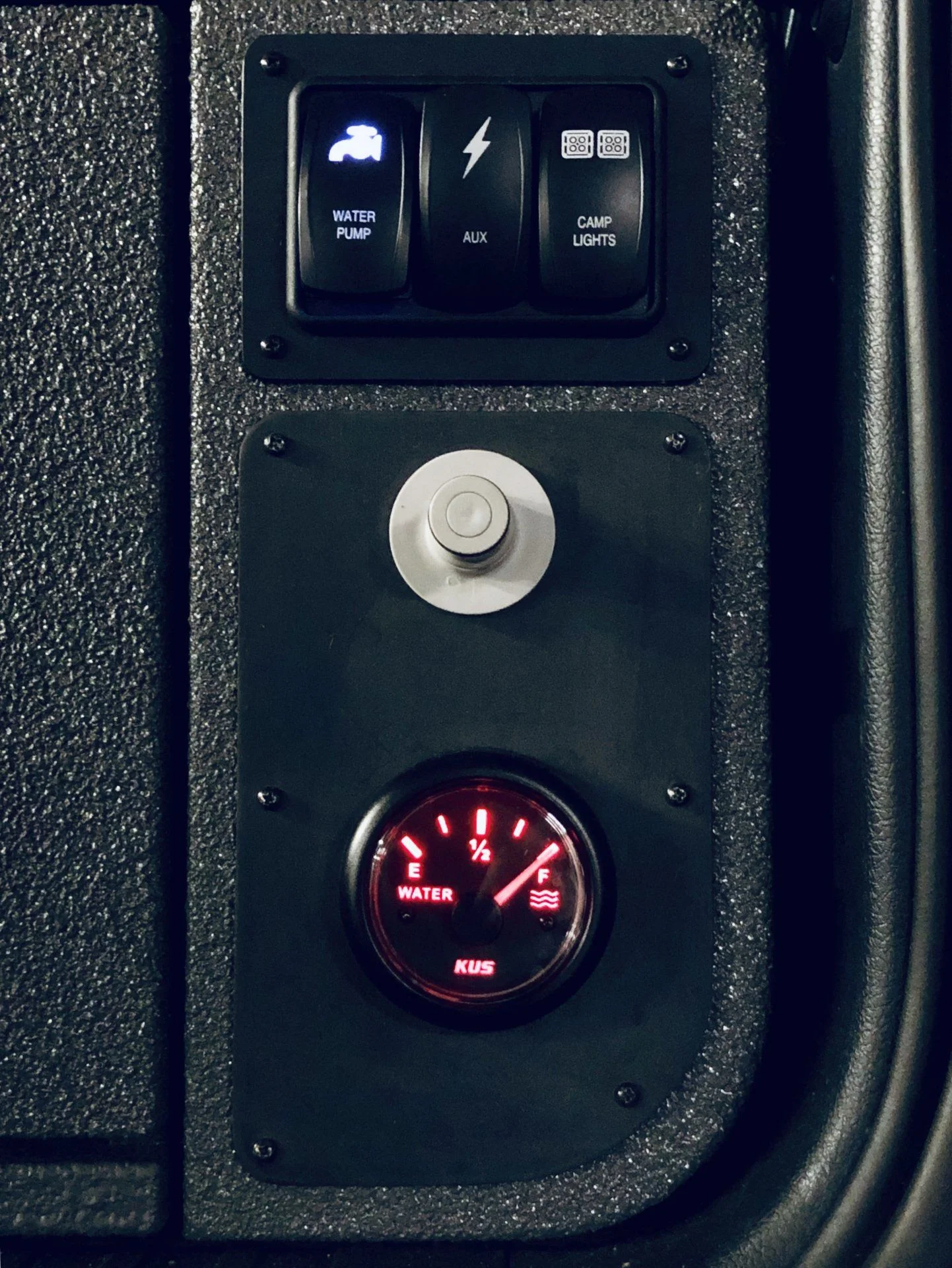

Redarc Stuff
20-gallon water tank in second row footwell
