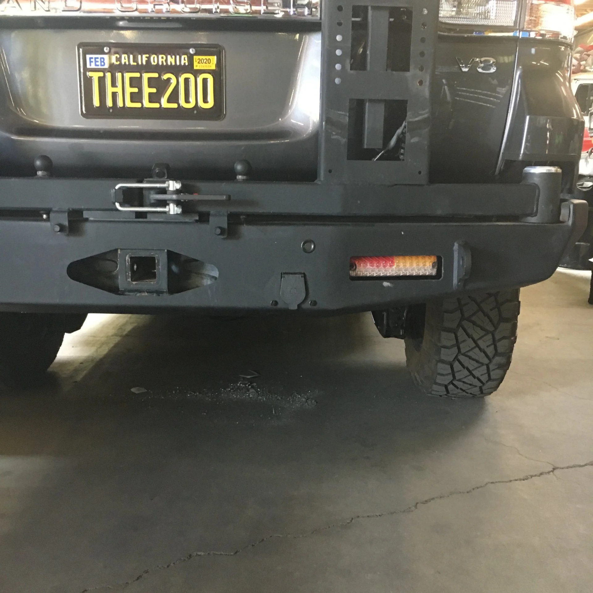

The one month countdown to LCDC has begun. We're out of town the first couple weeks of July but do have a short camping trip mid-month before final preparations for Colorado. The truck is currently at Valley Hybrids where the snorkel went on along with a bumper modification to re-locate the 7-pin trailer socket.

Any idea if the trailer socket just reached that spot or did they have to extend the wiring harness?

I’m 99% sure they reached without extension but will confirm soon.
Yep, no extension needed.
