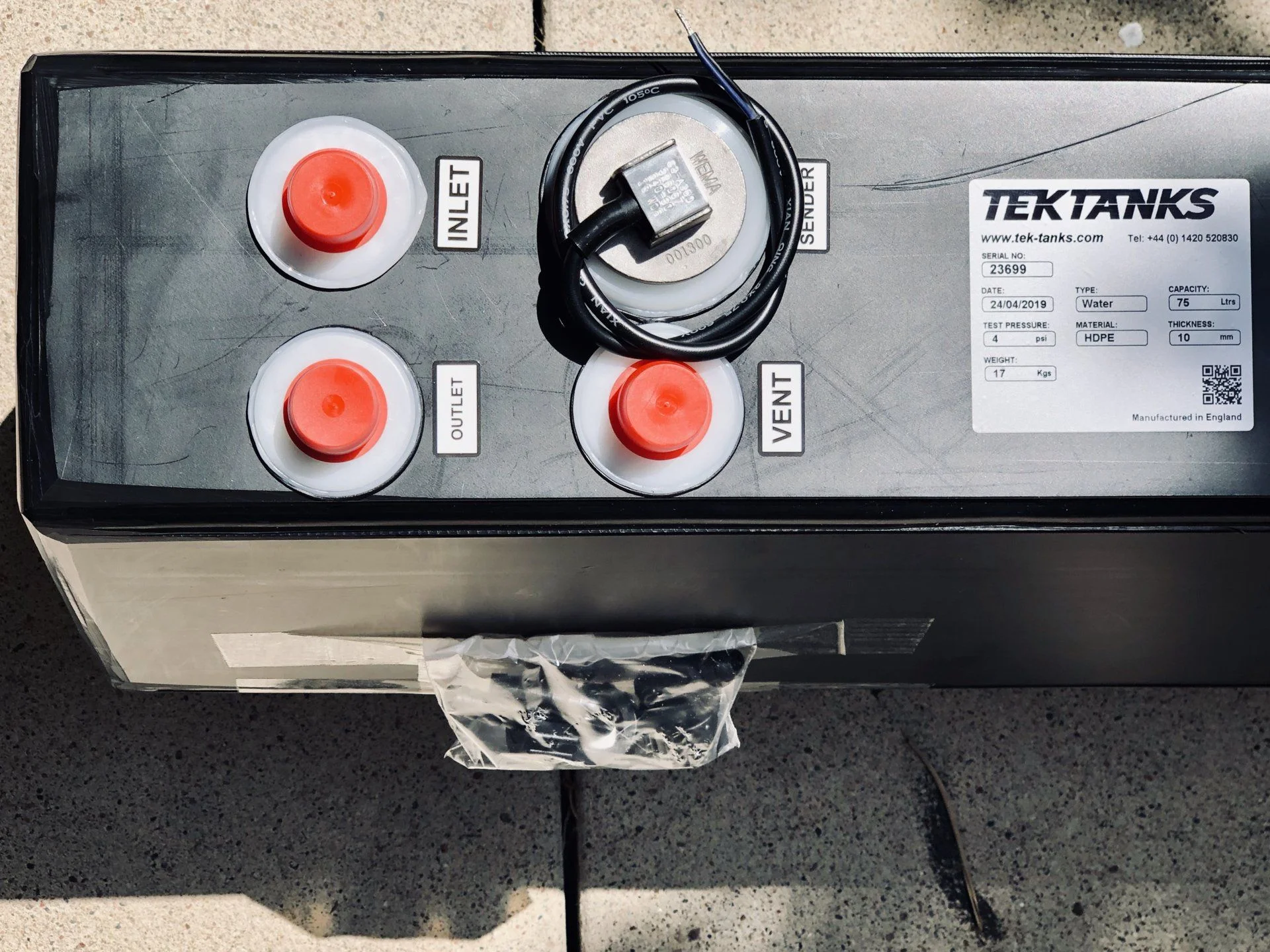

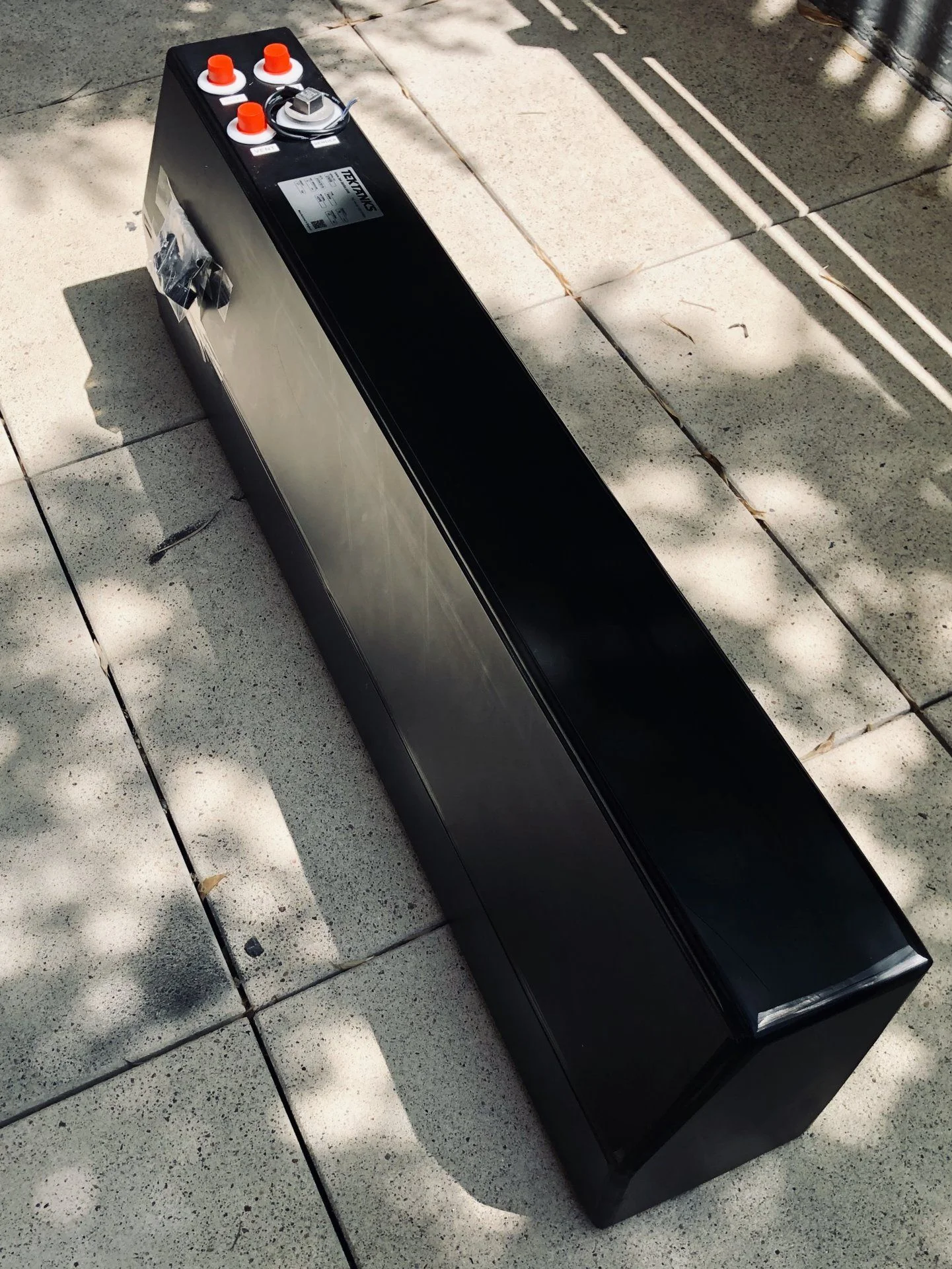

On a completely different subject, the custom second-row water tank was delivered on a pallet from Tek-Tanks while I was away. There's not much I can do with it yet, but I'm fairly confident that it's going to work very, very well. It's basically a taller version of the popular floorboard Frontrunner tank. The total capacity is 20 gallons. More importantly, though, is that all 20 gallons should be usable with this design with the vent on top and a pickup for the outlet. For comparison, my 14 gallon RV tank only has about 8-9 usable gallons due to the vent and outlet locations (crazy, huh?).

Man, now you’ve got me going out to measure what 350mm looks like when my kids legs are dangling from their car seats.
Care you share what we can expect to pay for one of those tanks?
The project cost a total of $1000. That includes roughly $250 in a pallet + shipping, $100 in fittings and small parts, and about $650 for the tank. If you didn't catch it earlier in the thread, it's a custom tank from Tek-Tanks in the UK. The construction/fabrication is pretty darn impressive and the tank itself is baffled to cut down on sloshing (which has been a problem with the current two tanks).
