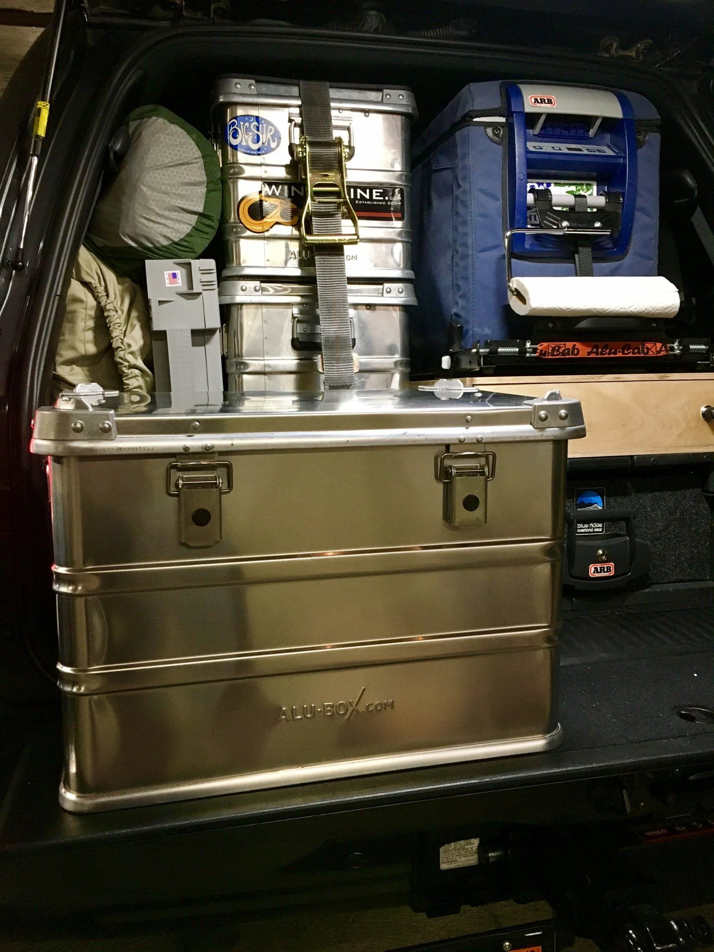

I also picked up another Alubox to store pantry goods, camera gear, and other miscellaneous items while traveling. Clearly, it has nowhere to go in the cargo area. We typically either tilt-up the middle row or remove it completely while traveling so we'll secure this box there along with our hiking gear and clothing.

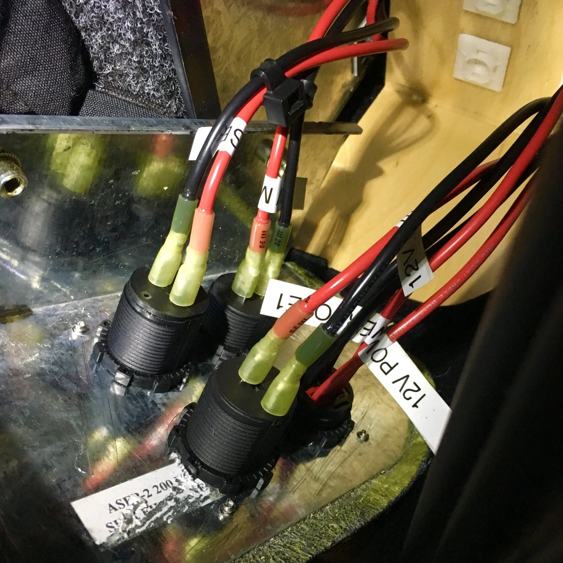

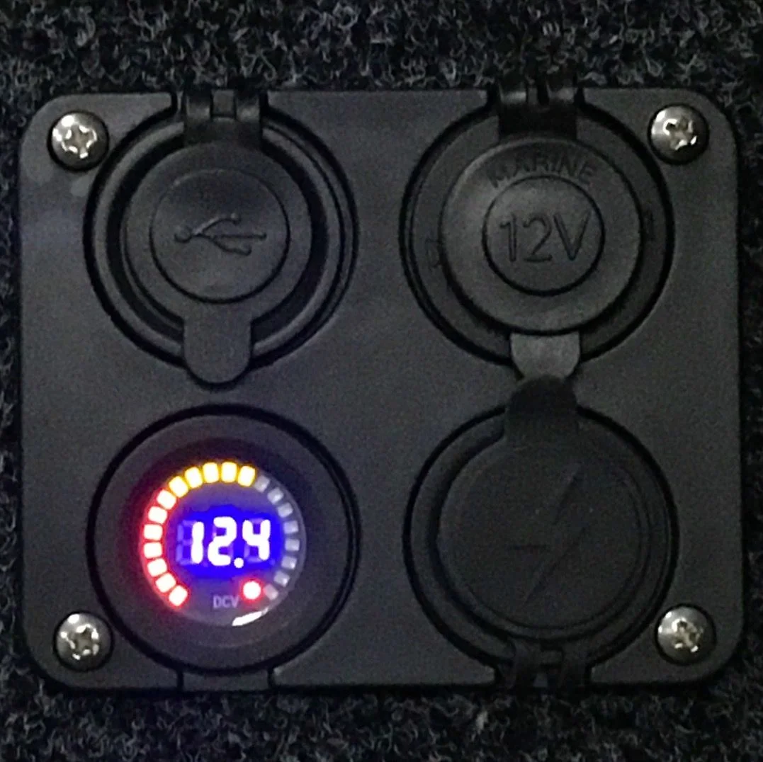

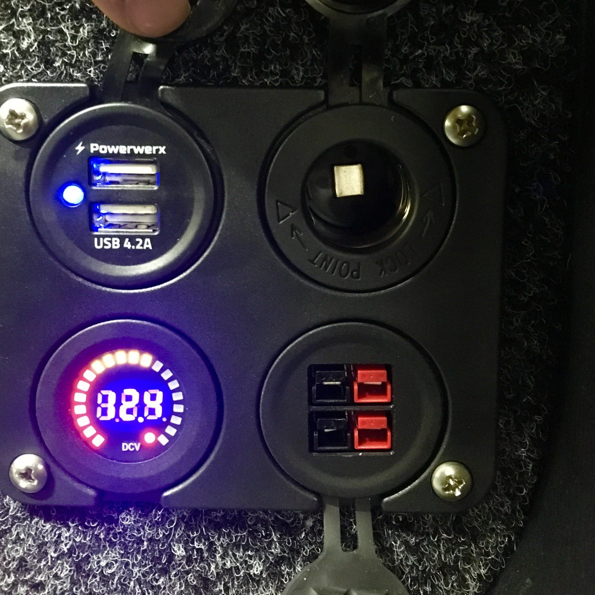

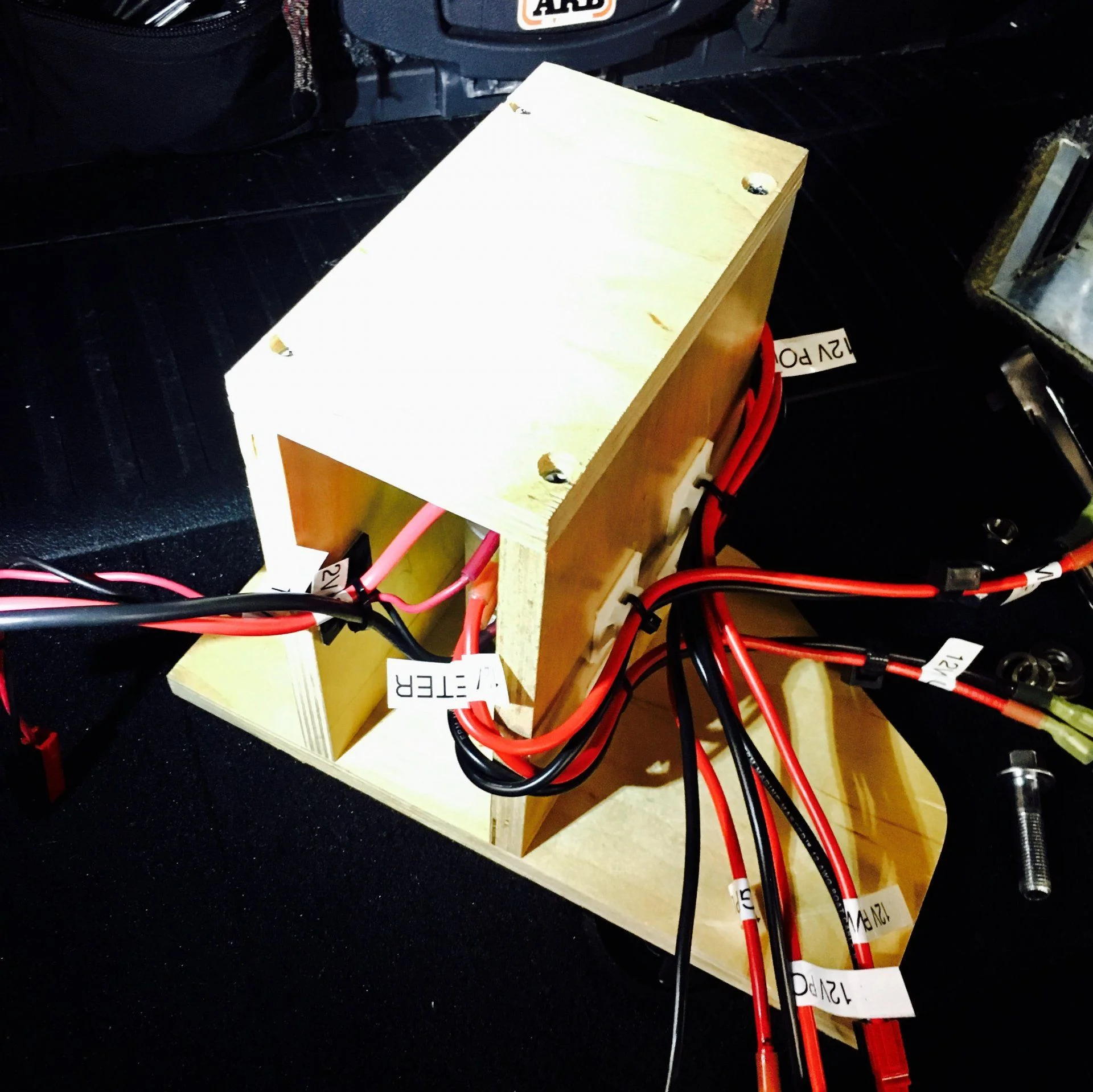

I made some minor changes to my auxiliary power in the cargo area. I previously had a small plywood box that contained my radios, power outlets for the rear (Anderson Powerpole Connector for the fridge, dual USBs, 12v cigarette plug), a fuse block, battery monitor, and radio speaker. All of these items are powered from the second battery via 4 awg power wires going into the engine bay.
  • Removed CB radio equipment because I never used it. This freed up just enough room to allow me to mount everything below the ARB side panel kit.
  • Moved the Yaesu speaker to the third row cupholder using a ram mount. We'll see how this works out. I'm a bit worried about this mount tapping the window when offroad.
  • With the power outlets now placed flush with the top of the drawer panel along with the recent addition of a small shelf below the refrigerator, it has become impractical to reach those outlets from the rear of the vehicle (though they are quite convenient for the second row). So, I decided to upgrade the rear electrical system by adding some outlets to the rear of the drawer system.
I branched off of the original power feed and added a 60A circuit breaker so that the wiring is protected from both the engine side (which already had a circuit breaker) and the cargo area, which was previously just counting on fuses for each individual circuit.
I usually run Blue Sea electrical gear but this time I picked up some panel products from Powerwerx as I really wanted a plug with built-in Anderson Powerpole connectors. I picked up the following panel connectors: Dual 2.1A USB, 12v Receptacle, Dual Anderson Powerpole 10/30/45A, and a battery meter. I also considered an inverter but held off.
Why the need for Powerpole connectors? A couple reasons. First, the pump for the shower system and the pump for a wash station faucet both use those connectors. Second, I'm considering a part-time solar setup and figured Powerpole connectors would be a good fit.

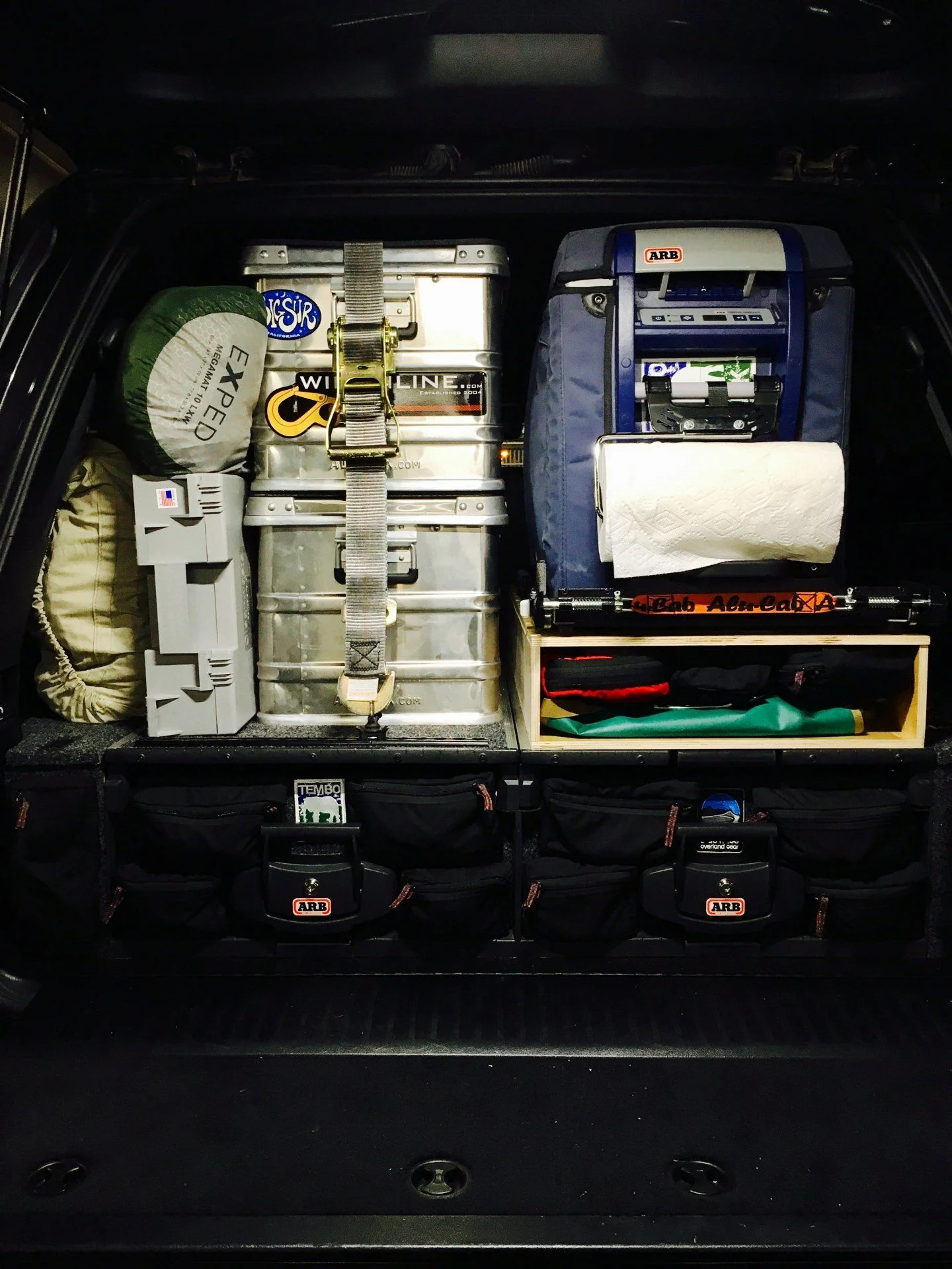

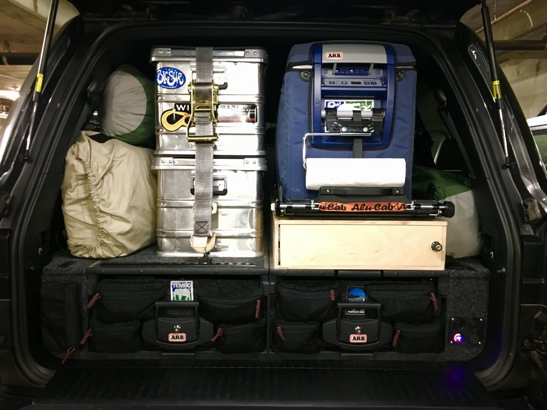

How is rear visibility when fully loaded like that?
Bad. Actually, I can see a sliver of road between the boxes and the fridge but I don't like to rely on it. The view is about to get worse as I'm going to put up privacy window covers in the rear area for security. Fortunately, I just need two mirrors by law.
Yeah when I have things loaded in my station wagon or in my truck with the camper, it looks like yours. I am not worried about the law, as police in CA have other stuff to deal with, but more with real world driving. Either I am carrying too much stuff (blocking view), or I need a bigger vehicle to carry in :D

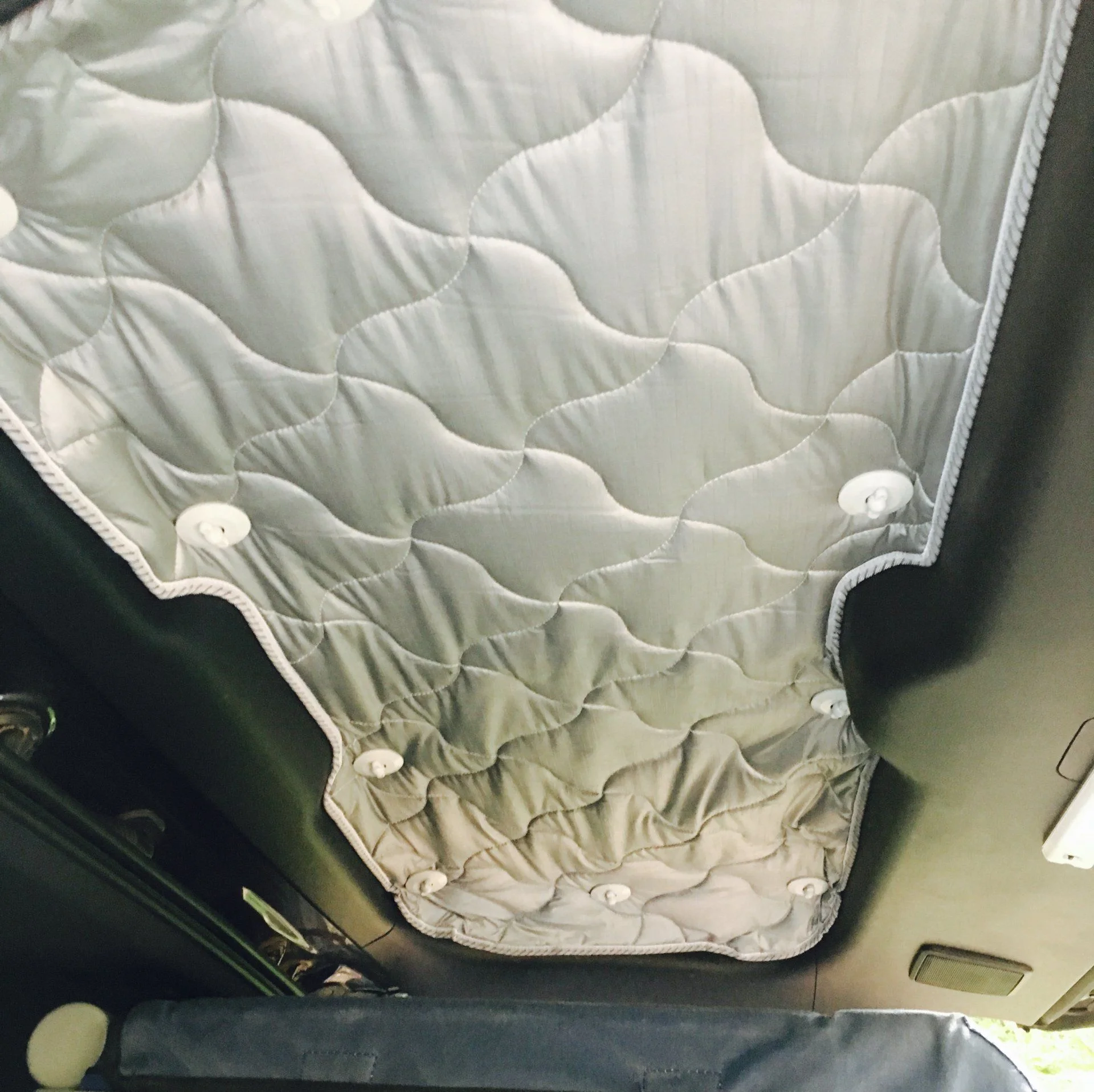

I don't have the window covers yet but they are from this company in Australia: Solarscreen - Quality custom made window insulation for Motorhomes, 4x4s, Boats and Cars
The pricing is pretty reasonable -- $200-$300 for custom fit screens that cover everything from the second row back. We've had some security issues in our community so I'm wanting to keep things less visible both at home and on the road. The idea is that we'll leave the cargo screens on full-time (should help fridge efficiency as well) and use the second row covers when parked for a long time at home or on the road.

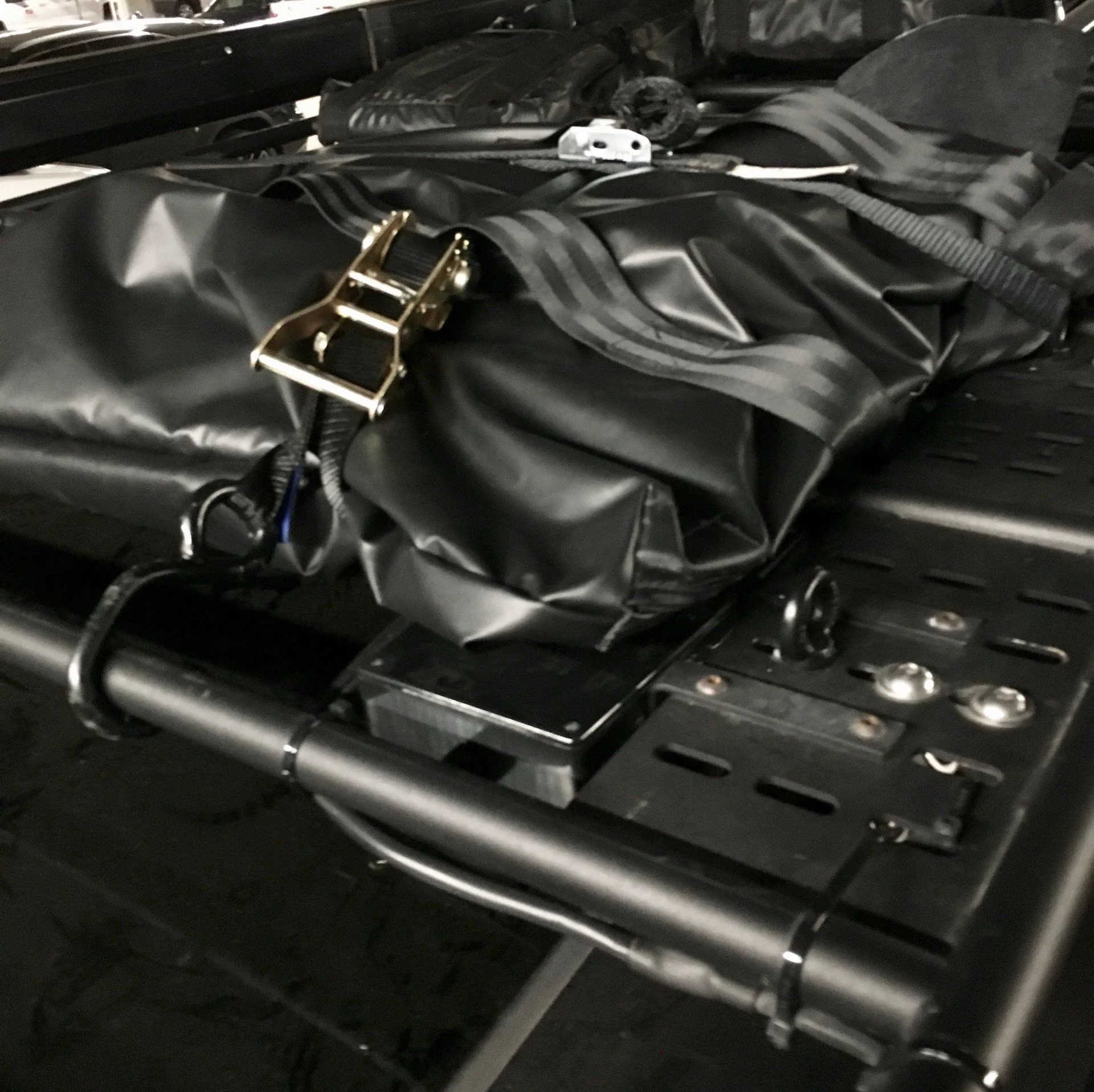

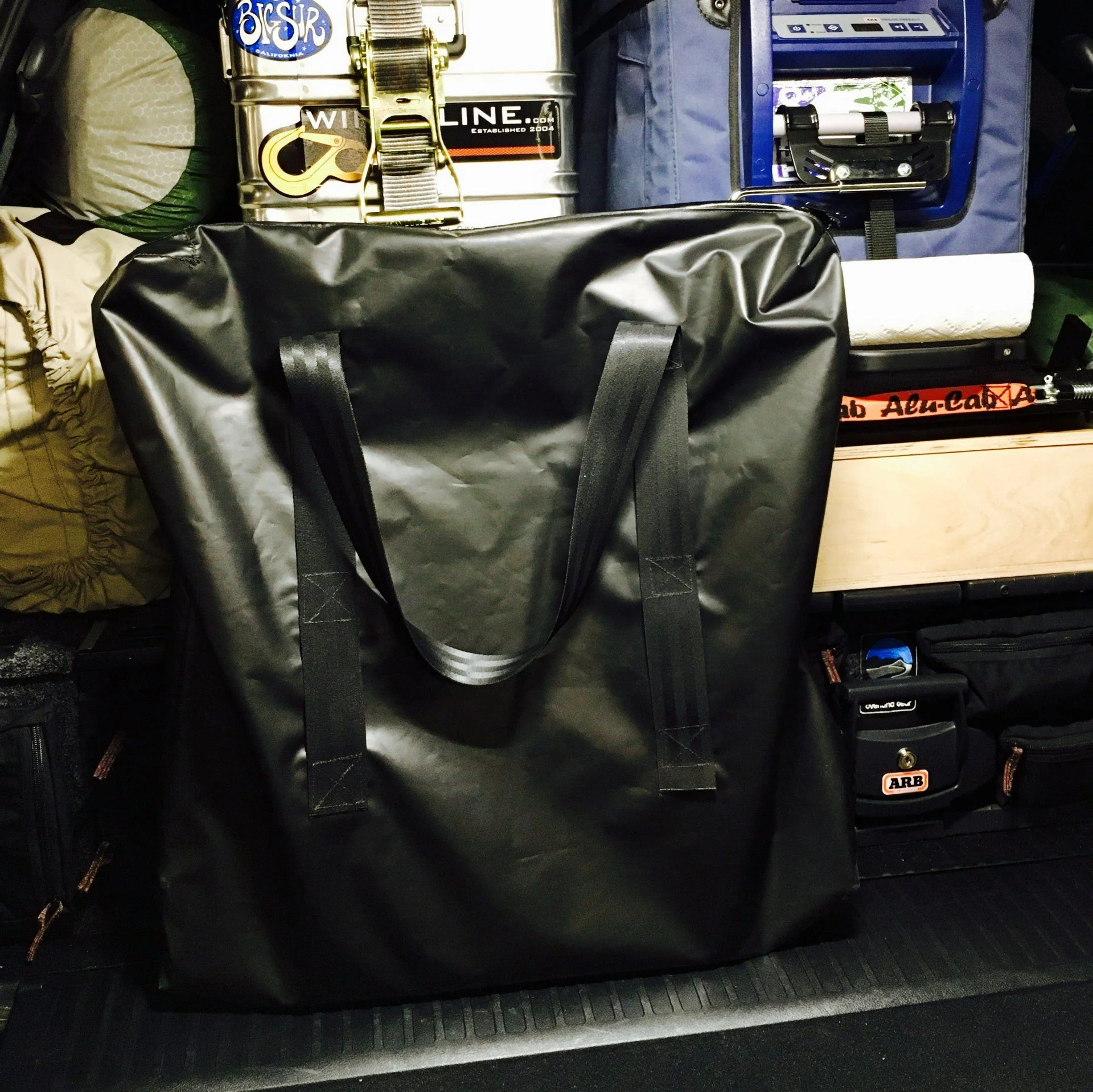

I alluded to a Snow Peak Pack and Carry fireplace bag a few posts above. We love to use the Snow Peak fireplace setup when camping but it rattles like crazy inside the truck. It also takes up a lot of room even though it's lightweight. We bought the canvas carrying case but have had mold issues.
I bought some 16 oz Vinyl-Coated Polyester, 1000 Denier Cordura, seatbelt webbing, and a fancy water-resistant zipper. The goal was to make a weather-resistant storage bag that would house the fireplace, its accessories, and maybe some other paraphernalia on the roof. I don't want it to stand out as we leave our rooftop stuff on full time. I've requested something like this from Blue Ridge Overland Gear but they haven't gotten around to making it.
Fortunately, my wife has a sewing machine and also loves the Snow Peak setup. She made this bag over the weekend. It's perfect (though she would say it still needs work/refinement). I'm optimistic that the combination of VPC exterior, heavy Denier Cordura lining, vinyl cement at all seams, and a protected zipper will keep water out of the bag.
@TonyP -- I think you'll like the Solarscreen kit. I picked mine up on Friday before heading out of town and they pretty much blacked-out the interior of the cargo area. Here's a super-short video showing the contrast of daylight outside versus the second row and cargo area. There's also a photo of what they look like from the outside along with the fit of the rear cargo area glass.

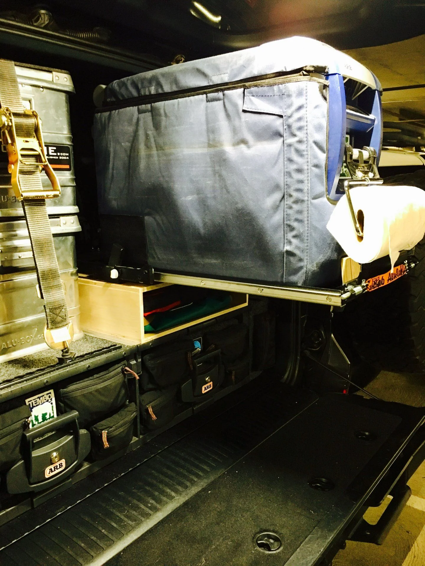

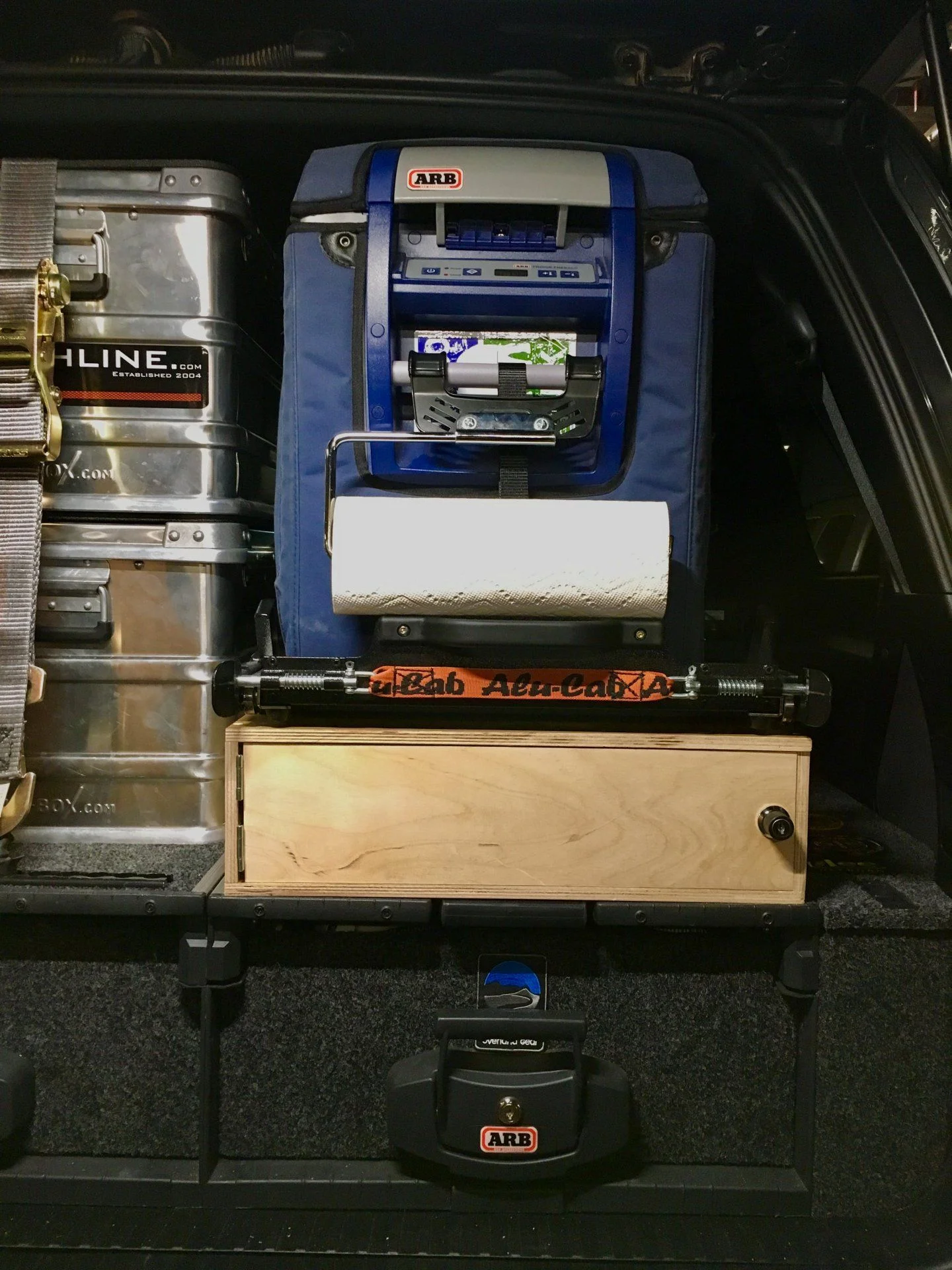

As I alluded to in another thread, I've been exploring ways to squeak out a bit more storage space in the rear cargo area. I built a small birch plywood box to reclaim some storage space below the refrigerator. However, even with a sliding drawer, actually using the refrigerator that high would be impossible... unless there was a way to tilt the fridge down.
In conjunction with the box, I installed an Alu-Cab Tilting Fridge slide. So far so good... I really like the setup though we'll see how it holds up offroad.
I had originally intended on a locking cabinet door on the front of the box but I may try some lightweight netting.

Just got my alu-cab slide, but had a question about yours? does your vertical "catches" tilt outward? i havent installed mine yet, but had one instance where when tilted the wheels on the slide can slip right between the vertical "catches". Wanted to know if you had experienced this on yours. I currently have mine under compression with a ratchet strap hoping to force them more vertical/ parallel, before i install.
Mine have a nylon stopper screw that prevent the slide from coming out completely. I think I can still roll past the tilt catch a bit, though. Is that what you're asking?
