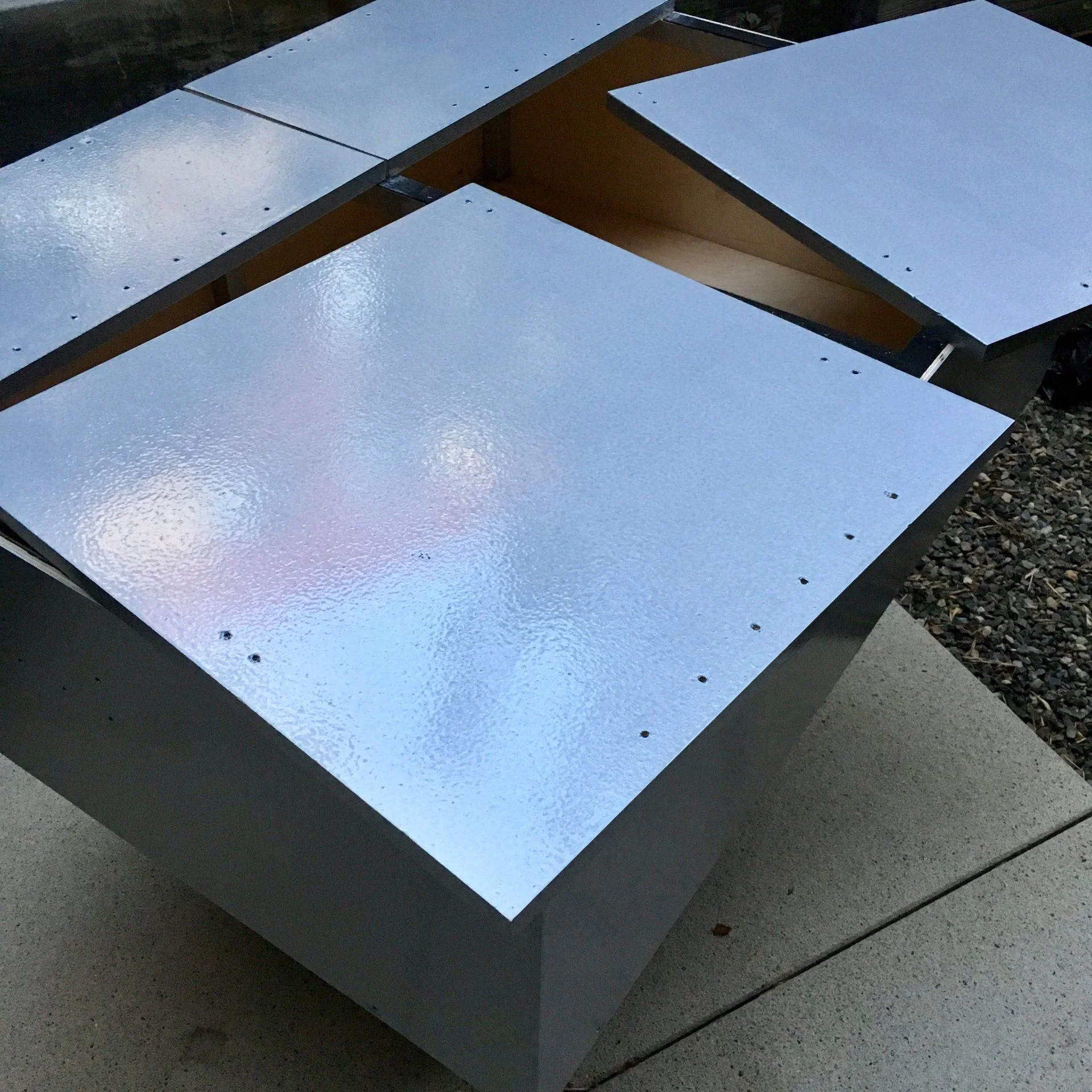

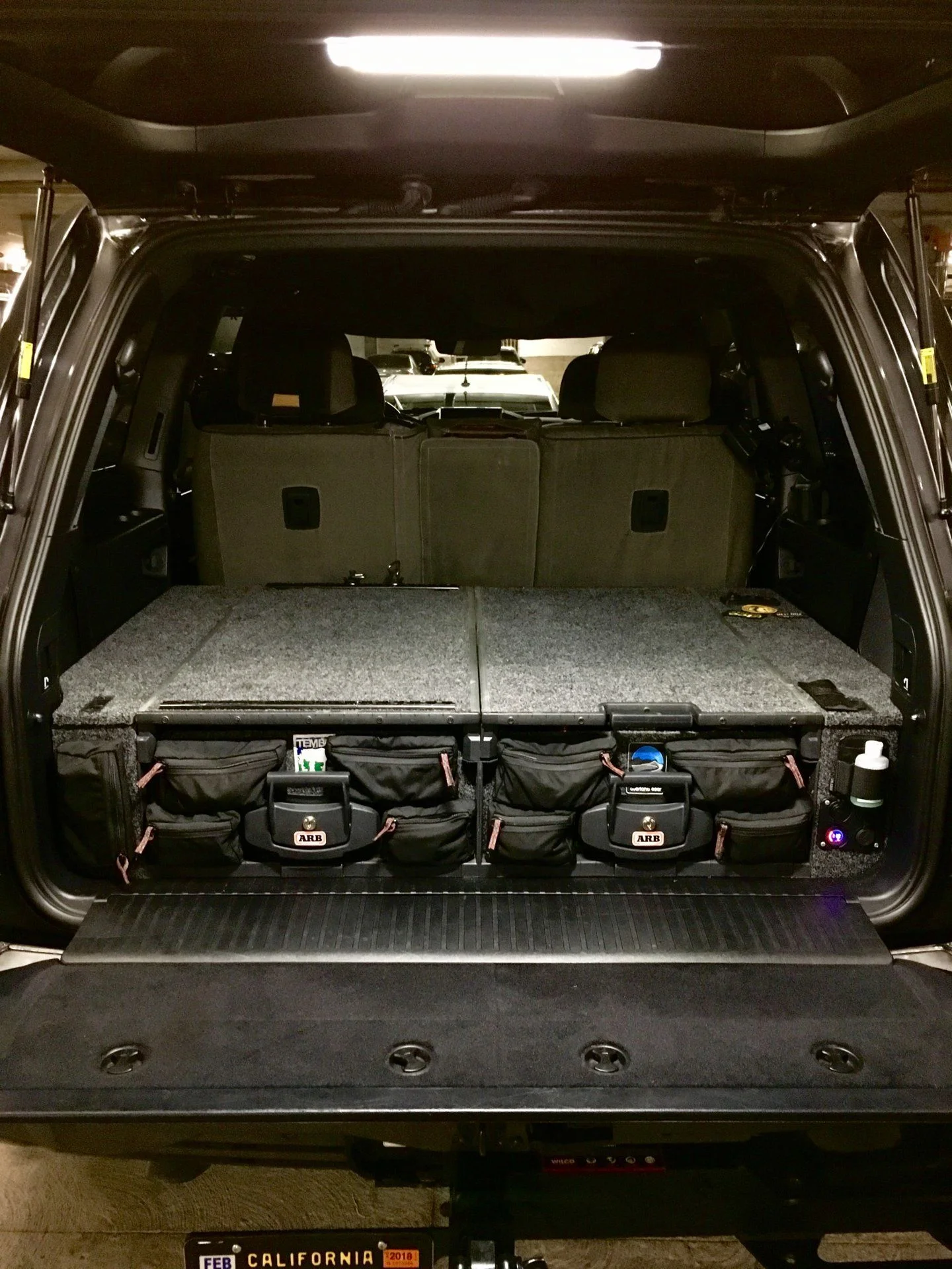

Working through a couple chores. Chassis Saver primer is now on my second row box and the cabinet I sometimes sandwich between the fridge and the ARB drawer. Monstaliner going on in a day or two.

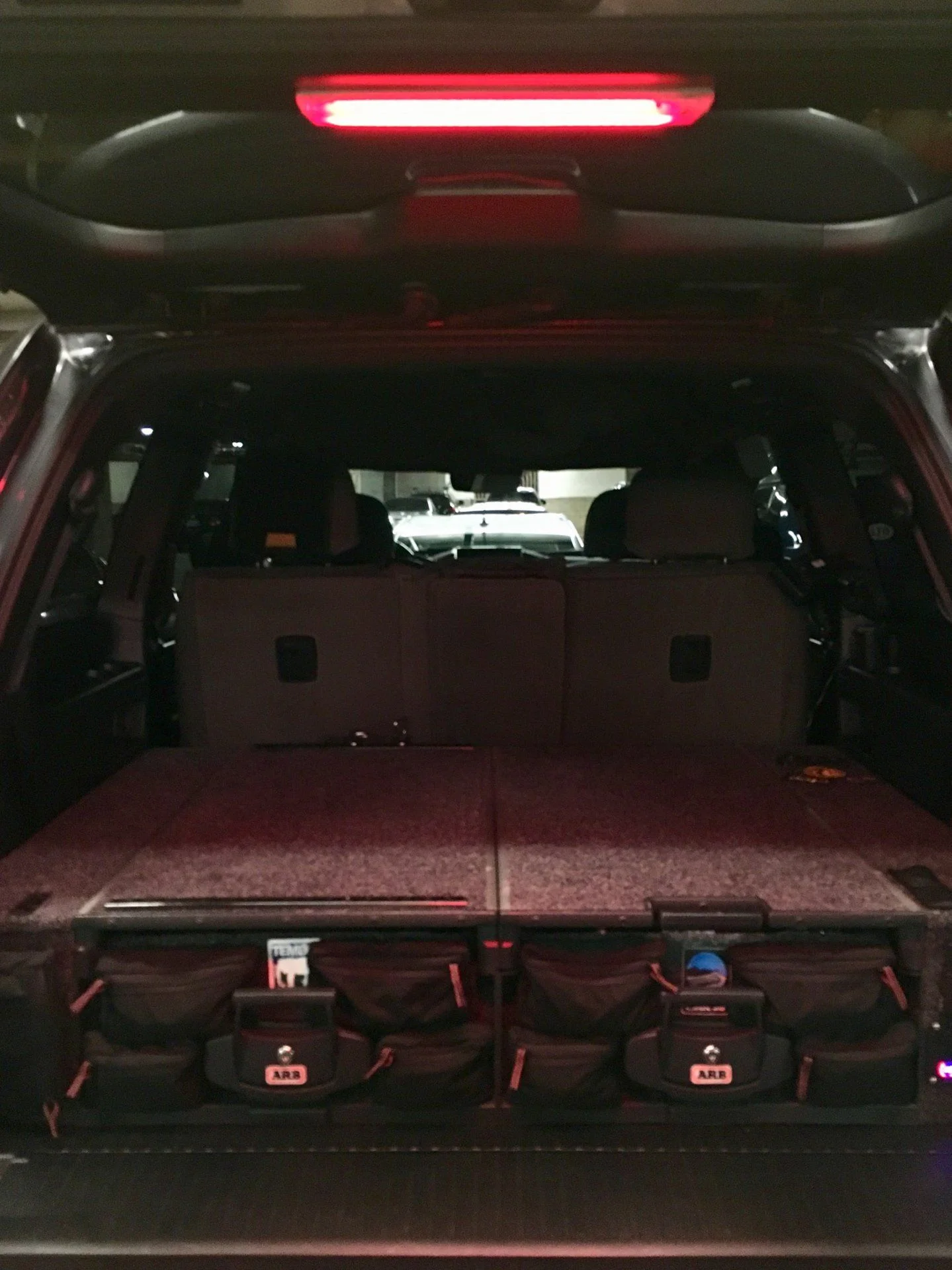

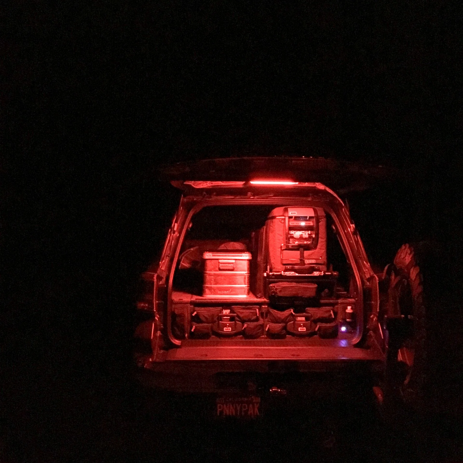

After a recent trip where the bugs would just not let up, I decided to add a second National Luna light to the tailgate. Now I have 1 red light and 1 white light. Both have two levels of brightness.

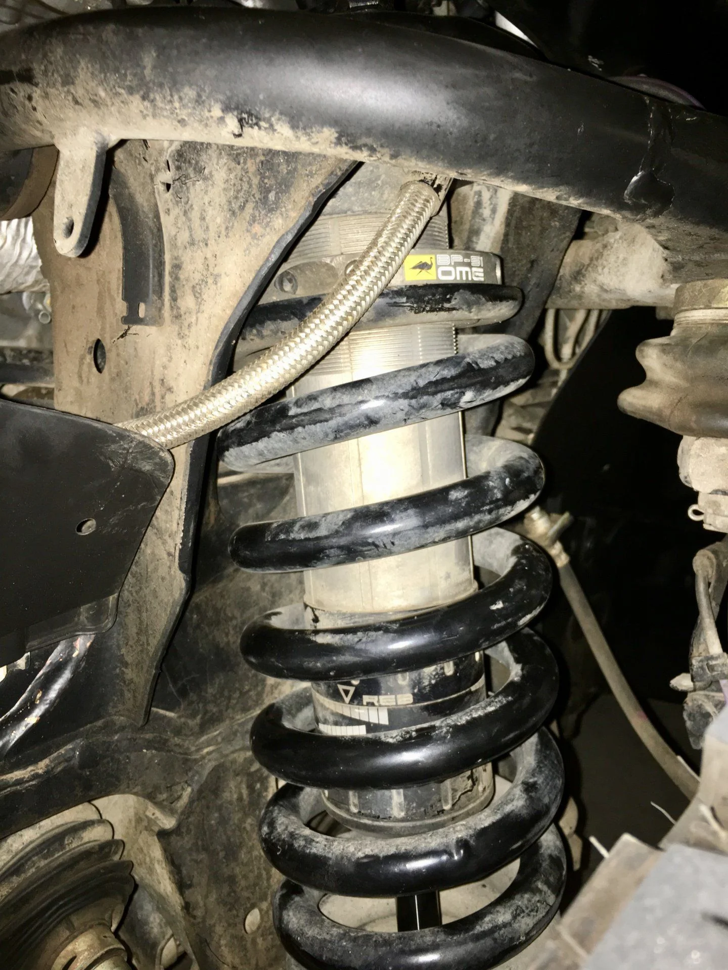

1.) BP-51s are on the truck! Thanks to @orangefj45, Dominic and crew at Valley Hybrids for the install. The rear fit kits for KDSS are backordered nationwide so Dominic came up with a clever solution for mounting the rear reservoir. Here are the current settings:
Front
  • Compression: 4
  • Rebound: 6
Rear
  • Compresssion: 6
  • Rebound: 8
Those settings are for when the rig is heavily loaded though at the moment the truck is empty as I've been doing some work in the cargo area. Thus, the initial ride felt stiff though the handling is much improved. I'm eager to see how things feel once it's loaded down.

Front Strut
2.) I finished coating both my second-row storage box and the cabinet that I use below the refrigerator with Monstaliner. It's been a week since I applied the final coat and the off-gassing is still strong. Both the Chassis Saver (used as a primer) and the Monstaliner is strong stuff.

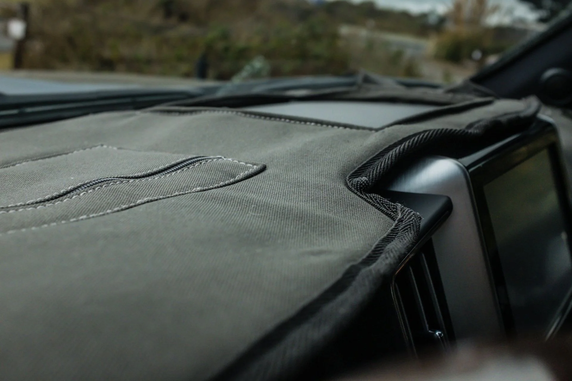

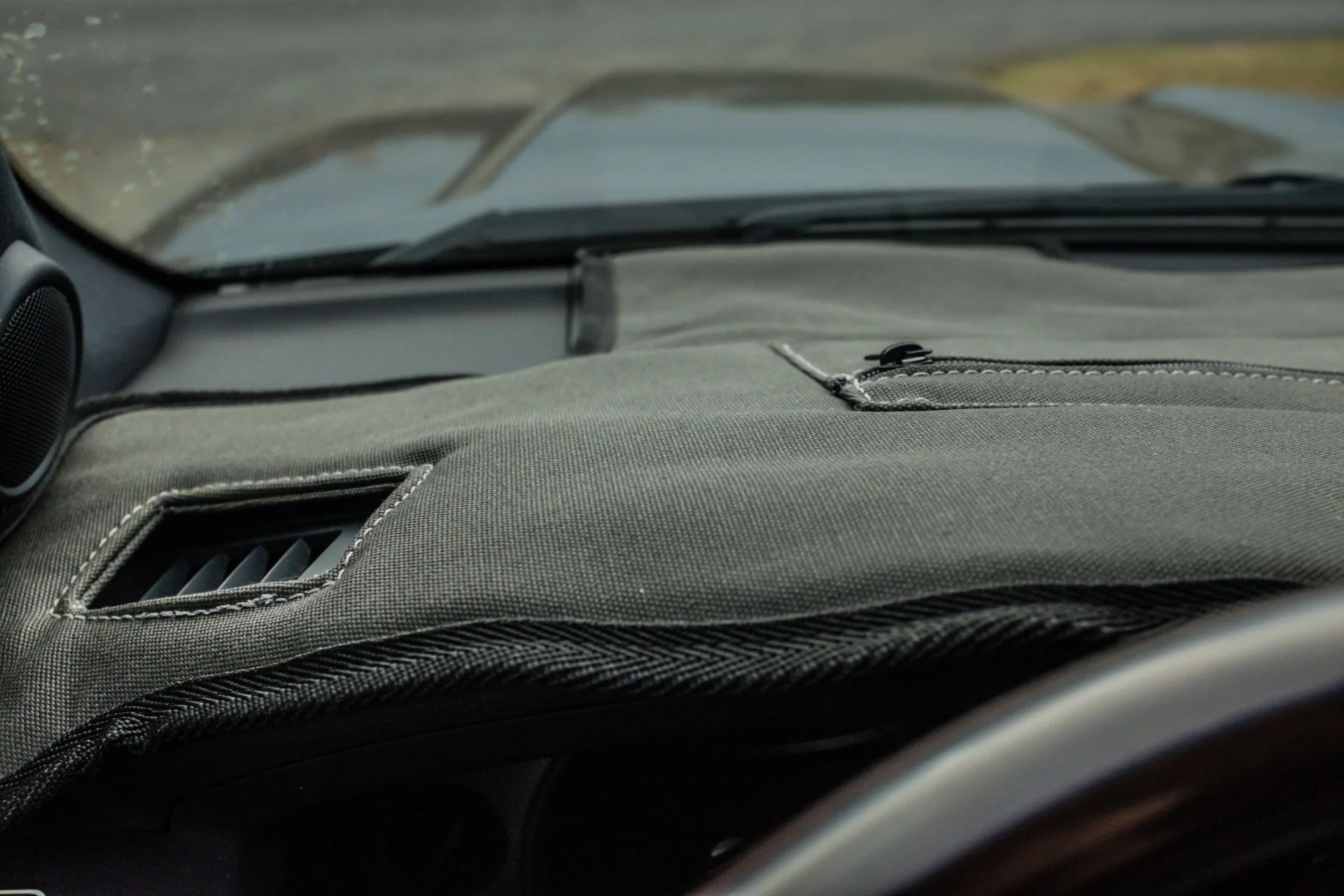

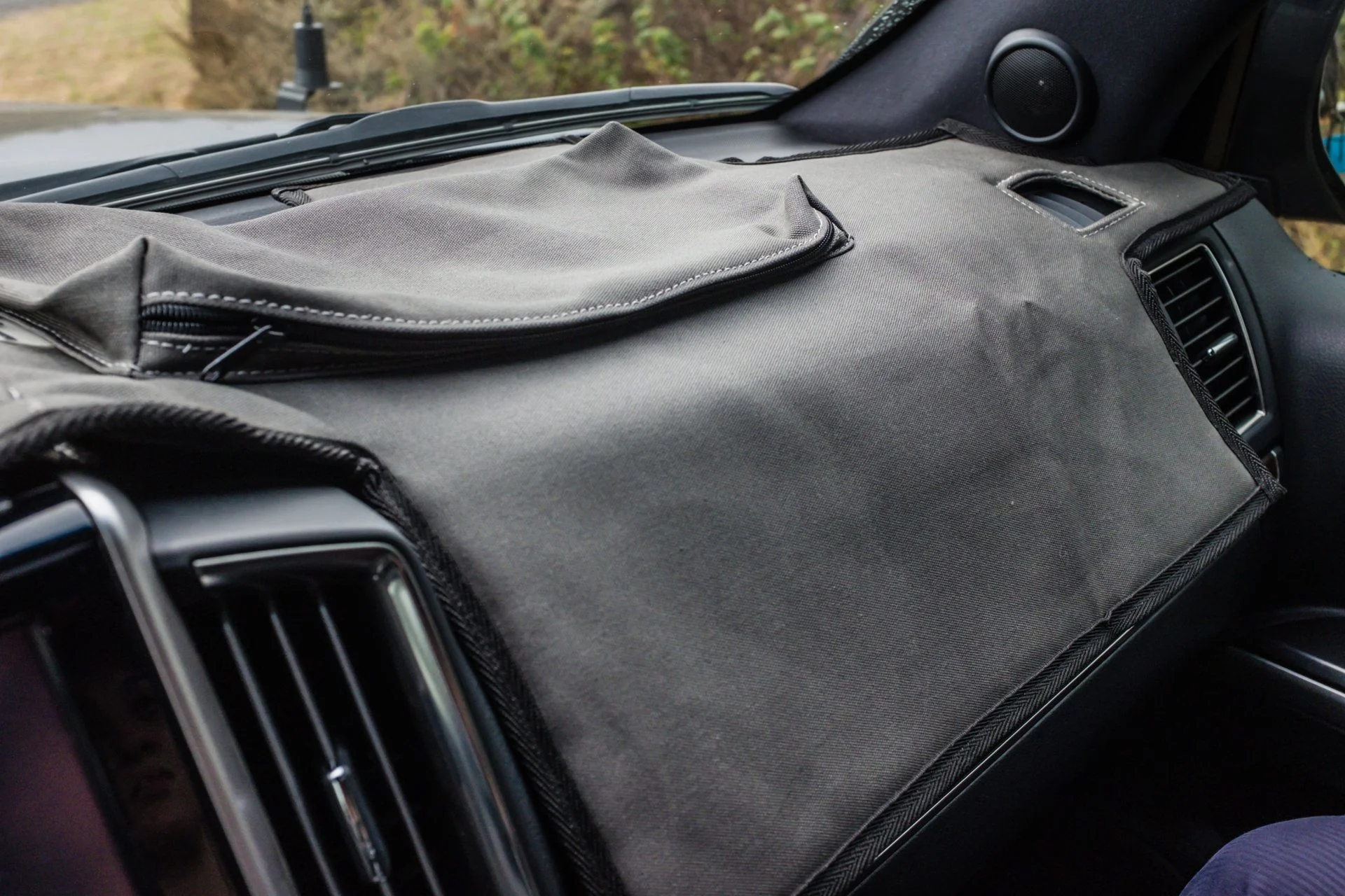

While we were literally heading out the door last week the delivery person dropped off a small parcel from Equipt. A while back I'd ordered an Escape Gear dash cover to match the seat covers primiarly for a bit of extra storage in the driver area. Check it out in the pictures below. The quality is top notch though I have some reservations about using VHB tape on the dash (the tape attaches to velcro so the cover can be removed). I also included 1.) a photo of the radio faceplate mount I made recently and 2.) a photo of the cargo area using the second National Luna light with the red cover.

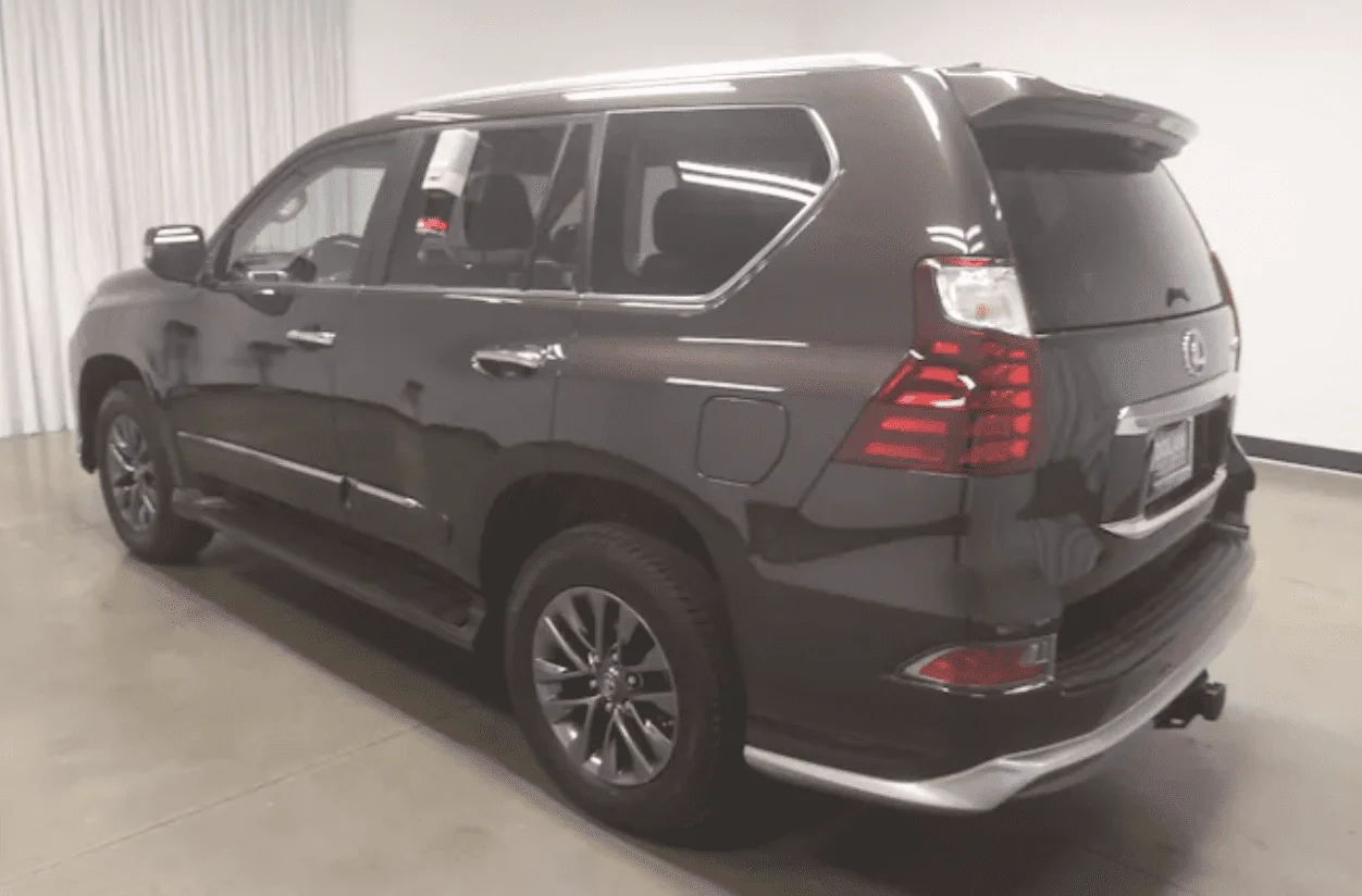

In related Land Cruiser news, the truck is about to get a sidekick. My wife had a Tesla Model 3 on pre-order for a while but her batch just got delayed again and she decided to go in an entirely different direction. All I can say is that she must enjoy driving the LC much more than she lets on as she just bought a 2018 GX that we're picking up later this week. It's a dark burgundy (kind of like the Brandywine Mica) with a brown interior. She says no mods allowed but I don't think tires or sliders count, do they? I'll post some better photos when we take possession.

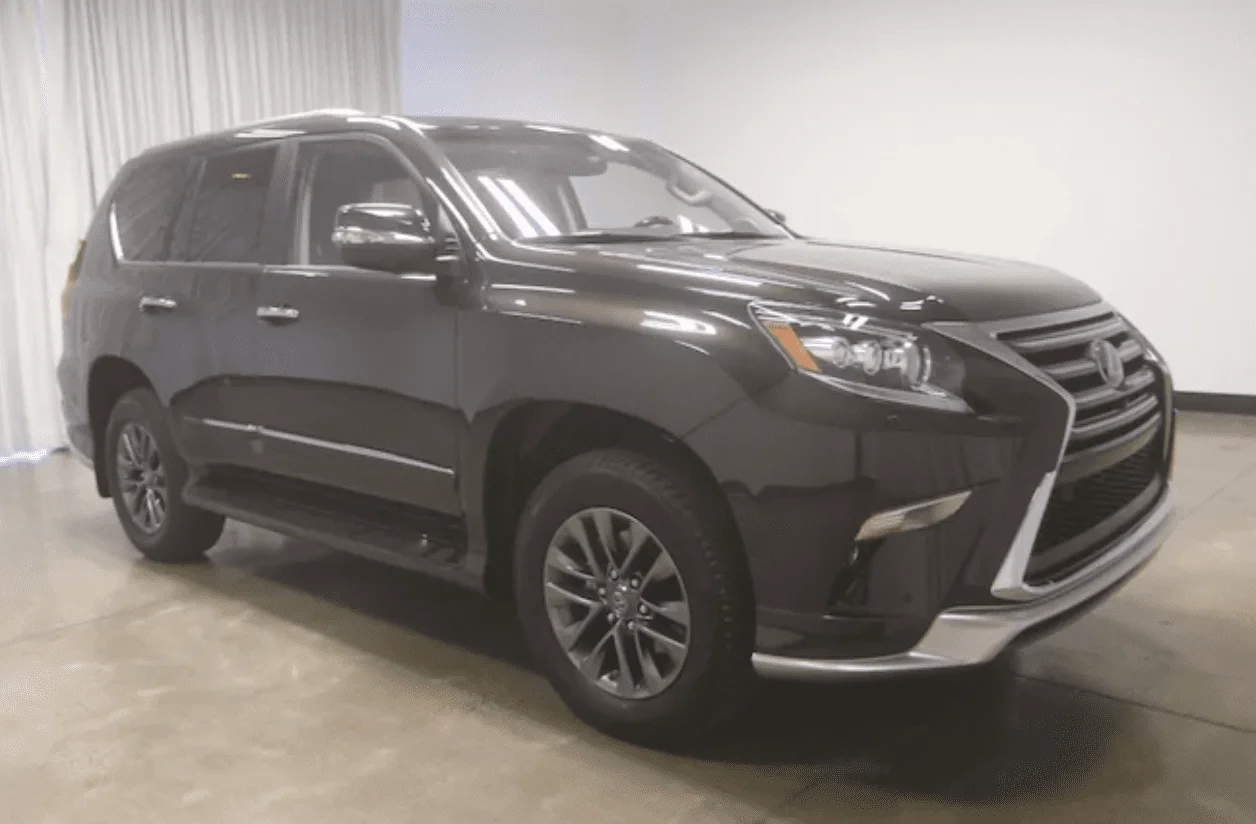

I guess we are now offiicially 2nd cousins, Cole.

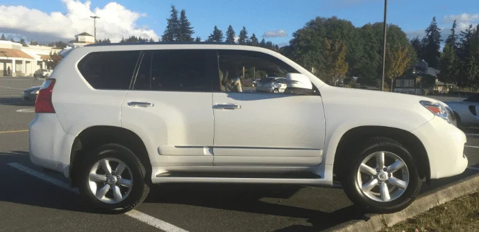

My wife and I are sharing a gently used CPO 2013 GX 460 as below. Not a wheeler but a driver / tow rig - brakes and suspension kinda suck so....It will get TT rotors/pad and TT Pro suspension at stock height.
Mall Crawler Flex Shot.....
PS Cole -
We are ordering some upgrades for our "new" GX. Let me know if you would like some decals as below in white to show off against the new truck's burgundy body. Pop off the plastic "460" and voila!

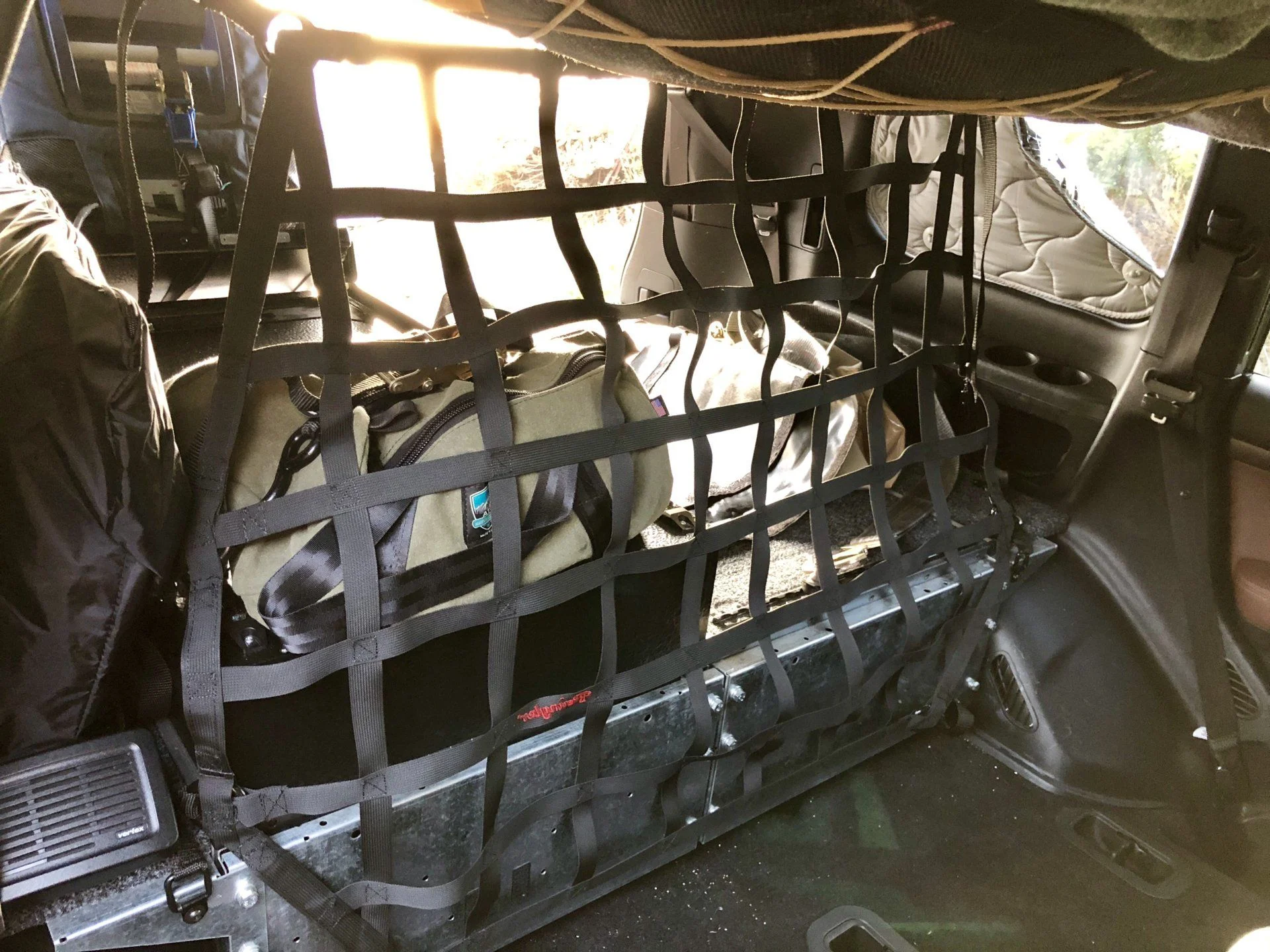

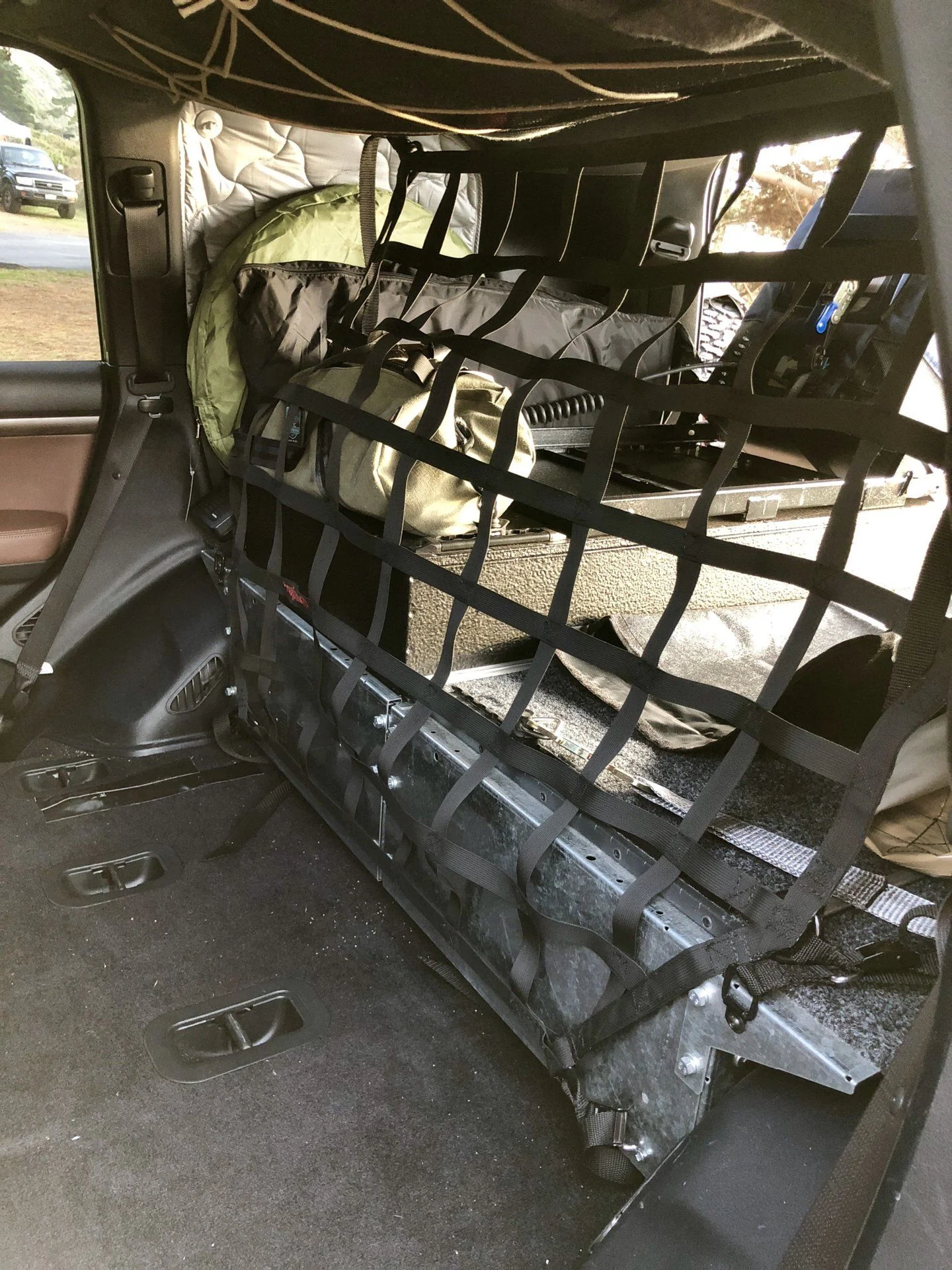

A few pages back I promised some photos of the Raingler cargo net but forgot to post them. Here are photos from both the driver and passenger side. The net itself is high quality though I did have to get creative in terms of mounting it. One could gain a bit more room by popping off the quarter panels and pillar trim to add better mounting points, but I ended up using the drawer frame for 3/4 mounts (footman anchor on the bottom of the drawer, D-ring on webbing off the strong part of the wing, and a removable ring mount on the wing itself). I'm using the third row ceiling handle for the 4th mount along with the BROG attic.

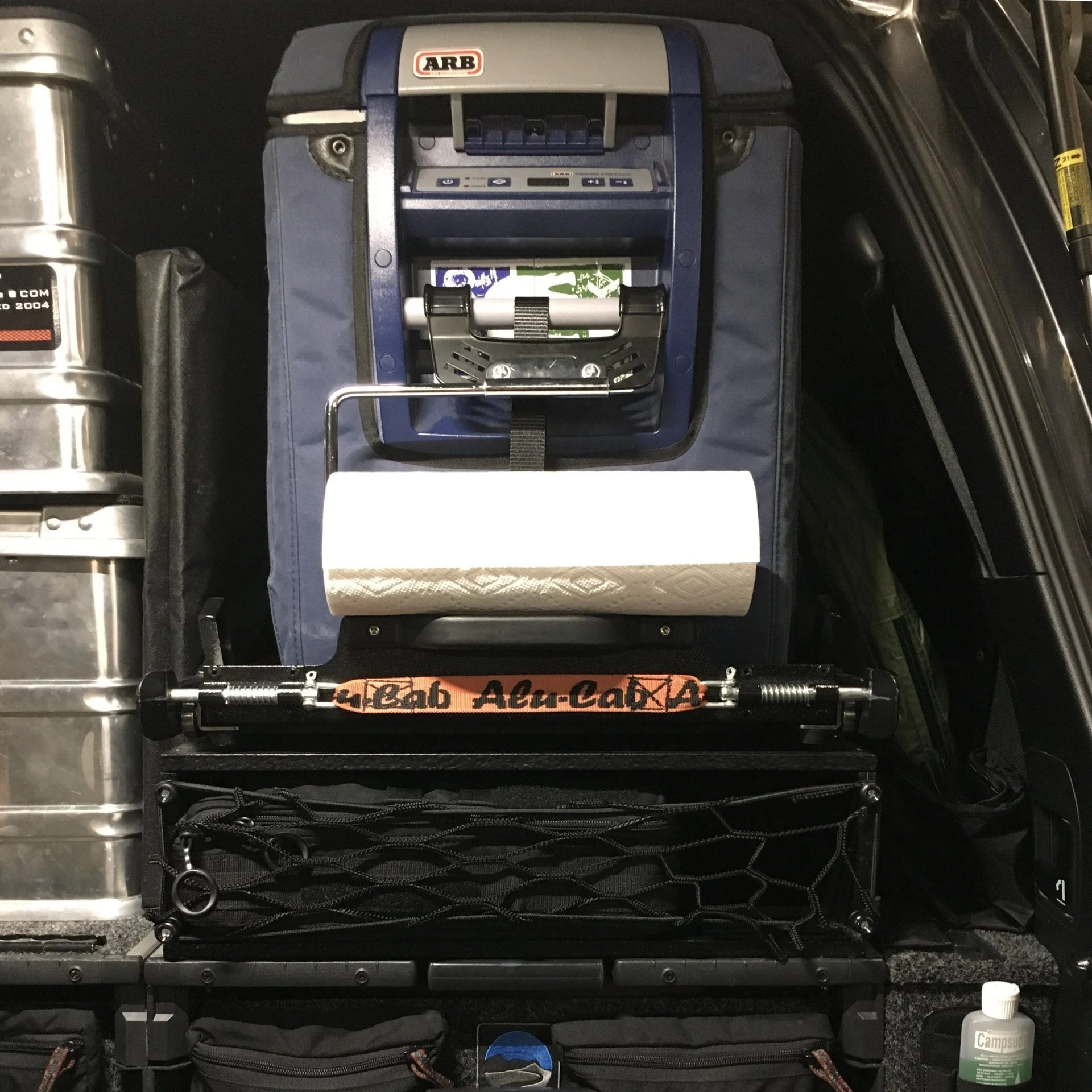

I also replaced the door on my under-fridge cabinet with some barrier stretch net.

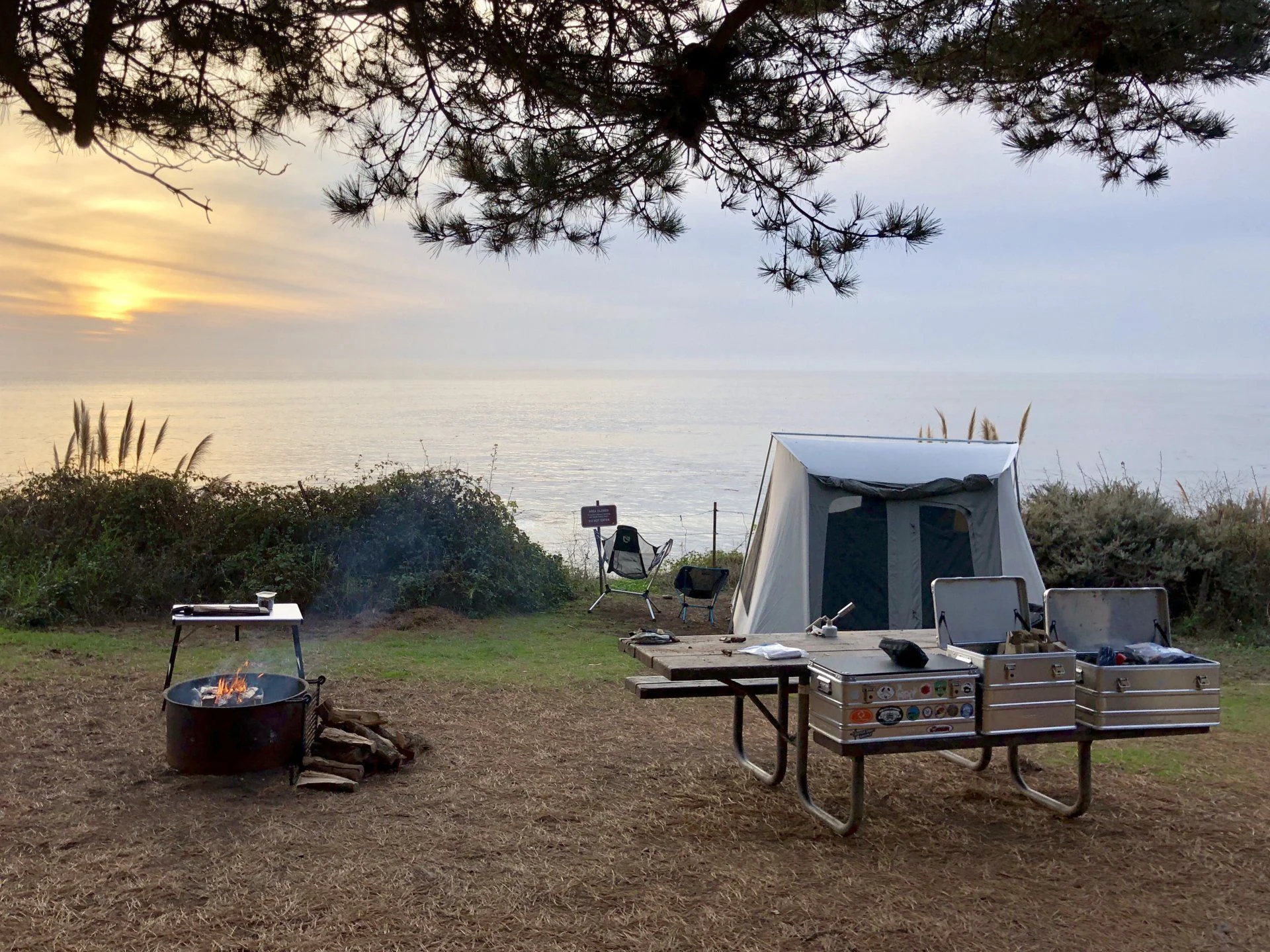

Aside from assisting Valley Hybrids / Cruiser Brothers with some fuel tank R&D, we've been doing a lot of short weekend camping trips mostly down to Big Sur throughout the fall. We don't stay in campgrounds often, but when we do it's site #22 at Kirk Creek.

I like that dash cover....
Yeah, it's handy! A bit of protection, a bit of extra storage, and it also stops stuff from sliding around on the dash. It's a companion piece to the Escape Gear seat covers, and just like the seat covers, the construction quality is very high and the fit is about 90% correct (not complaining... just my observation).
